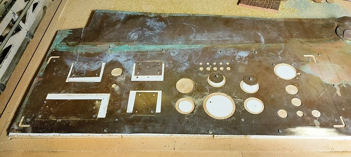

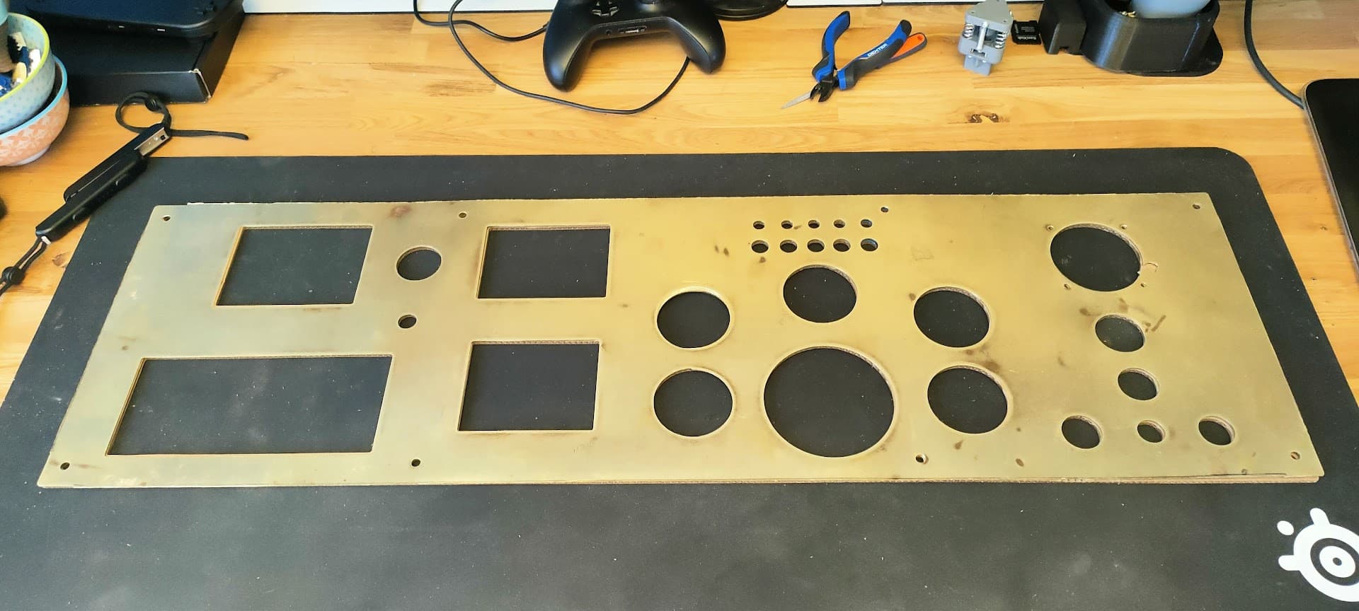

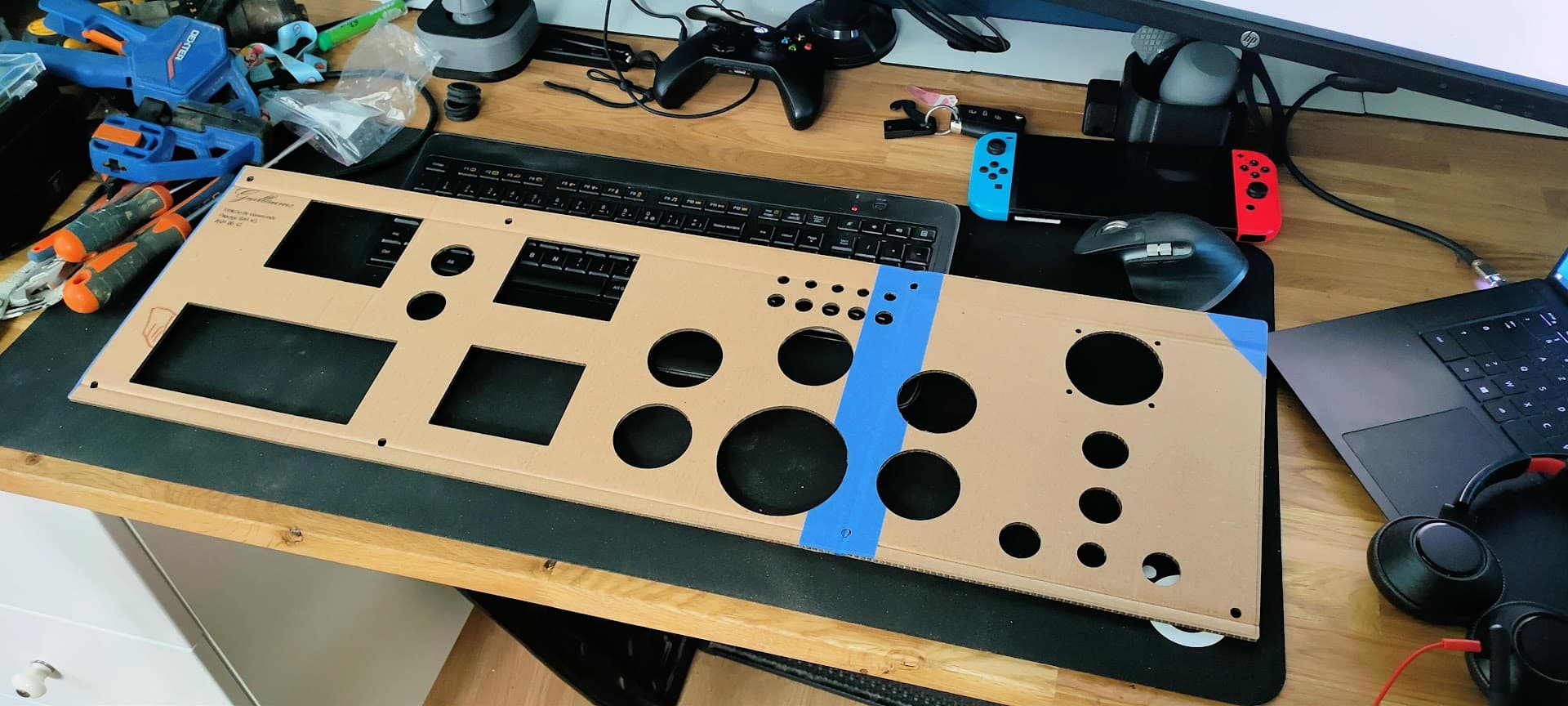

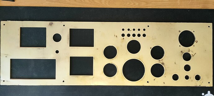

1. Cutting a dashboard panel

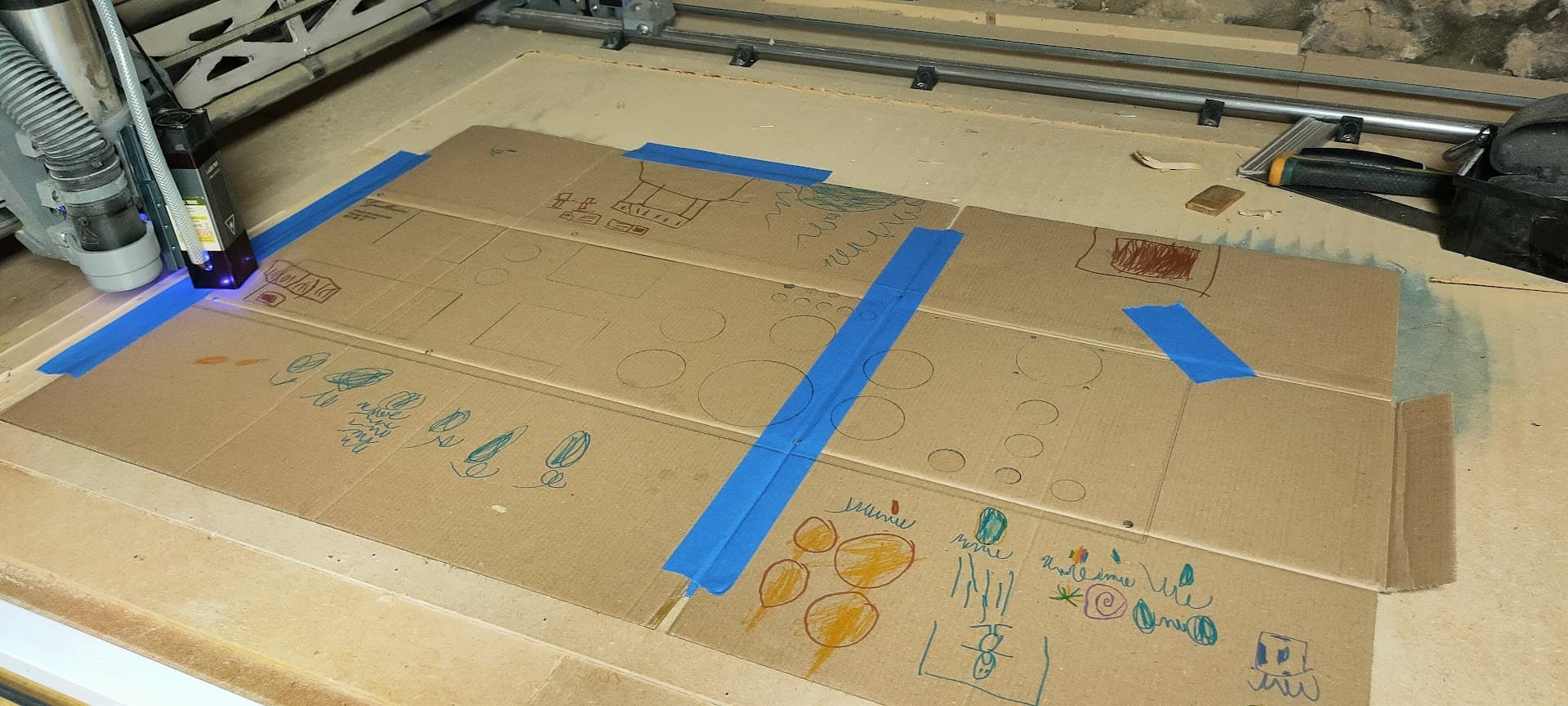

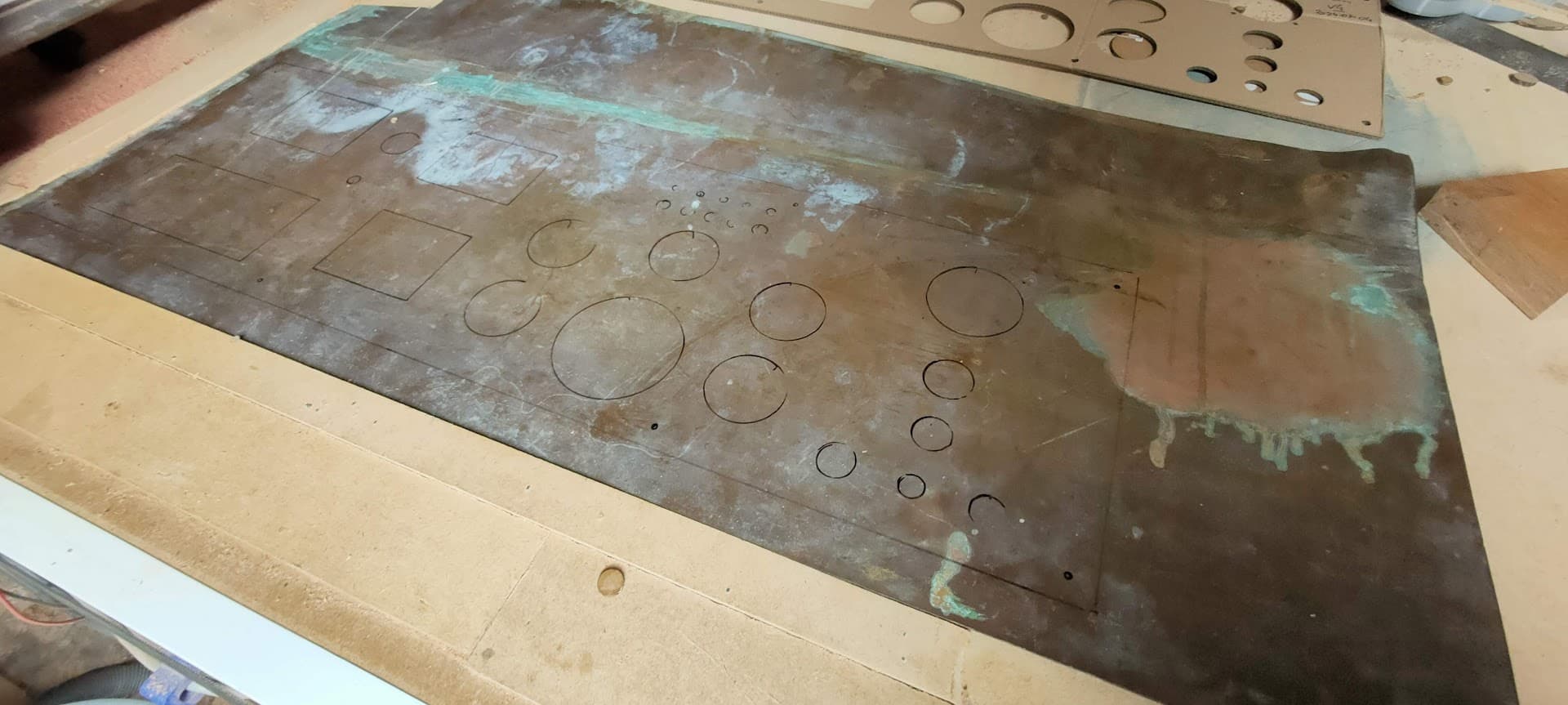

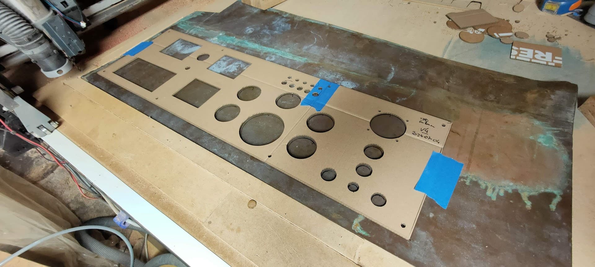

First task was to cut a dashboard panel for all the navigation instruments in the cockpit
He provided me with an SVG file of the layout, and I quickly laser-cut it out of cardboard to test the fit and feel
Fun fact: As you can see, the first prototype was cut out of a genuine spaceship dashboard courtesy of my 5yo son :smiley:
Prototyping like this is always a good idea, as he spotted a few mistakes and optimizations, and we did 4 prototypes before committing to the final cut

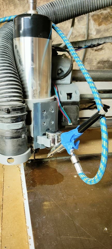

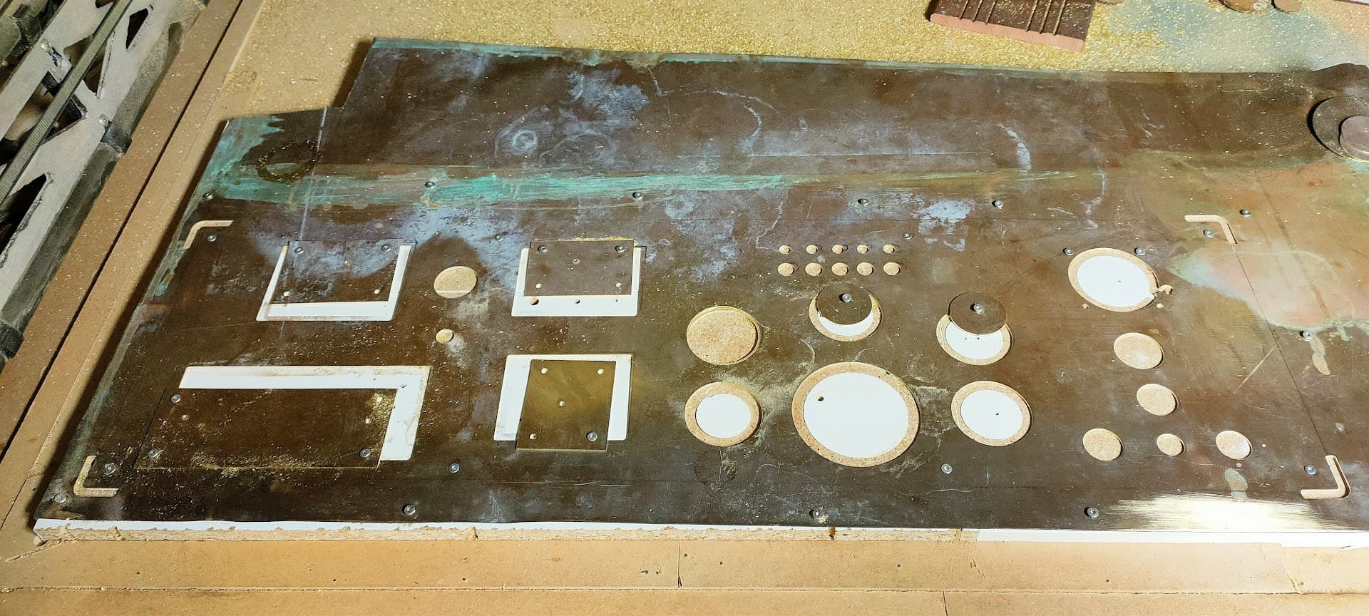

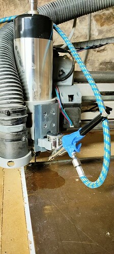

Final product was cut un a 3-4mm thick copper plate using trochoidal milling (hats off to @Tokoloshe)
I made a few boo-boos but nothing too problematic
I had to make an ugly kludge to spray some IPA during the cut :slight_smile:
After a bit of cleanup…

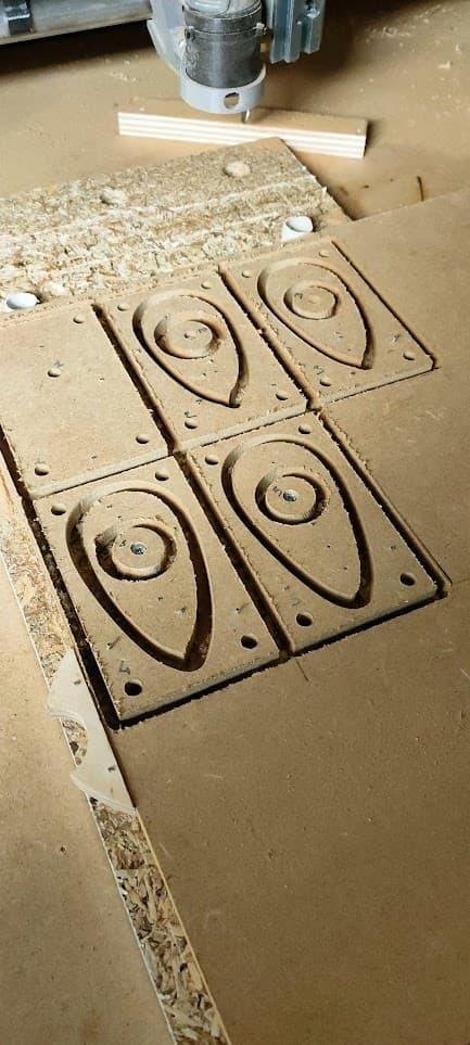

2. Sonar support

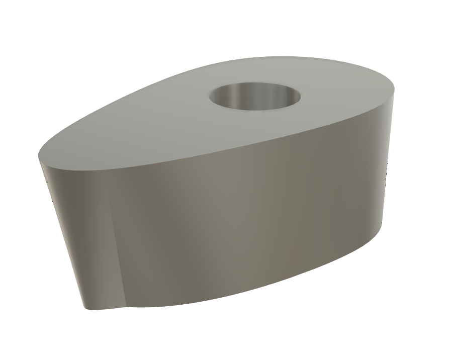

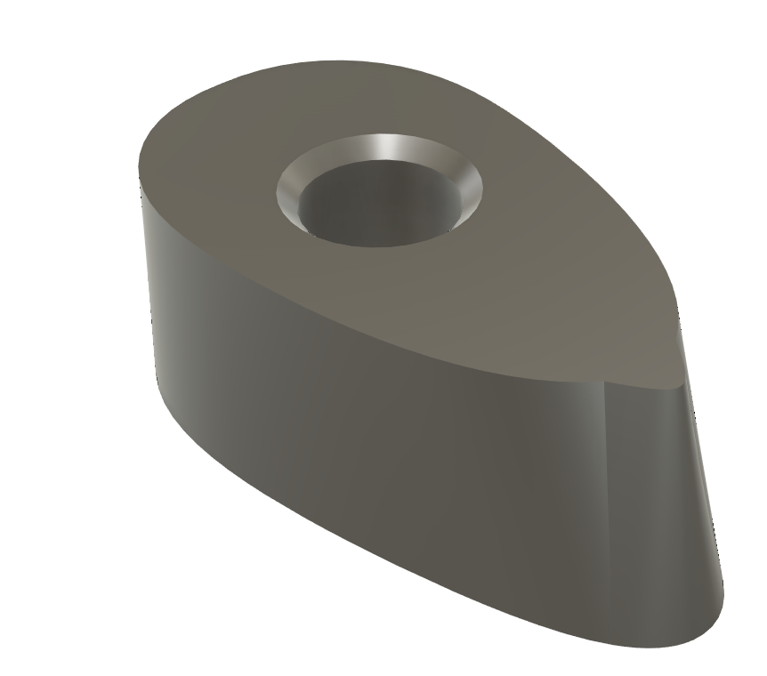

Second task was to recreate the sonar support.
The original is a kind of rubbery fixture that goes under the hull of the boat, with a hole through the middle were you can stick the sonar
As he needed to cut part of this support to adjust to the size and shape of the hull, he wanted to have a “copy” of this part in case he messed up

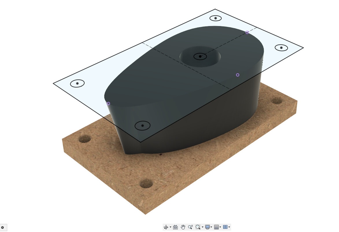

I measured and modeled the part in F360

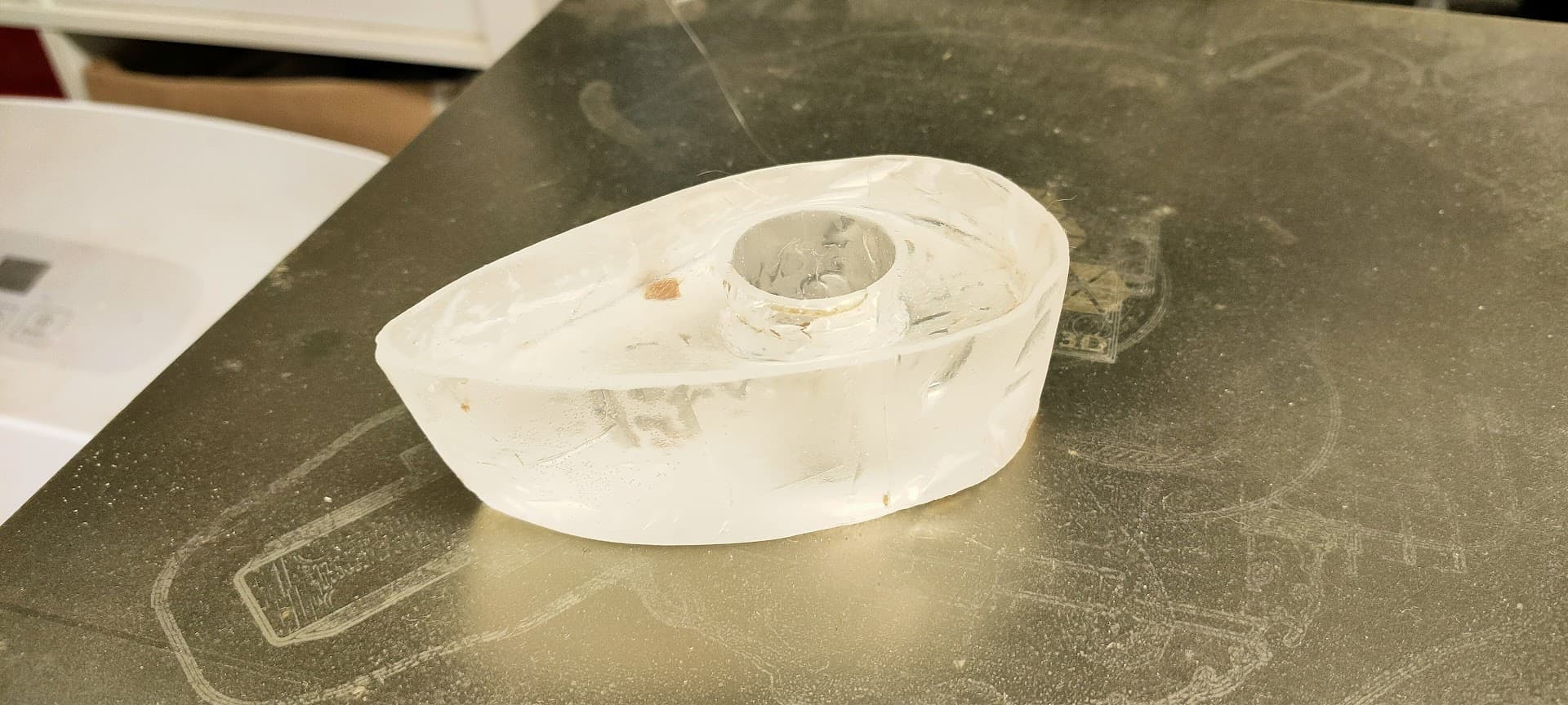

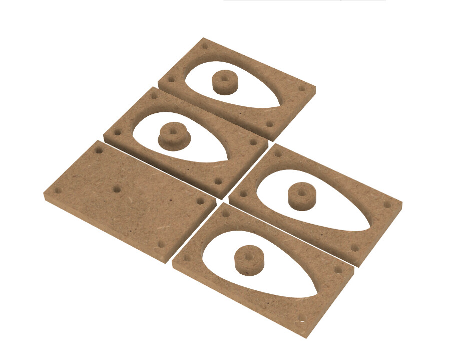

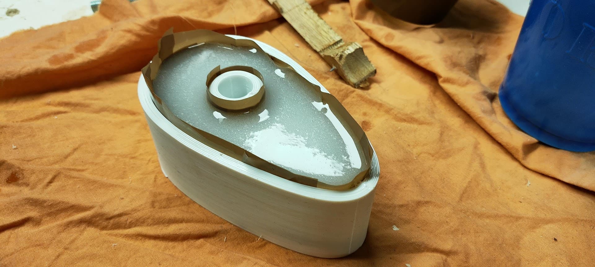

As the part lives underwater and needs to be watertight, 3d printing it was’nt going to work…

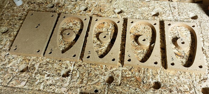

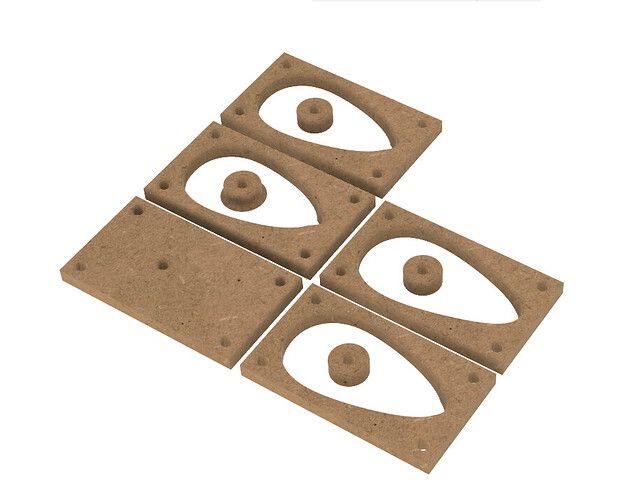

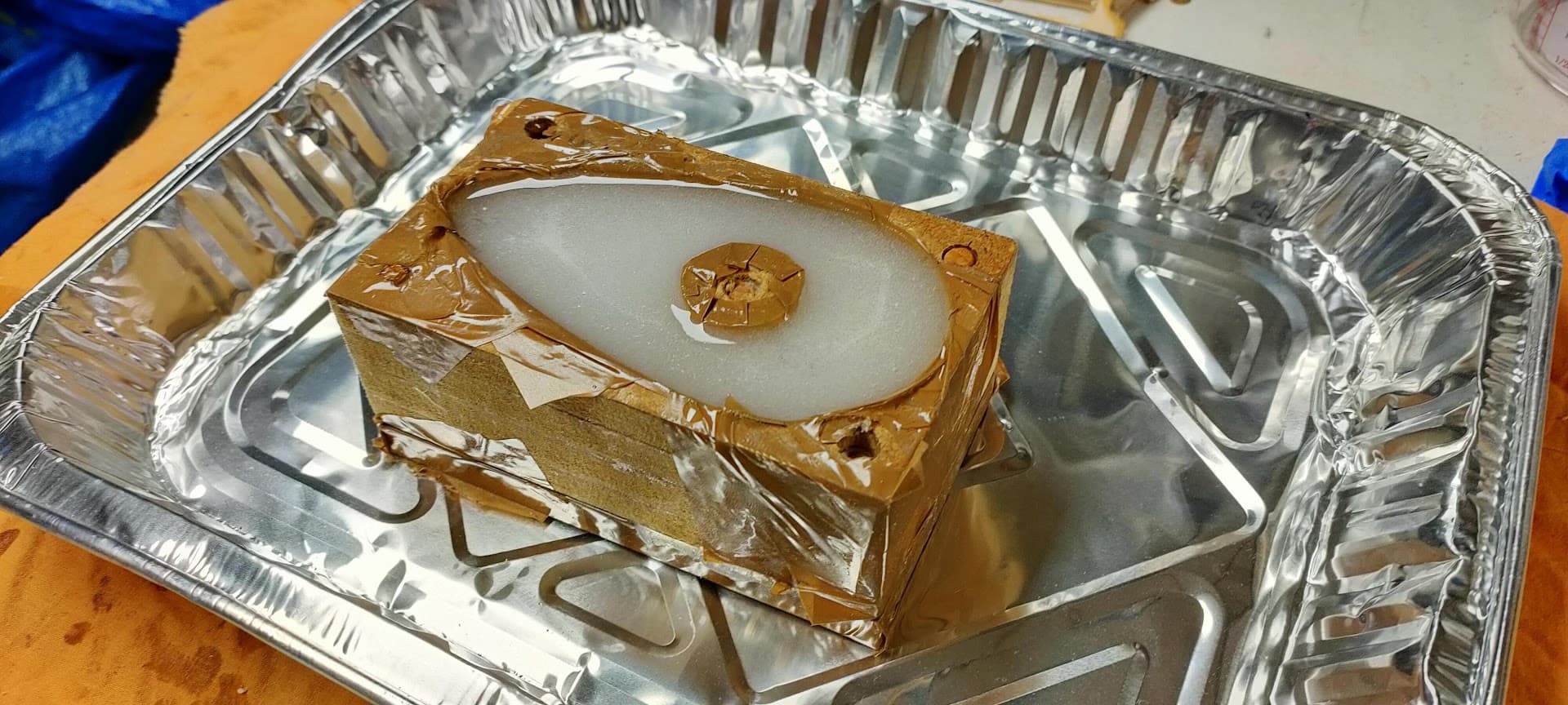

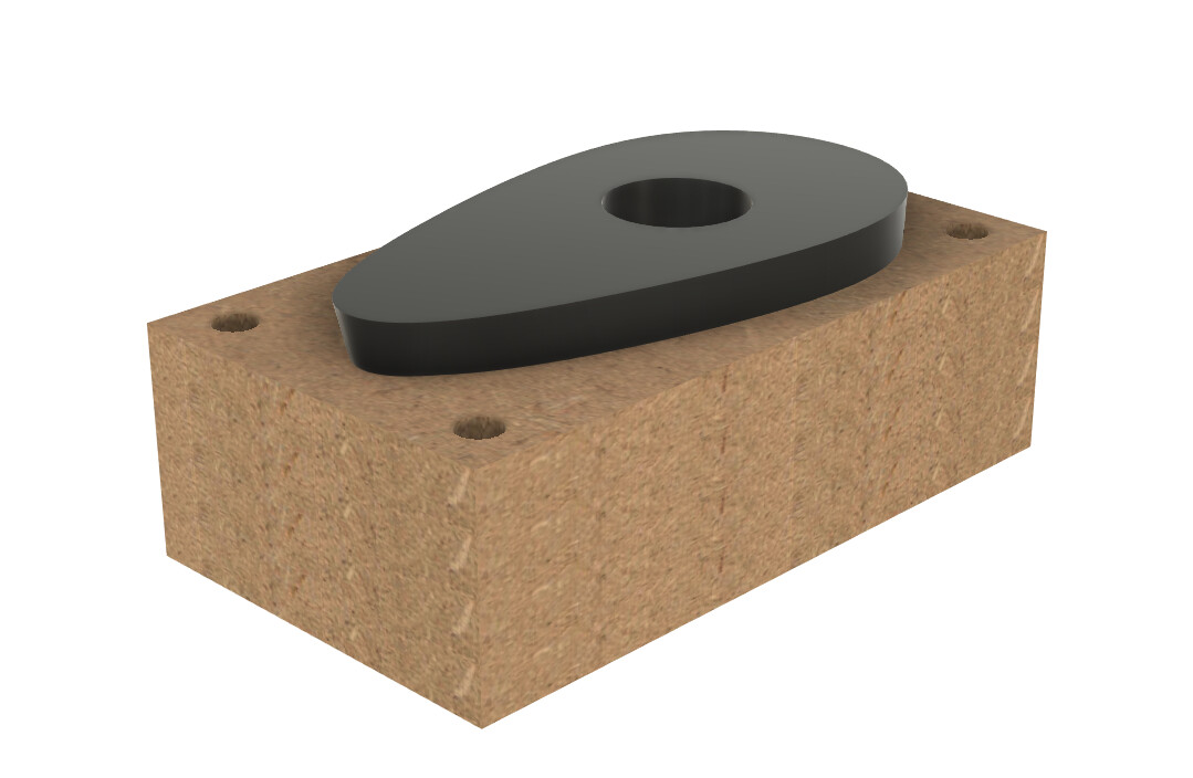

I decided to print a mold, and make the part out of epoxy
I initially printed the mold in TPU and poured the epoxy
I don’t have pictures of the utter mess it made, but trust me,the TPU mold wasn’t watertight :smiley:

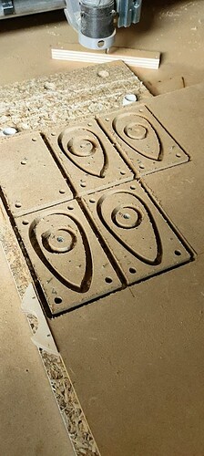

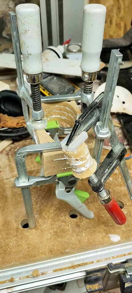

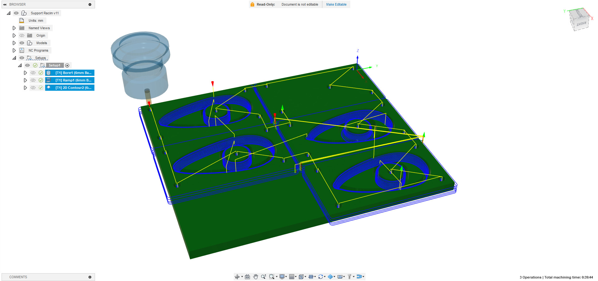

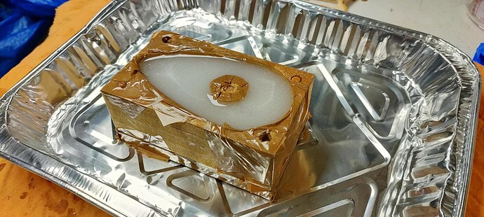

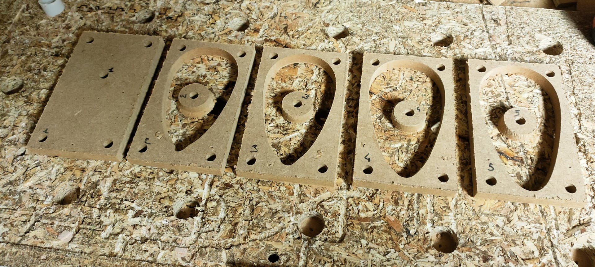

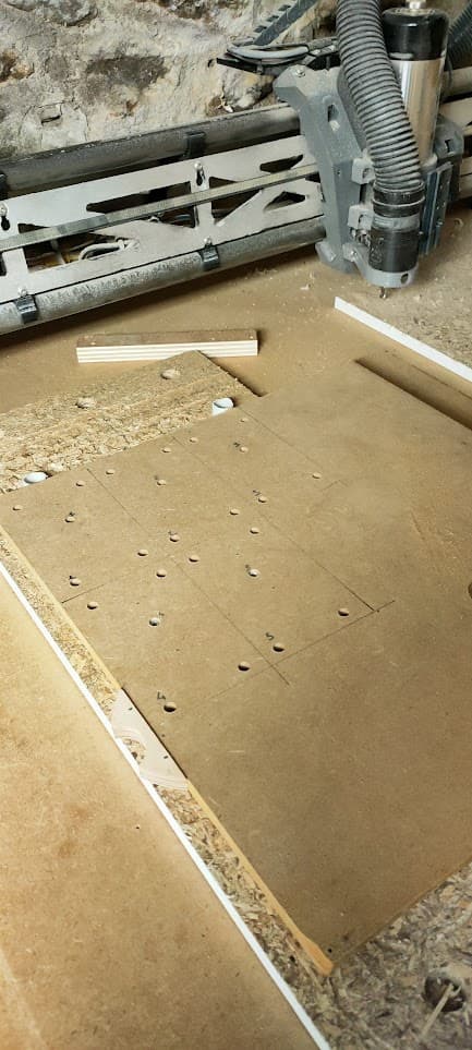

Second mold was made out of stacked sheets of MDF I cut on the LR3
This time I added extra security measures :smiley:

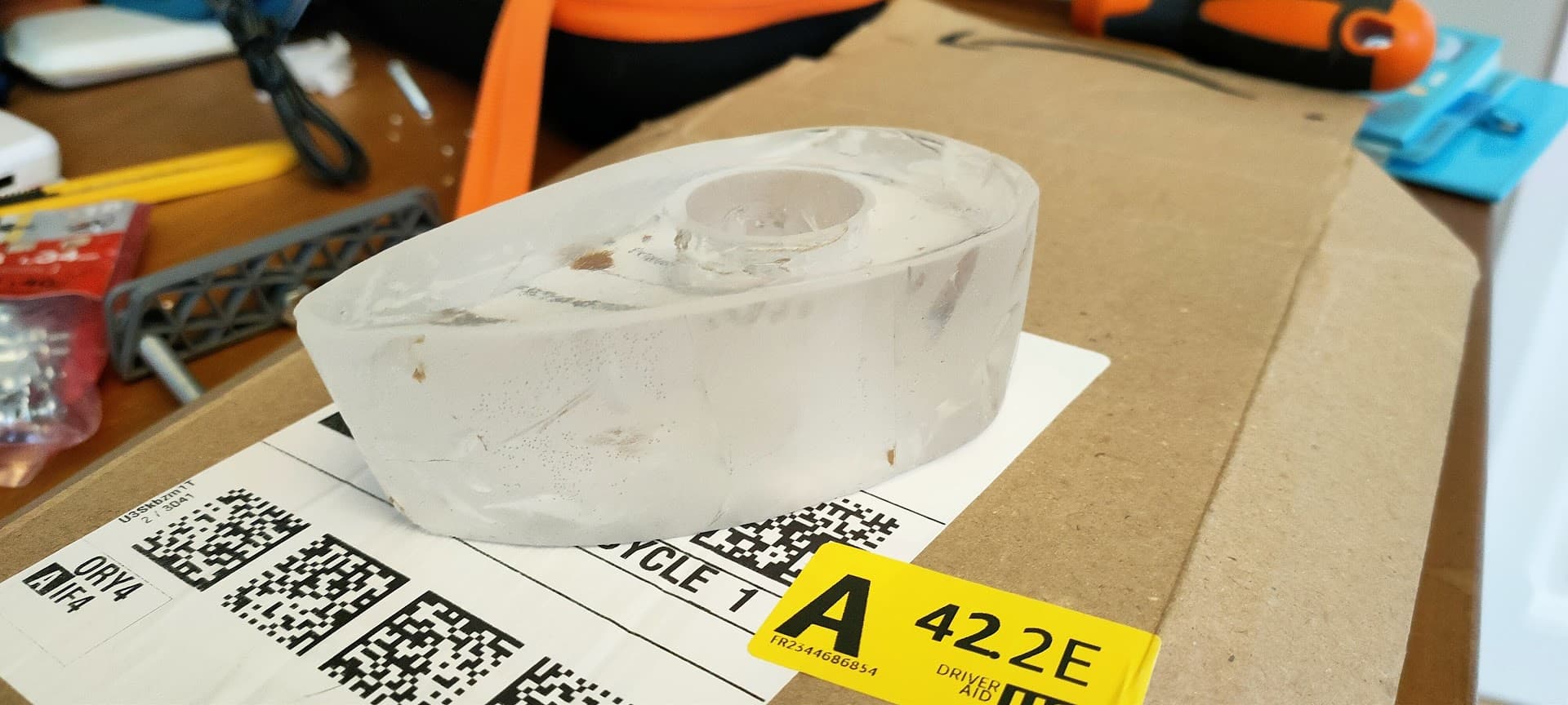

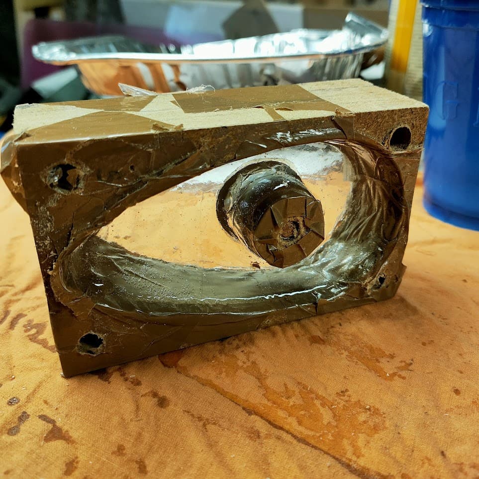

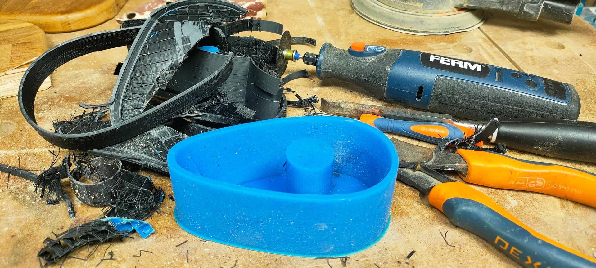

De-molding:

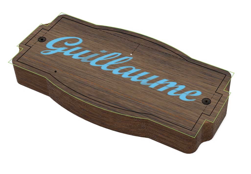

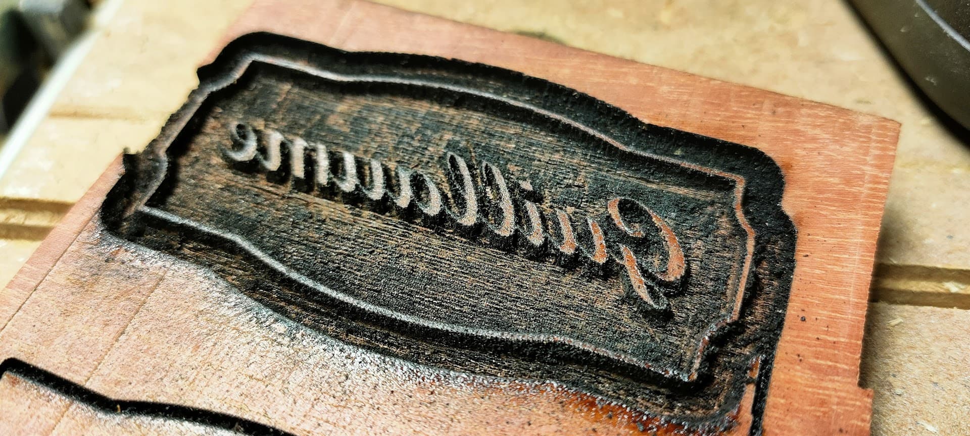

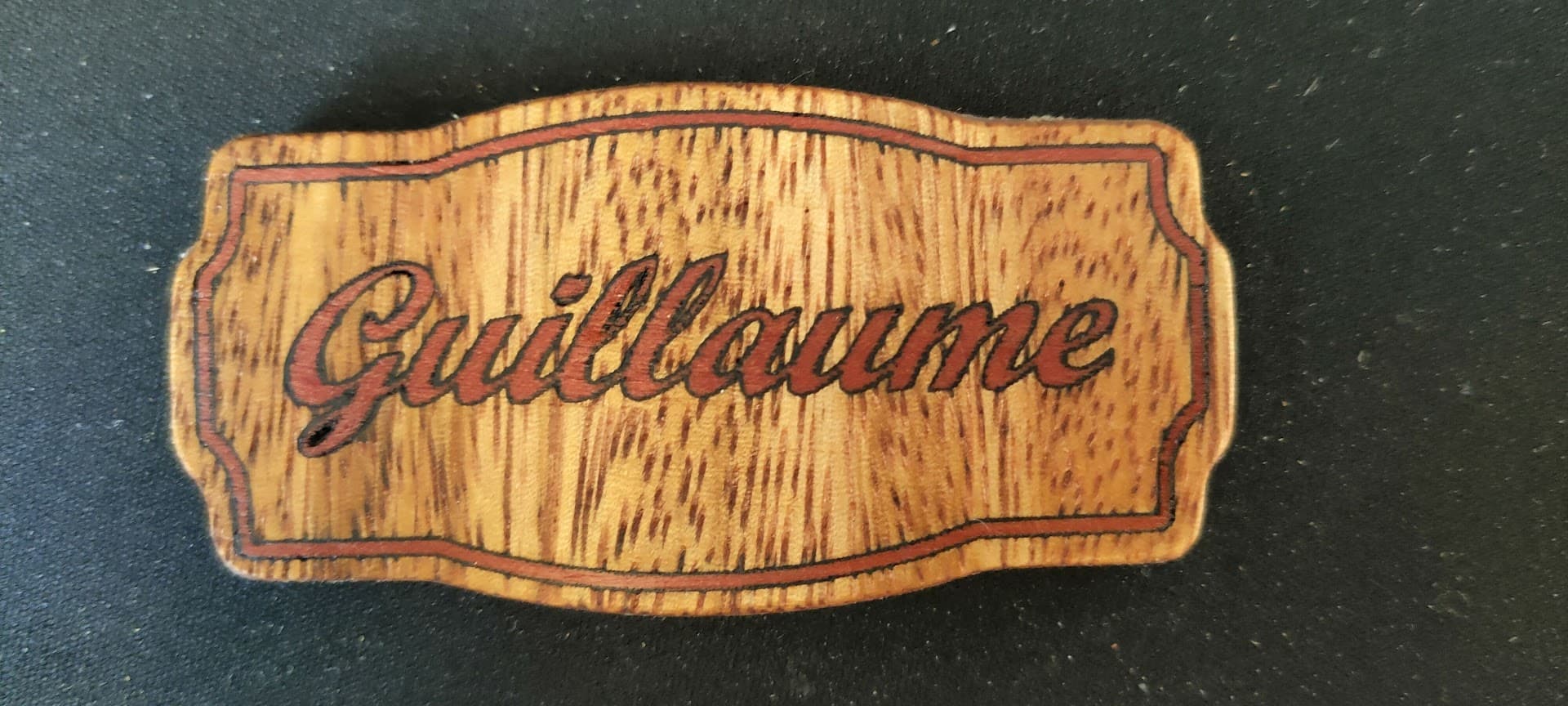

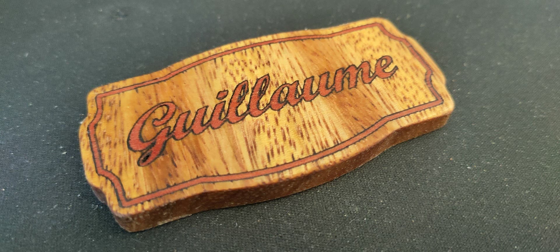

3. Extra project: Small nameplate

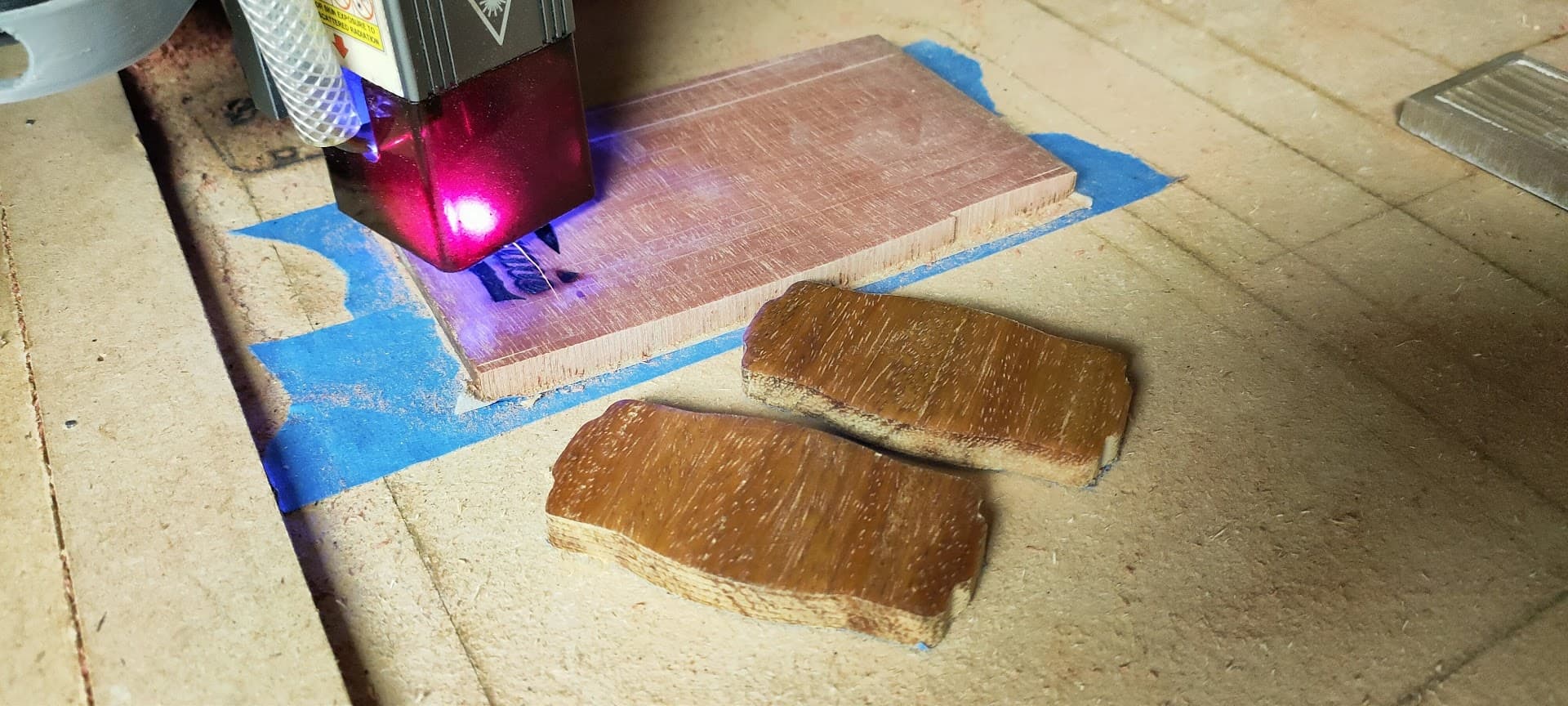

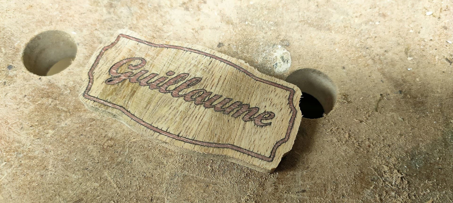

As a small birthday gift, I made a small wooden nameplate with the boat’s name
It’s made out of exotic woods, the blank is first cut on the CNC
Then I lasered out the inlayin the blank, and another time in negative in another species of wood
Stick the negative text into the blank, hog out excess wood, and there you go
After a bit of cleanup and oil (small deffect in the G but that’s no biggy…)

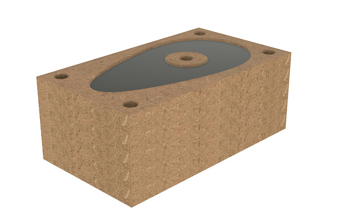

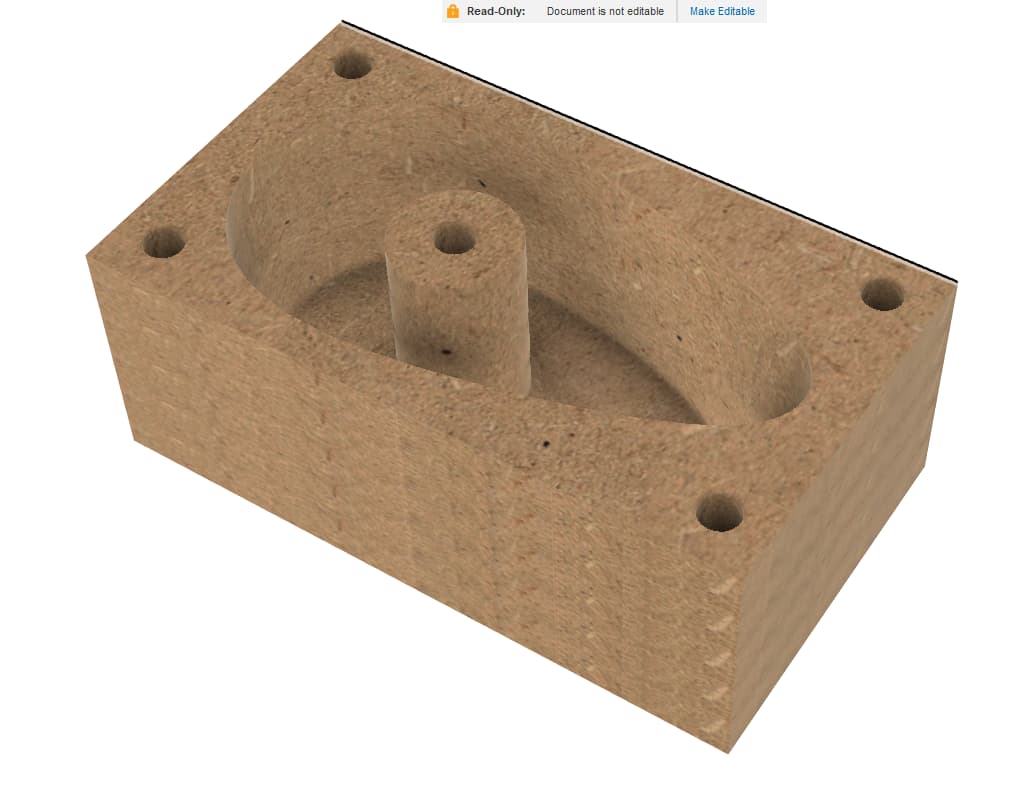

Ooh, that’s neat, and definitely giving me some ideas. What was your process for turning a 3d model into a set of “stacked negatives” for cutting?
Seconded Doug’s feelings about the bitter end! Damn!

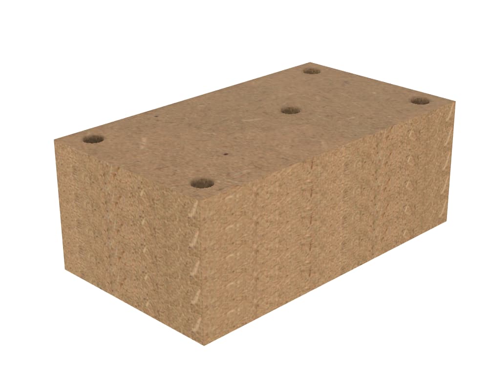

I created a small block the thickness of my mdf sheet around the model
Copy/pasted it a few times until it covered the part (i could ahve used a linear pattern)
And made a boolean difference with each of those objects
Then it’s just a matter of laying everything flat (I would use MapsBoard Pro for this now…)
And designing the CAM program

He already got over it and bought a new one with much less work
We should start a new dashboard pretty soon for this one, probably marine-plywood wiith some veneer

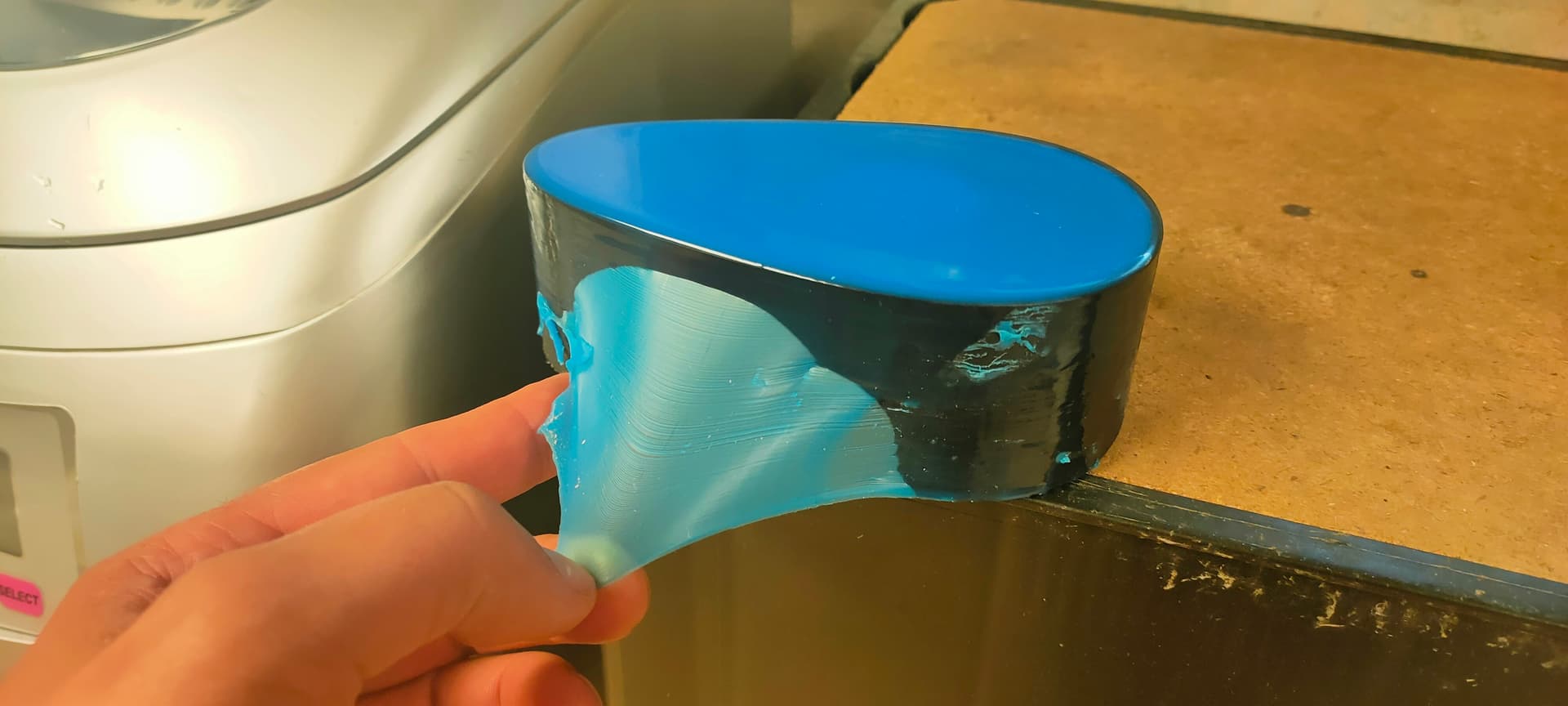

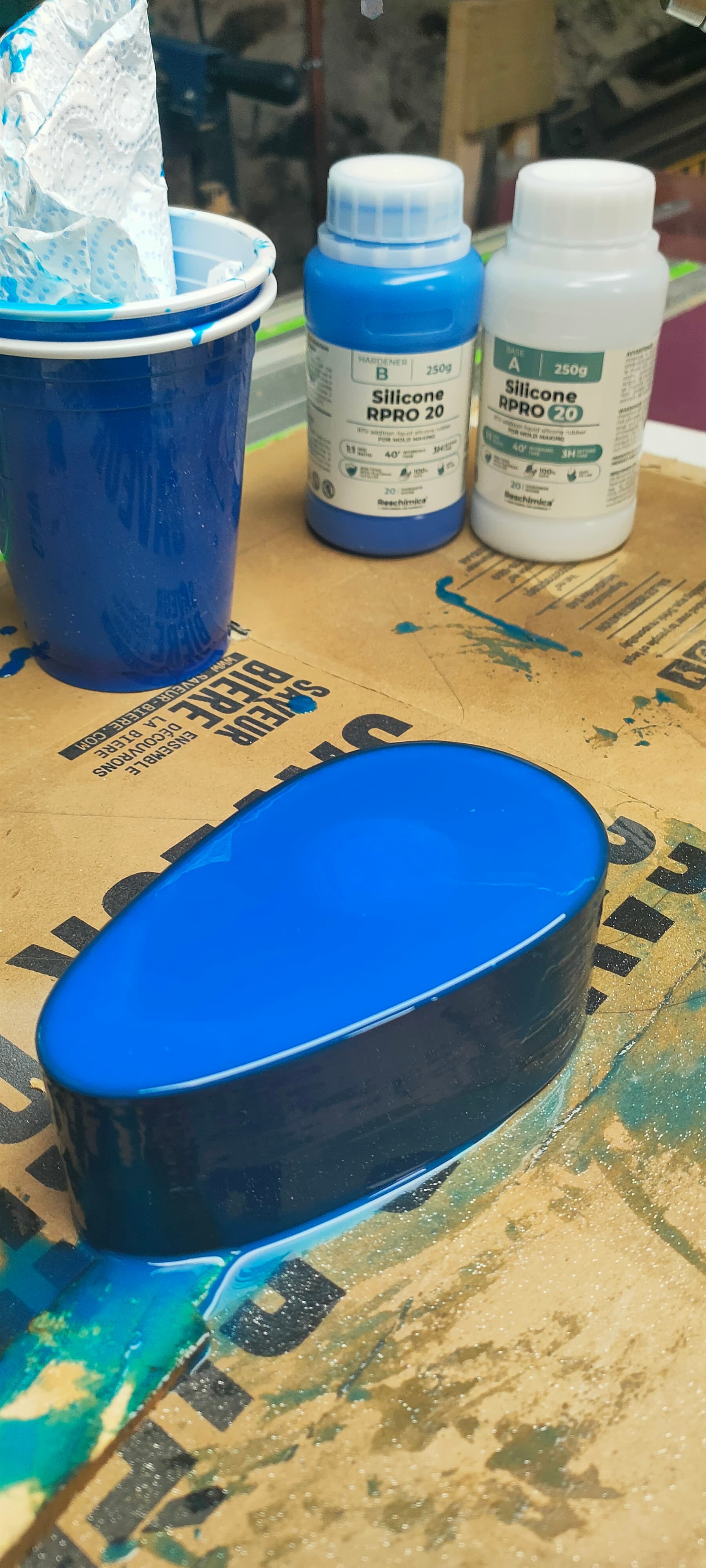

In the meantime, I’m re-casting the sonar support

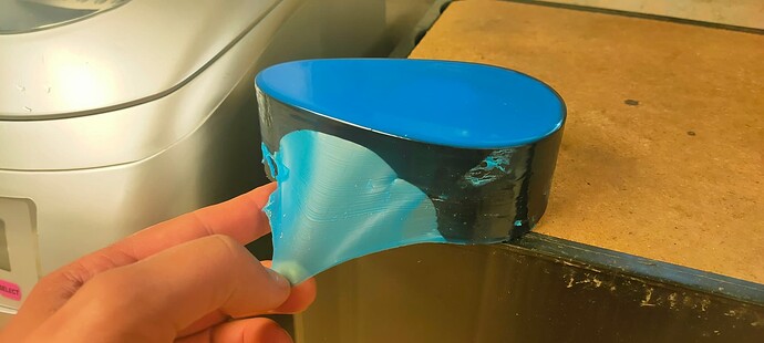

This time with a silicone mold to avoid leaks…
Mold removal went just as expected :smiley:
First time working with silicone, it’s always exciting to try new techniques
