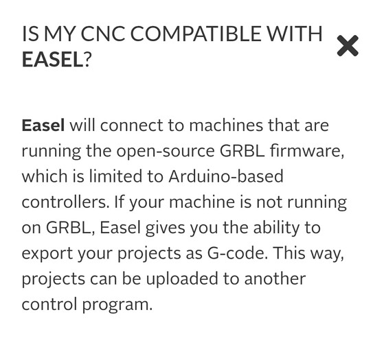

My understanding is that we can’t utilize the full capabilities of any cad/cam software like Easel, Easel cabinetmaker, Vcarve or an that I am aware of to control the LR4 with the Jackpot.
So in case I am missing something, is there any control software that works with it other than WebUI? I would love it if Easel would be that software… especially as I plan to purchase the Cabinetmaker part.
Or, alternatively and this is the least desirable, is there a control board that works “out of the box” that the Jackpot be swapped with so the LR4 can be controlled by the most popular softwares available?

Your question is possibly better directed at easel as to why they don’t support a grbl based machine over IP.
Searched their forum for ‘FluidNC’ and this was the second result which as far as I can see says it does support FluidNC?
Last time I checked, Easel used a very simple set of g-code commands that work with Marlin. There is a good chance it would work with FluidNC as well. Note, you cannot talk directly to FluidNC. You need to save the g-code file and use some sort of g-code sending solution to send the file to your Jackpot board.

I’m not convinced Easel isn’t compatible with FluidNC.
Jason, I believe (and probably wrong) that the issue is being able to be controlled wirelessly. As Ryan has reminded me, the job file sits on the sdcard in our jackpot board and is accessed and ran by our WebUI (i.e. press start) and thats it, the board controls the job from there based on the gcode. Having a program like Easel control the machine does seem a bit backwards now that it was pointed out to me in that giving control to an exterior program would allow for potential error if feeding all that gcode in a streaming fashion, whether wired or wirelessly. Having gcode on the board and being directly ran by the board to the steppers is the surest path and the most efficient, and I am now a believer in this process.
Once my job file is correctly created (by whatever means) and placed on the sdcard (by whatever means), the job will run exactly as programmed without any chance of ‘third party errors’
