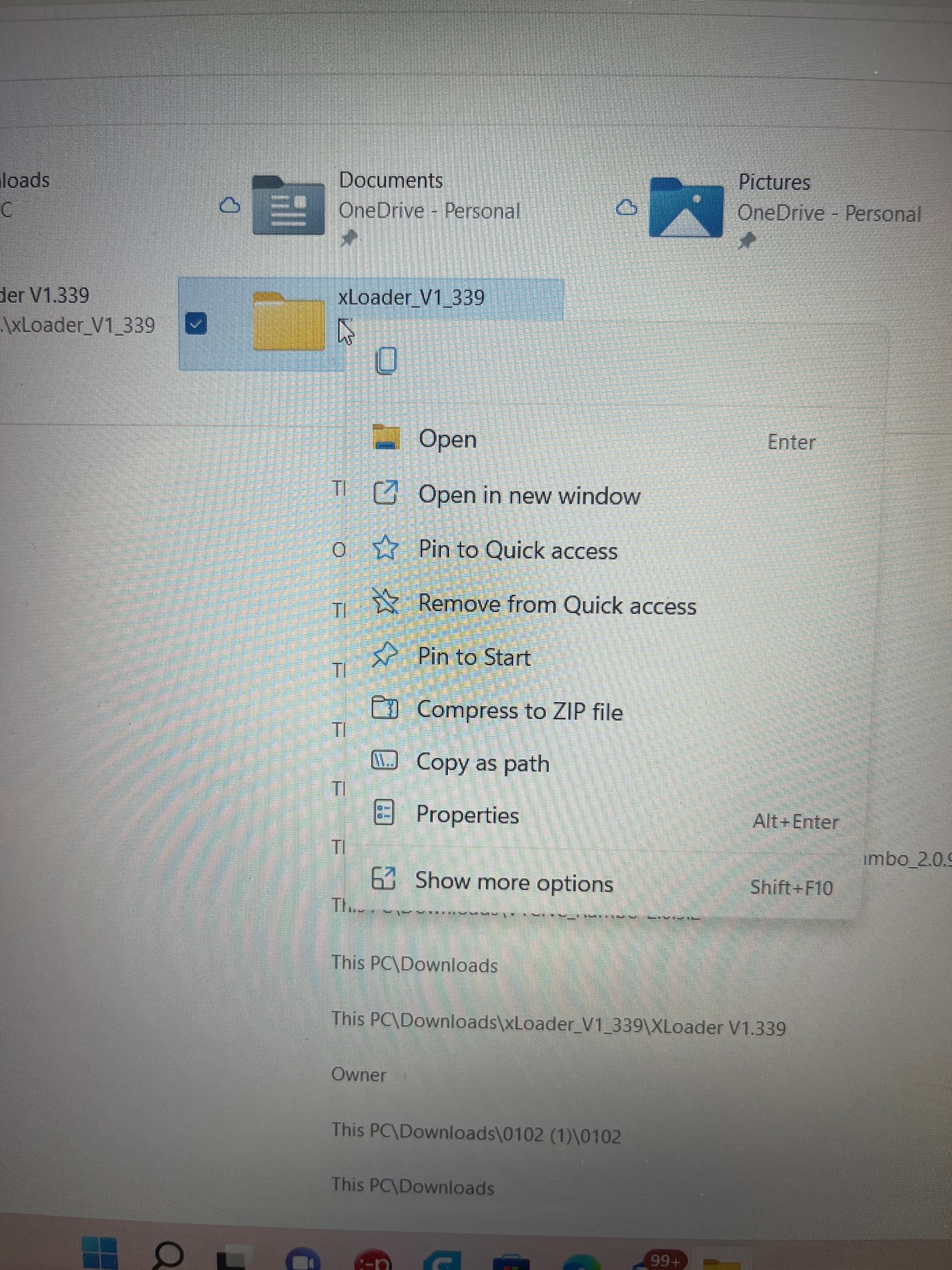

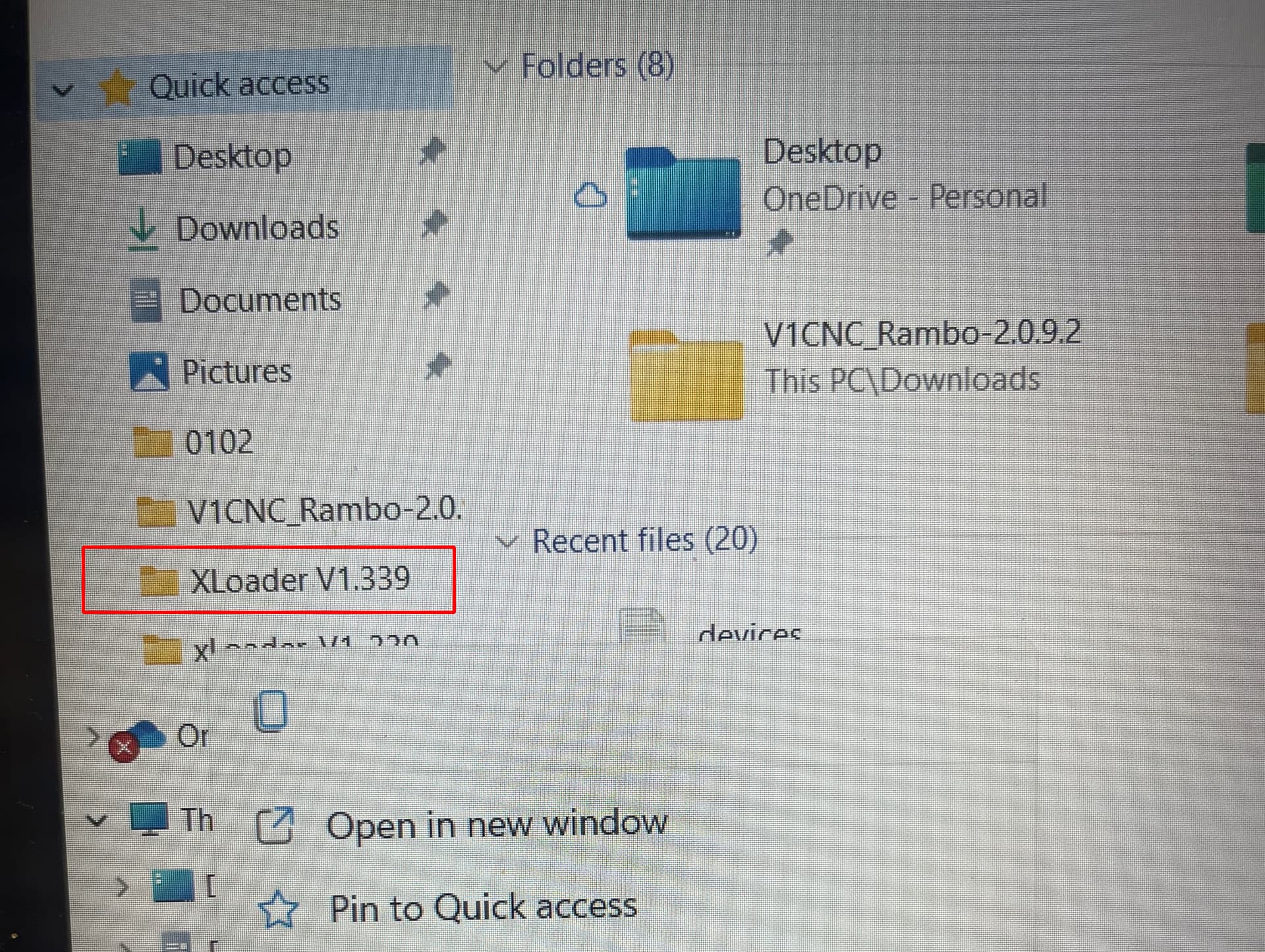

You right clicked on “Quick Access”. You want to right click directly on the XLoader folder.
I’m not where/how you got that particular menu. I would suggest you right click on the folder framed in red:
According to your screen, this folder is in downloads, so alternately, you can click on 'Downloads" then select for the content that appears on the right.
