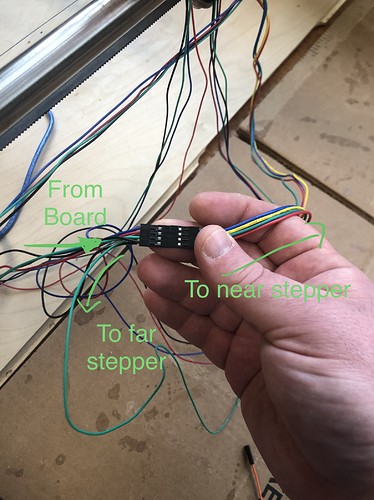

Here is a pic of wiring. Before the weekend my colleague must of played with it slightly and now neither y axis motor responds to commands. From my rude entry circuit analysis I’m pretty sure I’m looking at parallel wiring for the x and y axis. Is this something I should change? Some of the wires that are junctioned in the pin connector pictured seem loose, I was thinking my next step was to just require that and make sure the connections are all good, but just slightly confused on the color coding between the steppers and the other jumper wires (blue yellow red green vs blue black red green respectively)

First, make sure that you’re completely de-powering the steppers (I’d pull both the green power connector and the USB) before changing motor wiring, otherwise you run a very strong risk of permanently damaging the driver chip (ask me how I know!) which is under the heat sink on the driver carrier board. It may look blown, or it just may not work any more.
Second, there’s no real standard for color coding on stepper motors, so you can’t go by color to identify the coils. Each stepper has 2 coils that are energized in sequence to result in the step motion. If the coils get “crossed” and energized in the wrong sequence, either very weak and flip-floppy motion, or no motion at all, is likely. The good news is that this doesn’t harm the motor or the driver, it just doesn’t get any work done. To identify coils, with power removed, short any 2 wires together and manually turn the motor shaft. When the shaft is harder to turn (compared when all wires are disconnected), that pair of wires is one of the coils - call that Coil A. The other 2 wires should be the coil B - go ahead and confirm by the same method.
Third, with just three drivers installed on the RAMPS board, you should be using Series wiring, not parallel. The plug in the photo appears to have 2 wires crimped on one side (board and “far stepper” are permanently attached to each other) and “near stepper” plugs in as a parallel connection. Parallel wiring splits the current between the motors in a way that results in less torque. You’re going to want maximum torque, which is why serial wiring is recommended.
When I put my system together, I custom wired a series harness that ran from the board and had 2 sockets where the motors’ normal 4-pin connectors could plug in. Each connector pin only gets 1 wire this way. This allows reversing one motor by “flipping” its plug at the harness, or reversing both motors by flipping the board end of the connection (or flipping both motor plugs at the harness end, of course). I’ll let you search the forums for Series Wiring as I don’t know that I can explain the wiring arrangement better than those who have gone before. You will want to know which pairs of wires are coils on your motors before you begin. Remember that the colors are arbitrary!
Fourth, soldering the connections won’t help unless they’re in the proper order. If you can get them in the proper order by moving the plugs around, then the benefit of soldering is sort of lost (at least in my view - I like modularity and ease of swapping components). If you are having intermittent connection problems, I’d first check to see if the crimped connections are good. Use a small pointed object to gently lift the plastic locking tab where you can see the crimped metal and the pin should slide out the wire end of the connector. I’ve done a bunch of these and still sometimes get bad crimps or trap some insulation in where the wire is supposed to go. I’d be especially suspect of where 2 wires are crimped to a single pin.
