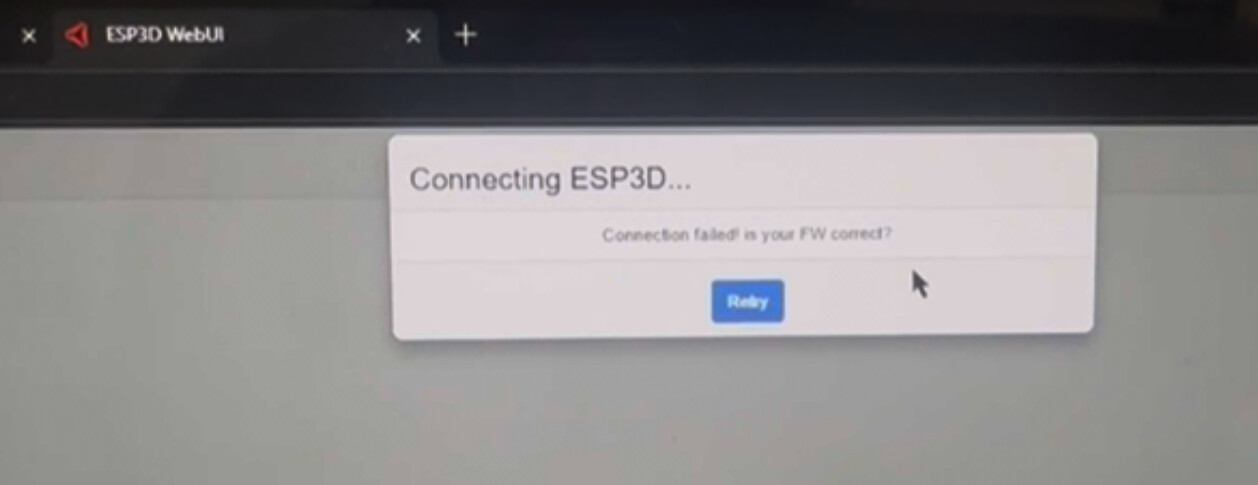

Ok, guys, for the second time today, my lowrider is giving me issues. Evey time I try to connect while its in the middle of a job (Abeit while it is paused and waiting for a tool change), I get an error when it connects to the esp3d, not the wifi. The error is Connection failed is your FW correct.

Do you have a screenshot?
By default, FluidNC will block http requests while a job is running. I’m suspecting that is what is happening here.
Thanks for the help! Here is the screenshot
How would I change the HTTP request setting?
The setting is $HTTP/BlockDuringMotion. I can provide some details in a bit.
Thanks! I will try to find that setting
