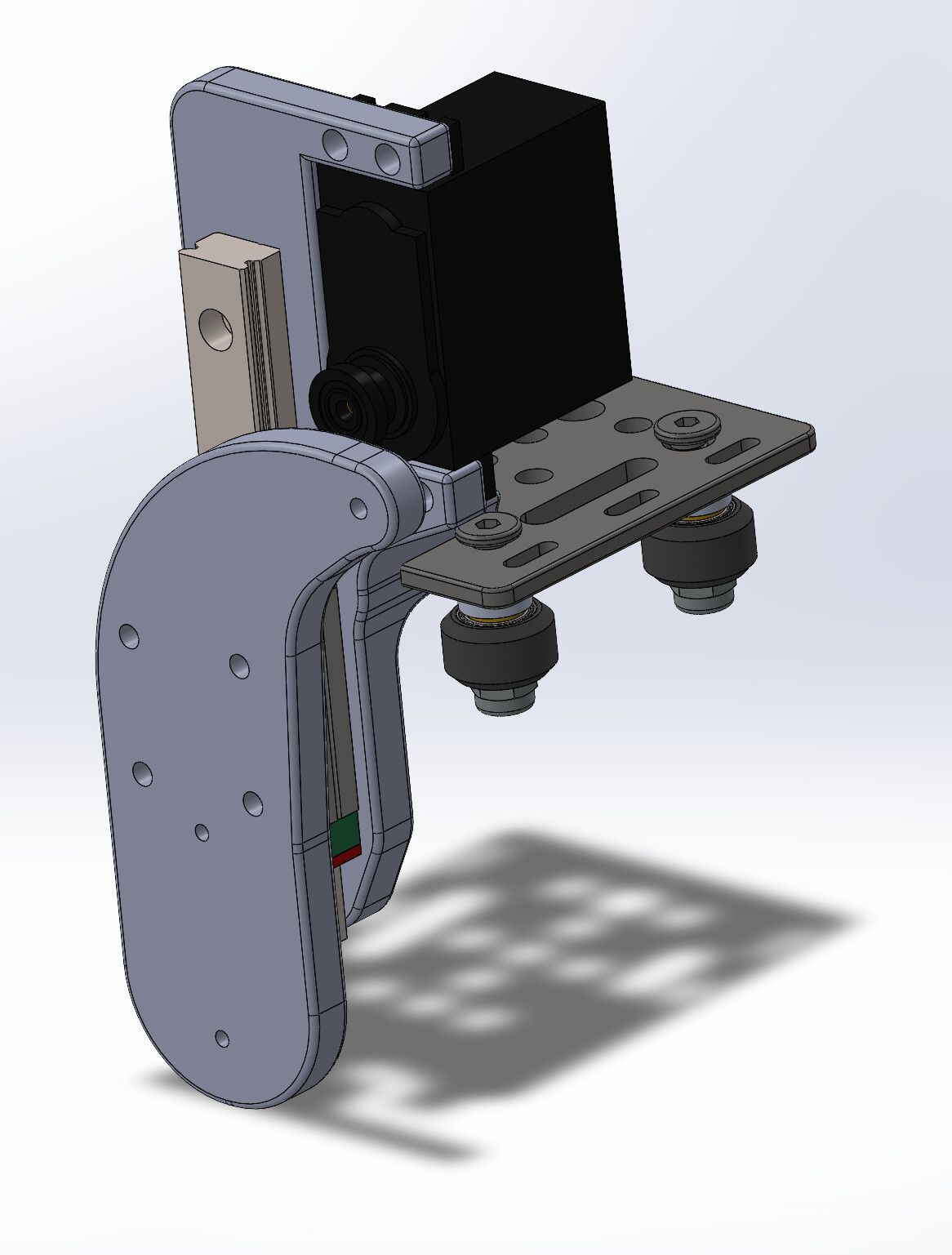

Hi all. I received all the remaining parts from China during the last 3 days. This morning I had a chance to mount all the pieces and also to modify and 3D print the new actuator plate.
Here you can see some pics
The structure looks pretty sturdy and stable. I am able to print at 3000mm/min without evident noise on the patterns.
