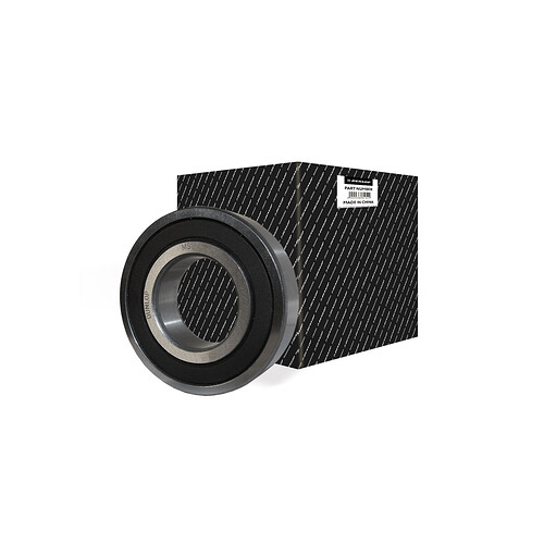

Also, if you haven’t bought your bearings yet I was very happy with these
£16 for 50 bearings, and much better than the ebay ones I bought before.
