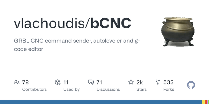

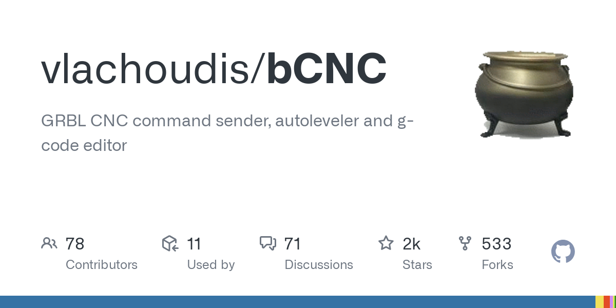

Its a feature of bCNC, which I’ve been using at the local hackspace. It’s nothing super fancy or automated, basically you mount a camera on the x plate, use the router to drill a small hole somewhere and then jog to line up the camera to the hole. The software calculates the offset between the two. Then you can realign it to that point as required, and help to home the stock (or the machine if into the wasteboard.) I’m not sure of the accuracy level compared to limit switches is but for double sided machining it might be helpful.
