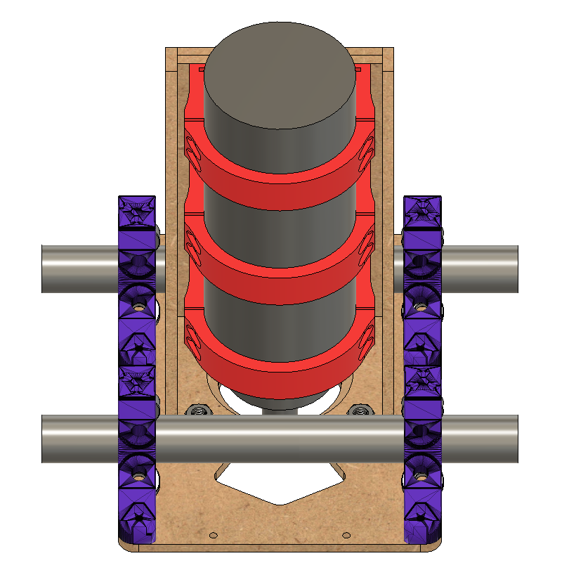

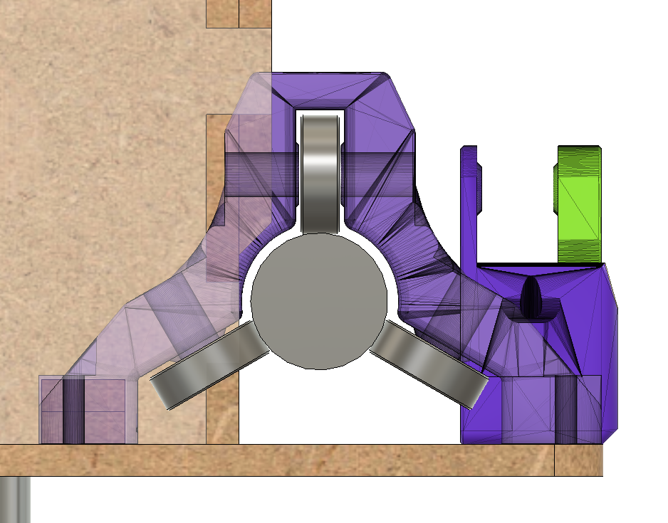

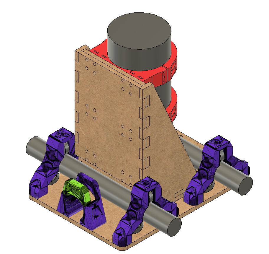

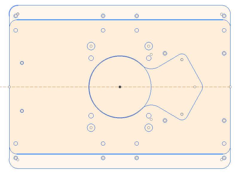

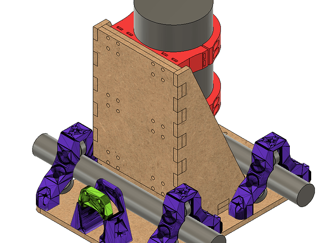

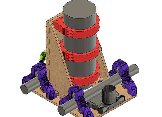

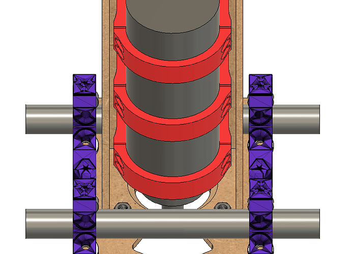

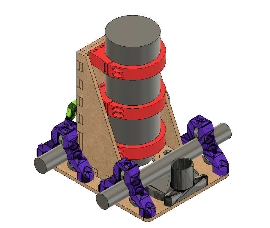

just an update, to fit an 80mm spindle I had to make the center plate wider by 30mm. Apart from losing some X travel, are there any other problems that could come up from this?

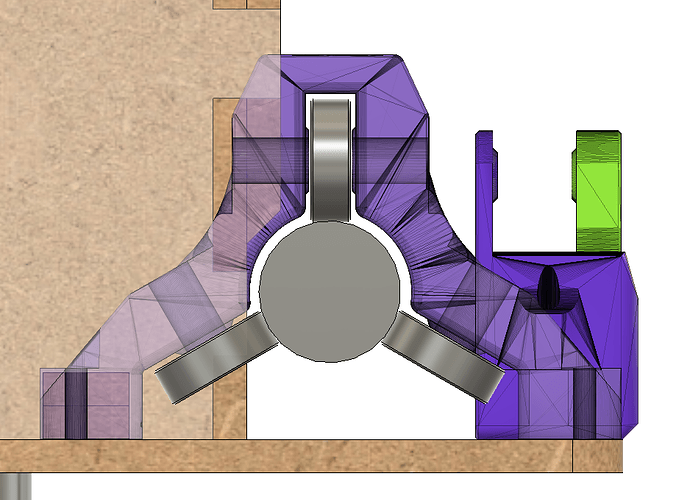

Even with this, the clearance is very tight under this design. I couldnt think of a way to 3D print it in one piece though - suggestions welcome!
  1. Ryan called this part in his designs the 611 plate, so I take that as an endorsement of changing it if you need to mount another router :).
  2. How are you going to make the flat parts?
  3. My work for involves assisting the router up and down. I pull it completely out to change the bits. I drop it down when I am setting up a cut and up when I’m turning it off. You’ll at least want a hole in your table to drop the bit into when you’re done.
I like the way the back panel takes a step backwards to miss the pipes.
no problems to me on changing the internal mounting holes, I just wanted a sanity check that there was no other issues with making the plate a touch wider! The other option was to make the rail spacing wider, which just has so much knock on effect that its not worth it.
The intention for the flat pieces would be to make them on the local makerspace’s x-carve using 6mm MDF. The chamfers will have to be done on a router table, and for the box joints will need some help from a chisle or predrill some mouse holes into the corners. The design will change a little for this spindle to try and reduce weight (not that it will have any real effect but old habits die hard). The chamfered bit was the only way to get clearance! I just hope that 6mm is enough section there for bending.
For changing bits mid job the idea at the moment would be to lift to ~z max and then rest the assembly on a perch (or just full power to the motors), and hopfully have enough space to get to it from underneath. Certainly whilst it is height adjustable with the clamps, at the moment I am thinking just to clamp it once and be done with it. With the way the spindle is crammed in there when it gets changed out for a needle cutter/pen/etc the bolts are all undone from the bottom anyway, so this has to be factored into the design.
W.r.t. the box joints, adding overcuts or dogbones would be easy in cam and wouldn’t hurt the strength enough to matter. Butt joints in mdf would be almost as strong, but wouldn’t give you automatic alignment like the box joints.
I was expecting you to not want to unclamp the spindle, that’s why I mentioned having all that. You’ll probably want a hole where you start the machine (at machine 0,0,0), so you can let it drop when the power is off.
Ah! Now I follow! Good idea.
