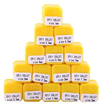

This makes me wonder: should I get the snigle Eclaire 1/8" collet? I’m not sure how many imperial sized endmills we get over here… If so - would this suffice in combination the 6mm that comes with the machine?
Or would I be better of if I bought a set like this: https://www.aliexpress.com/item/915664416.html (I’m not sure if this one really fits the Makita) I assume that the quality of the Eclaire one is immensly better. Would it affect the accuracy and stability of the MPCNC much?

It will make the Makita ER11 compatible.
I will need to cut the shaft back. But it’s easy
ER11 collet means your no longer limited to bit size
Do I need this shank before I get the er11 collets?
