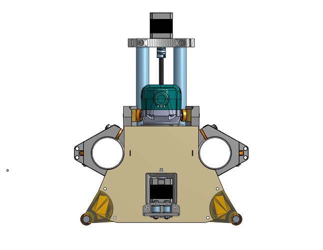

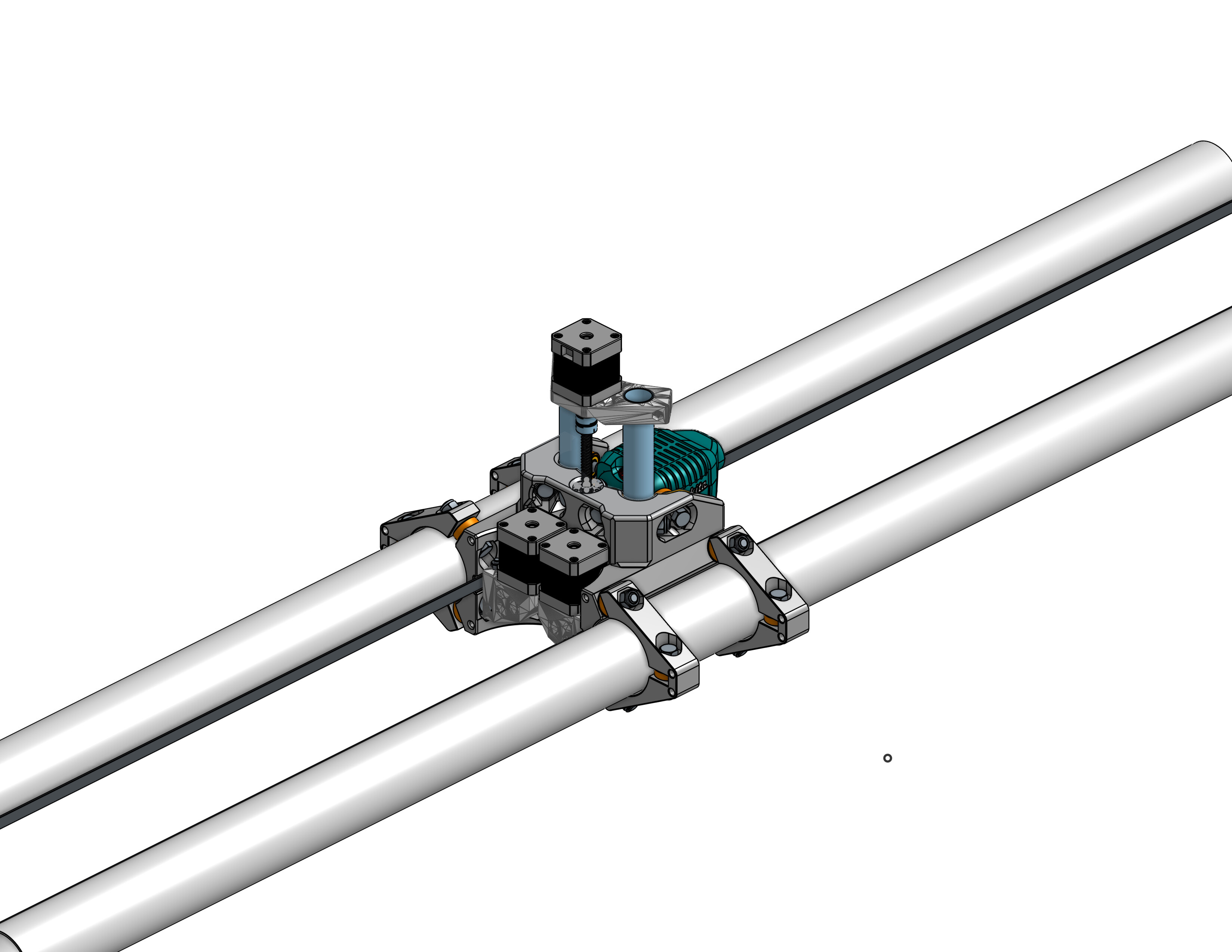

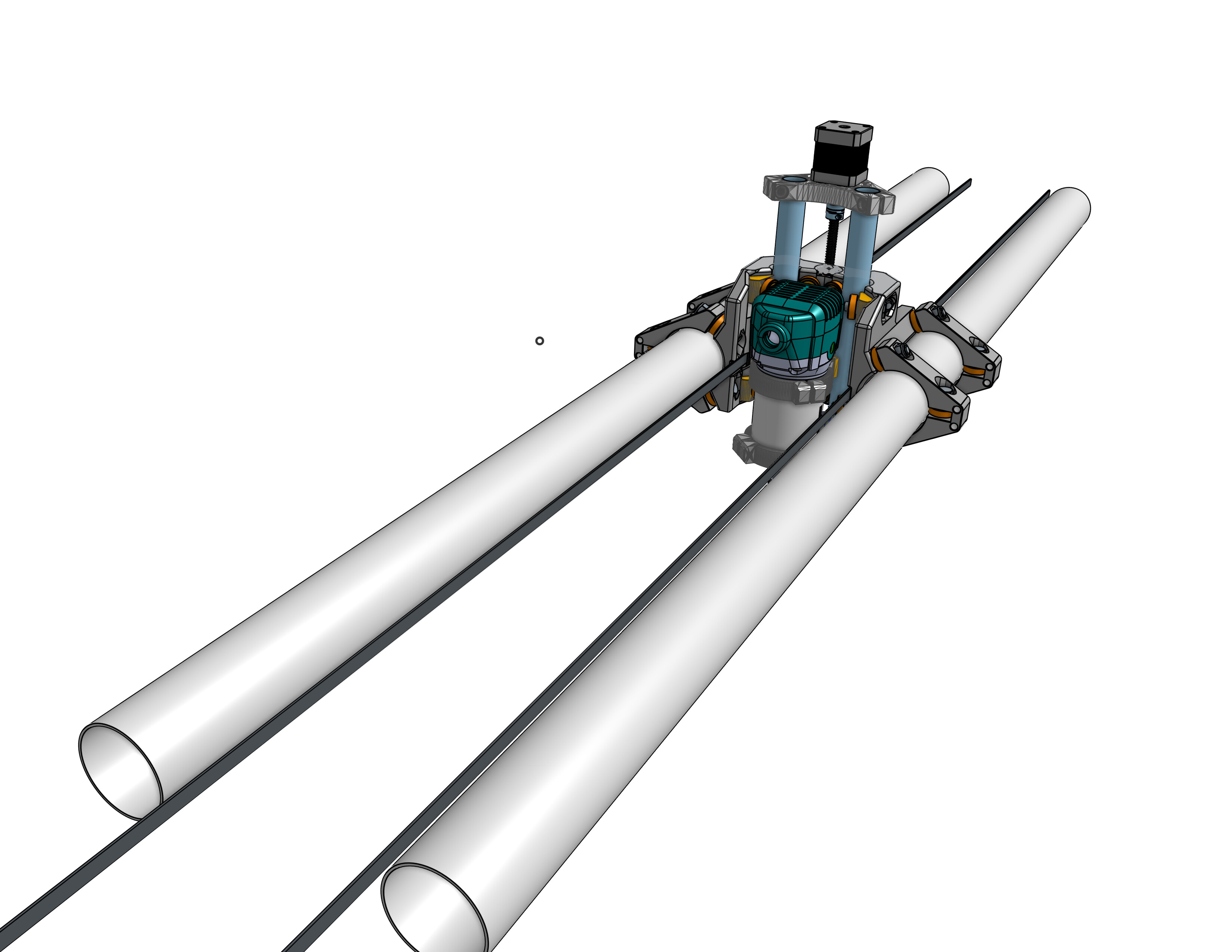

Well, its been awhile since I posted anything, I lurk pretty much everyday but usually don’t have anything worth saying, hopefully this is more interesting!

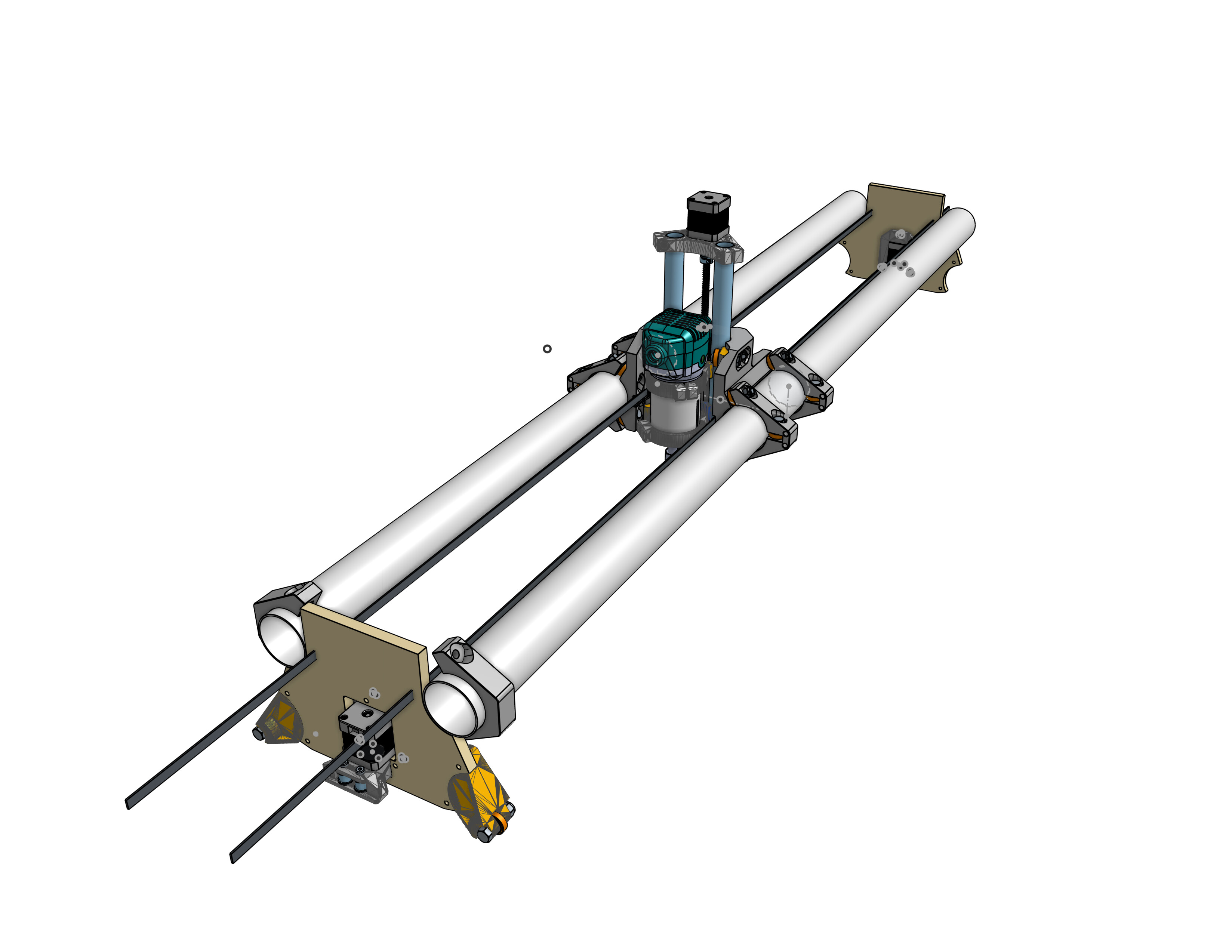

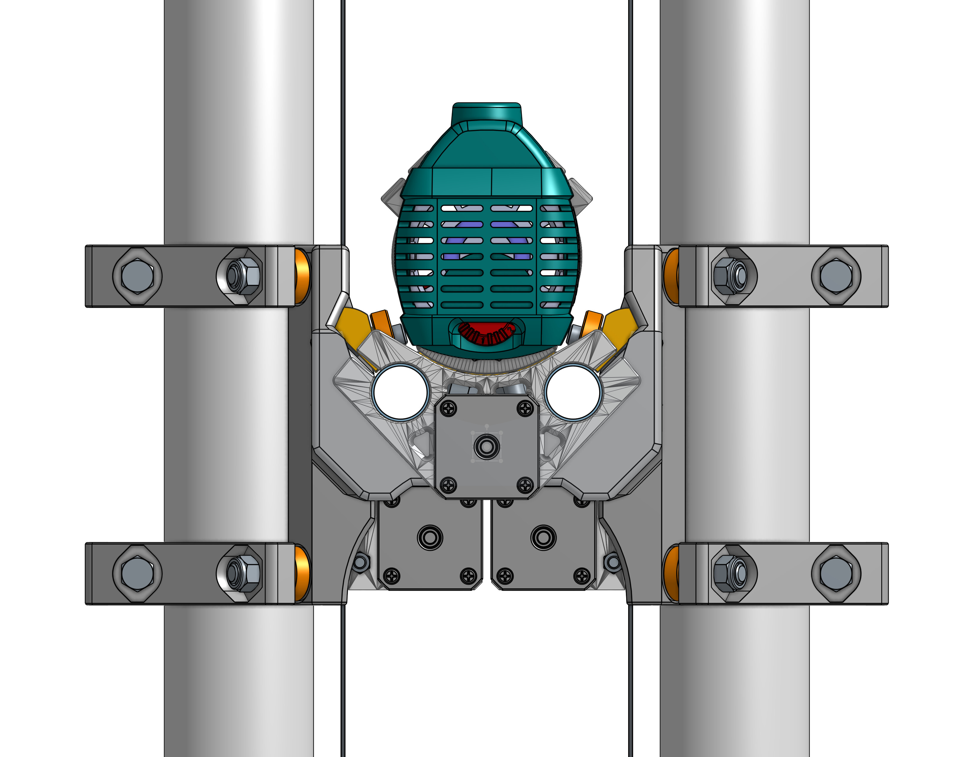

I’ve gone a few years without a functional cnc router and finally ran into a project that could really use one, so instead of doing the sane thing and rebuilding my MPCNC or building a Lowrider, I made a weird mashup of both that uses stuff I mostly have sitting around.
Behold the CNCrab…CrabNC? Idk but it kinda looks like a crab to me.

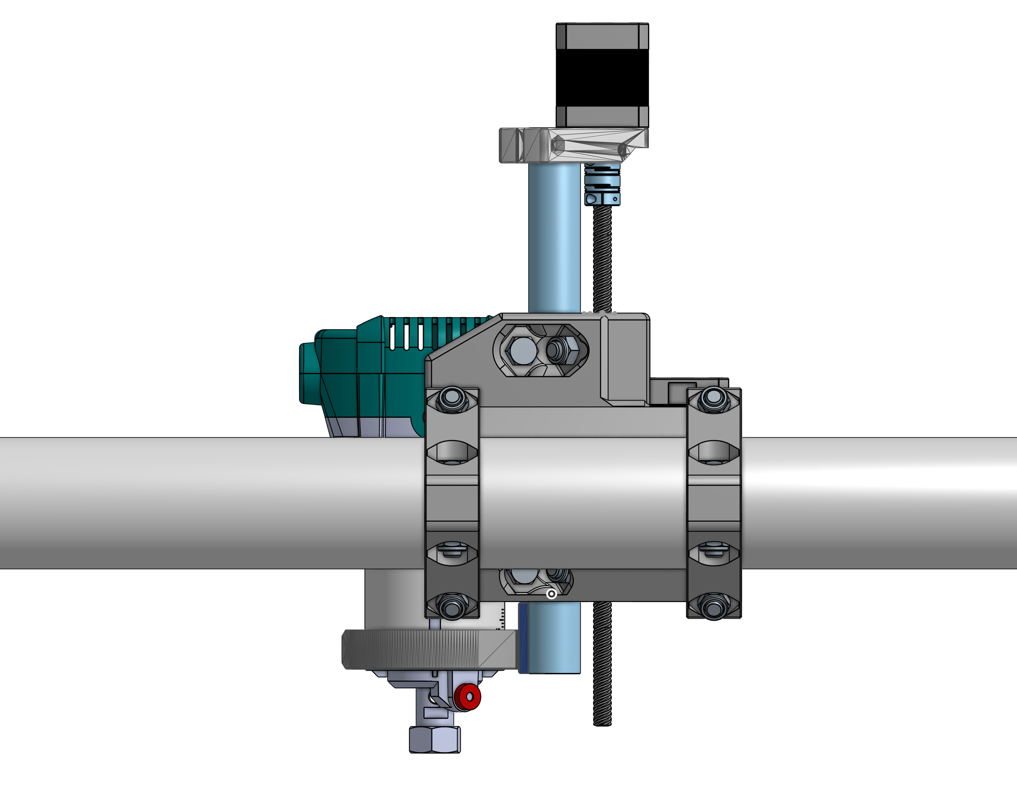

I have some 60mm tubes sitting around from an ikea couch that need to live on in something else, those are the main rails. The rest is as many parts as possible borrowed from the MPCNC or Lowriders. I currently only have the Core rough draft but would like to finish the Y axis ends and have it printing by the weekend.
What do you think? Is this a fools errand? And yes, I know some of the fasteners are facing the wrong way in my assembly…
Cheers! Nate
Should be good with the giant tubes!
That’s the hope!

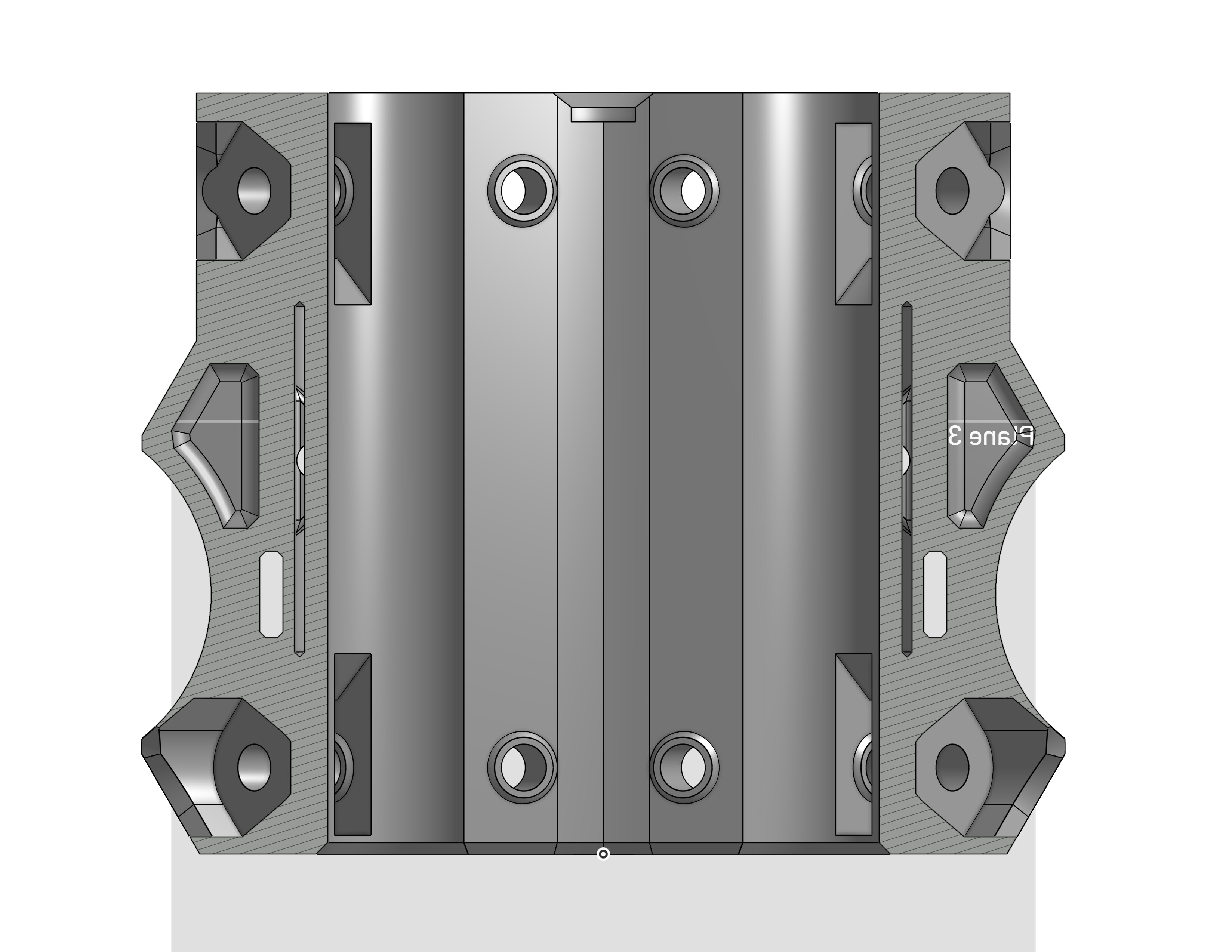

I copied the two round holes in the tube clamps you have on the Primo, I assume they’re to allow some flex there for adjustment, is that correct?
I considered making them two pieces and omitting the connection over the bearing entirely to save some space, is that something you tried with the MPCNC at some point?
Yeah, it seems to make things to floppy, being attached tested better for me.
No those are zip tie holes for misc. stuff.

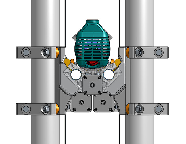

@nate , interesting. Why are you using 2 steppers/belts in the axial direction? Seems like the close distance between the two belts would have minimal auto-squaring effect.
@Bigchepin No reason other than I have them and there was space. Potentially it could offer more torque or another belt routing for a second core.

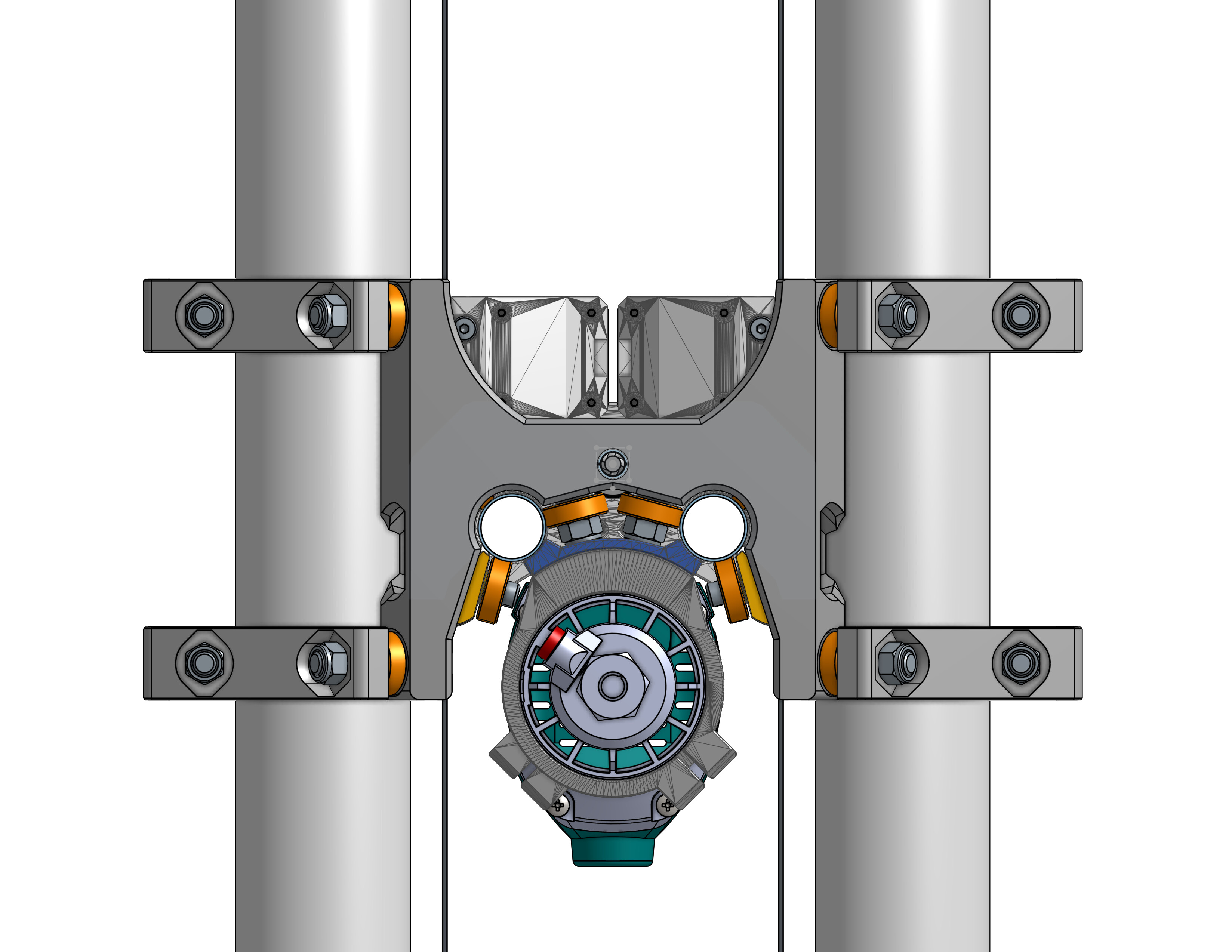

This is as far as I’ve gotten with the end plates, pretty much lowrider 3 derivatives but with the rollers mirrored instead of different prints for front and back.

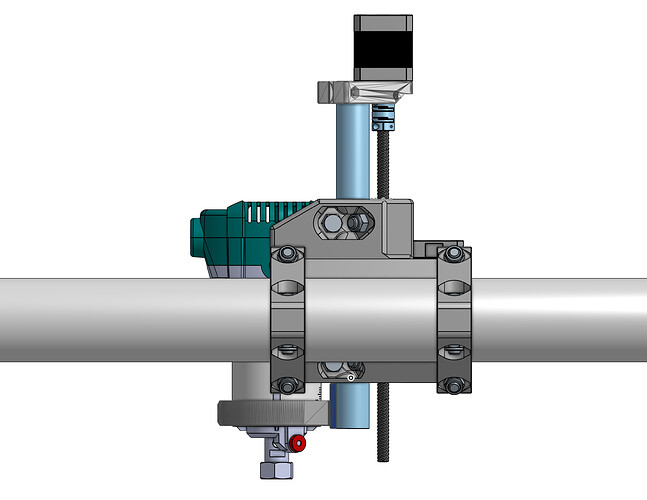

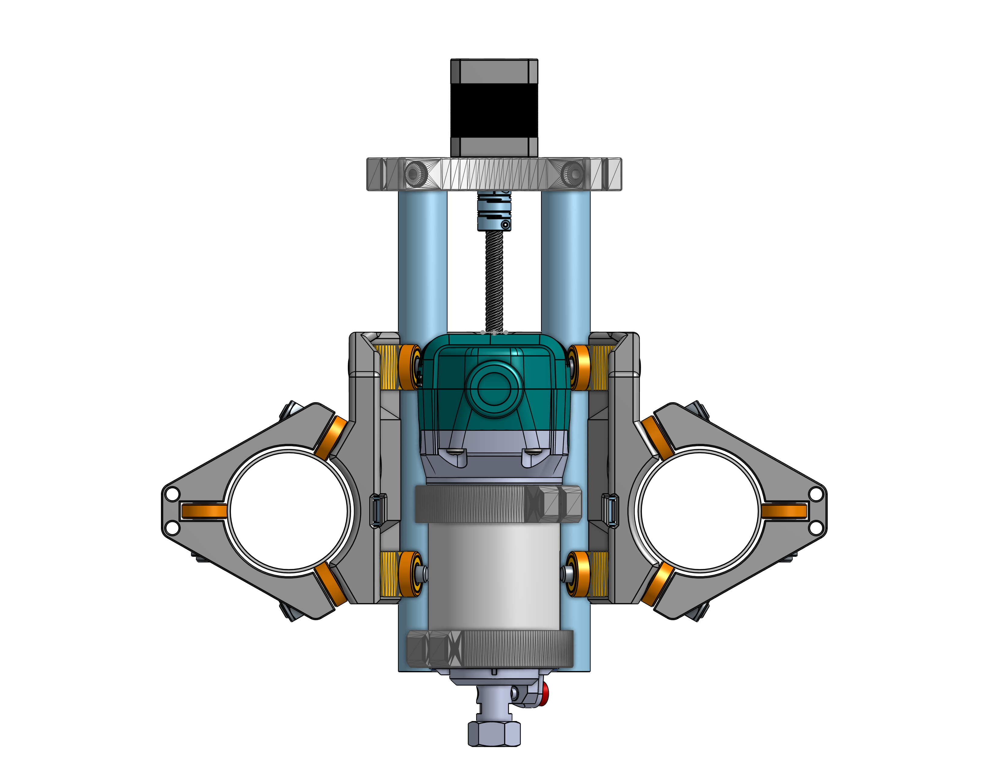

I don’t know, might be easier just to make the LR2 fit the big Tubes. Not seeing an advantage to moving the Z to the moving part. It might be really hard to get the right tension on the primo core Z tubes like that.
I understand the concern and the pitfalls, but I’ve already built a lowrider 2 and just wanted to try something different with what I have laying around.

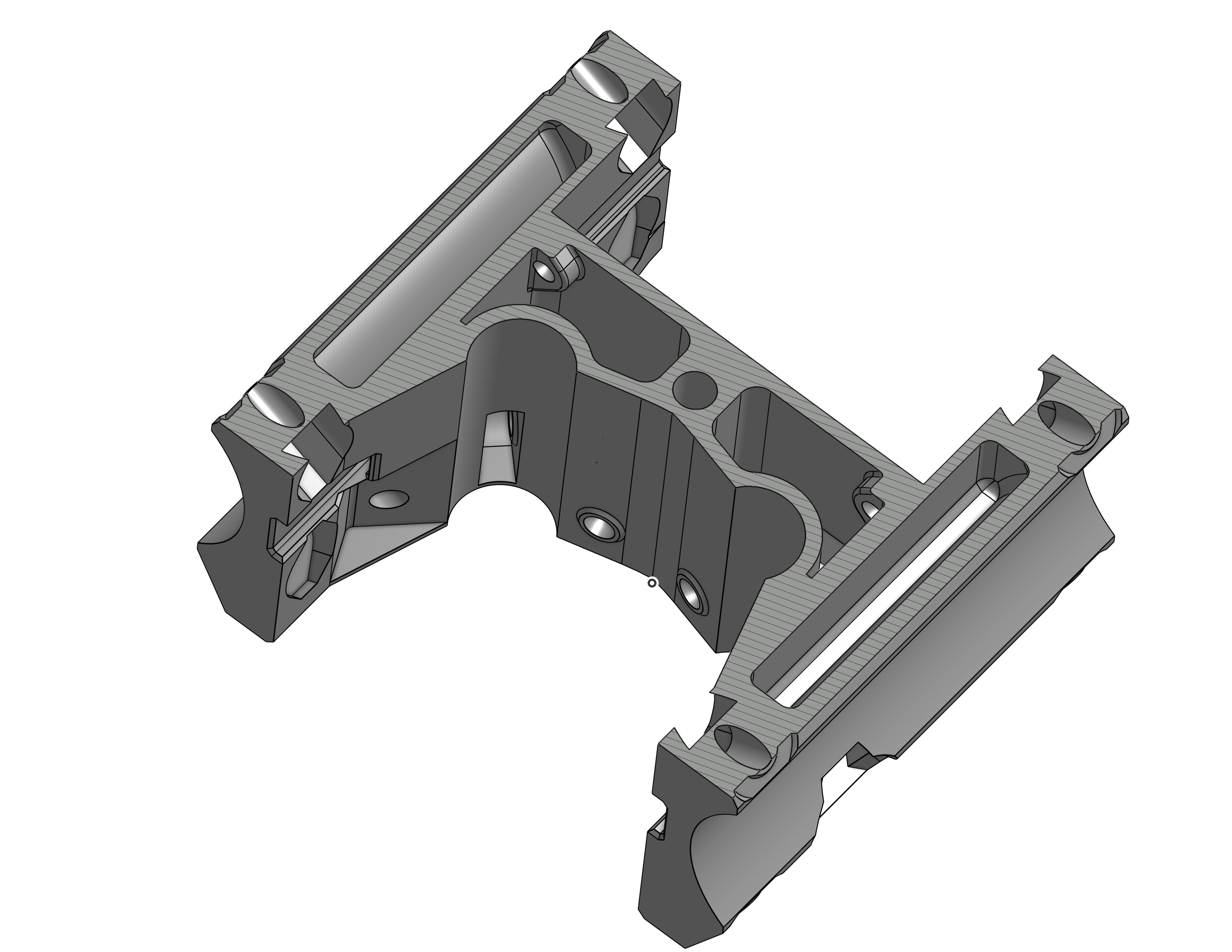

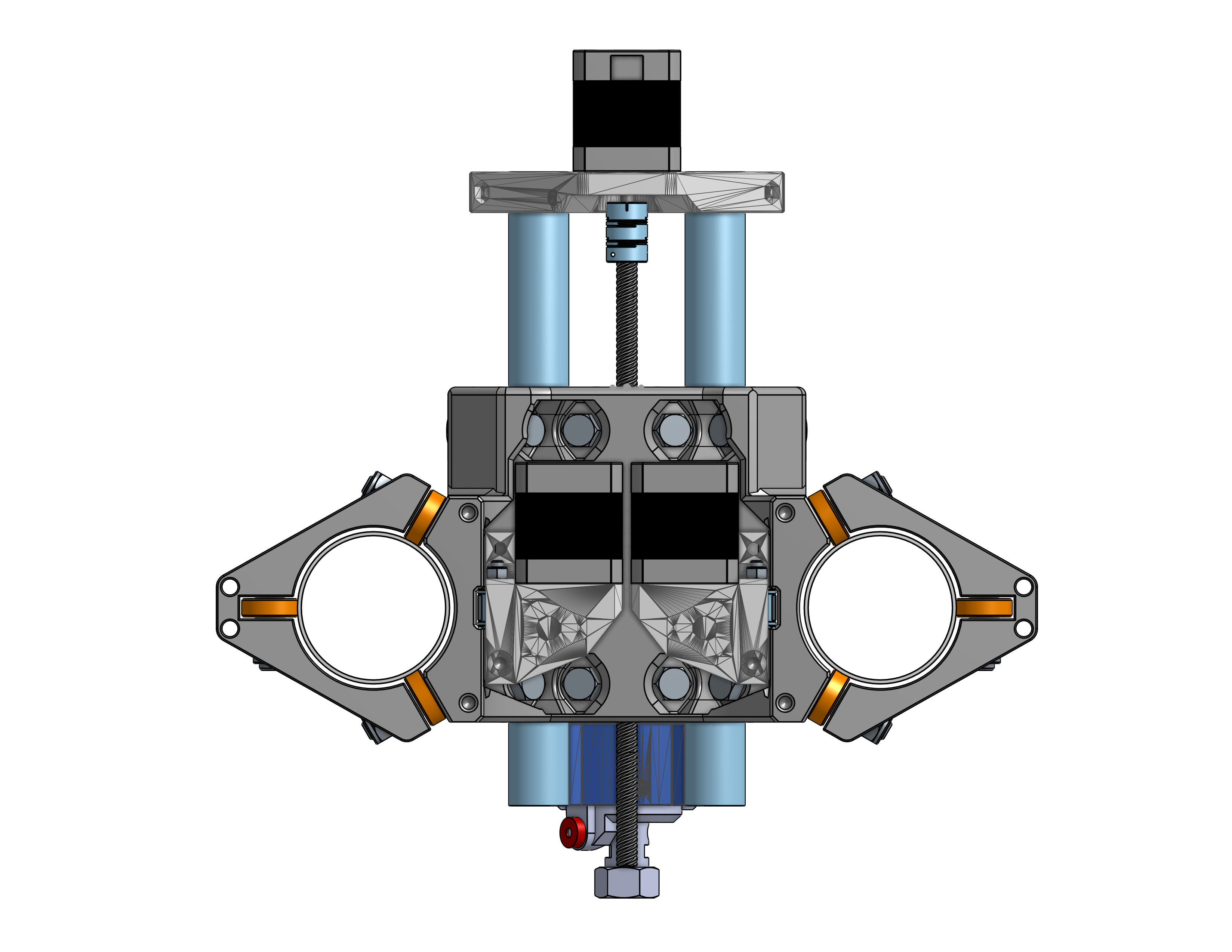

I have added a lot of bracing and cross support to the core around the z axis clamps in the hopes it mitigates the issue. I’ve also done some internal geometries as well. I’ll throw up a cross section when I get a chance.
Too bad I gave away my stainless steel lowrider years ago :face_with_diagonal_mouth:

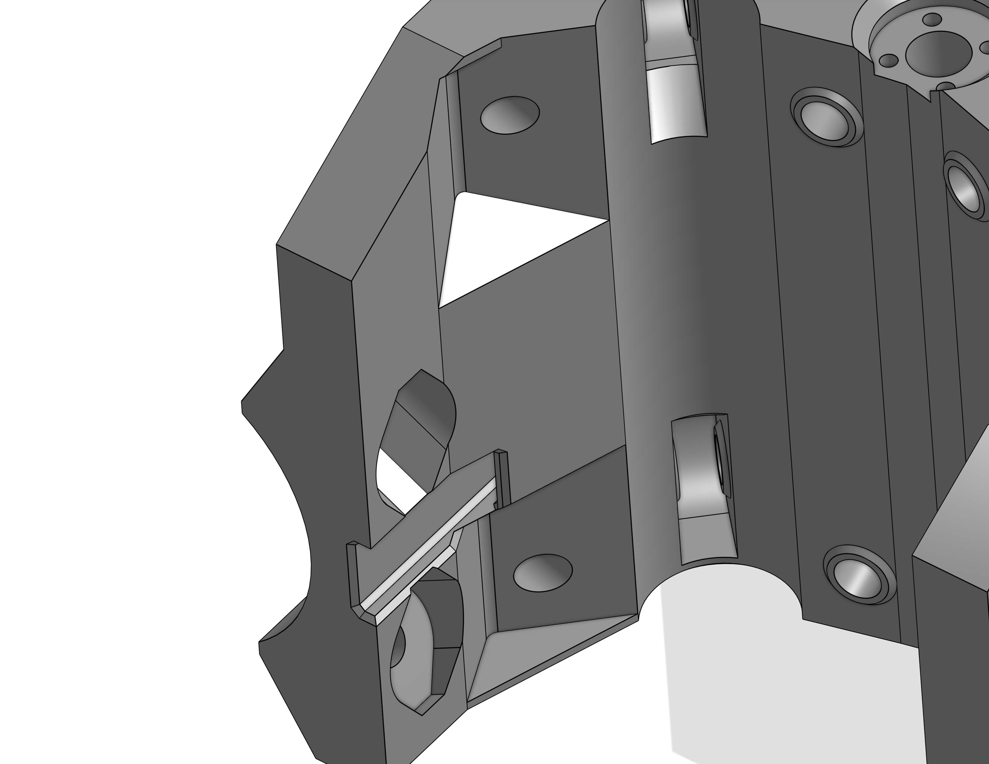

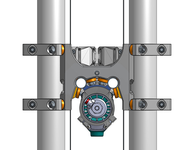

Here is the extra bracing in the middle and bottom of the core around adjustable z axis bearing.

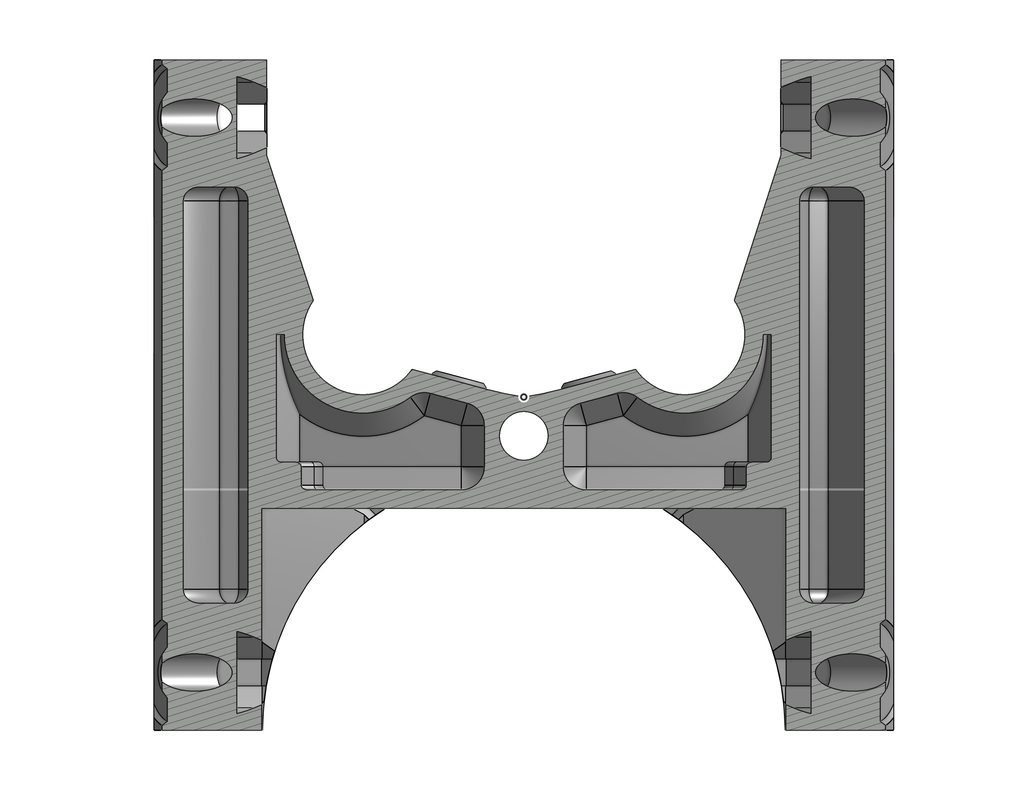

Here’s a cross section showing the areas I hollowed out to promote more perimeters when slicing, I probably could have taken a lot less and enforced higher perimeter count for these layers, its just an idea I’m playing with that’s worked for other stuff before.
I also have a bolt pattern on the back side of the core behind the x motors for a cross brace if necessary.

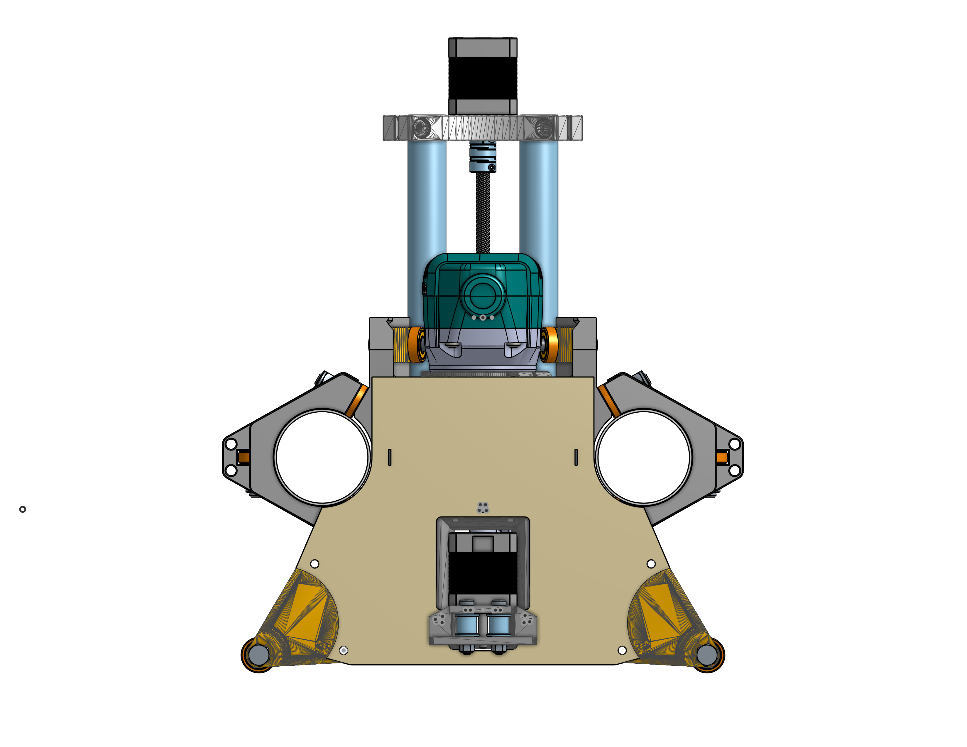

Your pictures are showing 2-Y, 2-X, 1-Z, are you going to skip one of the X axis steppers?
Most likely to start with. I guess I could run both off one driver, I know at one point that was being done with the MPCNC but that’s obviously for a ganged axis instead of more torque.
I really just stuck it there because I had the space, symmetry and flexibility later on.

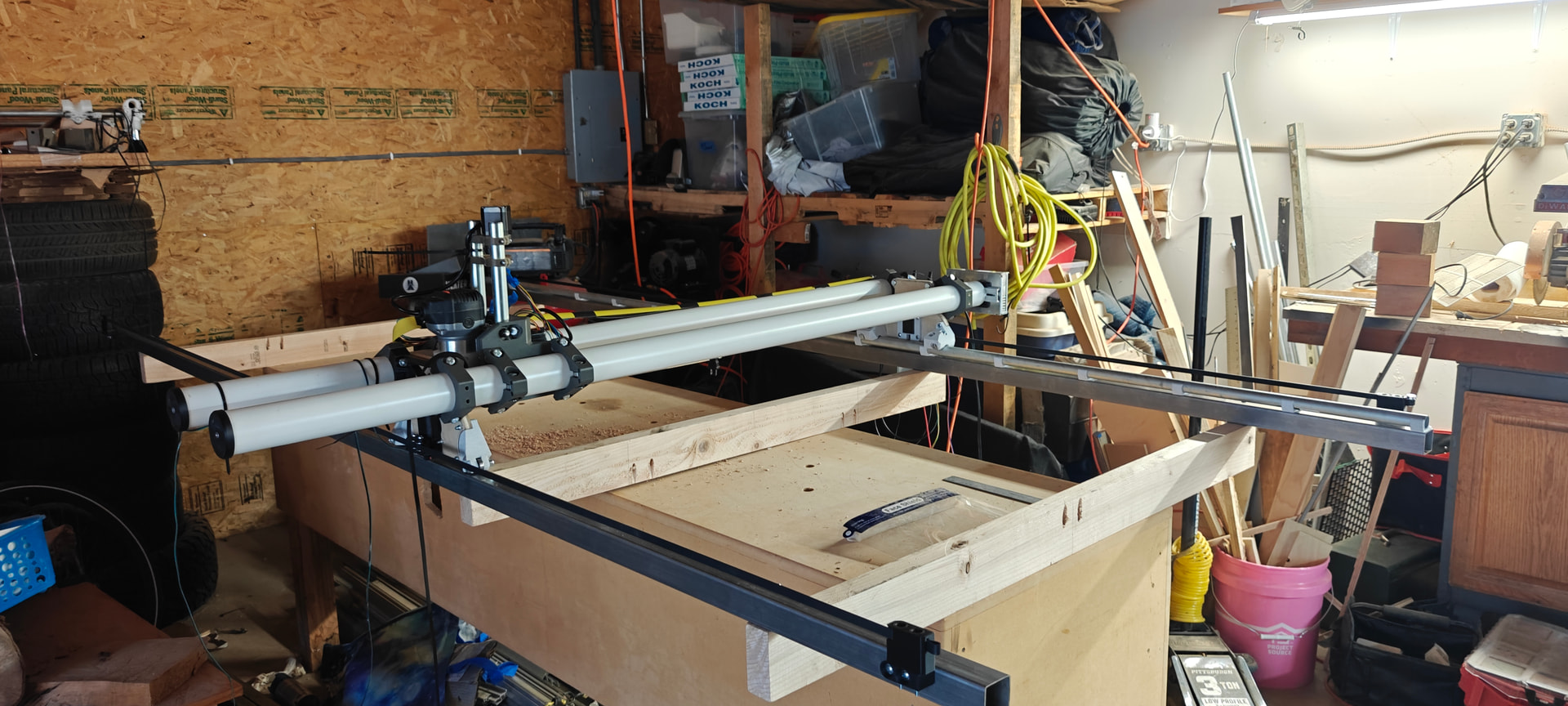

I’ve made it a little further along, this config will be temporary, I need it for a job asap so I fired up the printers and tossed it together.

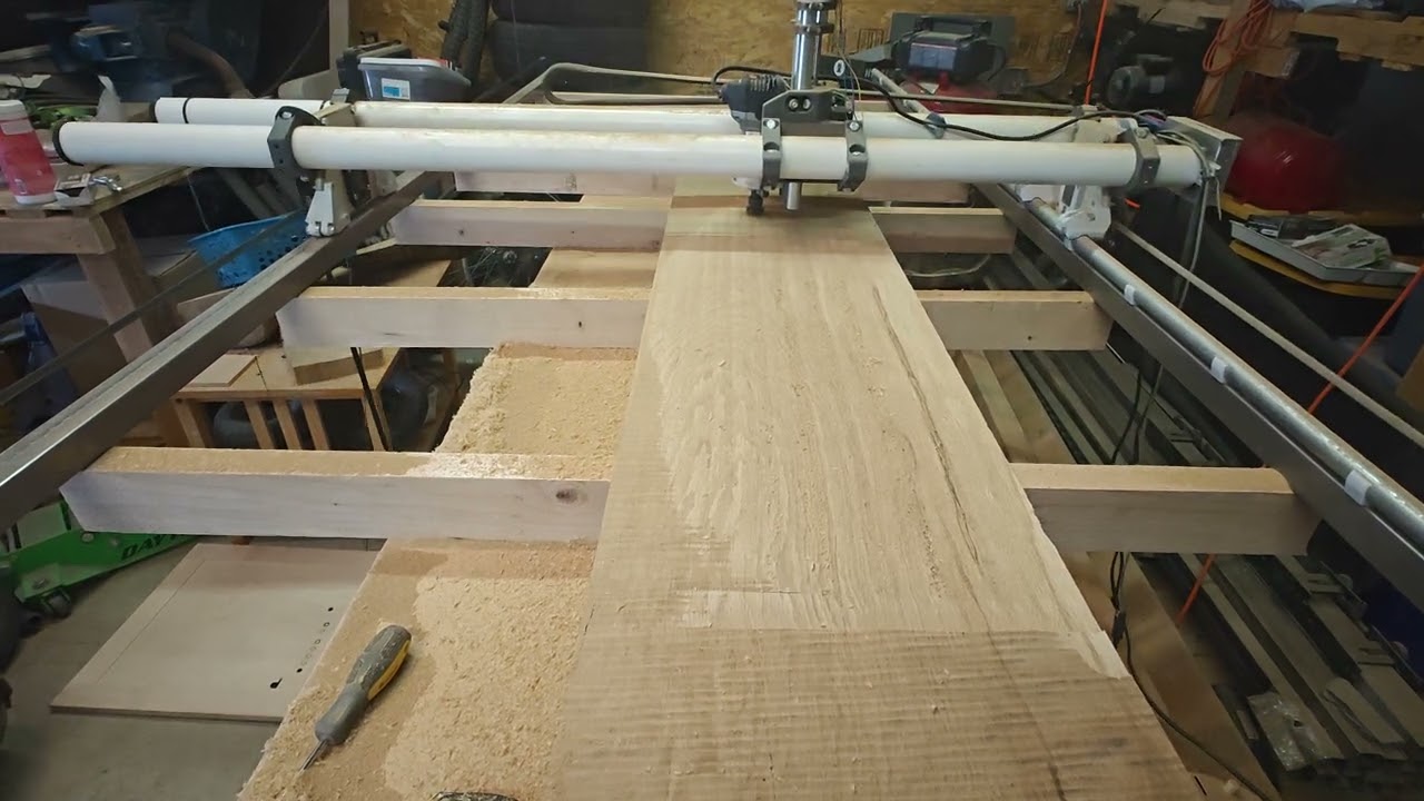

10ft 1.5in steel rails on a free table from the cabinet shop next door, I needed over 36 inches of x travel for this job so that’s why it has the 2x4 wings. I’ll probably run 6-8 wings and an mdf top. Primary application will be milling a bunch of white oak slabs for countertops.

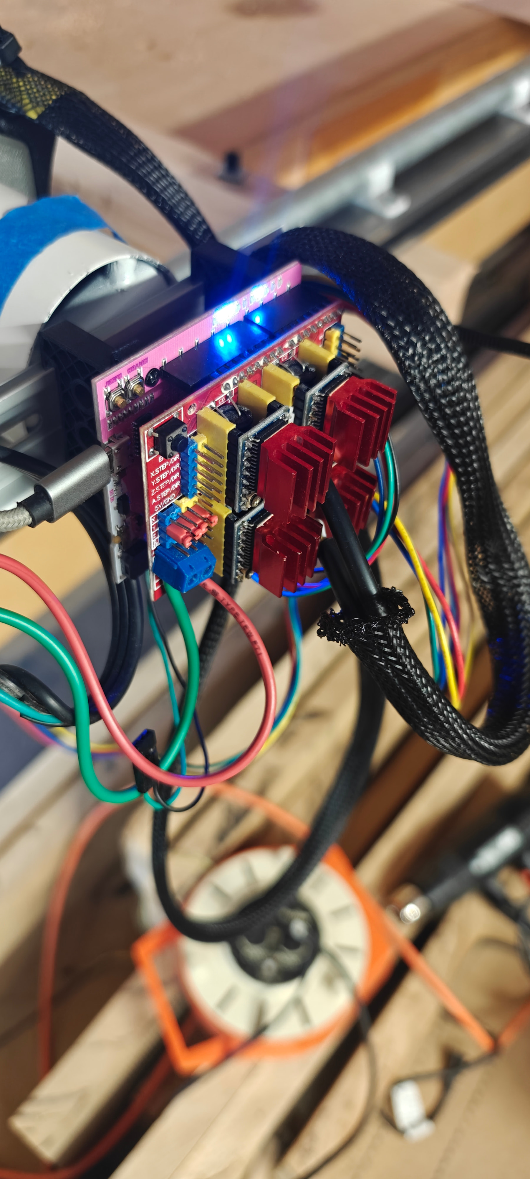

Currently having issues with the SKR PICO, at first it would intermittently connect, then it was a total crap shoot, now after reflashing it a few times with limited success it seems to be dead. Maybe I got a dud with faulty memory? who knows.
Its crunch time for this job and I have a gecko g540 and Expatria PicoBOB sitting around for a mill project so I’ll be tossing that on it today with GrblHAL.
put it to work immediately.
Ended up running it on an uno/cnc shield I had instead of fiddling with the g540. I’ll probably go with either a jackpot or a bart controller moving forward.
for more than surfacing I’ll need to finish the table, but its doing work so I can’t complain!
