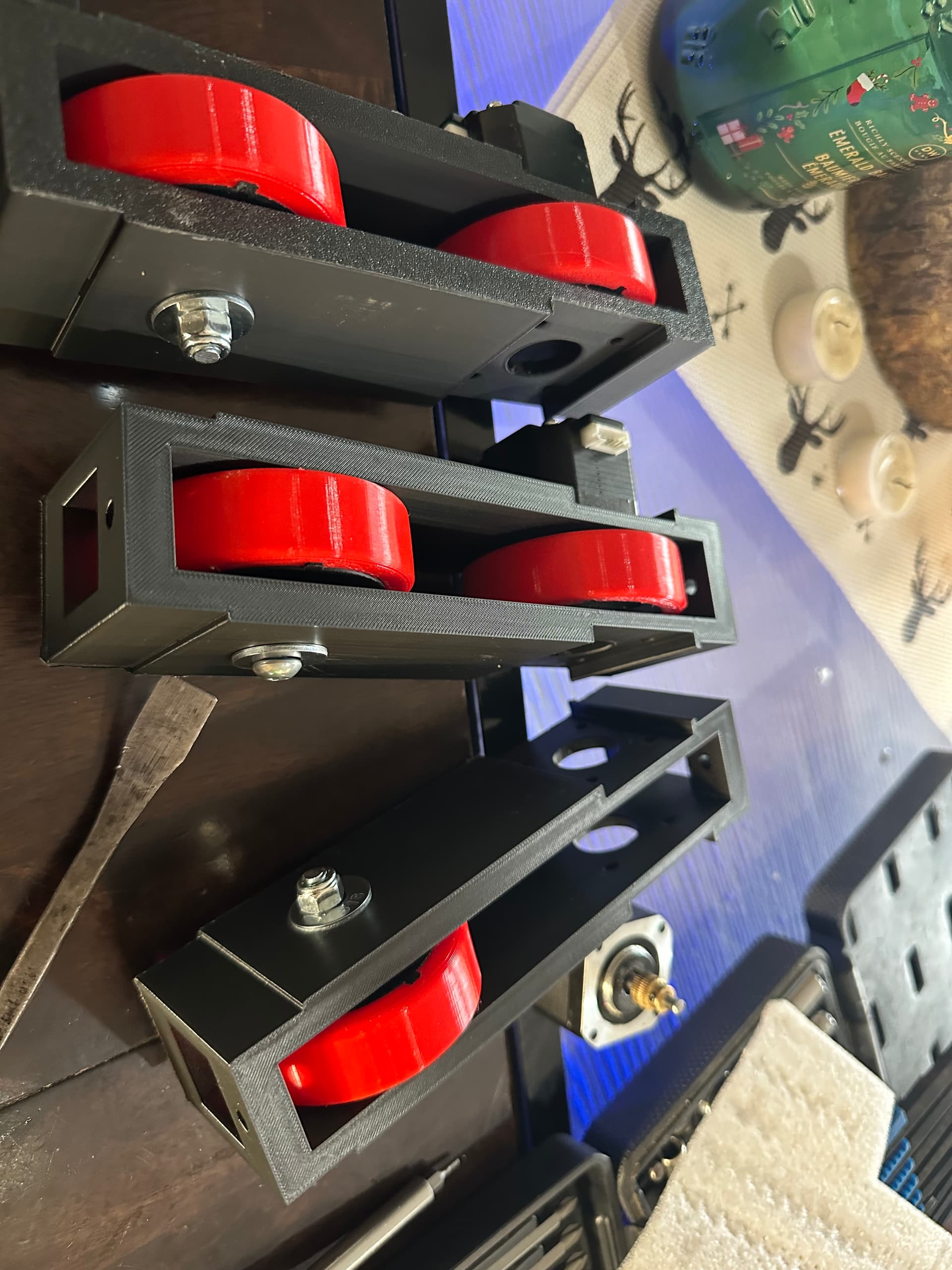

I have a semi finished prototype that I have been working on for quite some time refining. I have the truck or tube slider parts made but the rotating drum assemblies I will have to add a gt2 belt profile to them so I don’t have slippage and I can rely on it being accurate.

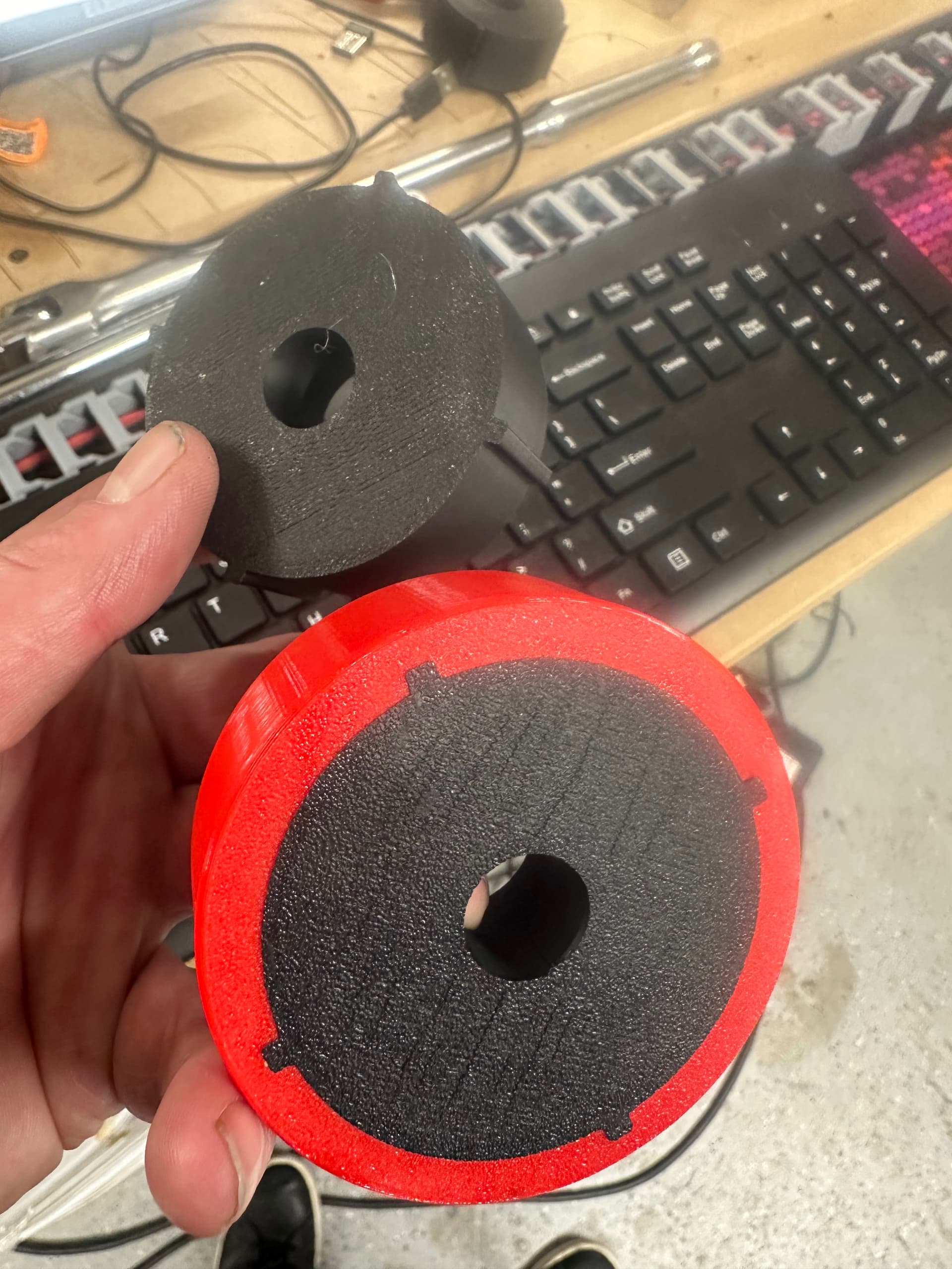

Small update, manually made some gt2 gears for my tube roll axis man that was a pita only to find out it was some glitch and the gears workbench worked on my other comp :frowning:
Oh well. I did get 3 axis to move together so I am going forward for testing

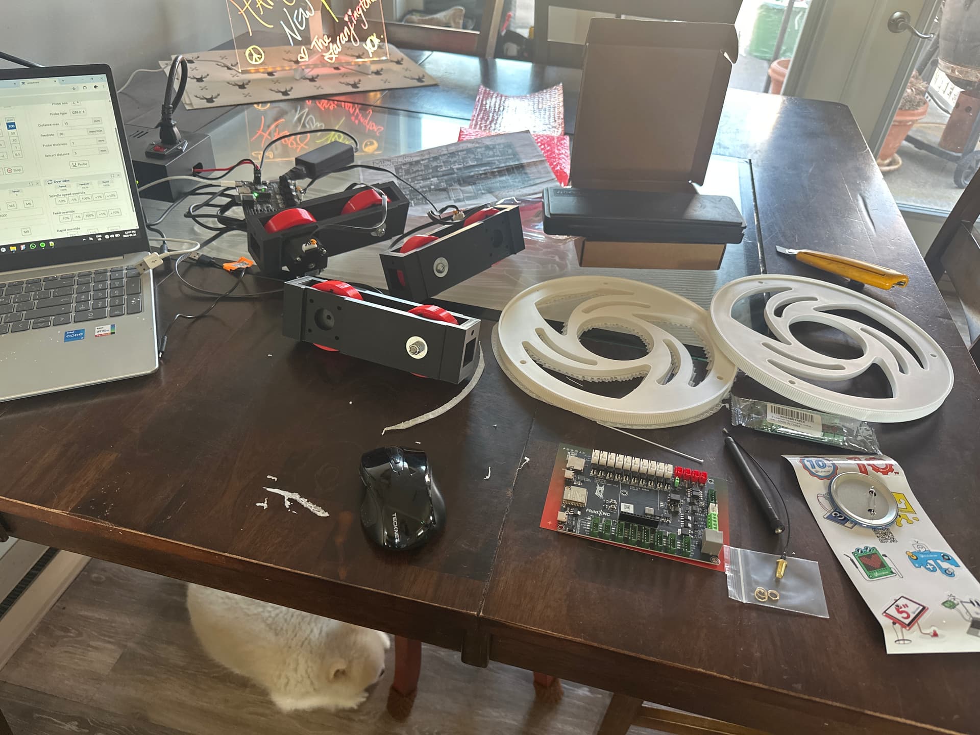

I did get the Doberman fluidnc board in and my dog isn’t happy. Very neat board and one of these optocouplers as well. next on the list is to put my inserts into these gears and bolt them together and figure out the inner pipe clamp portion.

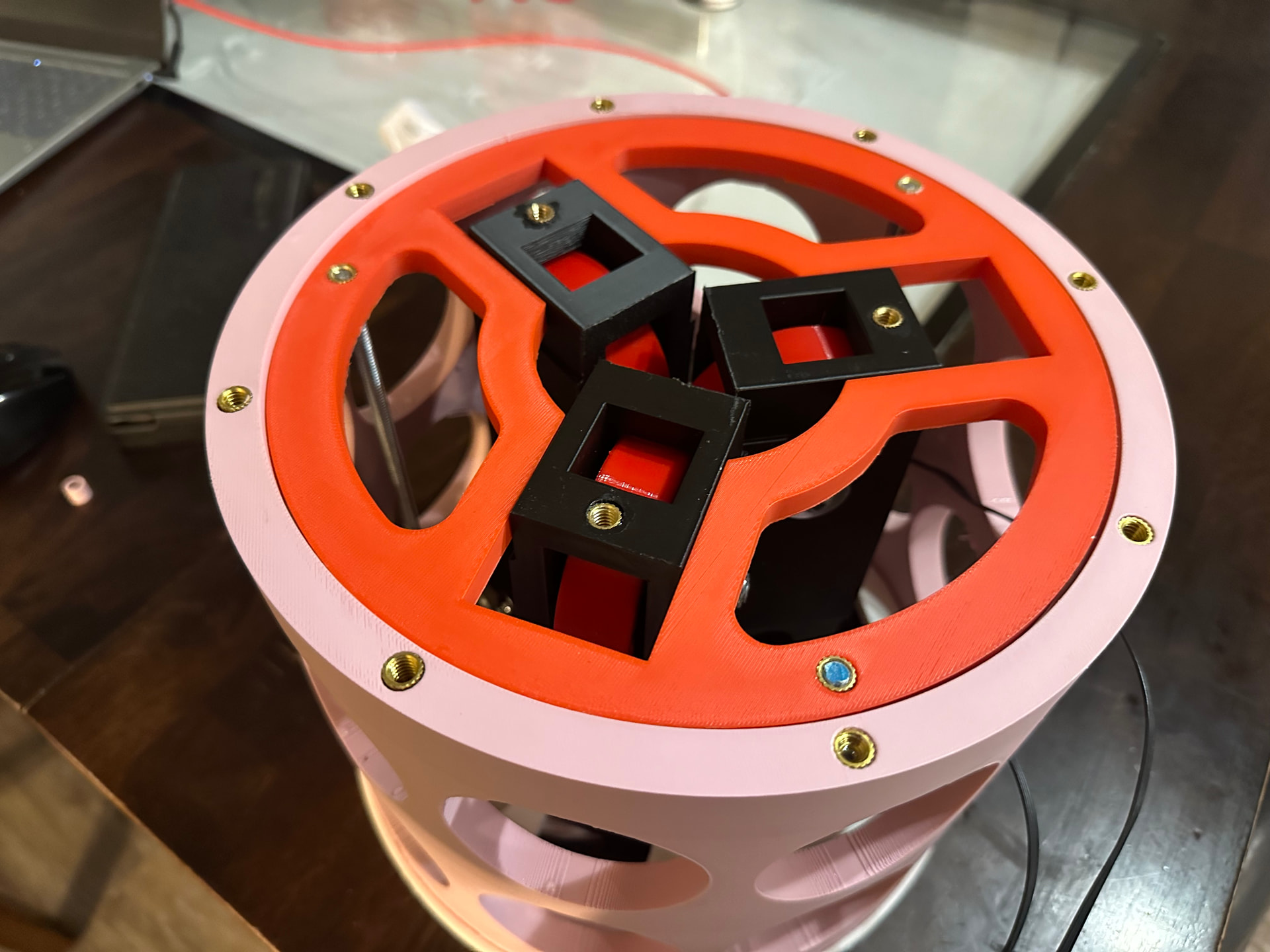

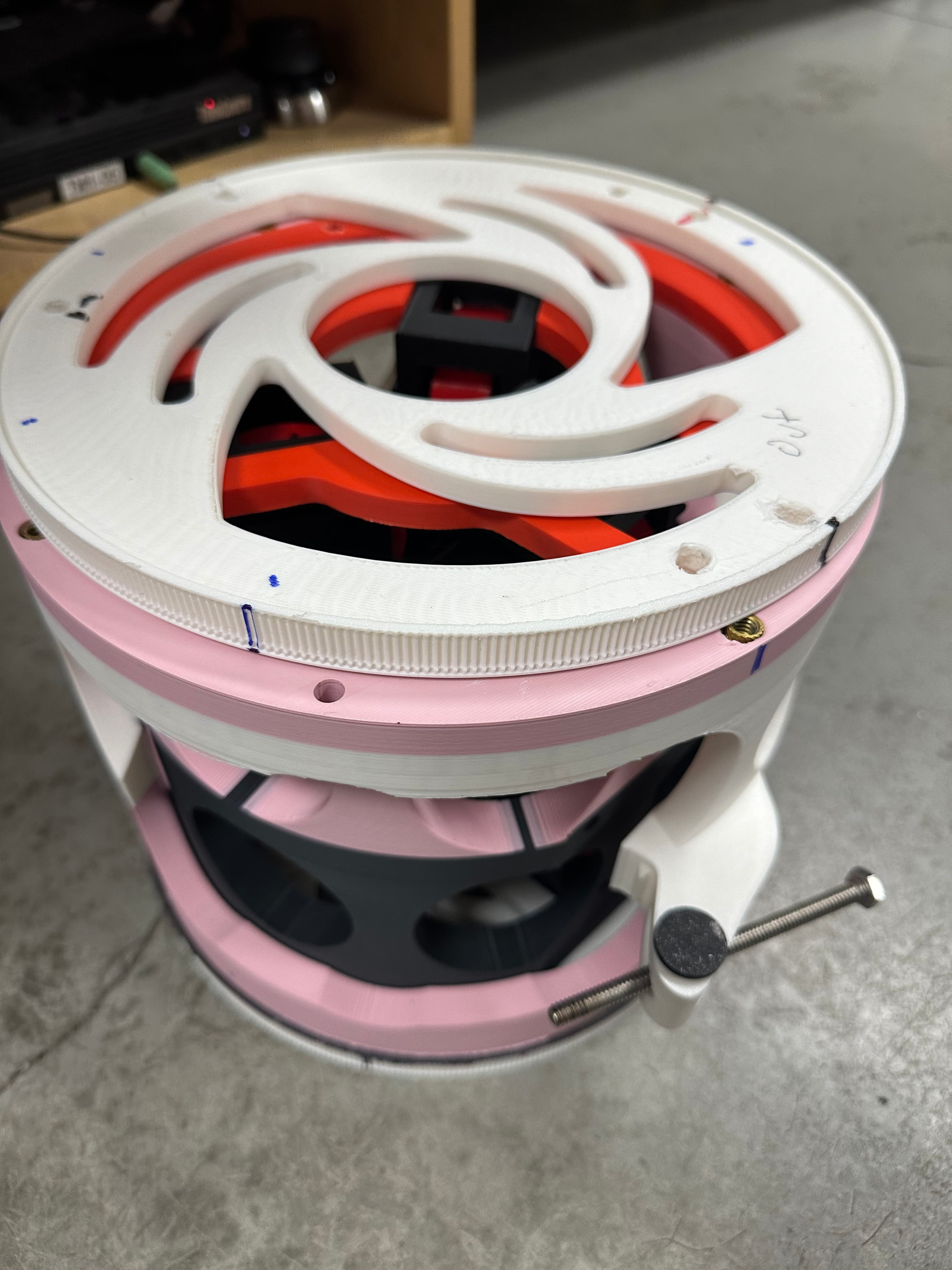

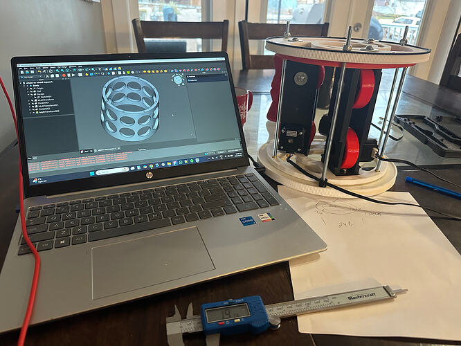

Trying out a support cage instead of support rods. Should be more stable and take up the cap between the inner rotor and outter. Some graphite will help I bet with friction.
Also man it’s hard to hold this thing and move it while recording.

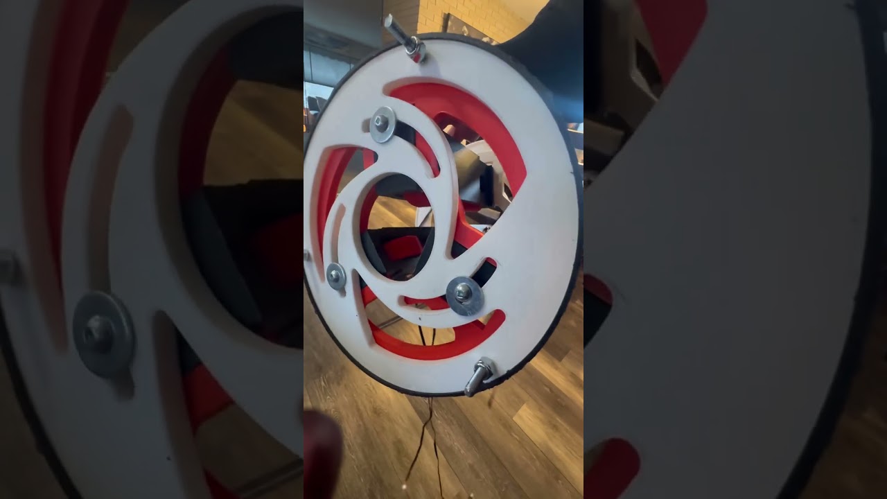

Support cage was definitely the way to go so much more solid and will take up the gap between rotors for smoother action.
I think I will do this for the inner rotor as well.
Now I need to figure a way to tie the two rotors together and adjust it to clamp the tube. I am thinking I will use the holes in the cage and have a sort of plug with a captive swivel nut .
Well I am in the middle of learning what I should have done a long time ago in free cad.
Assembly oh boy it should save a lot of print time and waist.

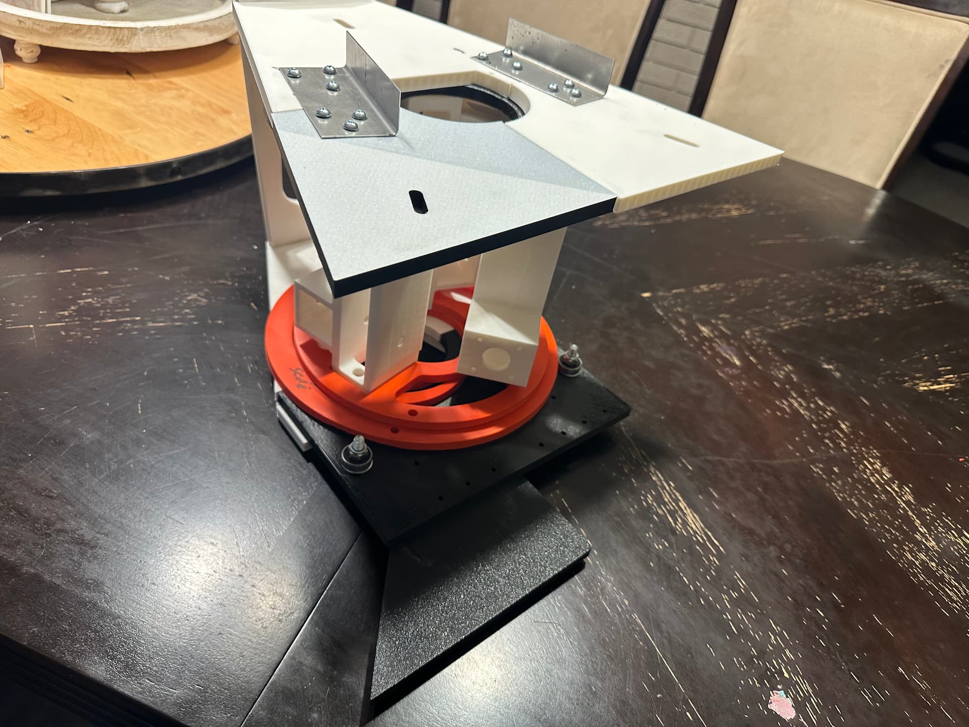

Here is a latest pic it’s getting closer each time.
