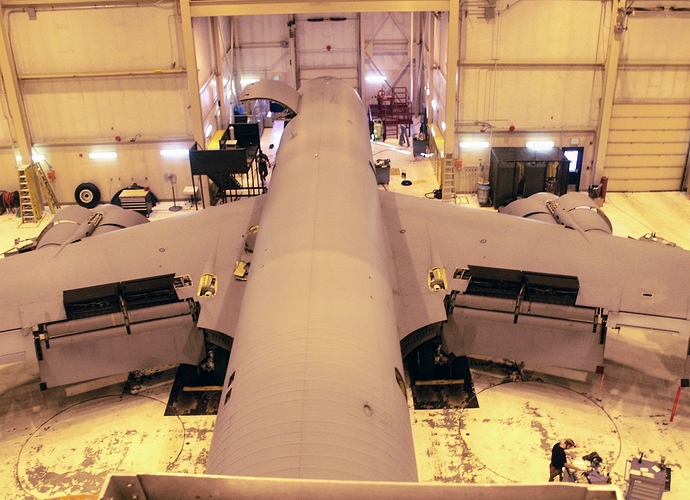

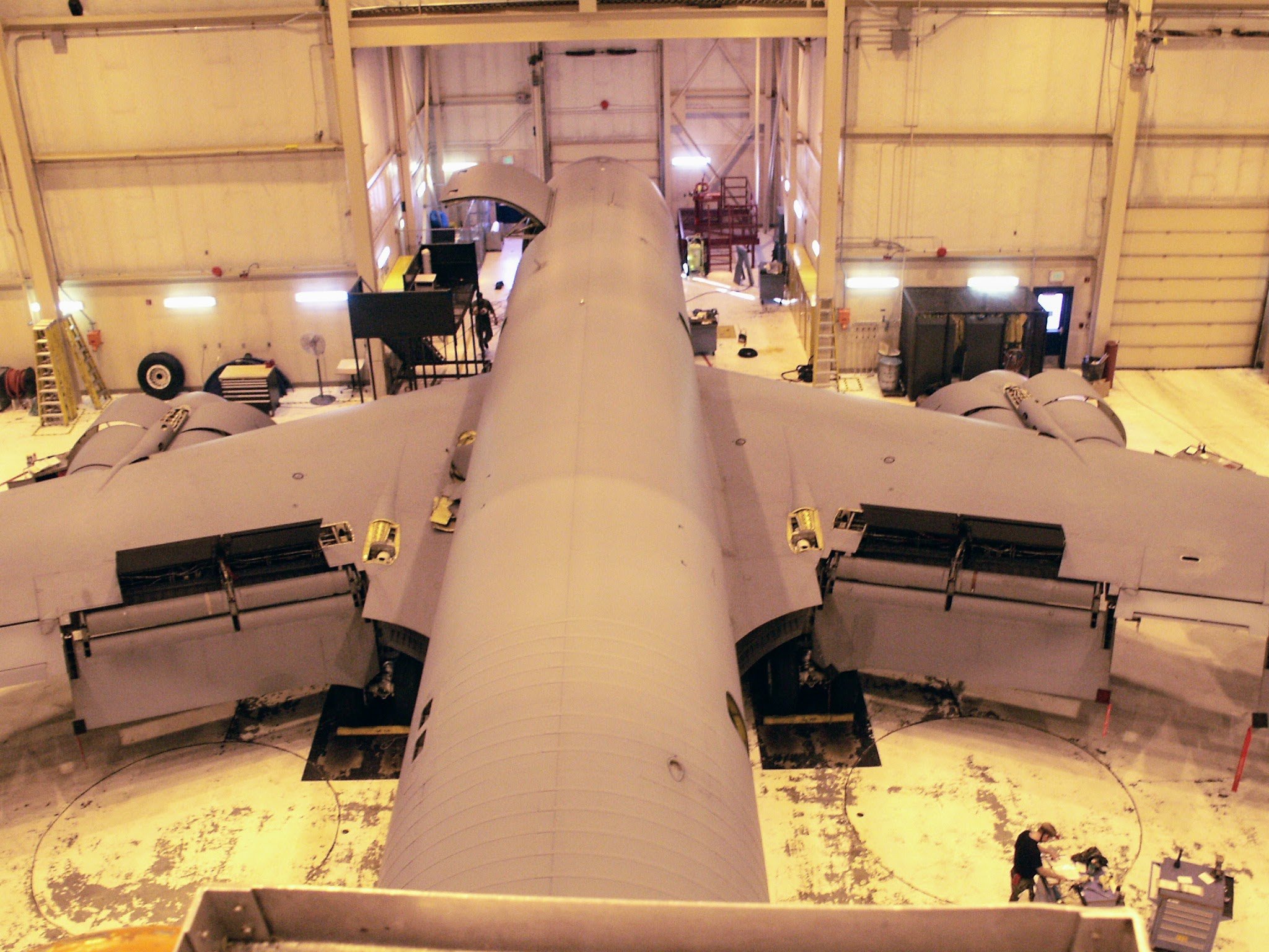

Even the commercial flame detection systems don’t work sometimes. We tested ours in the hanger when it was installed. Four foot by five foot oil drip pan in the middle of the hanger, add some old rags and a liter of gas. We had six foot flames, detectors didn’t trip. They rejiggered for a while and they would trip. Flash forward 6 months and the extinguisher cannons fire with a plane in the hanger, no fire, no smoke, they just went off. By the time the fire system was shut down there was eight feet of suppression foam in the hanger, this isn’t a small hanger. There was a KC-135 in there at the time, that’s a Boeing 707. FODded two of the engines out, the cannons shot rusty water straight down the intakes, the other two had foam in the bypass areas, but didn’t seem to get any debris in the cores.

So yea, don’t leave them alone for very long.
