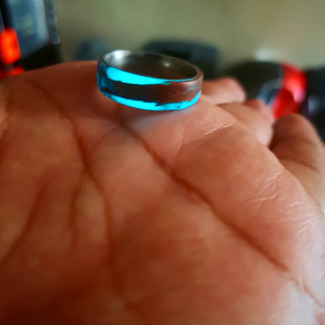

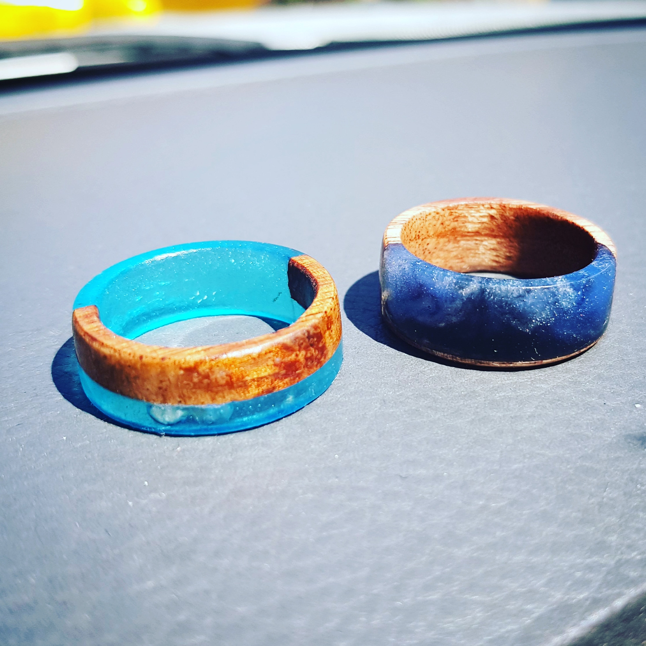

Wooden rings are easy, it’s literally two circles, but you will still have to true them up by throwing them on a drill and sanding the outside, or making a makeshift lathe on the drill like I did.
The easiest way to do a laminated ring, IMO, is to wrap it around a ring core you can get for a few bucks on Etsy. Titanium, stainless, Sterling silver, carbon fiber, etc. You can also cut the core from wood and then wrap veneer or shavings from a plane around it. Solid wood rings are pretty weak, so this gives it some strength.
I 3d printed one a while ago. I sketched the cross section in xz, set it away from the origin by the radius length, then revolved it around the z axis. Didn’t look anywhere NEAR that nice, though!

Nice rings
