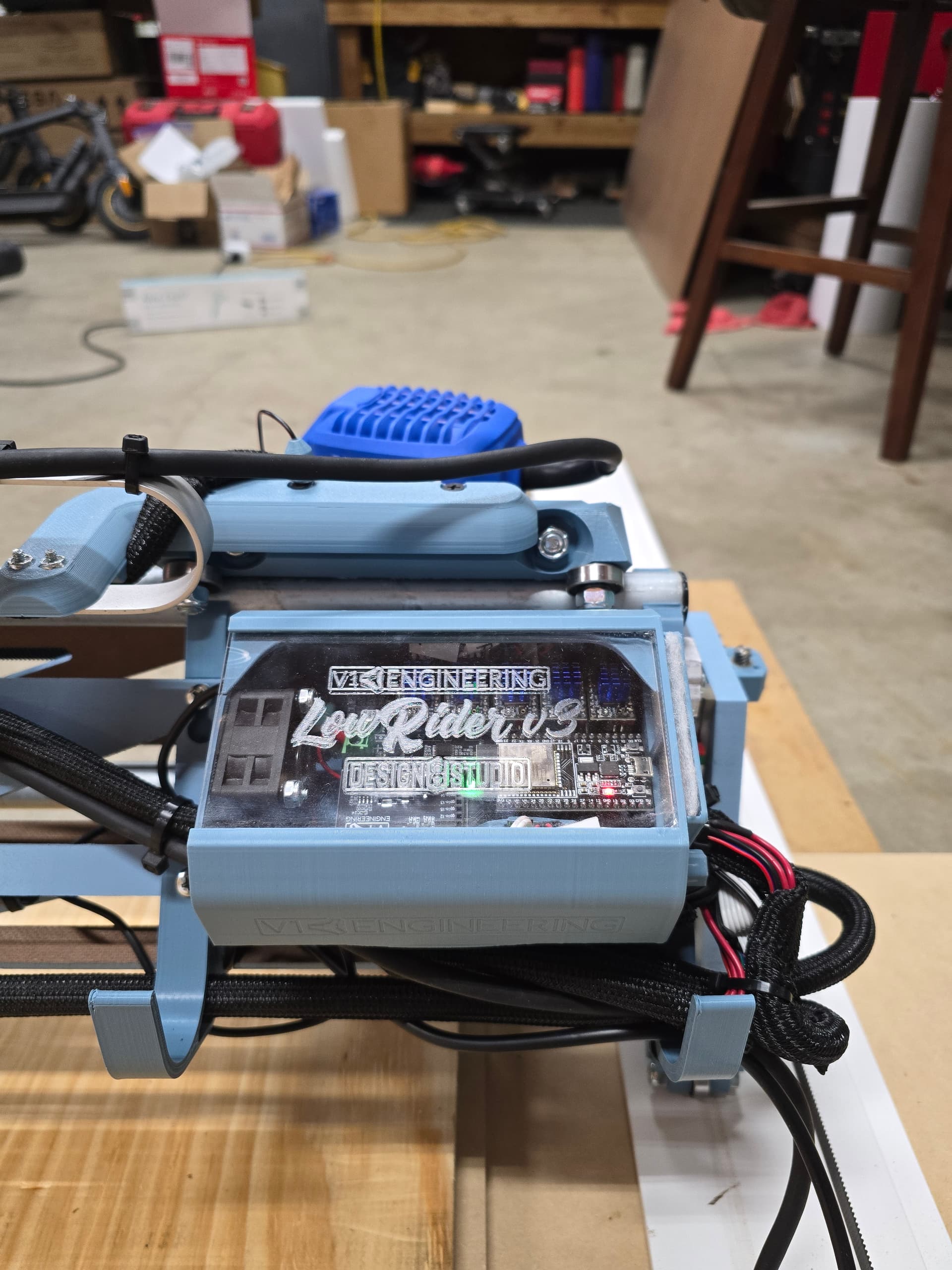

Hello all. First post here. Just completed my first Lowrider 3 build and have had great success up till now…
I am using Estlcam, and the lowrider 3 is equipped with a jackpot board (everything bought from V1).
I have successfully cut out the struts as well as a few other items, but on the latest attempt to cut out a torsion box table, I am having the problem that I have not been able to troubleshoot myself.
After jogging machine into the desired start position and beginning the job, it probes just fine. After probing though it will appear to begin running toward the start point, but will overshoot and continue until the steppers start ratcheting as the machine is “out of bounds” off the mdf spoil board.
I assumed it was a corrupt file or I failed to select a proper “Zero” in Estlcam so I rebuilt the file again and verified all was correct. It continues to produce the same failed result. I looked at all my settings in setup and they all look good to me and have worked fine in the past few cut jobs so I am at a loss as to why it would act this way?

looking at your gcode and its first move is to X12610 Y10271… That makes me think you might have imported into estlcam using the wrong unit of measure. Did you import something that was designed in mm as inch?
When you did your cam did the colored lines show up super tiny in estlcam? Another thing you can do is enable the grid. I usually set mine at either 25.4x25.4 or 304.8x304.8. So that gives me a grid of 1" x 1" squares or 1’ x 1’ squares. Either way I can easily get a visual if my part is looking the right size or not.
Thank you Jonathan! Not sure why I overlooked that, but that was it (Newbie here). I imported the file in MM and it works just fine now. I am implementing your suggestion to apply the grid as a double check that the object size is correct.
