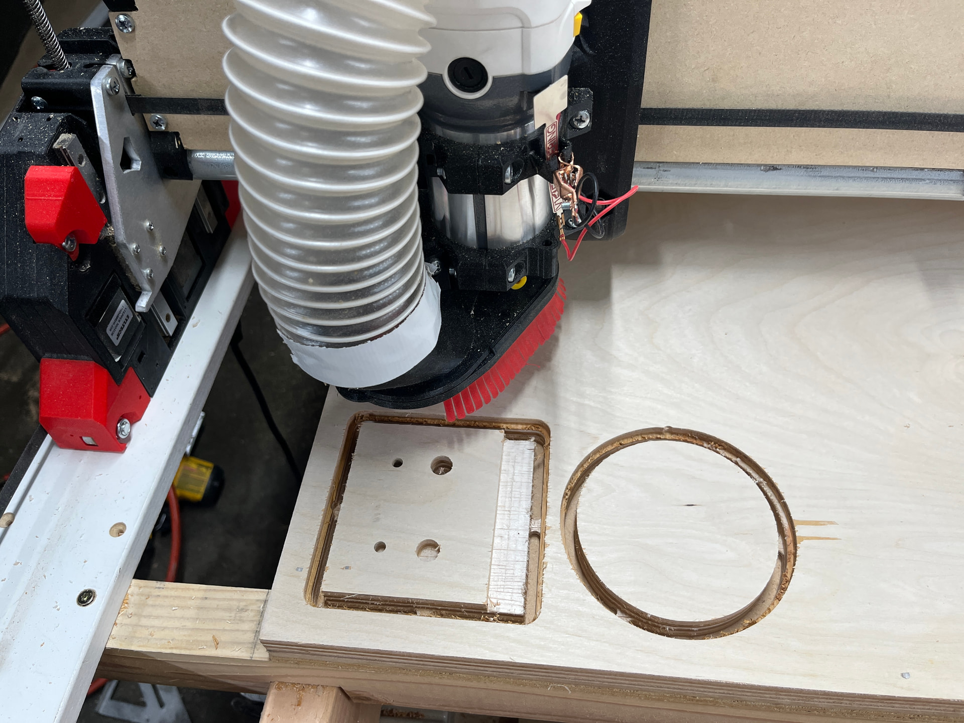

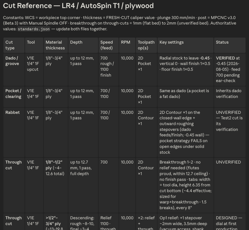

To make a long story short, I installed the Fusion MCP, trained it on an existing project’s CAM settings that have a bit of everything for cabinet making, then spent a day refining test cuts. Holy shit this is awesome!
Being able to just chat w/ Claude code, it instantly makes some tweaks, I run a small cut, and feed the results back is a game changer. I tuned the fit on dado cuts in 3/4" ply, set depths for through cuts, added a chip evacuation channel for deep through cuts (Claude’s idea). This thing absolutely ripped through my settings and nailed it. The goal is to create saved tool operation profiles in Fusion so I don’t fully rely on Claude to do everything for me.

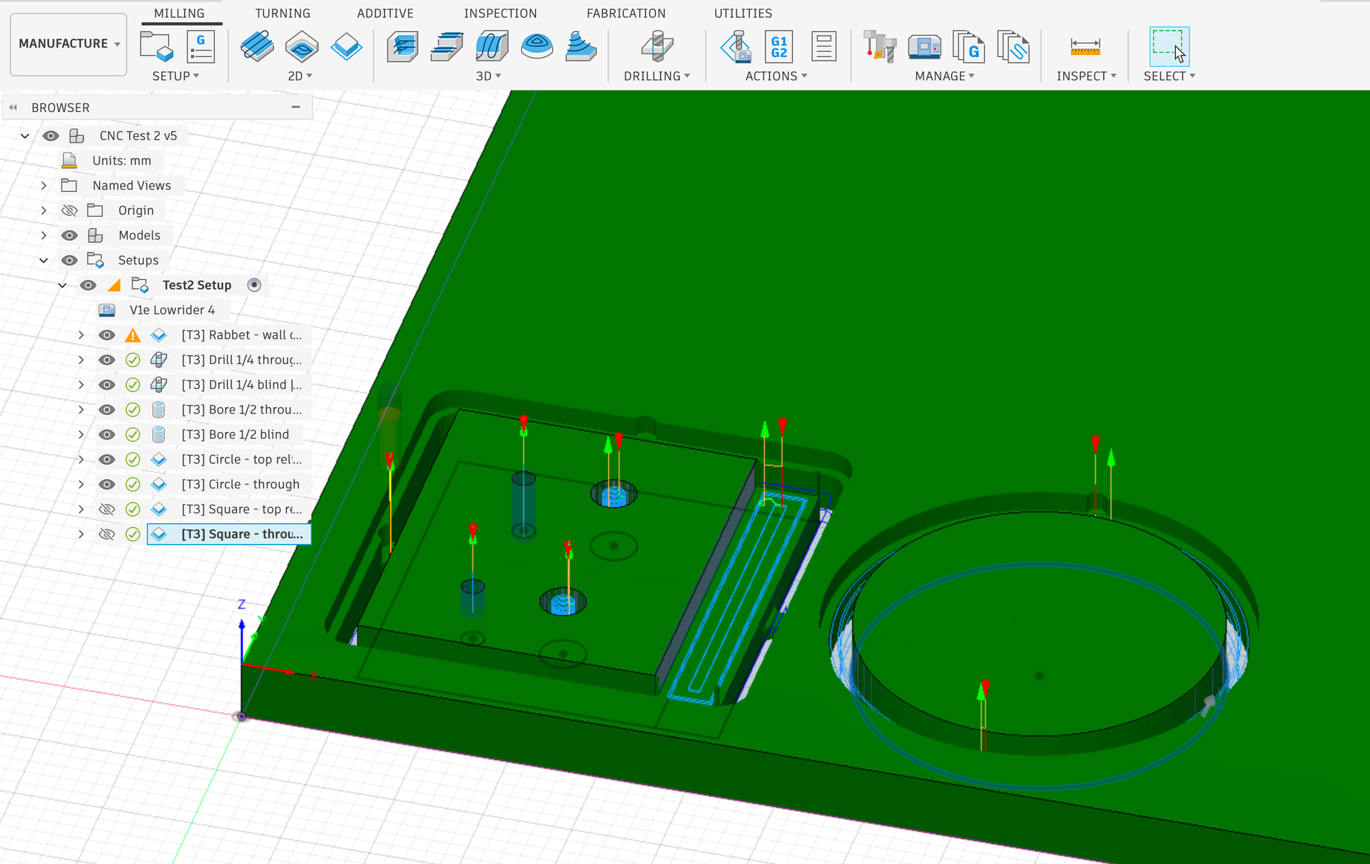

Completely hands off CAM setup from a drawing
Cut from previous CAM output
Table of toolpath operations I’m working on

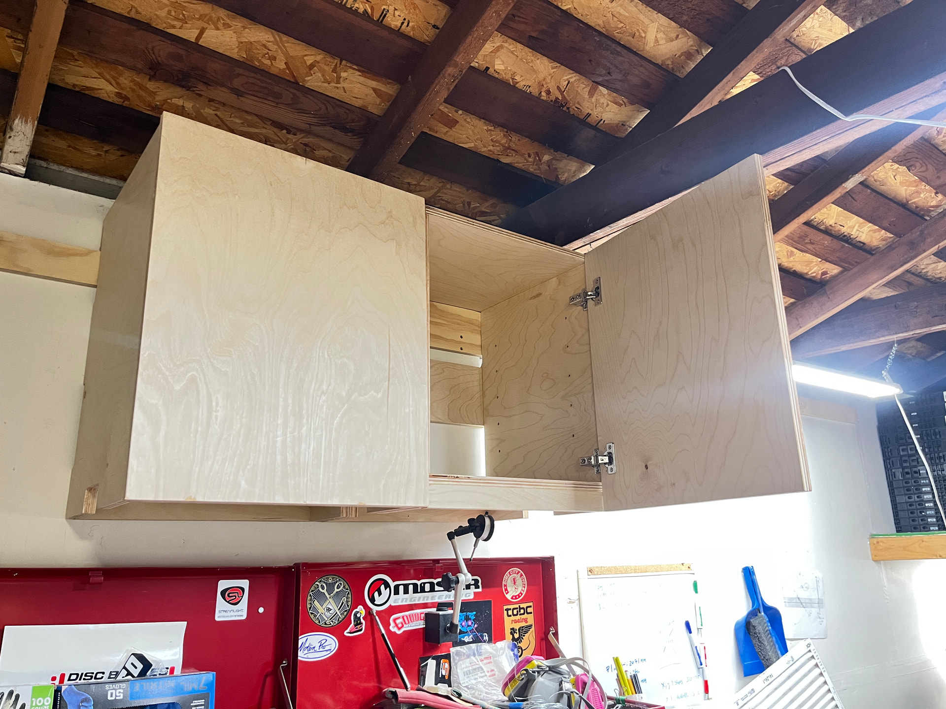

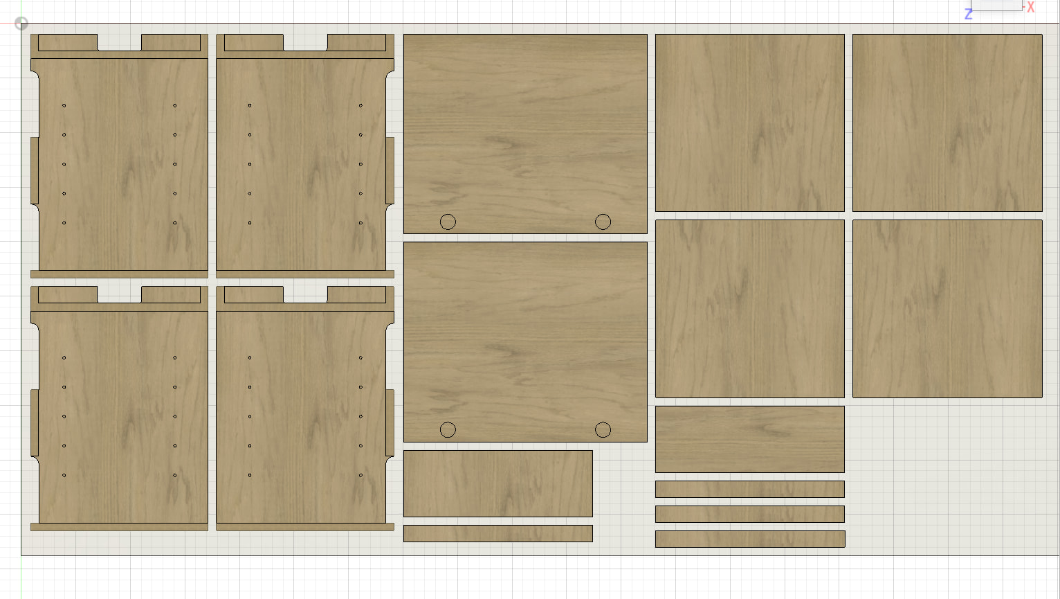

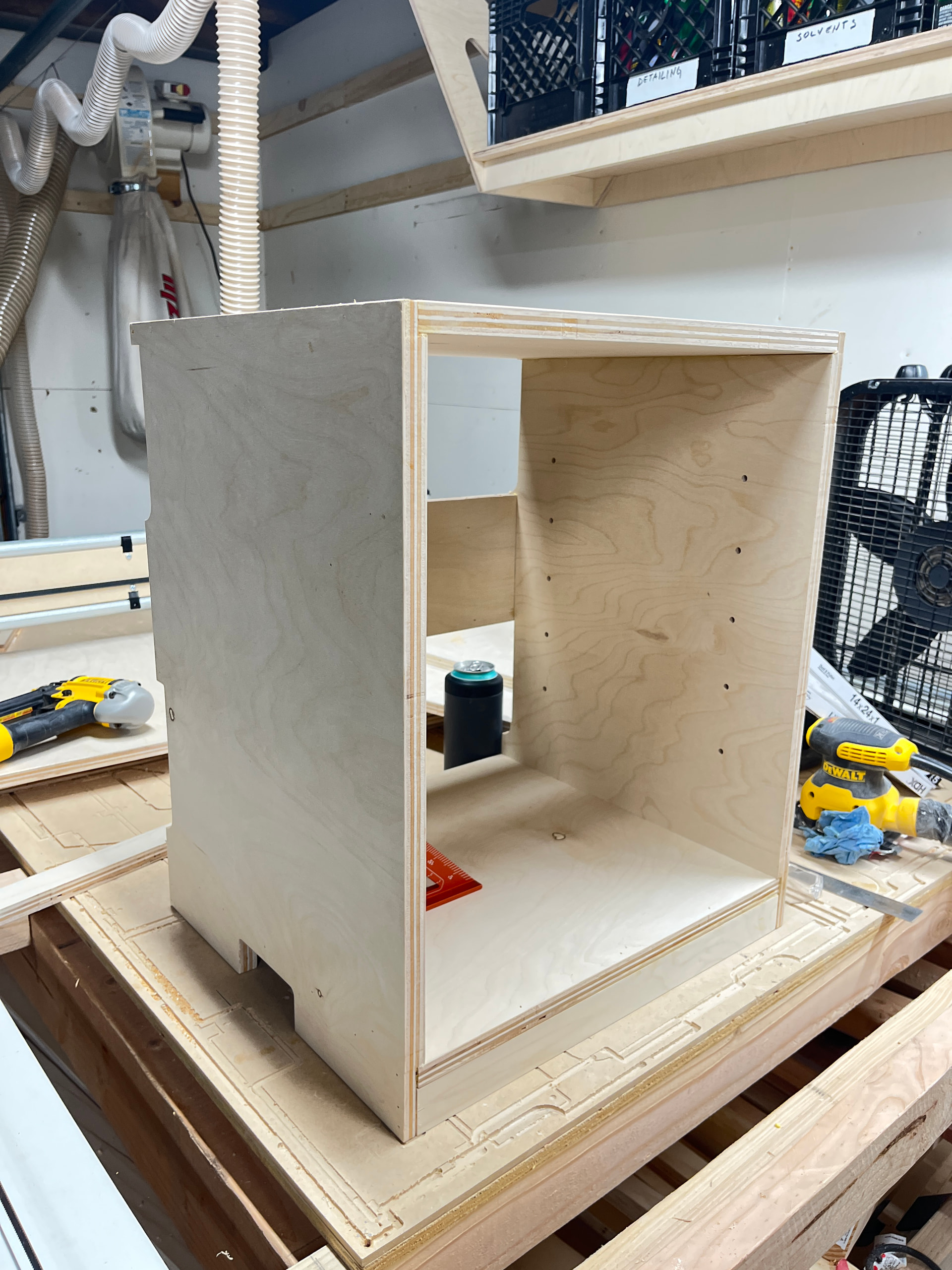

Re: cabinets, yes I half agree with you. I think the best workflow is to cut the sides on the CNC and mark the table or track saw lines for the other cuts on the sheet. I’ve designed the sides to have dados, rabbets, and the shelf pins which makes it super easy to assemble. These are french cleat style so the back panel of the sides also have some reliefs for the cleats. Whole thing is parametric in fusion.
I really need to get a pen tool or laser to mark the straight cuts. Dados/rabbets + glue + brads makes assembly super quick though.

@spsully2582 inspired me to finally work in an operation for a circular/track saw cut path instead of milling squares out of the sheet. I’m working on using a V bit to score a manual cut path at a depth that jives with the blade thickness and hopefully helps prevent tear out.
But that’s pretty specialized for cabinets/flatpack stuff. The repo will mostly have pretty generic cutting and clearing operations designed for a standard LR4 and V1E 1F bit.
