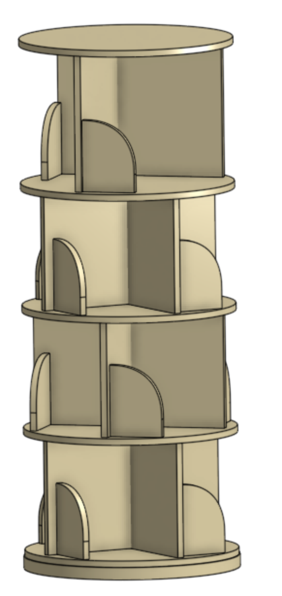

Building a rotating bookshelf for my youngest and thought of an easy way to cut the circular shelves.
I have 6mm holes in my spoilboard, so I simply cut a 6mm hole in the middle of my square stock. Then I connected both with a metal pin as a pivot point. Then I moved the router in position above the stock and while I moved down the bit very slowly I started rotating the stock by hand. For the finishing pass I moved the bit slightly closer to the pin and kept turning the workpiece.
Video.
How it will look when done:

Started adding bolt and dowel holes to these circular shelves and thought of a (somewhat) easy way to do this with the CNC even though the shelves are larger than the cutting area. I basically rotate the workpiece using the CNC.
Given that I need to machine four identical quadrants, I machine one, then for the last feature I just run the bit straight down into the workpiece and turn off the router and remove the clamps. I have added a pause command to the GCODE at that point. Then it does a 90 degree arc move with my pivot point at the center, rotating the work piece as it moves. Then I fix the clamps, turn on the router and resume the gcode, letting it mill the last feature. I repeat this 4 times.
