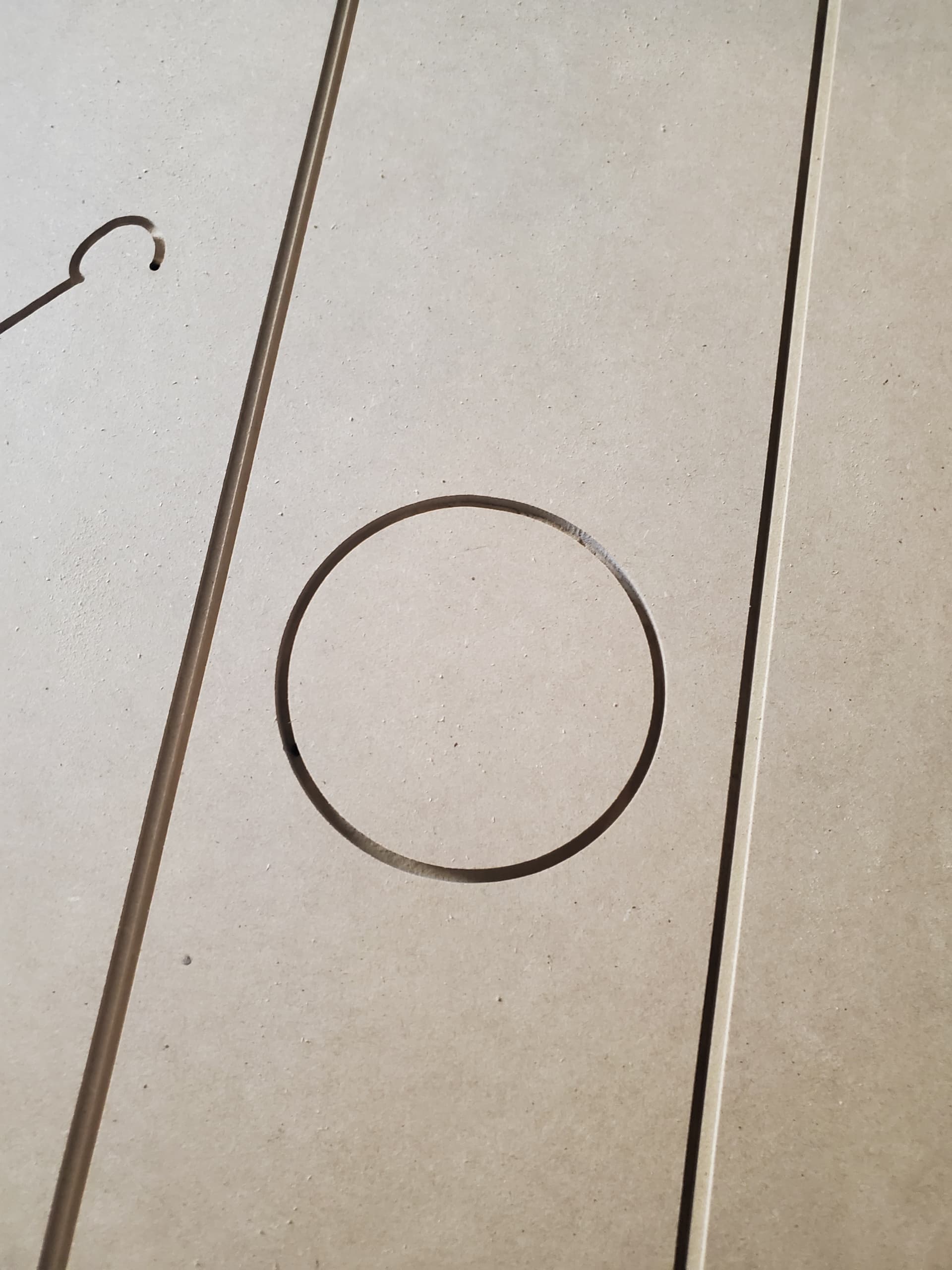

Circles are ovals...squaring issue?

But one victory was that I did like you said and slowly.tightened those bolts and sure enough that really did cinch it down. Possibly will even totally solve my initial circle issue as the carriage was way more sloppy before I tightened those. So thanks for that!

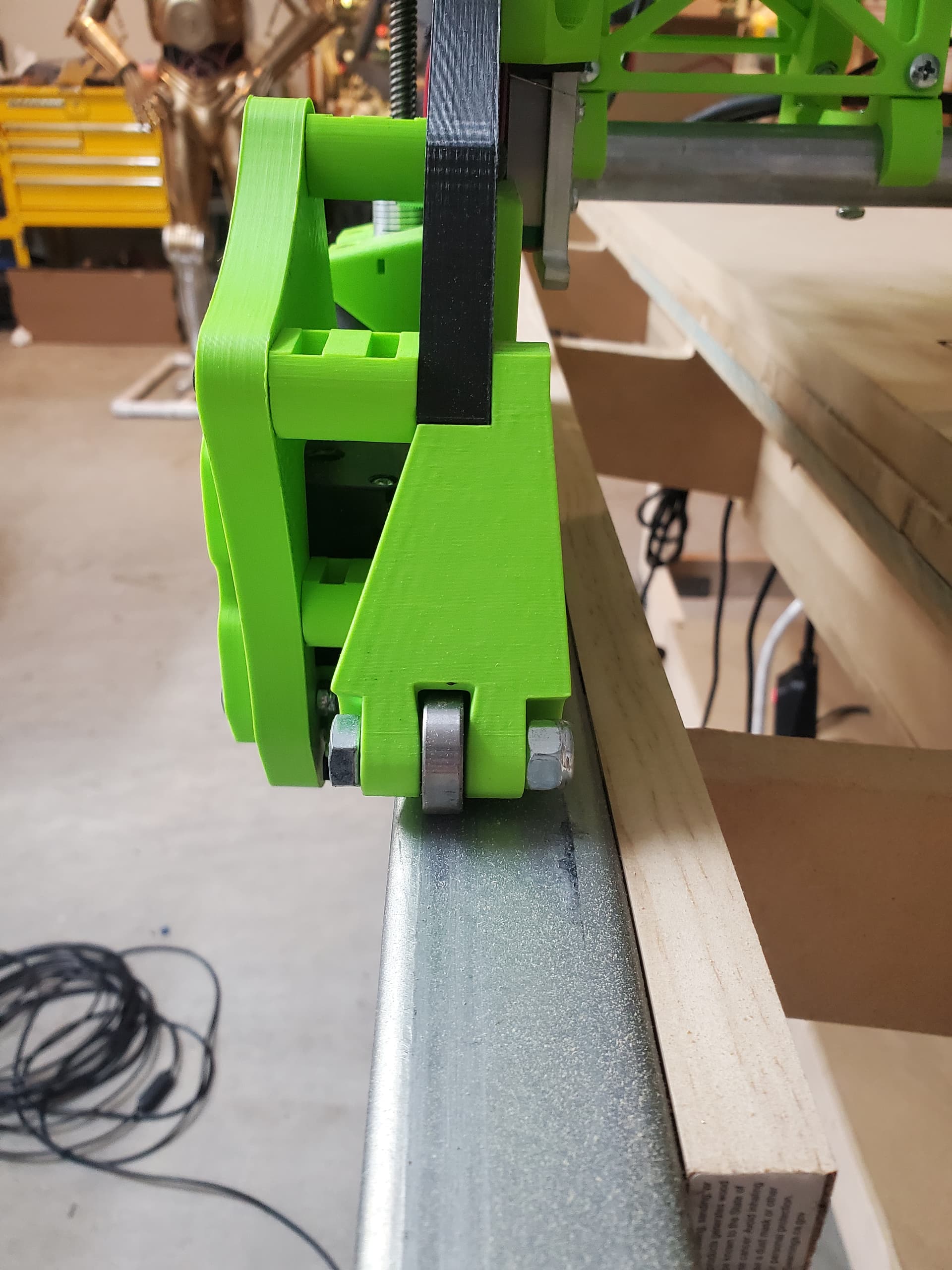

Ok, I totally undid all my endstops and started from scratch and learned I had a few things mixed up. I removed the endstop sockets from the SKR board and that helped as well as totally replacing the endstop and wires on the Z1. I then was able to make it home all axis. The z probe worked like a charm too. In addition, I went into TinkerCAD and designed a little 60mm block with negative space to act as a brace for the Z when I power it down. That way everything stays trammed and close to even. I saw Doug Joseph has a wood block, but this was faster and worked better for me. I’ll share if anyone wants the file.
Next, I went to square the entire 4x8 bed and saw that when I went to Ymax limit and Xmax limit that the YmaxXmax was not even. So I did hats likely not the preferred way, but I carefully measured and manually pulled the carriage back. I’m not describing it well, but what I was solving was that the position of the Y steppers were not even which was causing the Xmax to be slightly behind where it should be. I then redid the max and min points to find the diagonal measurement. I measured Y as 2460mm and X to be 1230mm, so just shy of as large as I could go. The diagonals measured as 2722 and 2723, so 1mm! I was surprised that after just that one minor fix and 2 go arounds squaring that I was able to physically square without firmware offsets.
So I am just now cutting an arcade cabinet speaker plate that’s 800x120mm roughly and has two large circles and pleased to see that the circles look great and so does the overall squareness of the plate!

Oh! And in the Xmin of the hidden belt side without the conduit, I added the slightly longer stepper offsets. That allowed the pulley system to not rub and also put my bearings more on the Superstruts as well as fixed the slight flaring out of the lead bearing.

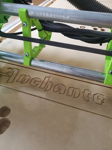

Speaker plate cut perfect except Repieter Host crashed but my part was basically done. Test two is a nameplate from brother in laws wedding. The fonts cut very, very well.
