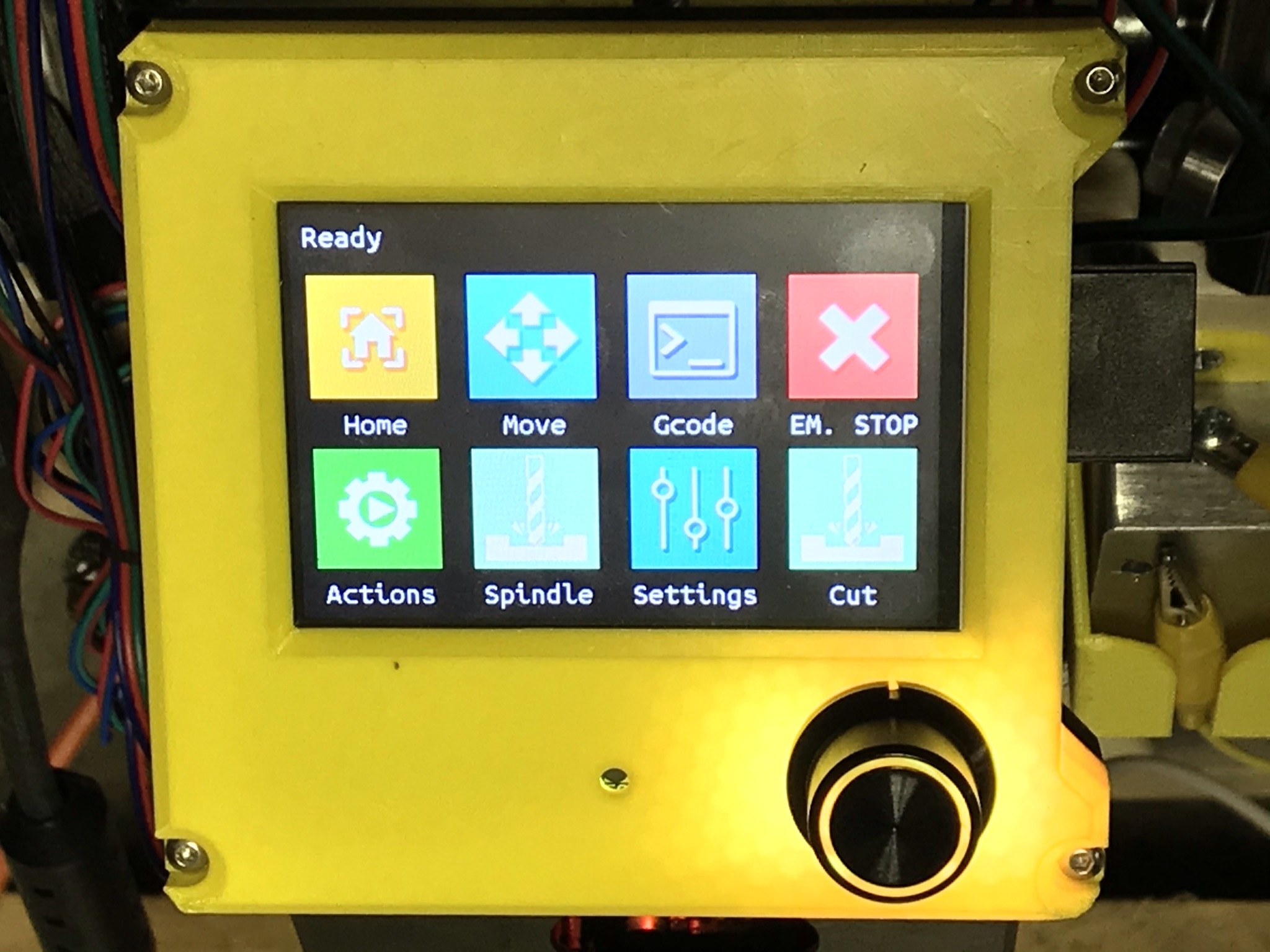

Marlin uses the homing to establish the machine bounds. I also added a touch probe for setting the tool height. The only remaining end stop was Ymax.
I manually touch off my workpiece before the job using the TFT controls. Thus I added a “Probe Z” button to the home menu:
I also want to have the canned ‘custom’ GCODE routines accessible from the main menu, I thought ‘Actions’ was a better name for them:
To create a new button in the TFT firmware, I created an 95x95 pixel BMP and stored it in the TFT35 folder. I added a line to TFT/src/API/icon_list.inc with the base name of the new icon.
To define a new label for the icon, I added the base name in TFT/src/User/API/Language/Language.inc, then added that term to all of the language header files
Once the icon and label are created, they can replace items in the menus.

I didn’t like how the TFT firmware would immediately start running gcode as soon as you touched the file!
So… I added a confirm dialog box…
I will push this up to my fork on GitHub.

I changed my Touch Off buttons to ask for the new value, allowing touching off to non-zero locations.
I also added the current tool coordinates to the status bar to immediately see the effect of touching off.
