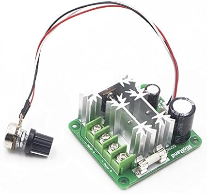

I own a 400w spindle with variable speed controller. http://www.amazon.com/gp/aw/d/B00IFUM1Z4/ref=mp_s_a_1_2?qid=1445036536&sr=8-2&pi=SL75_QL70&keywords=ld52gf
The speed controller that comes with it is junk but a better one was cheap. Im hoping this one will work for me.

Desicide to go whit this spindle, has speed control and selection of collects
I like that one. it is like my 400w spindle, same mount, yours has what looks like a better speed controller which is good cause the one I got with mine was defective as reviews had warned. I bought a better one similar to yours and it works great. I also added the ssr to the spindle power line for on/off control in software.
EDIT: there is a 52mm spindle holder on thingiverse that works great. I remixed one to have holders for line lasers
Got a link to the speed controller you replaced your broken one with? The ssr you are using is it the same as the one in Tomi’s picture? I am looking to set up something similar.
