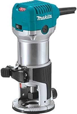

I have purchased the Makita, it’s awesome.
The makita is easy as to mount and I found the blank tool mount on thingiverse but I can’t figure out how to get the STL into fusion 360 so I can edit it, does anyone know how to do it?

I’m impressed by the body on this Makita, it’s a perfect 65mm cylinder of machined aluminum, makes alignment so easy!

I just got the Makita (RT0701C 1-1/4 HP, 6.5A compact router) from Home Depot for $99. It weighs less than that stated above, it is 3lb 1oz (1.39Kg) without the unused base plate. I read that the DW660 weighs 1.18Kg on the Shapeoko forum. That is about a 7oz difference.
The Makita has a built-in speed controller from 10000 to 30000 RPM which is a pretty good range for CNC use.
One drawback of the Makita is that to use 1/8" bits it either needs a 1/4 to 1/8 collet reducer or a custom collet from:
http://www.elairecorp.com/makitaroutercollets.html
The custom collet supposedly has a very good runout spec.

There are a few reasons I don’t go with that one but the biggest is how far from the axis it is going to need to be. The closer the cutting bit is to the center of the z axis (or where the X and Y cross) the better. Linear force multiplier the further out you go. So I didn’t think you could make use of all that extra power without some serious chattering. It might be rigid enough for it, I can’t wait to see how it works. If we can cram 1.5 HP on here that would be insane. But the Dewalt for $55 has more than enough power for what I’ve tried and it comes with 1/8th and 1/4 collets.
I’m more of a bang for your buck guy.
Really good point on the Z axis offset. I will see how close I can mount it.
Remember that the DeWalt needs a (Frankenstein/Light Dimmer:) speed controller.
I don’t think we can get the dewalt in Aus :frowning: that’s why we pretty much have to go for the Makita

Did you post up your Makita mount?
I haven’t had a chance to test it yet, I’ve been waiting on reprinted Z parts for a better Z fit. Once I tested it I was going to make the Makita mount look a bit more attractive too! Happy to share what I’ve got though if you need it but it’s untested (apart from mounting my router, which fits great, but I never got to actually mounting it to my MP CNC).
Yes please I will test it.
Source file if possible as well.
Did you upload it anywhere?
Sorry it’s taken me ages, I’ve been staying away from home and unable to access anything. I’ve uploaded the Makita mount here: http://www.thingiverse.com/thing:1008647
There’s also a mount for an e3d v6 (which are awesome).
