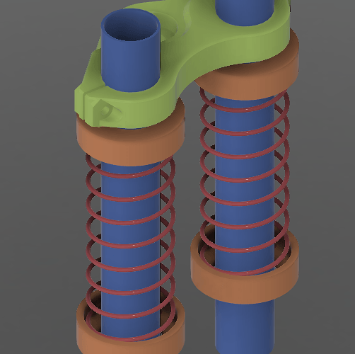

One annoying feature, because of the extra weight, the Z axis would spin down when the motor is disabled at the end of the run. Normally this wouldn’t be a big deal, but I cut mostly 2" foam with mine and I zero my bit to the top surface of the material and work down. I came up with a solution that I am in the process of completing. I bought some compression springs to mount around the conduit in the Z axis to help neutralize the weight of the spindle on the Z axis motor.
I have attached a CAD drawing of my intent. I ordered the springs from HERE. They were $11.77 ea, but there is a $40 minimum purchase, so I have an extra set. The nice thing is, they are stock springs. I expect them in next week and will update when I get them installed.

Just eyballing this, the spring rate of 7.2lbs/in (3.6lb/in x2) seems a bit stiff to me. If you set the spring heights to provide enough force to net out the Z axis weight at Z=0, you might not have 2" of travel left before bottoming out the springs. You only get 4.38 -0.71 = 3.67" total travel and if the Z axis weighs more than 2lbs (1.67 *7.2) you will run out of headroom. That being said, even offsetting som/most of the weight at Z=0 might be good enough to keep the axis up.

I liked that you caught that. I considered a single spring around the lead screw and keep the load at 6 lbs… I put a scale under the bit in the spindle when it came to rest on the table with varying results, however, most times it was =/> 5lbs.

How much z travel do you have? If you have two springs in parallel like that the lifting force will increase by 7.3 lbs for each inch of movement. Lets say your z axis weighs 5 lbs, if you have no preload and zero lift at the top of your travel then you have net weight of 5 lbs, but descend by only 2 inches and you have 14.6 lbs of lift from the spring, or net of 9.6 lbs upward force on your lead screw.
I think you might do better by stacking the springs in series instead of parallel and then preload a bunch. If you stack your 4 springs on top of each other then the force changes by only 0.9 lbs for each inch of compression. If you preload with say 6 inches of compression then you will get 5.4 lbs of lift, and when you lower by 2 inches the force increases to only 7.2 lbs of lift, a very reasonable range compared to 0 to 14 lbs.

You bring up excellent points, thank you for your feedback. I wanted to avoid a custom spring but i may have to resort to that. This was the closest "stock" spring they had to my parameters and i thought it worth the shot.

So here is the final result. Well, not final, I’m reprinting the top Z axis pieces out of polycarbonite instead of PLA. However, the springs work like a charm. They have perfect amount of compression for the 90mm of travel ihave on the Z axis, yet the spindle doesn’t drop after deactivated.
Note: I am only cutting foam with this machine. (40mm thick foam with a 50mm long 9mm dia. router bit)
This is exactly what was needed. Let me know if you have questions
