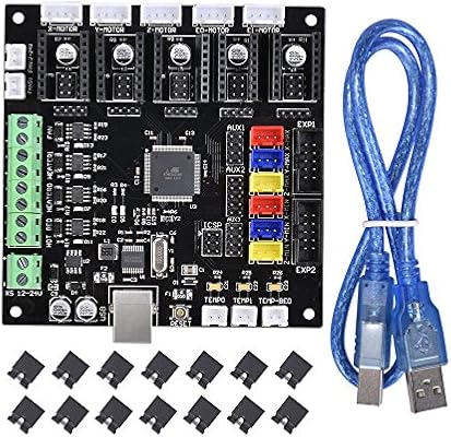

Pardon my ignorance of RAMPS, but which of the two screw terminals is the proper power input? The 5A one or the 11A one?
If I’m not mistaken, you can buy just the PCB and populate it yourself. Doesn’t seem to have all that many parts. So, if it really matters, I guess there’s that as an option, and you can buy the parts from a respectable vendor, like Digikey or some such equivalent.
5A is for board and steppers (all that mpcnc requires)
11A is for heaters/fans (mp3dp)

I don’t think on the stepper side that the ramps is ok for 24 volts. Looking at the reprap page it seems like you need to do some replacement of parts to run at 24 volts on the stepper side.
http://reprap.org/wiki/RAMPS_24v
That’s a good link Matthew. I’m assuming you’re not using a heated bed, so that polyfuse is just dangerous, not already on fire. From the pics, the stepper capacitor voltages look like 35V. So that leaves the arduino regulator. Did you toast that already? RAMPS should poser the arduino with just the 5A input. If it only comes on with USB power, you burnt it.
That still doesn’t explain the heat of the drivers. Are you sure you have them set up properly? When they are in standalone, the little potentiometer determines the current. If you weren’t getting th configured via spi, then they would be at whatever random current was set with that pot. The best way for me to tell was that they reported non zero registers with that debug command.
This single board seems to do nominally the same as what the two board combo (with RAMPS v1.6) was doing.
However, it can allegedly accept up to 24 volts.
I guesss there’s no benefit in powering it from 24v though, is there? After all, the board will just have to down convert it.

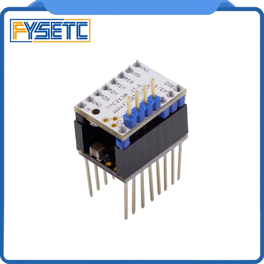

FYI, I notice that some of the sellers are selling the TMC2130 with a “stepstick protector”. Anyone know what those are? Is it just a gimmick, or does it provide real value/protection?
Strange. The description for the protector on its own suggests they are for the tmc 2100, but I don’t know what they even do.
I really like how those 1.1 ones have most of the soldering done right. Someone’s been paying attention.
Well, what could it be? I’m thinking flywheel diodes and/or overcurrent protection. Anything else? I would say overheating protection, but wouldn’t that require a temperature sensor on the TMC2130 module itself?
I suppose it could have polarity protection also, in case it was plugged in wrong.
Anything else?
I wanted to chime in and add if your are sold on the tmc’s consider using a flyback diode system, or freewheeling diodes with them. It doesn’t make that big of a difference on the 12v system, but with 24v you need them or back emf will burn them up. Probably why they were so hot.
There either called tl-smoothers or silent stepstick protector. Make sure to get the ones with eight diodes. Watterott carries them.
