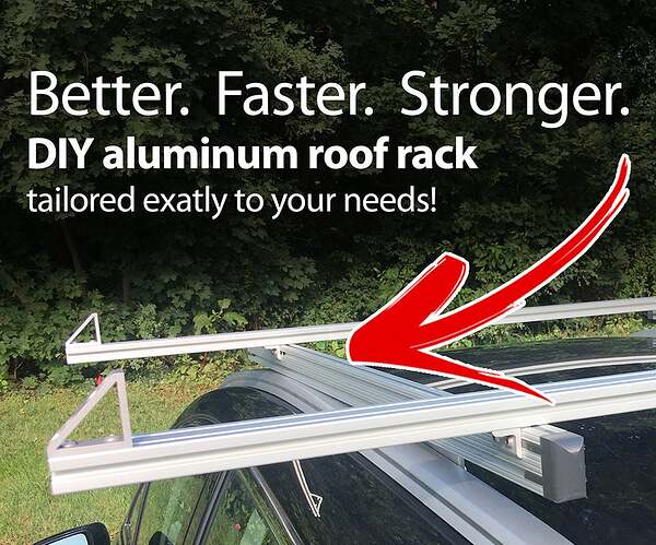

I was poking around for 3D models for the Chevy Bolt we just got and I saw this:
https://www.printables.com/model/191350-chevy-bolt-roof-rack-tower
screenshot-2023-12-05-1701803097
Did one of you do this? I’m not sure I trust EMT enough for a mountain bike on my car, but the style is really appealing to me (for some reason).
Shoot I trust the EMT, the printed part in the sun though. I would keep an eye on that.
What about 8020?

For the rack i am with ryan, elements on that plastic is not good.

ASA will work for that.
Yes, but roof bar loads have a habit of increasing sneakily, think: bumps and cross- gusts from trucks. On my van I used 5 mm aluminium strap for the structure and it sits in slots in the printed covers which act as spacers and bracing. It’s really a metal core doing the heavy lifting entirely hidden by the plastic.
I just saw a YouTube video on higher density TPU as a filament. I’d consider that in this application. Print with added walls and higher infill.
