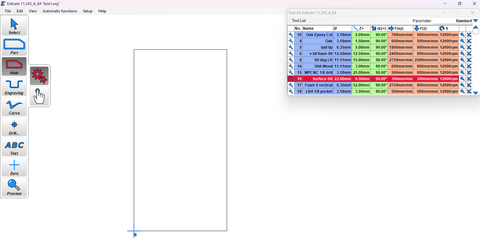

this is how I would do it…
for example… a box / rectangle:

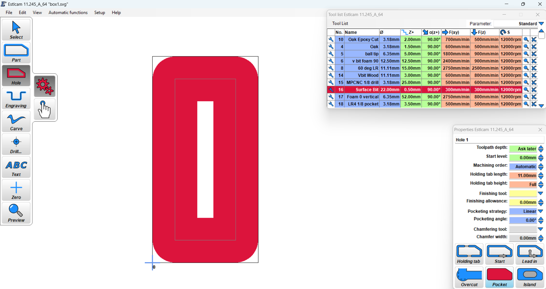

If I use the surface bit to cut the top 2 mm at 0.5 mm per pass, I would use the surface tool
tell it to be a hole

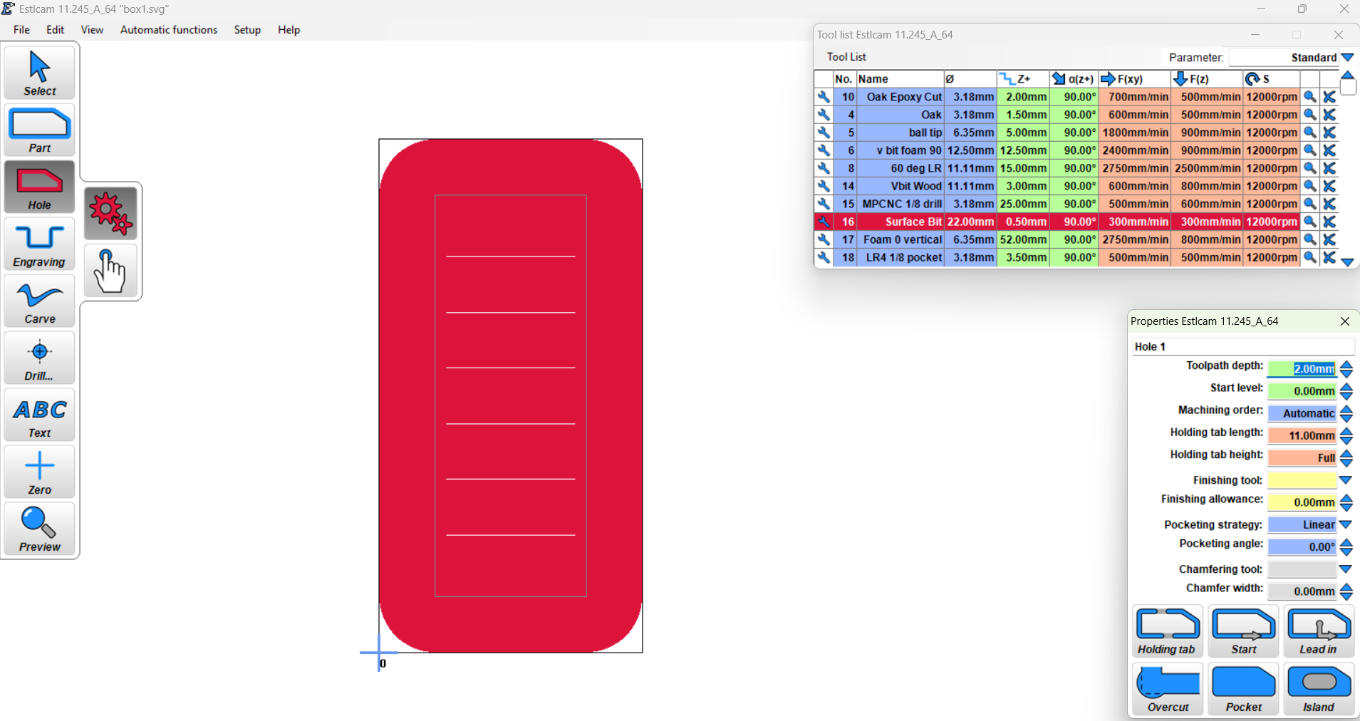

and then press the pocket option lower right and set the toolpath depth to 2 mm
the generated gcode has the same path for 0.5, 1, 1.5, and 2 mm depth:

If you wanted to manually change the number of steps, you highlight the z and everything below it to the next z and paste it in and change the z’s so they go highest to lowest (-0.25 > -0.5 > -0.75 for example). Notice the x and Y values are copied for each z setting, so you just need to change the z, but you have to copy all of it for the full movement. When you edit your gcode, if there is only one depth, you could copy from where that initial depth is set to the end. if you have a finish pass at full depth, then you would want to leave that alone and not put it in at every depth. leave it until the very end.
