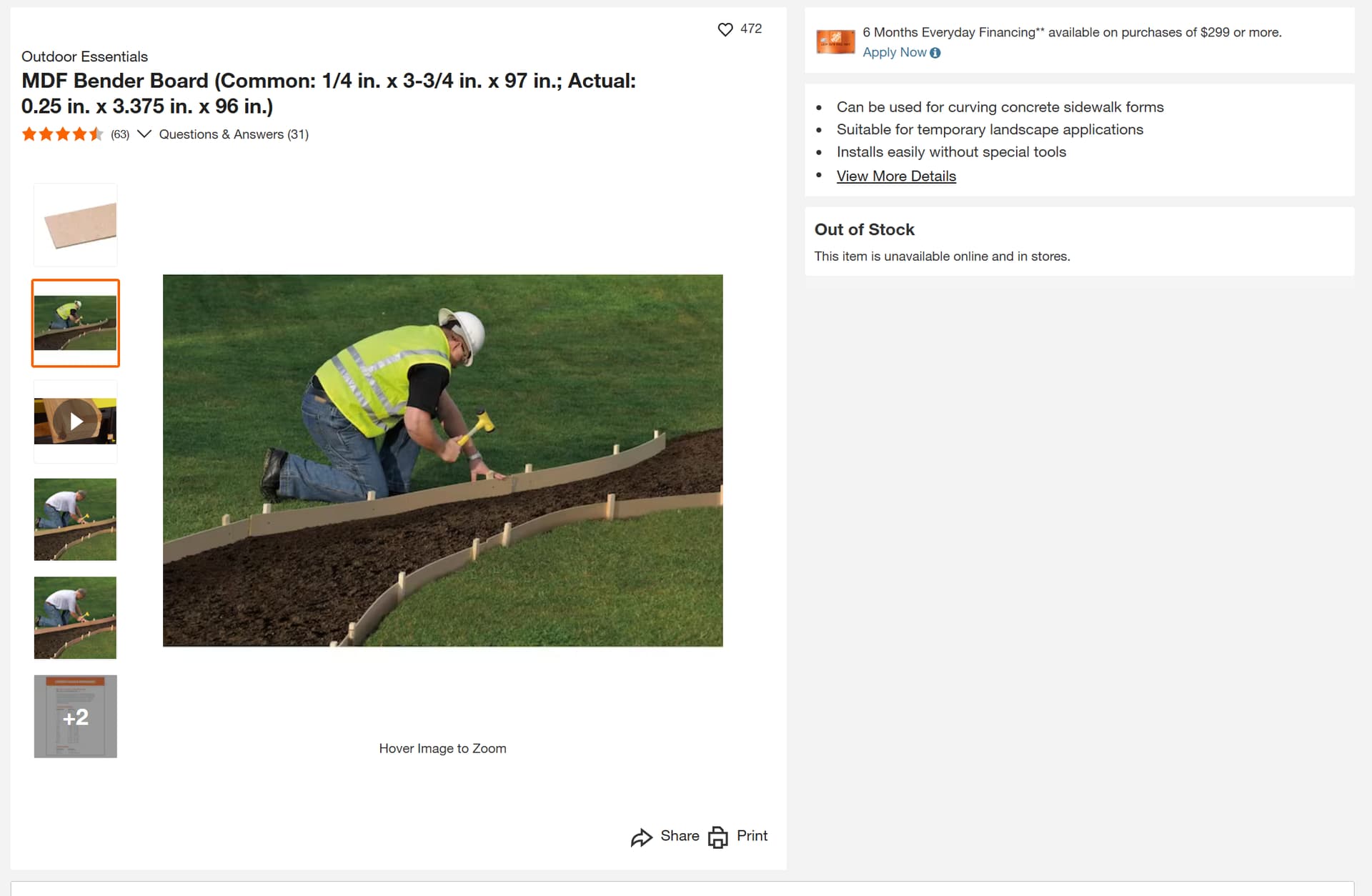

Check this out, $3.50, for 8’ of 1/4" MDF. What a steal! I don’t use 1/4" MDF for anything else, so buying a full sheet is a bummer. For anything but a full build, one is enough for both parts. $7 for two to do a full build is pretty dang good and very easy to handle and transport.
https://www.homedepot.com/p/Outdoor-Essentials-MDF-Bender-Board-Common-1-4-in-x-3-3-4-in-x-97-in-Actual-0-25-in-x-3-375-in-x-96-in-487404/202297474
Wow, awesome.

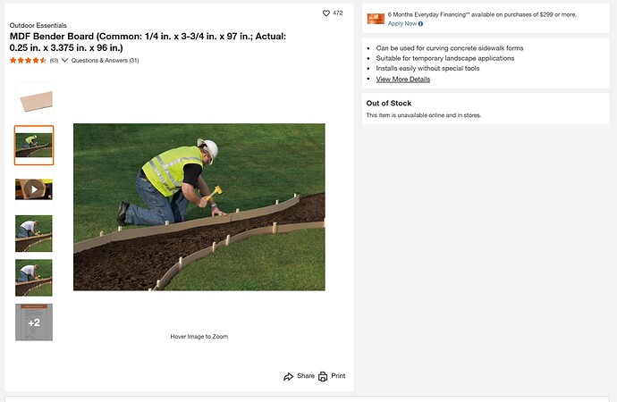

Sadly, for me this shows as:
Out of Stock
This item is unavailable online and in stores.
Man I was so hopeful for this!
But out of stock :man_facepalming:

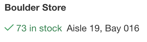

Just checked, both of the orange big box stores near me have it in stock. The one across the street from my office has it in the concrete area (Aisle 19)

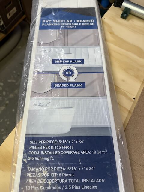

Out of stock for me as well in NJ, I used this PVC Shiplap from Lowes, worked great :slight_smile: https://www.lowes.com/pd/Reversible-Wall-Kit-7-313-in-2-83-ft-White-Shiplap-Wall-Plank-Coverage-Area-10-6-sq-ft/5013467575
