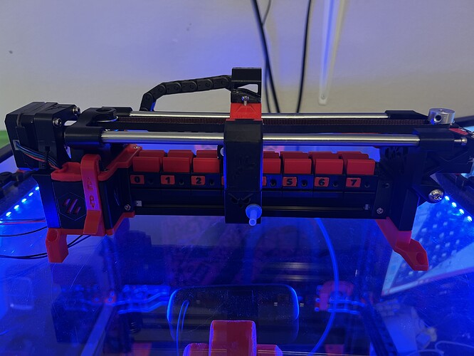

Going to try my best to document this build, but it has started this weekend with the goal of my 3 adult kids helping me out. They missed out on the Voron build, because I was so impatient, and I really want them to get their hands and minds on this build. So, with that said, sharing the build with them will take priority, but I have enough from today to share.
This is a Siboor ERCF V2 kit. It’s being printed with Polymaker Polylite ABS, in Black with Red accents, just like my Voron 2.4 build. The plan is to build this pretty much as the kit is presented. I’ll be doing the filametrix cutter on my stealthburner/galileo 2 extruder with 2 toolhead filament sensors. (The kit comes with hardware for 1 sensor, so I ordered some extras) Also will be using the Cottontail Buffer.

We were able to finish the Gear Box section of the build, and are currently printing parts for the filament blocks, which will be started tomorrow. So far I’m satisfied with how everything is fitting together, and also impressed with the kit so far. Not many pics to share, but here are a few. More to follow.

Bad lighting, but the ERCF is done. Everything fit and messed as expected. No issues so far.

The Filamentalist directly behind the feeder work great, but the 2 or 3 on each end don’t the bowden is too curved and the stepper just doesn’t have the juice to retract it back through all the curves. So… Back to square one. I’m going to try the cotton tail buffer AND the Filamentalist combo (mainly the later just to hold each spool before it enters the buffer. Trying not to buy a more powerful stepper to drive all that filament. I had the cotton tail mostly printed out anyway, so why not try it?
Yep. This is what I am finding out right now. They are just too tight and adding the friction from the Bowden is enough to put them over the top.
would it work with a longer bowden tube but straighter? You could put 4 in front and 4 right behind and run the tubes under/between the ones in front.
This is actually what Im doing. Wall mounted two shelves of 4. Work has been busy though, more to come.
Here is what I came up with. Works great, filamentalist side. I am still having trouble with Gate 2 and Gate 4 slipping but getting very very close.
Getting so close to all the gates feeding consistently, but not quiet there yet.
Yellow failed to retract all the way out the gate, and stalled, wouldn’t recover. More work tonight, hopefully we finish this test print.
