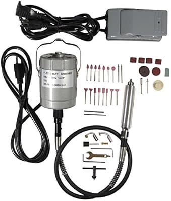

I like the switching your router idea, but what if we made a flex shaft like the Dremel fortiflex?
I think you can order flexible shafts in any lengths from some companies, and the properties vary quite a bit. 30000 isn’t hard to get, as necessary torque lessens in higher rpms. We can print everything else.
I think there’s a company, power transmission flexible shafts that might be worth a quick look.

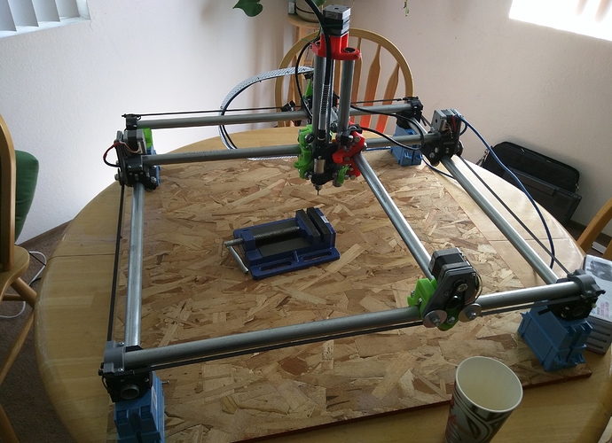

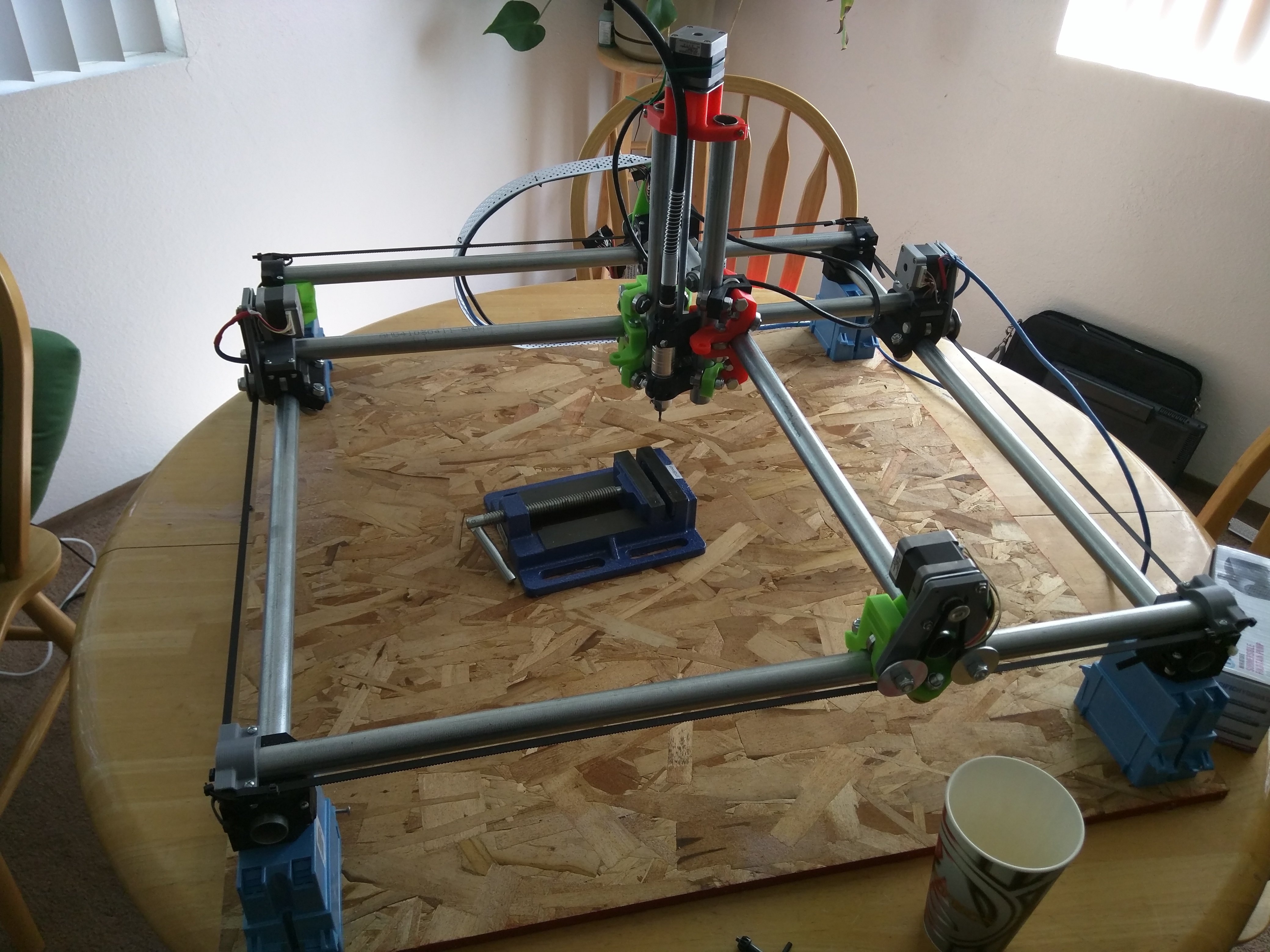

That is how this all started!
[attachment file=66534]
This picture was taken a week before I put the parts on thingiverse the very first time. The motor driving the flex shaft is hanging from the chandelier.
That is soooo cool! What where you using at the time? Still the DeWalt with a modified flex? It had to make the z a bit liter.
How well did it work? :slight_smile:
Also, I love the electrical boxes for feet! Lol
We used to use these. The dewalt is cheaper and stronger.
Have you considered modifying flex to work with the DeWalt? I doubt that particular flex is up for the task, but there are other options.
How was run-out on the hand piece?
There was a ton of heat. Adding anything to the dewalt makes it too expensive for no added benefit. Why move it? Direct drive!

What is up with that cable chain? It seems awesome!
Wow! I missed out on that version of the center assembly! My motor mounts still look like that though… Digging the use of the outlet boxes!
Almost looks like vinyl soffit vent.
Hahahah, version zero. All parts were symmetric, very few molds would have ad to be made. Stepper silencers (the motors came with them, salvaged out of copiers). I bought so many of them the guy called me and asked if I wanted to come pick them all up, he had a whole storage garage full and was selling them on ebay one or two at a time before me.
The cable chain was the edge of the corner plastic for dry walling rounded wall corners. I used it for a while and decided I hated early on. I don’t think it made it to a real cut before I threw it away.
Pretty serious picture for me. I had no idea at the time, it was just the coolest thing I made so I took a picture. Many thousands of builds later…Might have to frame it.
