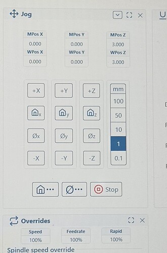

One thing I noticed is that once I jogged home, the stop jog button wouldn’t stop it - is that normal?
I know the endstops are there to do it, but I figured the stop button would work even when homing.
Endstops will only stop if if you are homing. They have zero effect on jogging. I’m not sure why the stop button didnt stop it for you.
I’m pressing the wrong button maybe? I pressed the stop button in the jogging section. If I recall there were was another stop button in the UI?

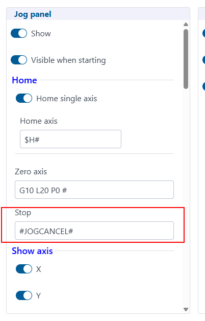

It was this red one in the jog section:
Basically I pressed Y home, it started moving in the opposite direction than I expected, then I pressed stop here but it kept moving. Pressed it frantically a few more times as the beam went up against the YMax(?) and started skipping but nothing happened, so just cut the power.
The one issue was that like in another guys thread, I sorta built with mental orientation backwards, i.e YMax as my starting area in my head and visually while building, rather than the endstops section where it homes. So in my mind I flipped everything if that makes sense and didn’t really take homing into account.
It’s an easy fix, just flip things and reorientate mentally, but it added to my confusion.
That button executes whatever you have in the settings for stop in the Jog Panel

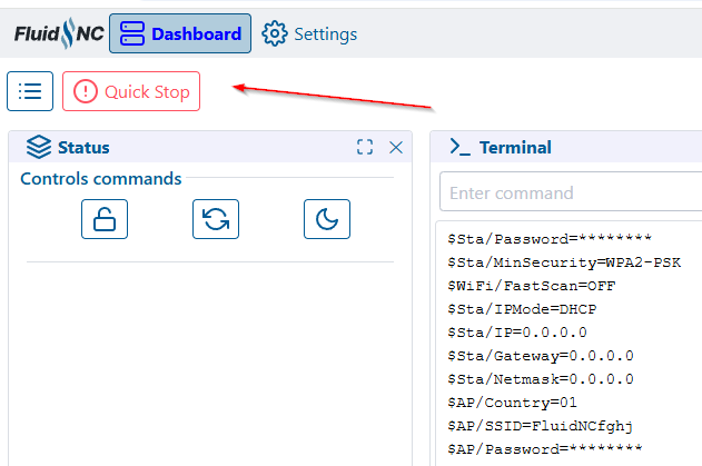

If you want to “Stop Now”… press
Or in emergency… power cut is your best option if you absolutely need Stop “NOW”, especially if your tool is spinning
