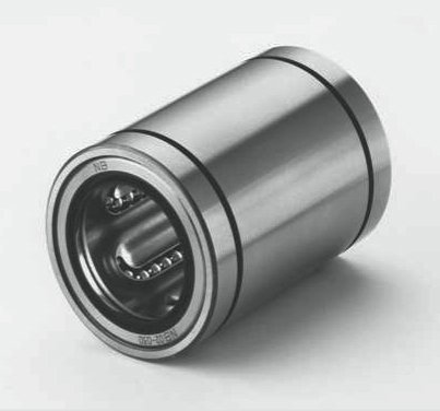

I plan to use these kind of bearings, instead of the current ones:
I think this cannot be used for the Z axis, since it has to stay opened at least on one side to attach the tool mount, but it would at least be used to link the X and Y axis together.

Anyway, Those bearings seems to be really awesome and the ones I received already are super smooth. They were actually not much more expensive than the cost of three bearings, so I thought I could give them a try.
In case the pic above didn’t show up, you can check here, this is where I bought them:
https://item.taobao.com/item.htm?spm=a1z09.2.0.0.SyWpEh&id=520801851507&_u=n23vfsu660e
Only 6 yuans for the 60mm one, that’s less than one US dollar. I love taobao, best online sales platform ever :smiley:
They have a dust seal, so hopefuly the performance should remain the same no matter how dirty the Cnc gets (which was not the case with standard bearings, they tend to accumulate dust and make the ganty harder and harder to move). Well, that is if the dust seal proves to be good. My guess would e that the dust will eventually get inside, but I could always find solutions to avoid that later.
Also, since the plastic has its limits in terms of hardness, I found out that occasional re-tightening of the bearing was necessary, probably because the screws are deforming slightly their holes or for some other reason. Last, but not least issue, I had to compromize between play and smooth movement, the more I tightened the bearings the less play I had, but the harder it was to move everything. I should’nt have this issue anymore with those.
There will be four 60 mm long bearing (on for each motor slide) and two 120 mm long ones for the X and Y axis on the gantry. I would really like to find a similar solution for Z but I have to find opened linear bearing with a large enough opening and at the right size. I’m pretty sure they exist so I’ll look into that later, if it turns out to work fine on X nd Y.

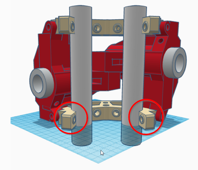

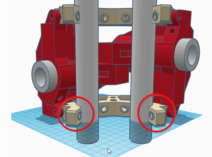

I’m still in the process of finishing mine MPCNC, but as for the strength of the middle part, I would say that the weakest point is in the XYZ part, not XY (look to the picture). Maybe it is good to somehow redesign them?
You’re absolutely right.
I plan to redesign this too, once I validate the concept for the other axis.
My plan would be to use the same kind of ball bearings, but opened on one side. I just need to find appropriate ones.
Some other solutions are possible, I’m currently not entirely decided which one I’ll use.
Any suggestion is welcome though, it is possible that the ones I imagine may not be the best :slight_smile:

The usual bearings have an inner and an outer race as well as dust shield protecting the ball bearings. Linear bearings have the ball bearings exposed to the rail, through a seal mind you, but still exposed. That’s what I was trying to say. If the rail has a nick or is dirty, it’ll cause the little ball bearing to get gung up on it.
Yes, you’re absolutely right.
But actually, a similar phenomenon appears with the standard bearings: dust accumulates on the outside ring, preventing them to run smoothly.
I’m not worriying about any dent on my tubes, I don’t have any diamond hammer to throw at them, so they should not get damaged before a long, long time :smiley:
