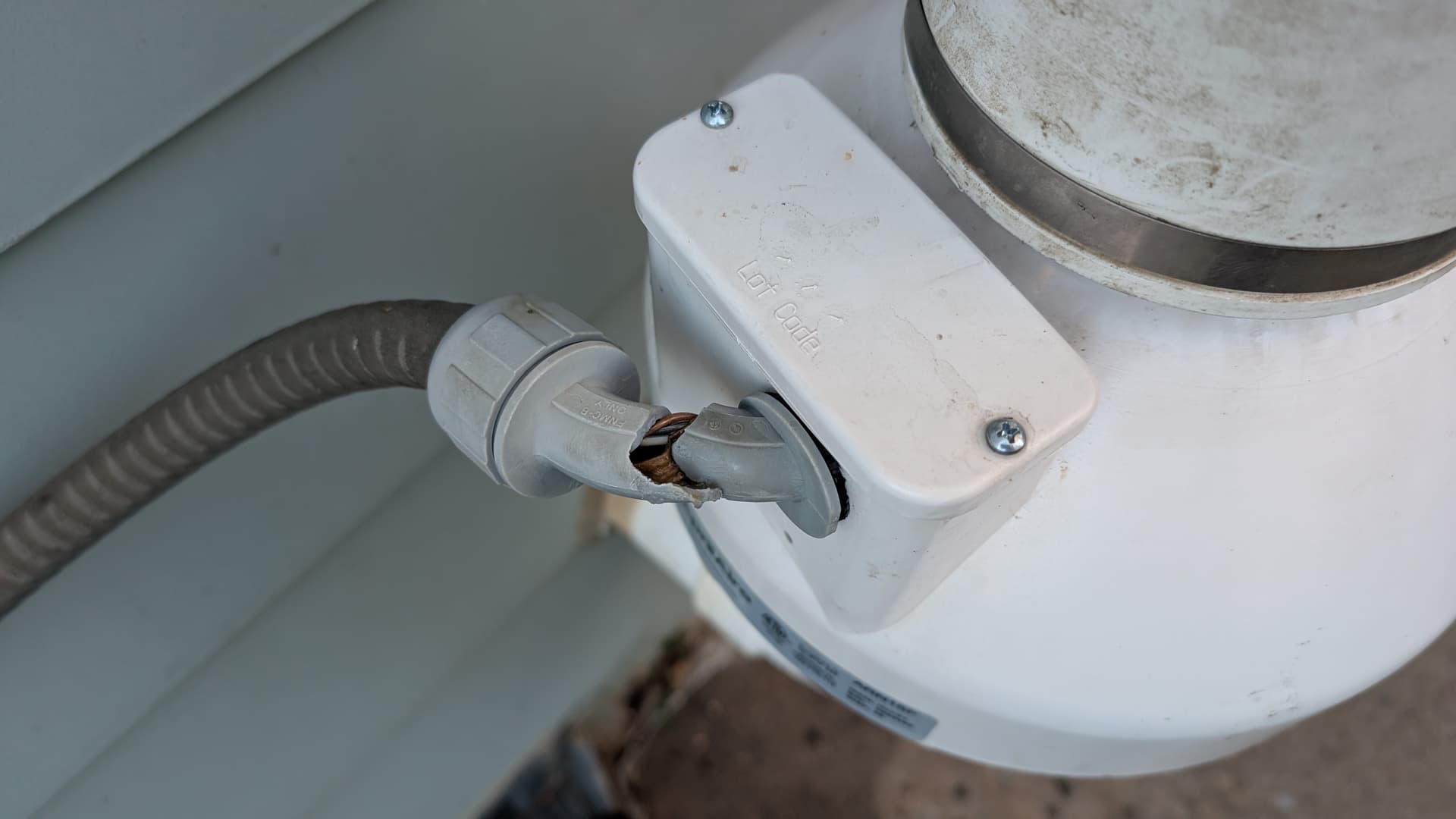

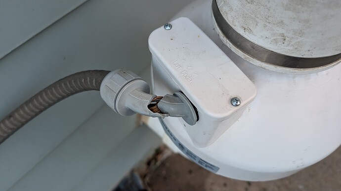

It’s what I call a “surprise project”. The exhaust fan from our radon mitigation system gets full of ladybugs, so I take it apart and clean it out. But when I took it off this time, this angle connector broke. They are cheap and available at home depot, at least. Just not what I was planning on doing today.
Probably less of a surprise to whoever violated the bend radius on that cable.

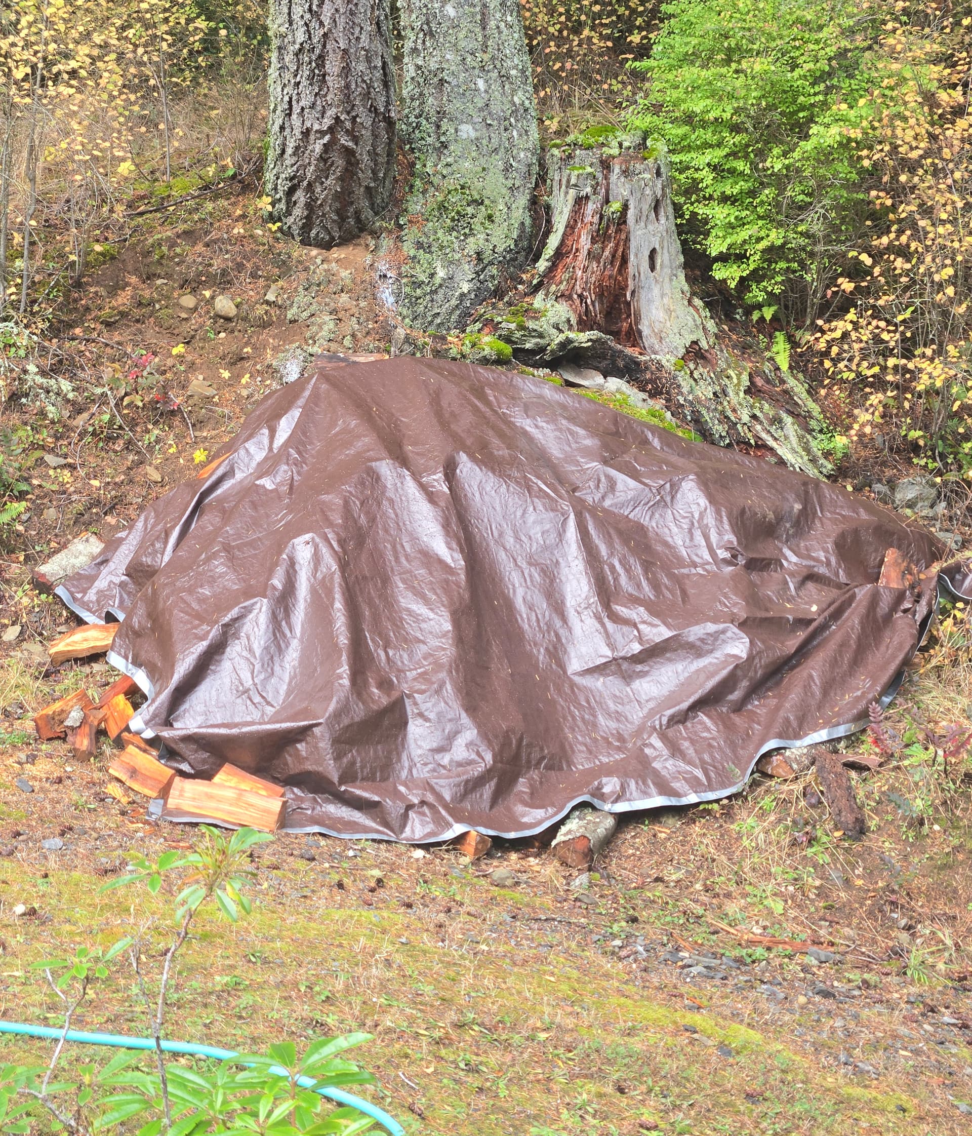

Firewood got delivered the day before we left for the week. Luckily we cut the vacation short, cause we had a storm roll in that I wasn’t expecting. Pulled the tent stakes out of the ground. So when we pulled up, the tarp was flipped over and the wood was getting rained on. Tarp is screwed to some bigger chunks now. :rofl:

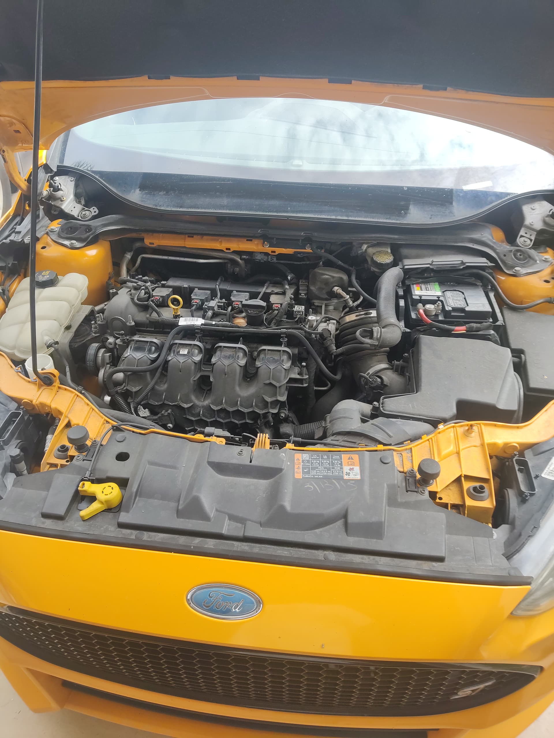

My 2015 Ford Focus ST sprung a coolant leak from one of the heater core hoses at the firewall.

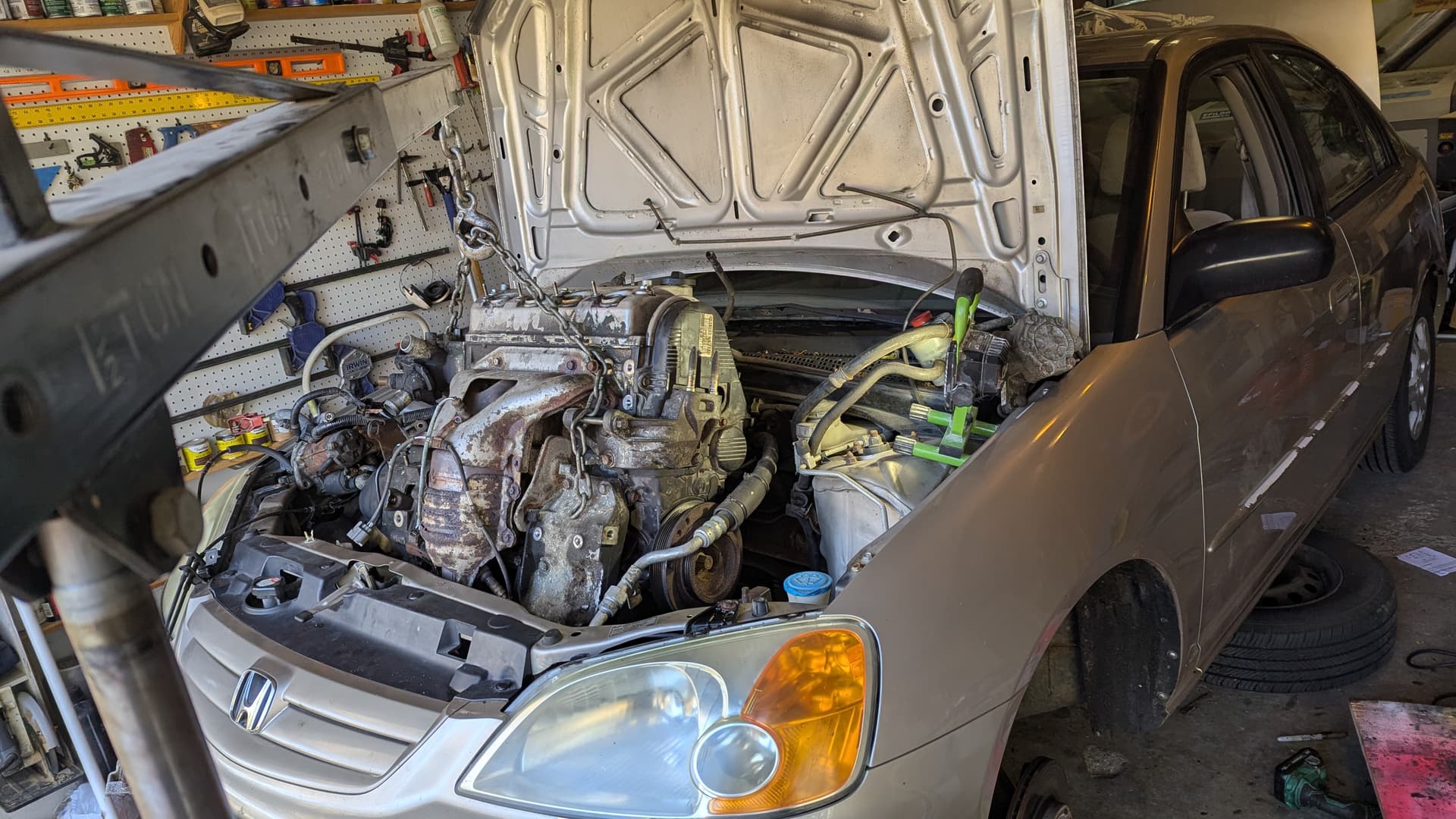

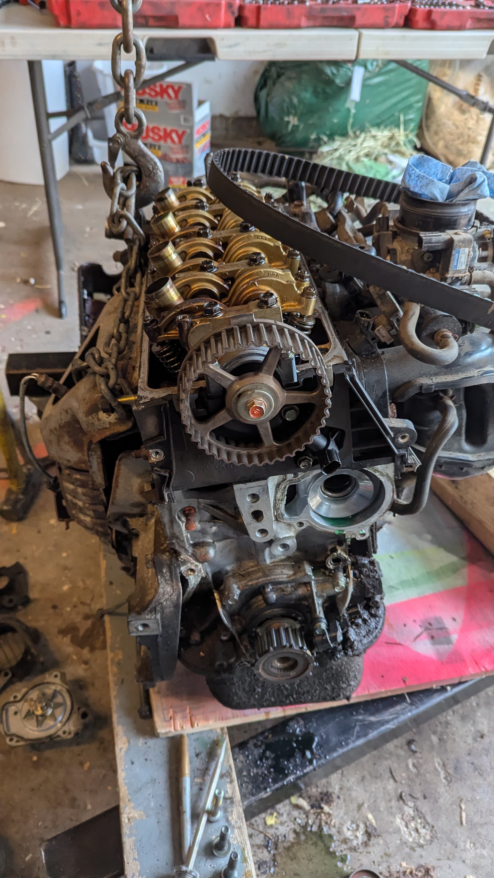

I hear you. I’m pulling an engine tonight to do a clutch and timing belt on one of the kid cars. Hope to have it functional and back in service monday before i go to bed… Heavy sigh. Sometimes the best choice is to just put my head down and get dirty to get it done. Hang in there.
I feel you….I’m gonna try and do the coolant lines AND diff oil by monday. At least I only need to finish one of them, as the wagon was bought specifically to be the 3rd car so we always (hopefully!) have 2 cars in service.
This is how far i got yesterday.
Water pump and new timing belt installed.

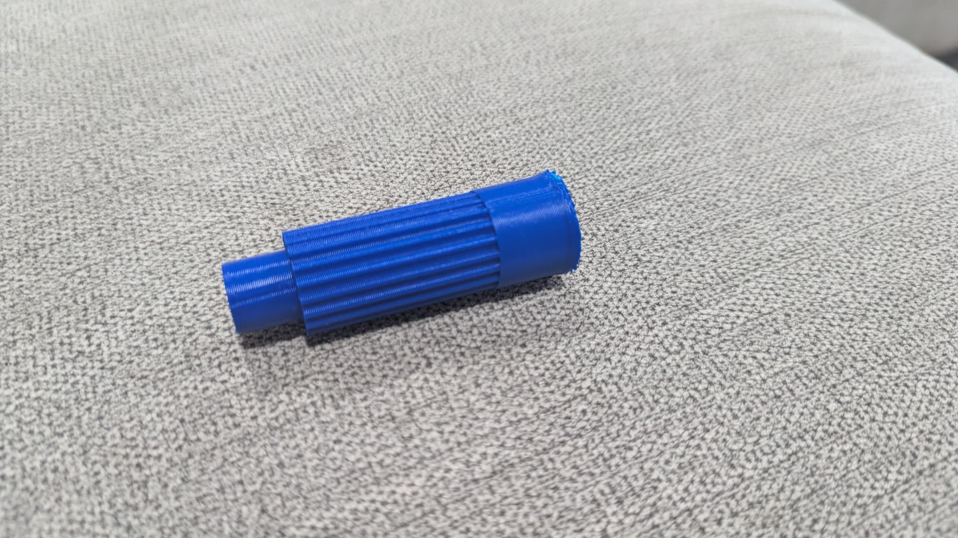

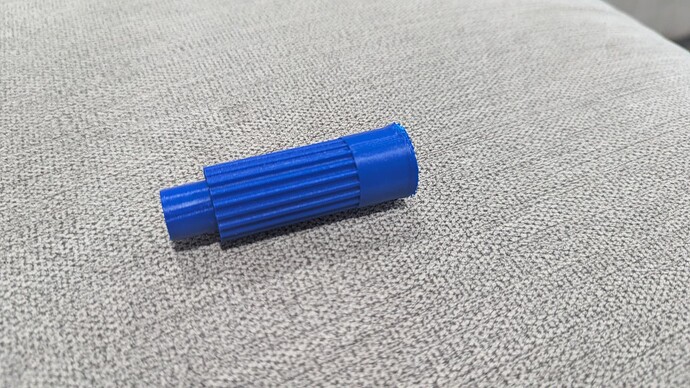

Clutch plate shattered. Realized the new kit didn’t include a clutch alignment tool. So i printed one on the newer mp3dp (First real thing):
Model off thingiverse. Hope to get the clutch on and everything back in tomorrow.

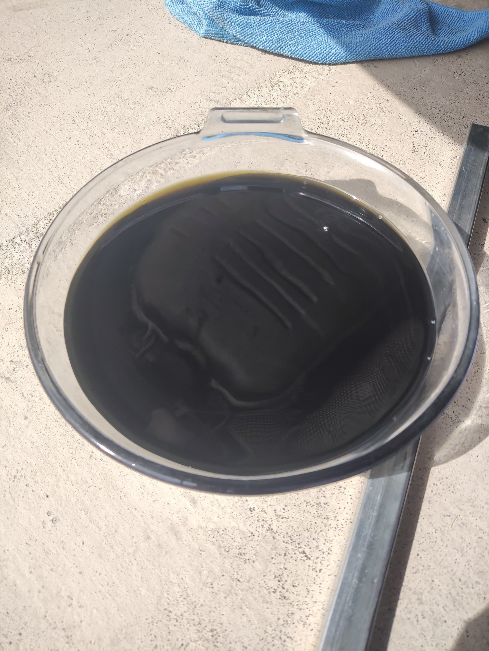

I did manage to do my jobs. Drained and refilled diff on my wagon. Only did a quick test drive but the noise appears to have gone away!
The old oil. It was TIME. no idea if the previous owner(s) ever changed it. My guess is no…:

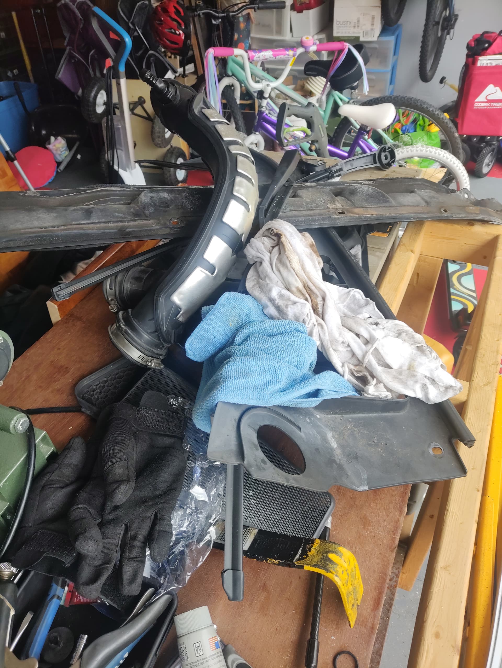

The bigger job was the tiny little o-rings (not pictured) in the heater hose fittings. It was a simple swap but I had to do quite a bit of work just to GET to the hoses:
The parts pile:
I won’t know if it holds till I refill the coolant…didn’t have any on hand. The o-rings are in, though!

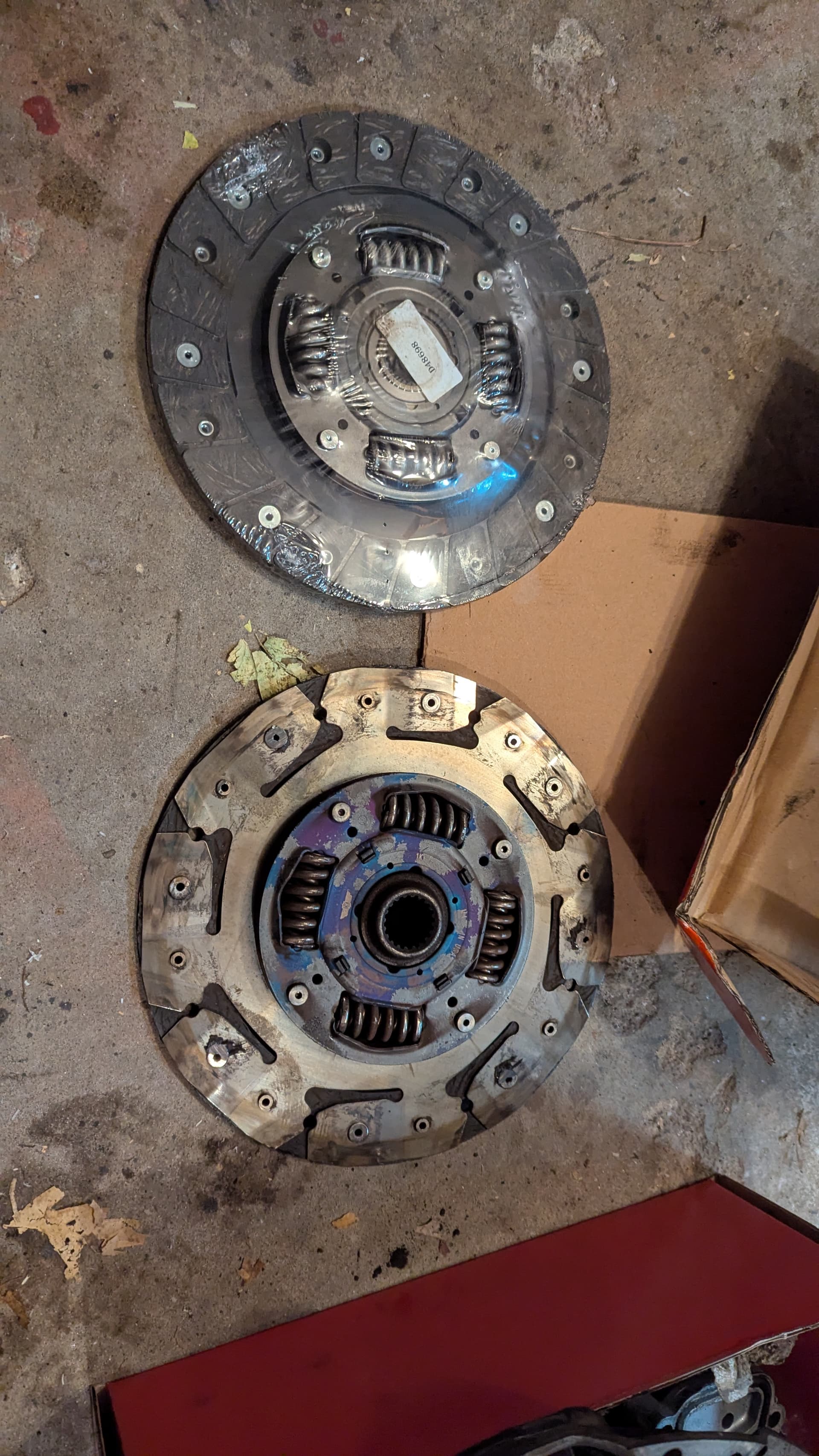

I got the clutch, flywheel, and engine back in on Monday, but the clutch master cylinder failed… Replaced it saturday morning and it is back in service.
The old clutch was totally gone…
