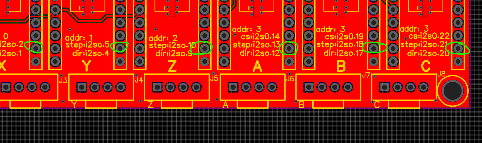

Intentional support for external drivers would be awesomesauce.
Honestly, I thought we already did. I had no idea it didn’t work.
I could be wrong. Hardware is not my strong suit but I think the TMC2209s are 3.3v while most external drivers are 5v (or at least support 5v). I haven’t actually seen anyone get external drivers working on the Jackpot.
I’m looking at the schmatic right now. Having an option for 5V seems simple enough for me to add. And While I was poking around…it seems we can actually accept up to 50V input, free upgrade, maybe I need to test it.

I was just poking at all the components and realized they all seem to be 50V rated, on the high side at least. I need to check but I remember Bart asking me about this, I swear there was a capacitor or something that needs to be swapped.
Public service announcement - I have 100% made some that are not 48V ready. I have swapped the regulator a few times when inventory ran out at LCSC. So do not test this unless you know what regulator you have.
Most 5V circuits will tolerate 3.3V input for digital circuits. 3.3V is greater than 2.5V, so it considers it a high signal. The reverse is less often true. Sending 5V into a 3.3V circuit could release the magic smoke.
But fast electronics, like ws2815 leds, need 5V. Otherwise, it doesn’t reach the threshold fast enough.
An easy test or workaround is to use a logic level converter. A breakout board logic level converter is pretty cheap.
I think I have a spare external driver here I could try at some point, but

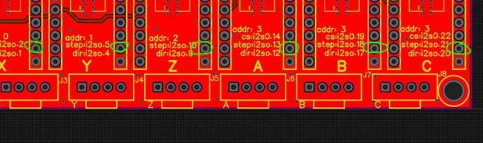

Could you not just skip this pin and use one of the 5V pins, and still use the regular step, dir, enable pins?
Jackpot is missing ESD protection for external drivers. That’s why I stopped working on my test setup and started playing with the Boxer board.
ESD protectoin for the expansion headers and maybe these stepper signals if we bring them out should be something we’re thinking about.
Ahhhhh, okay that makes more sense. Felt weird for it to be so simple.
Since I am poking around in the Jackpot I think I am going to start a new thread with some EE and jackpot NG related questions if you guys wanna help me out.
External drivers are supplied with their own power supply ideally anyway. So you’ve got a small 24V for the board and an 36 or 48 for the stepper drivers.
Also, external drivers use 5V logic (or 24 for closed loop, but that’s rarely used).
