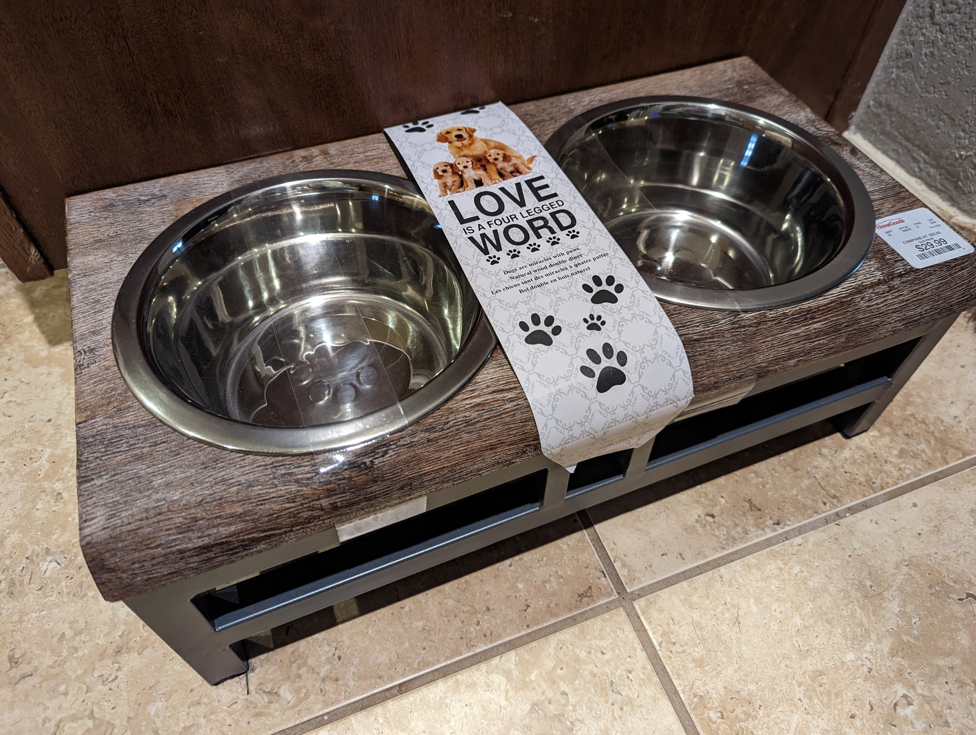

Cat feeding station

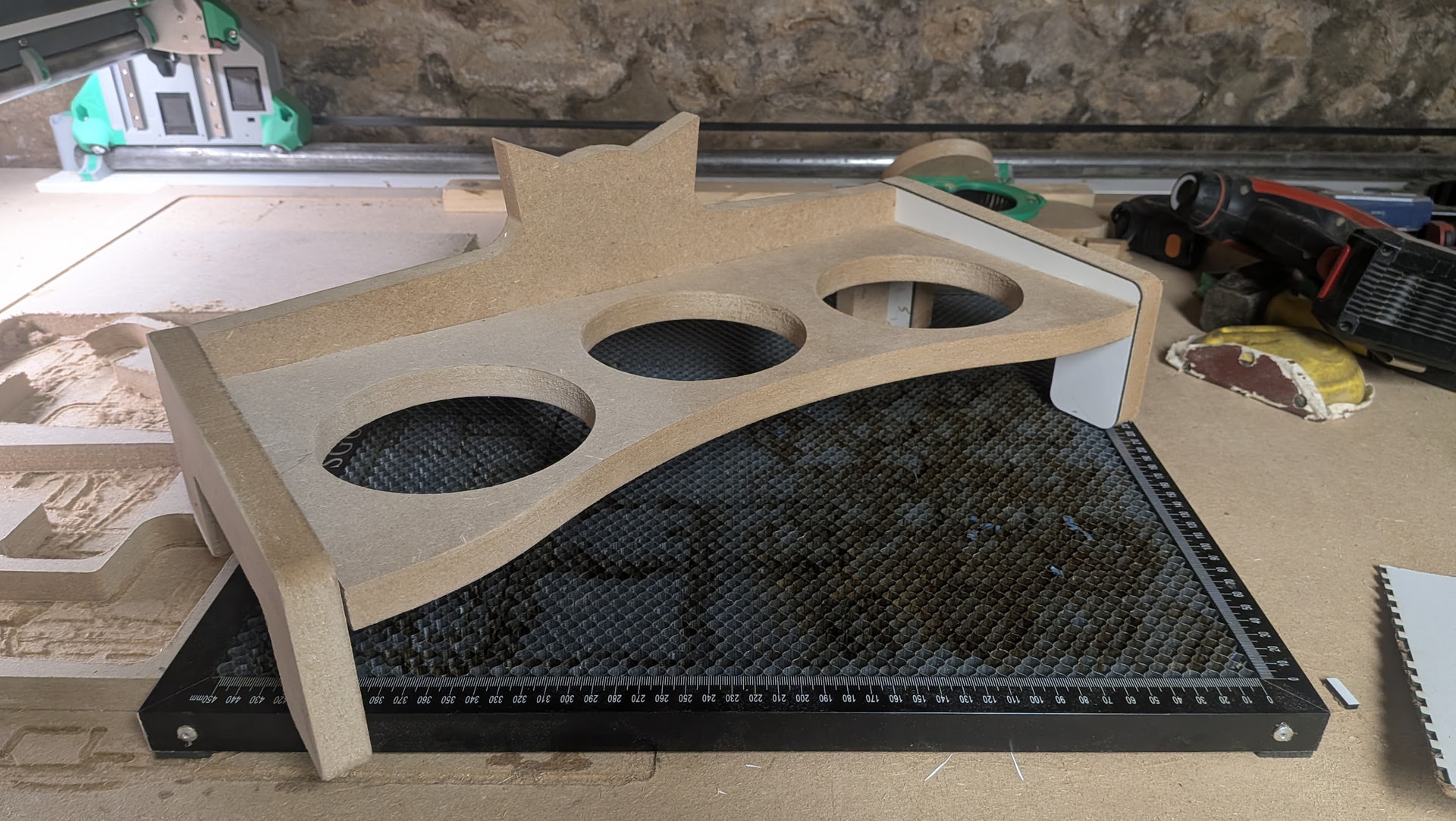

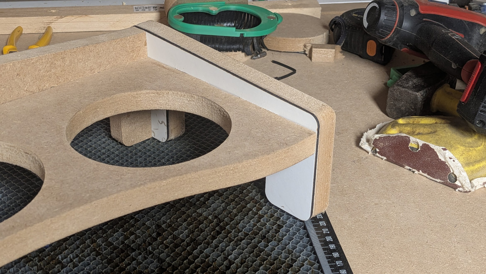

First prototype test with “Fibre dure” (don’t know the name out there…)
With an epoxy finish?
17858473823923027053777621389612
I’ve had good luck with UV cure epoxy and a heat gun (on thin layers at least). Pour the epoxy on, use the heat gun to make it less viscous and let it run. Bubbles pop in the process and you have all of the time in the world to make sure its all smooth. Use the UV lamp to cure it for 30 seconds, sand it down, then repeat on the off chance any bubbles made it through.
The downside of UV is if you pigment it. Then you need thinner layers otherwise the UV doesn’t make it through. Shouldn’t be an issue in this case though.

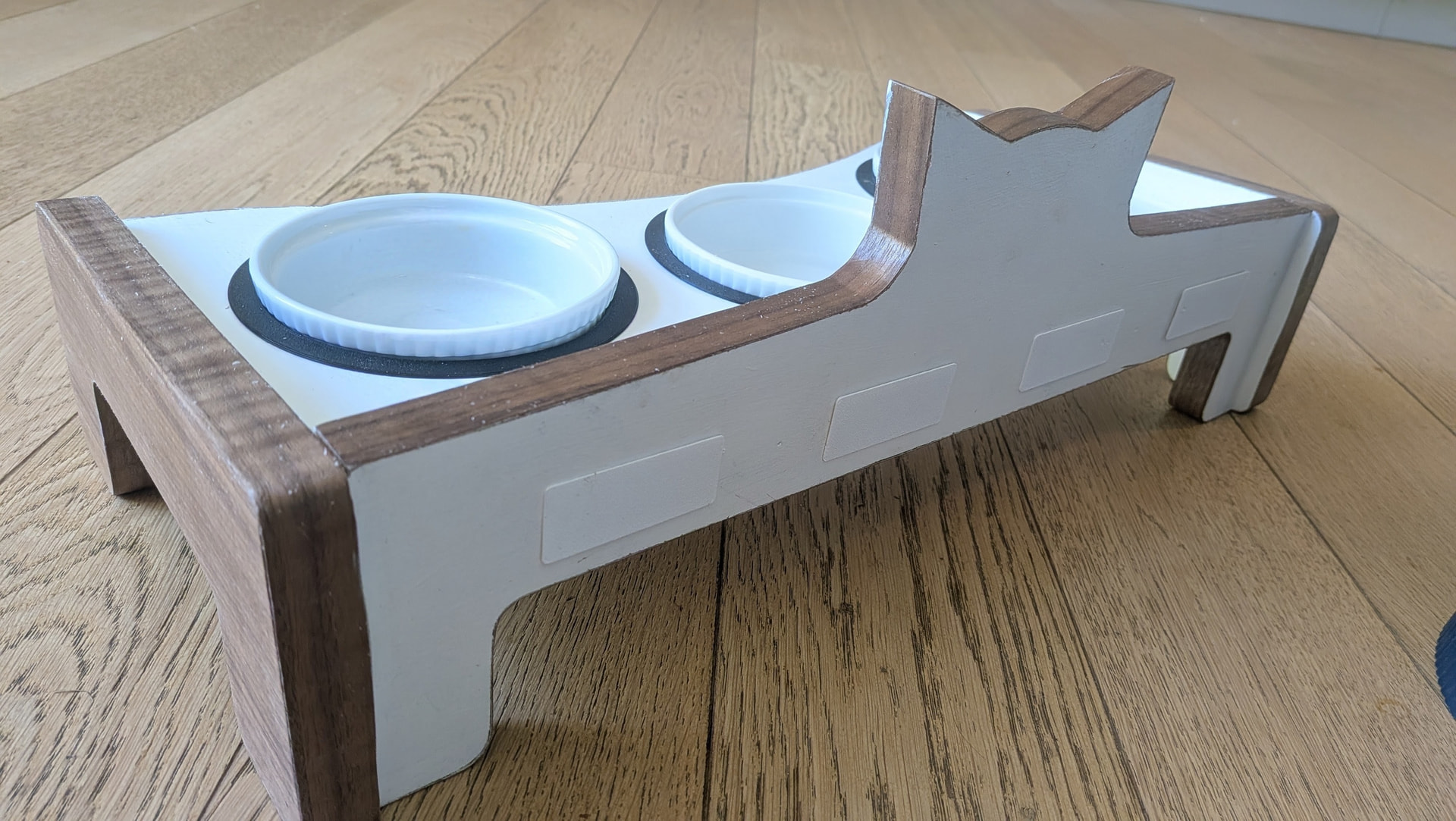

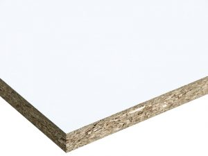

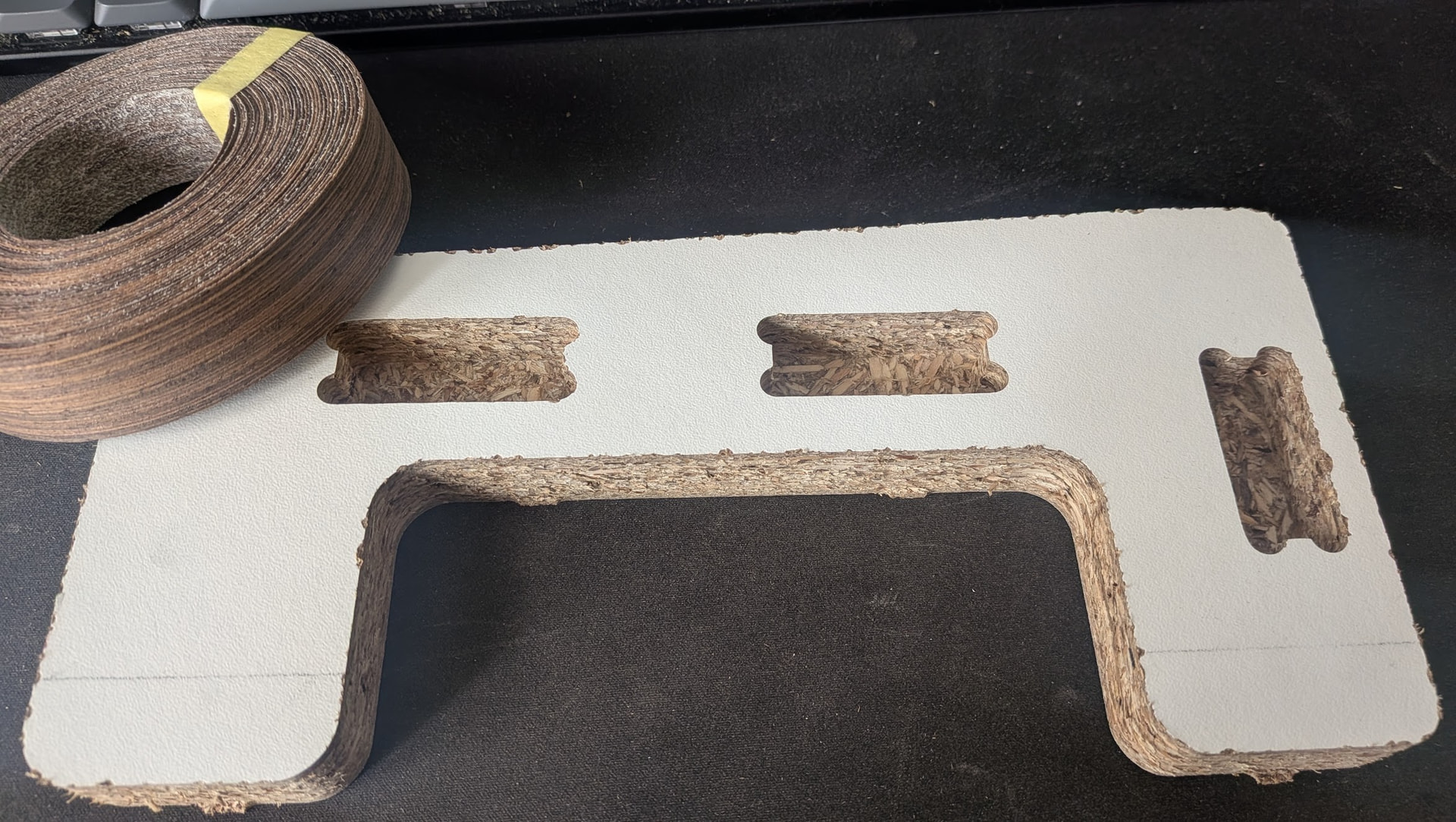

What if, instead of trying to cover the MDF with some palstic, I would just cut a material with this plasticy film already on it?
Well.. turns out this material exists, and it’s just plain melamine board… like..

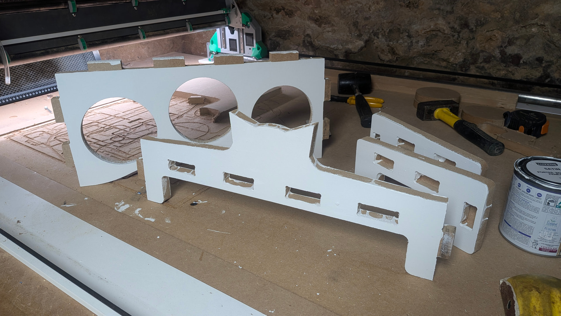

I have a lot of tearout though…
I need to work through my settings and see if I get better results with a downcut bit…
This one was with an upcut bit but finishing pass on each contour
The tabs are problematic too, will need another hold-down solution…
Not sure about glueing some veneer on top of the melamine too…
The sides should be fine, but not sure it will stick to the white surface
Anyone already tried?
Melamine is often used as a glue surface because a lot of glues don’t make a good bond with it. You would have to scratch it up and the use a specialized melamine glue to put a veneer on top.

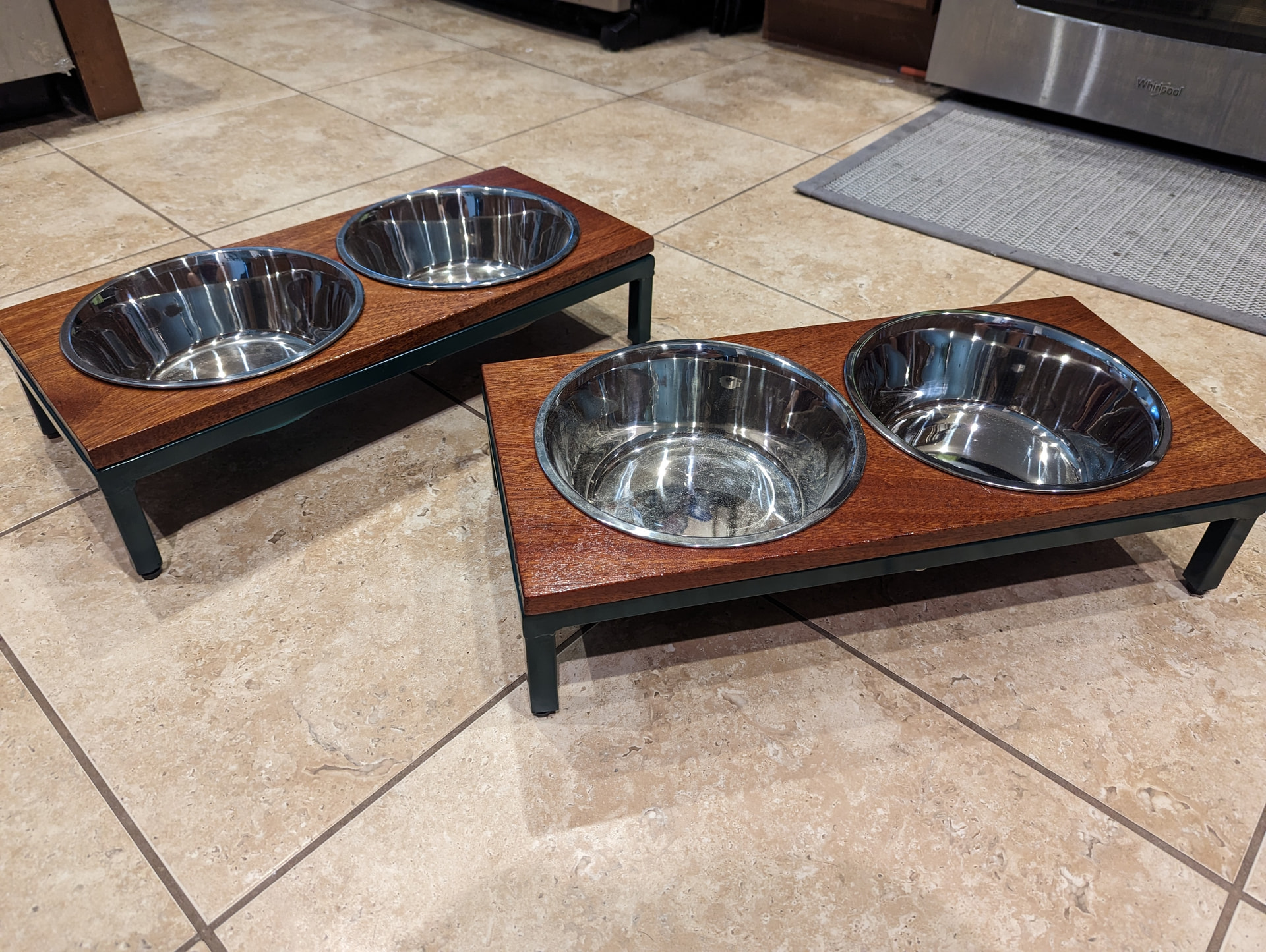

Cut the top out of woods that do ok around moisture… Teak, mahogany, cedar, spruce.
I made our dog’s bowls out of mahogany and just put a good oil-based penetrating finish on them.
By the time I finished, I had WAY more than the $30 this one would have cost that I got the idea from :slight_smile:
The last one was made with oak, but where I live, I can only buy shitty glued-up boards -_-
It bowed and cracked after only a couple monthes
Sure I could buy from a specialty store but they’re pricey and there’s none in my immediate area, so shipping costs a lot too -_-
Only way to get easy access to exotic wood is to buy terrace boards, and I’d need to joint them…

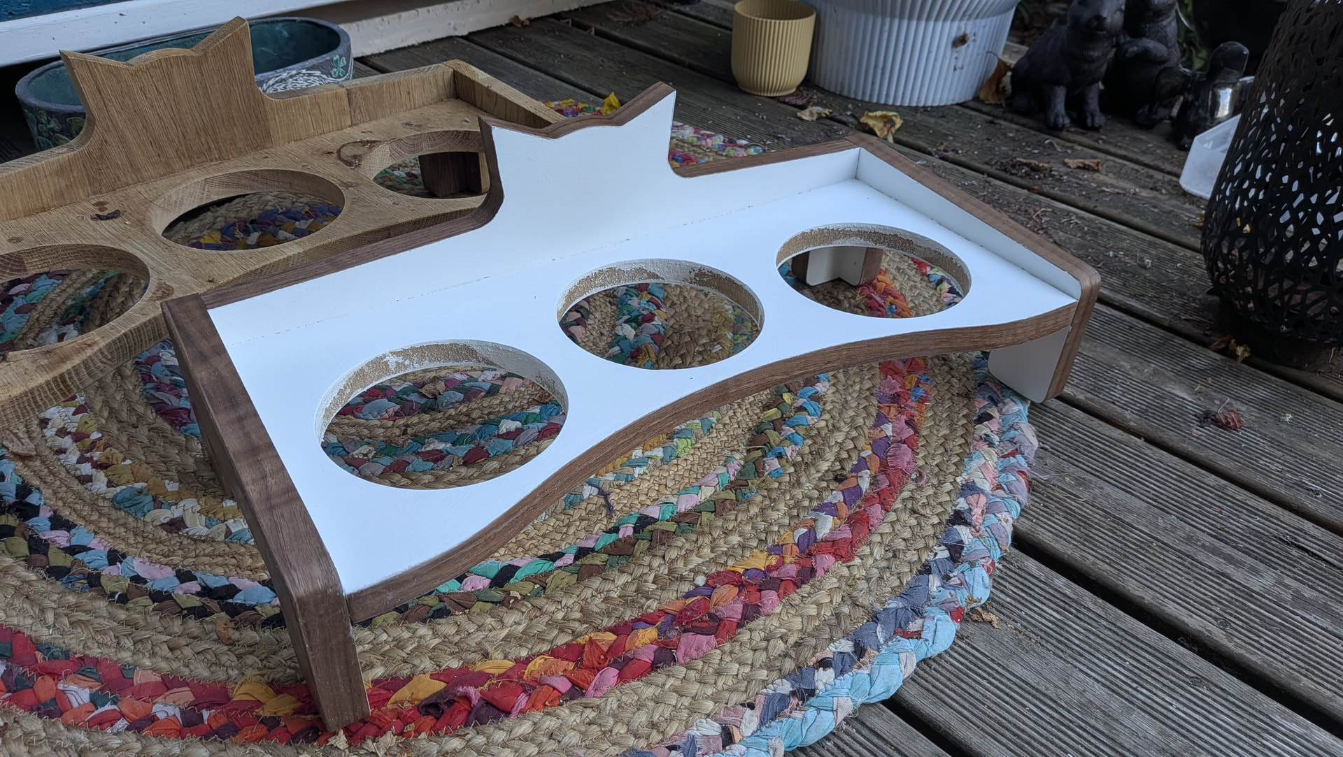

Well.. paint it is…
Thanks for sharing lovely to see your creativity! Inspires me to try more things!
Just a few finishing touches here and there and it should be good to go

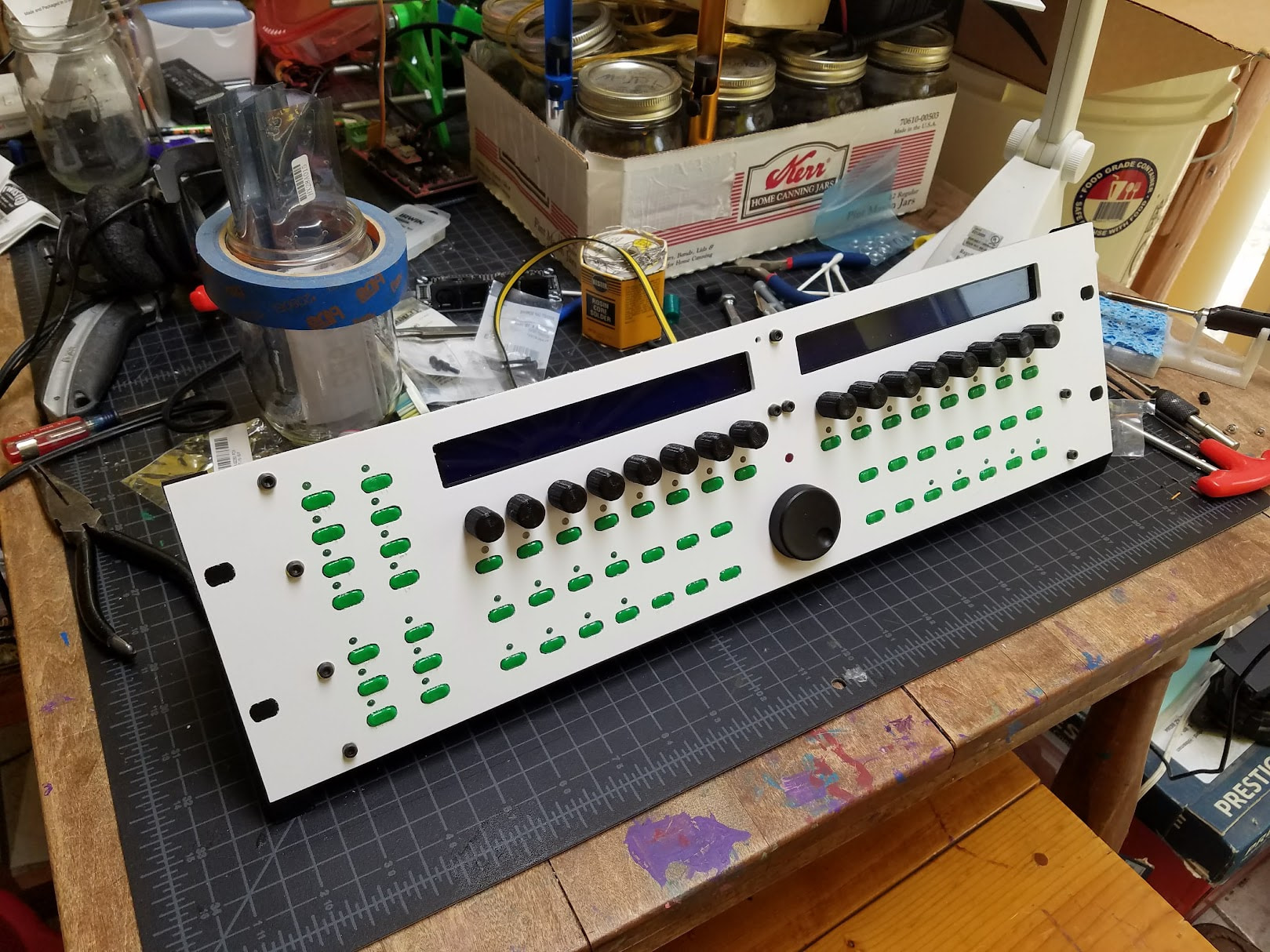

Might be too late to chime in but if you’re still looking for a material for the top my local big box hardware stores both carry a thin PVC sheet material that cuts beautifully. Last time I bought some it was really cheap but it’s a nice smooth white surface and machines very well.
I used it for a “temporary” faceplate on my midi sequencer about 9 years ago and it’s still holding up well:
The end mill I used was dull so it’s not the cleanest cut…but this stuff cuts so easily it didn’t really seem to care that the mill could barely cut MDF anymore other than leaving a few bits of plastic to sand off on the edges.

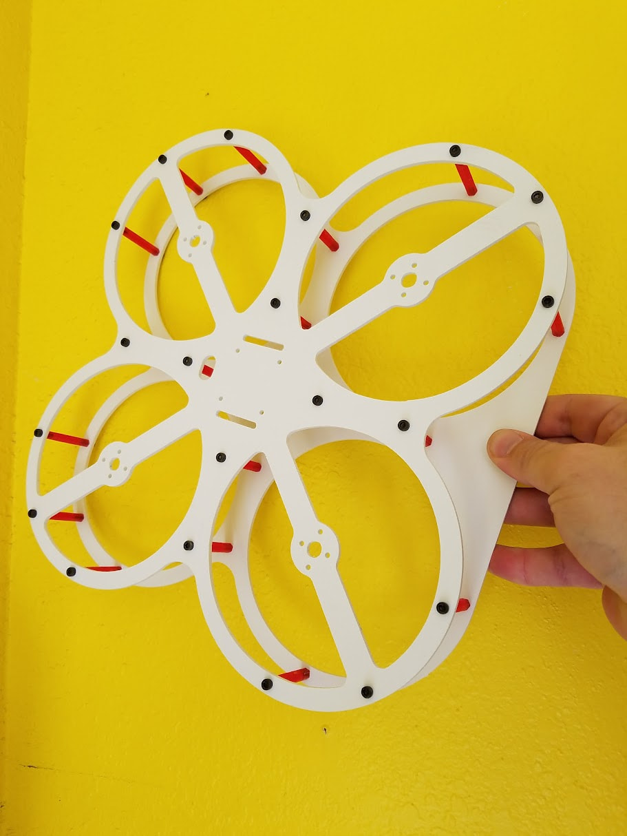

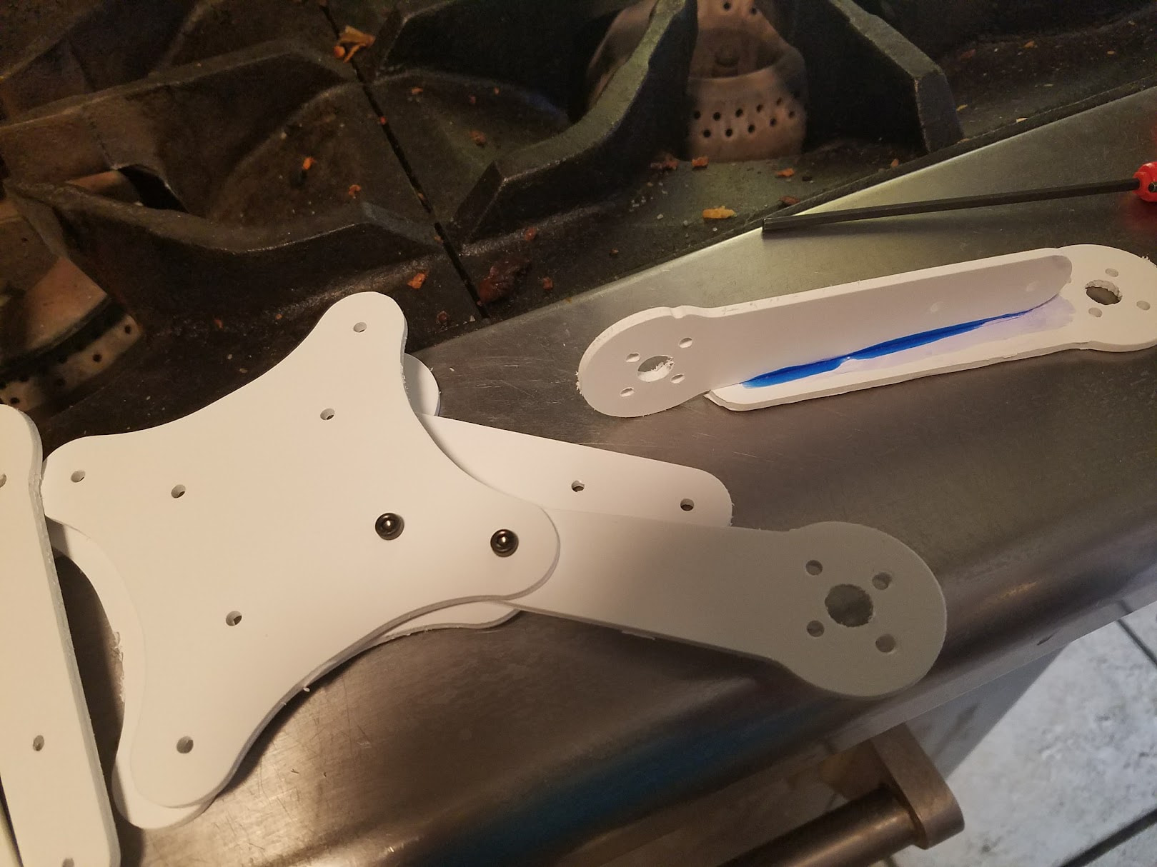

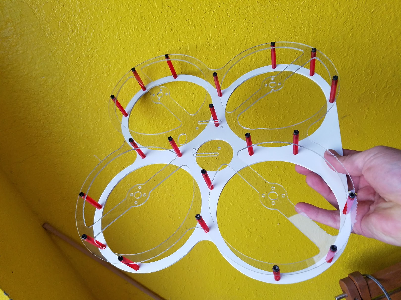

I had originally bought it to try making a quadcopter frame - I knew it was too flexible but I thought in a sandwich type of setup maybe it could work:
It did not :frowning: It wasn’t stiff enough even when doubled like that.
I tried pairing it with lexan instead but that didn’t work any better (ignore the terrible cuts on the lexan my feedrate was all wrong and my old machine was not nearly stiff enough for some of the things I tried to make it do)
I did some other tests with using PVC cement to weld stiffening ribs to it which showed some promise:
But to do it right I’d have had to cut slots for them and at that point it was just feeling like too much work to make the wrong material work just because it was cheap and locally available.

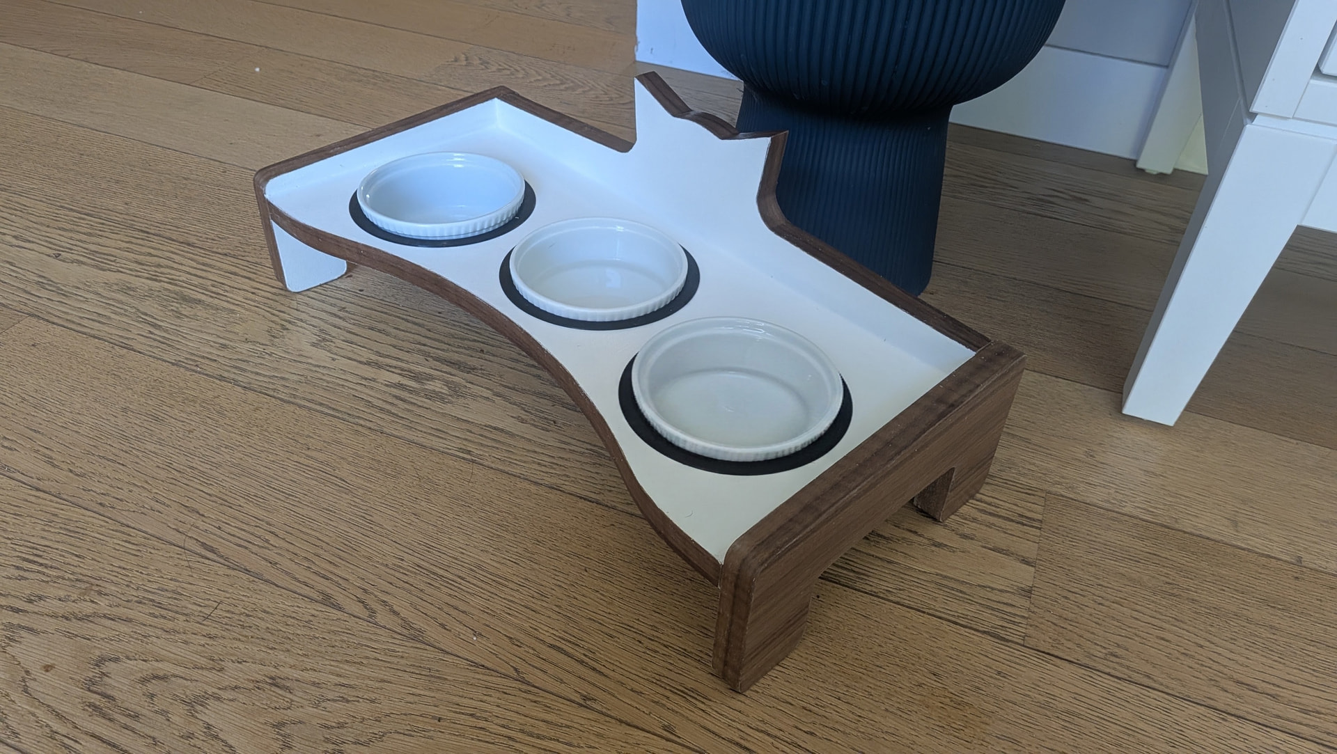

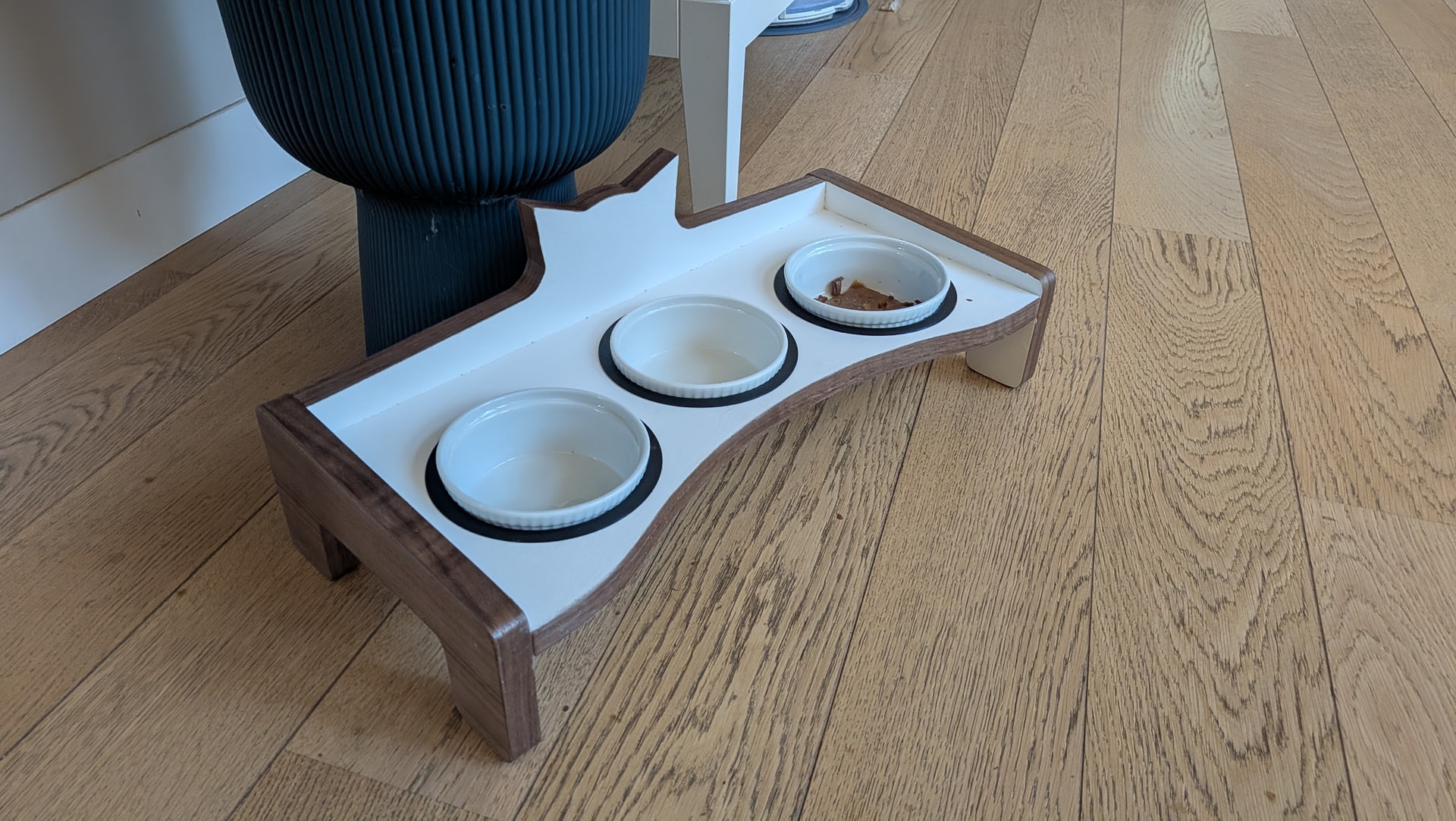

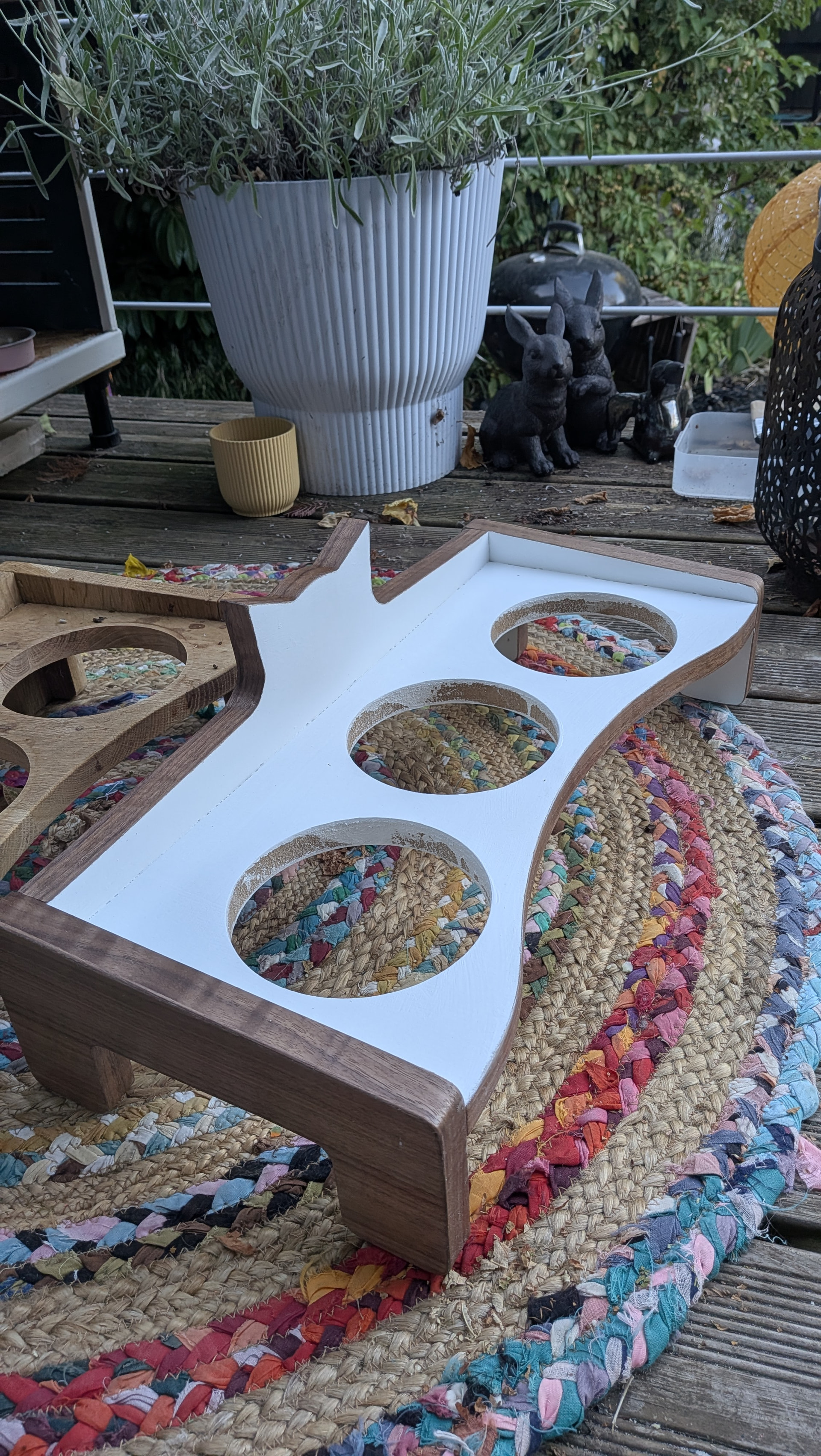

I think I’m done.. for now :slight_smile:
Made some small plugs to cover the through body holes on the back
Added some acrylic joints

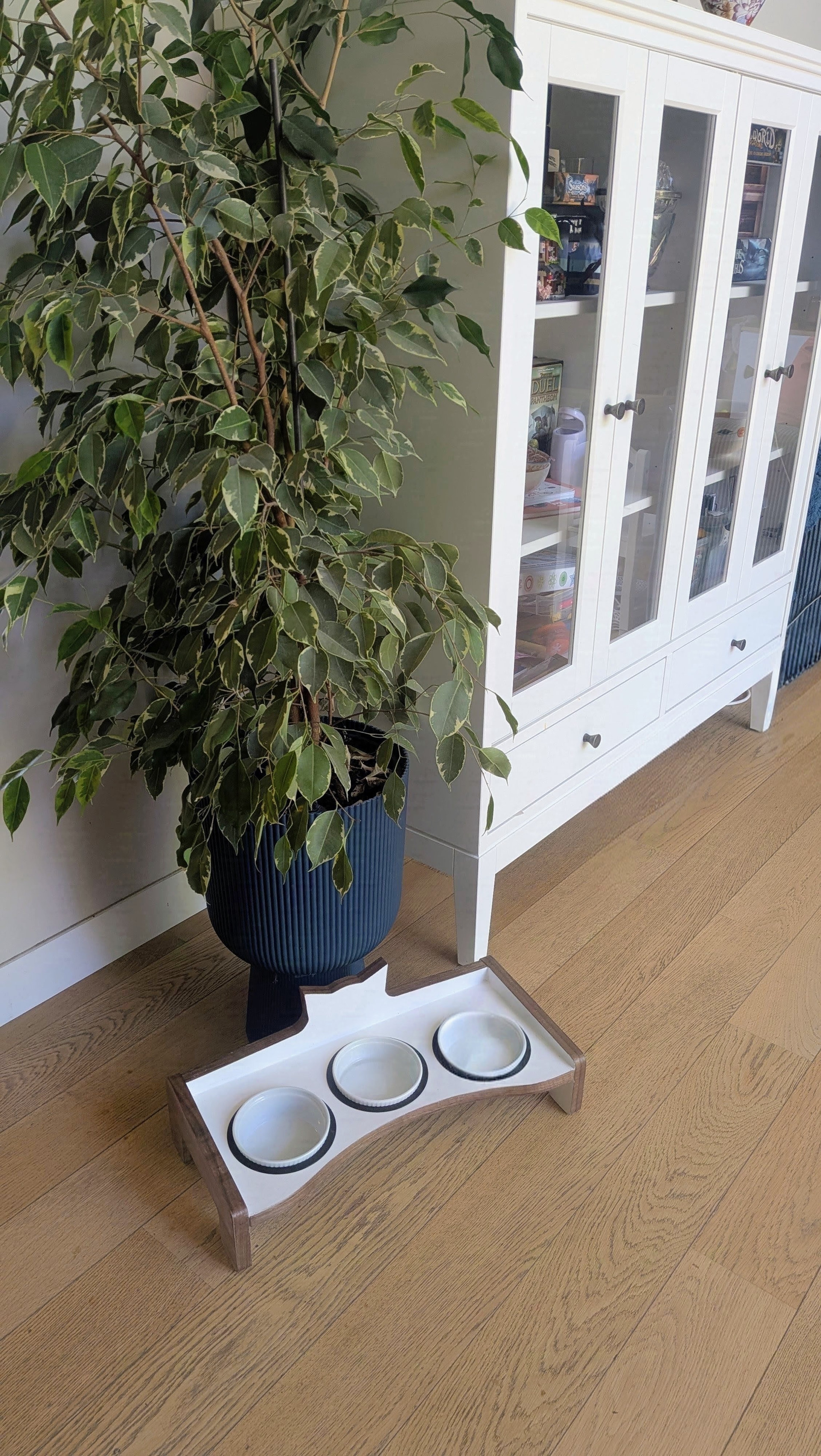

Very happy with how it blends in the house
That looks really good!
