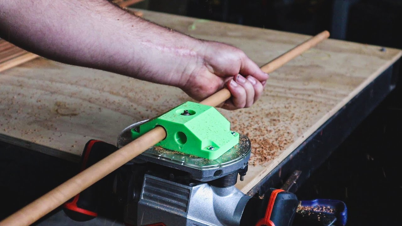

There’s also the possibility of making something like this if you’re super keen:
That’s almost exactly what I had envisaged, except with it being a bit more open at the start so it would accept wider stock, and with a pre-existing dowel or 3D printed part to feed the thing through. Could still do the half-assed lathe approach to stabilize the far end of the square stock to keep it straight in the jig etc.

If I wanted to make a 60mm dowel, my approach would be:
1/2" router with 30mm roundover
Cut stock to 60mm x 60mm
Router plate with a piece of scrap as a fence
Cut all 3 roundovers leaving ~30mm of uncut end.
Clamp the piece to the side of a workbench by the uncut ends to use the workbench as the refence for the last roundover.
You can do the same thing with a DIY router table setup pretty easily, too.
The nice thing about that is that it’s under hand pressure and following a guide bearing so no issues with deflection etc. It’ll also be sooooo much faster than a CNC approach.
The less nice thing is that you need to rip the stock down somewhat accurately to start with. That’s about the one thing that I think the rotary axis would do a better job of.
Anyway, just some random thoughts. Good luck and post photos :slight_smile:

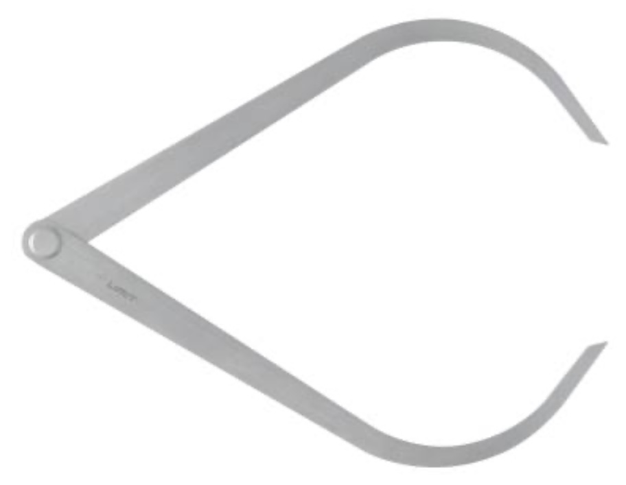

A one off, that length, is the job for a hand plane and calipers.
Knock the corners off to make the square an octagon then knock the corners off again to make a … hexadagon… maybe?
If you want o cnc something make a big pair of calipers to check your diameter along the length

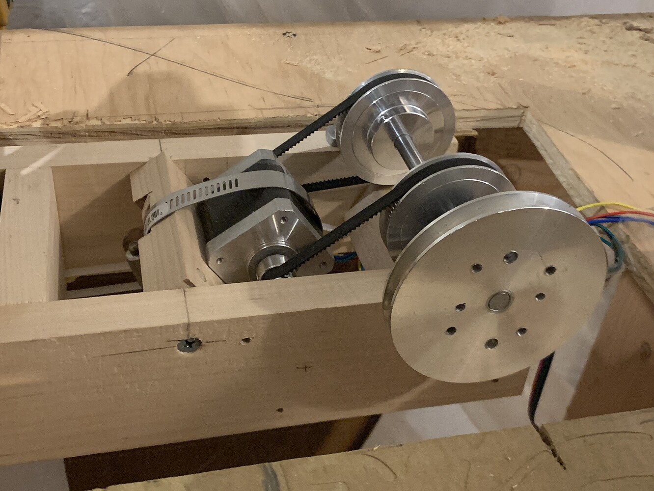

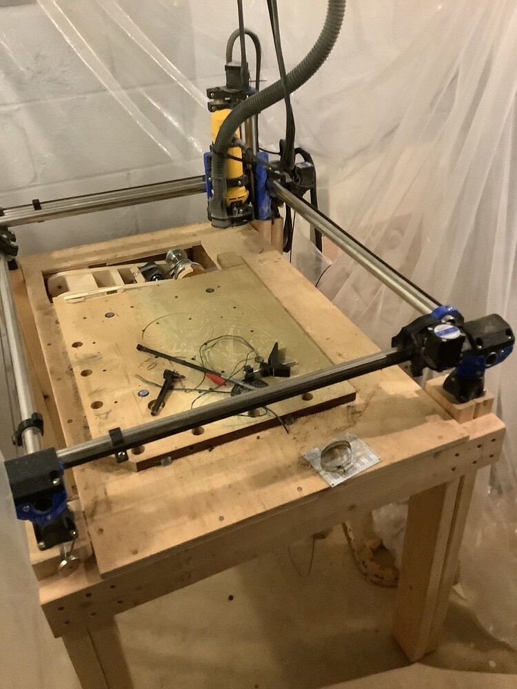

I have this setup to engrave with a rotary axis I’m making pieces that are roughly 70x80mm but only 19mm “long” (thick)
I have set up my primo mpcnc with a rotary axis. I use the last driver on the Jackpot board for a simple belt driven “plate”. I don’t use a chuck.
I can jog all 4 axes at any time, but I don’t have software that is truly 4 axis. I use V-carve pro for rotary work. I position my X at the axis of rotation and then the V-carve rotary job moves A,Y,Z.
It’s set up to make edge design on small pucks that bolt onto the rotating plate. I first cut blanks with a flat XY job. Then I mount my “ hockey puck” onto the plate for rotation cuts of the edge shape and engraving This works well for hardwood.
If I want to work in a larger diameter size range I can pivot the whole rotary drive lower. At some point I would probably have issues with the stepper not holding against the greater leverage with a larger radius but I haven’t tried that.
Vcarve has “wrapping “ for spirals and fluting. Think of the old craftsman router crafter and it can do all that.
It can also import a.stp file and make roughing and detail cuts on objects based on cylindrical coordinates. Most chess pieces look like lathe work except the knight. It can carve them all.
Thirdly you can use engraving or texture toolpaths and apply them onto the 3d model.
BTW I don’t have to make any physical changes to the machine to go from XYZ jobs to AYZ
I have a different post processor for each of course. All my gcode file names start with F for flat or R for rotary.
For rotary I use my touch plate on the edge of the round plate and account for the radius. Rotary jobs work best if Z Zero is the axis.
Thinking through the options is half the fun. I hope seeing my take on rotary helps.
