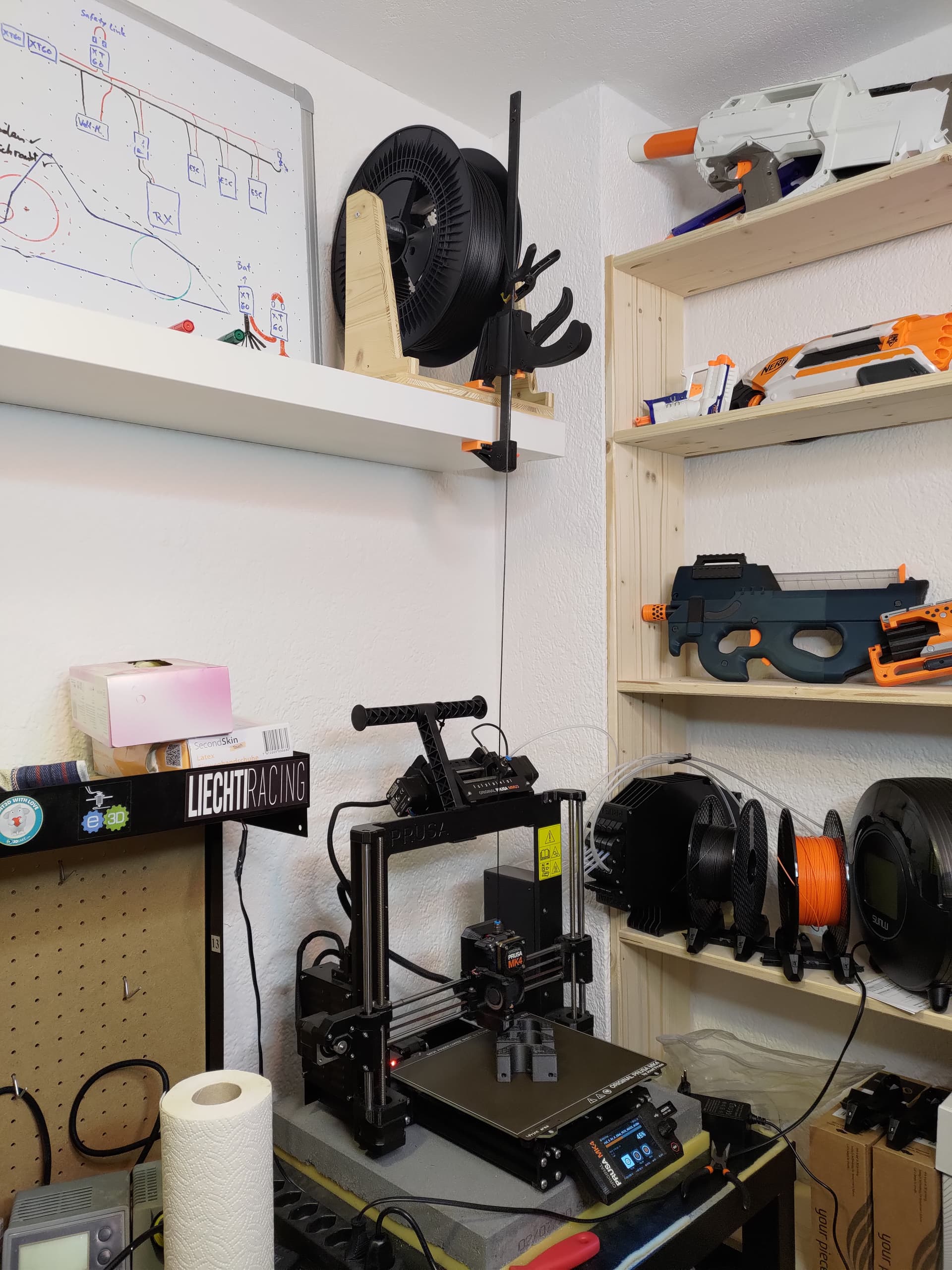

The 2.5kg spool also needed a bit of a special setup to print…

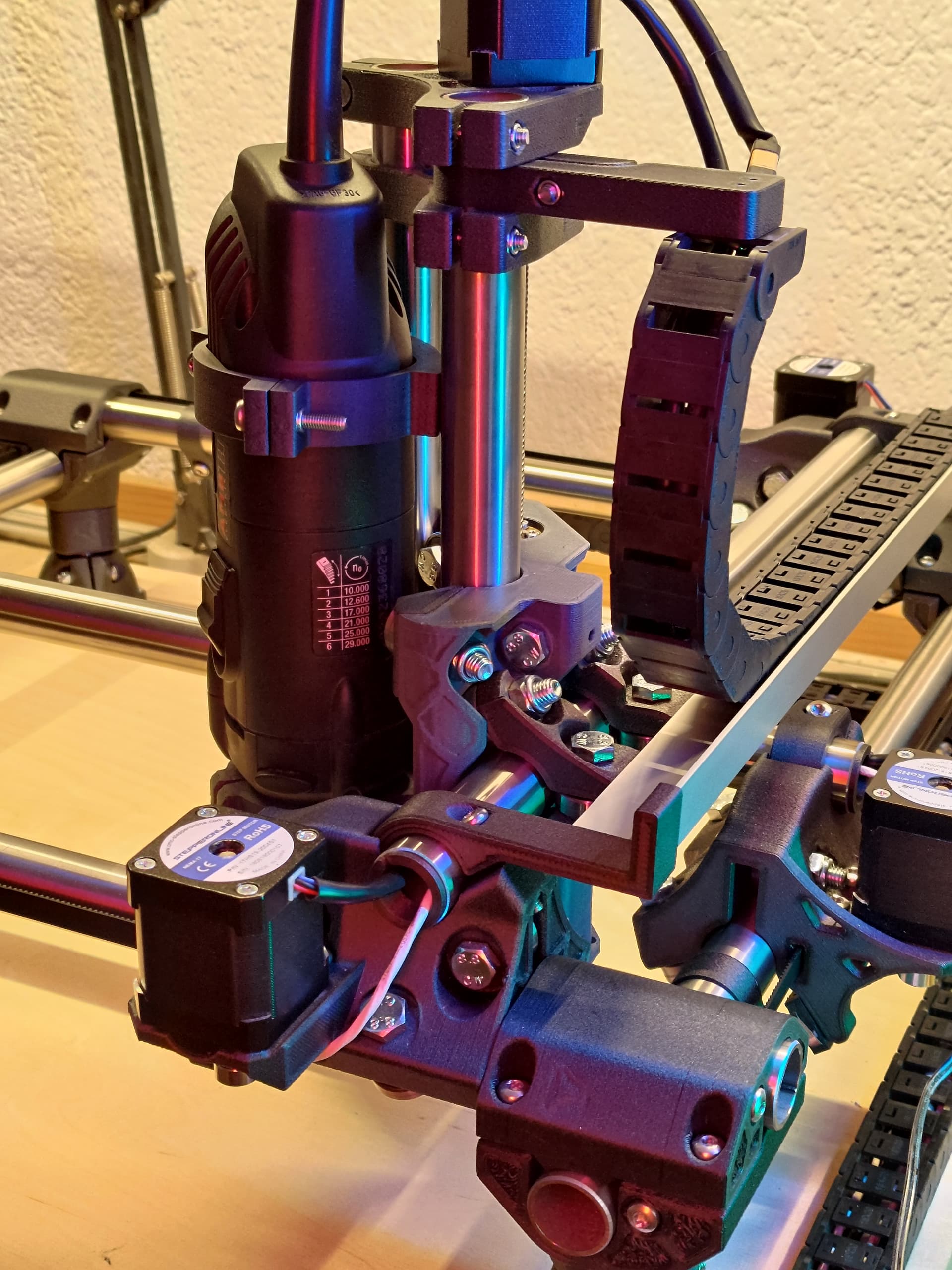

I have about 600g of Prusament PCCF left over from another project and was thinking about printing the core from that. That would leave me with ~100g left on the spool, what other parts would you recommend to be printed out of PCCF?
I was thinking the Z axis parts?
Ryan is going to have the best info on what parts get the most stress. Personally, I’d do the tool mount in PCCF. I’ve broken my mount a couple of times, and ended up beefing it up somewhat.
Unfortunately, the last time I took a look most CF PETG was less rigid than regular PLA. The best you are going to get is some added heat resistance.
So far I printed all the parts with 2.1mm thick walls, that should help with rigidity. If it turns out that some parts are still not stiff enough I can reprint them from CF HTPLA or PCCF…

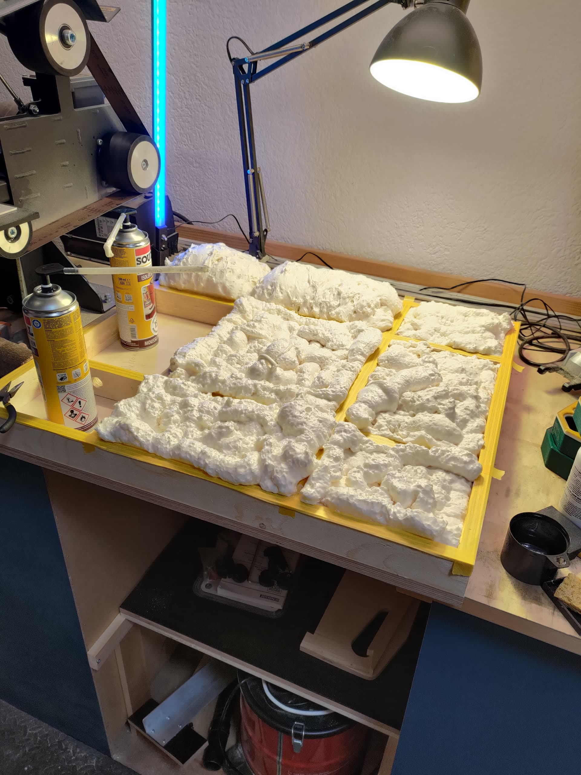

Torsion box base
Filled the chambers with PU construction foam, 2 were left empty for the electronics

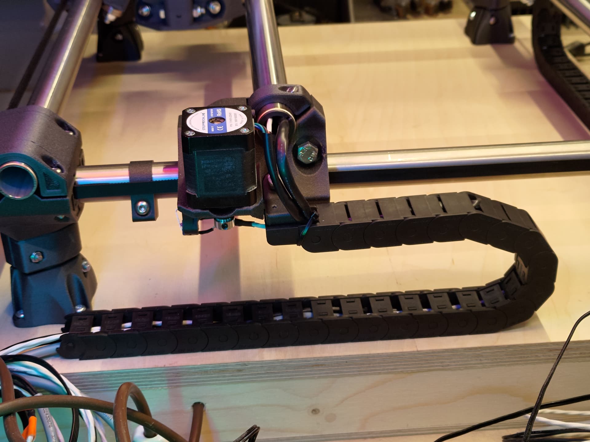

Cables are managed :smiley:

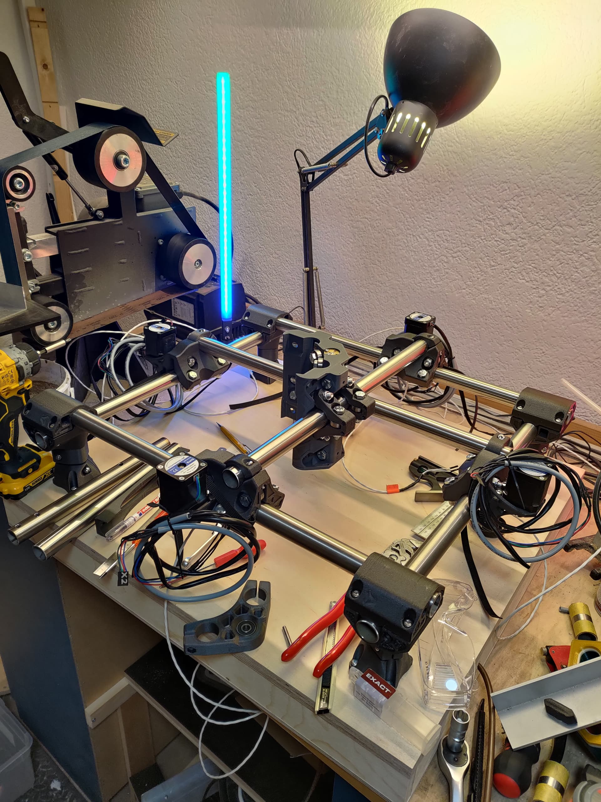

To do:
Connect the electronics
Install the wasteboard/T-track
Install firmware
Get it calibrated
Looks solid! Why the foam?
It’s supposed to dampen sound and vibrations. No idea if it will do anything, but it also didn’t cost much…

It will help a little, at least it will stop the table amplifying sound, it won’t do anything for the airborne variety. Think of a guitar or violin body, the sound boxes are actually tuned to amplify the sound in a specific way. Our tables are like cheap ukuleles!
I thought about randomly spacing the webs in my last table to give a variety of pitches of resonance for each square, in the hope that they would magically cancel each other out, but then I looked at the maths involved and thought… nope! :rofl:

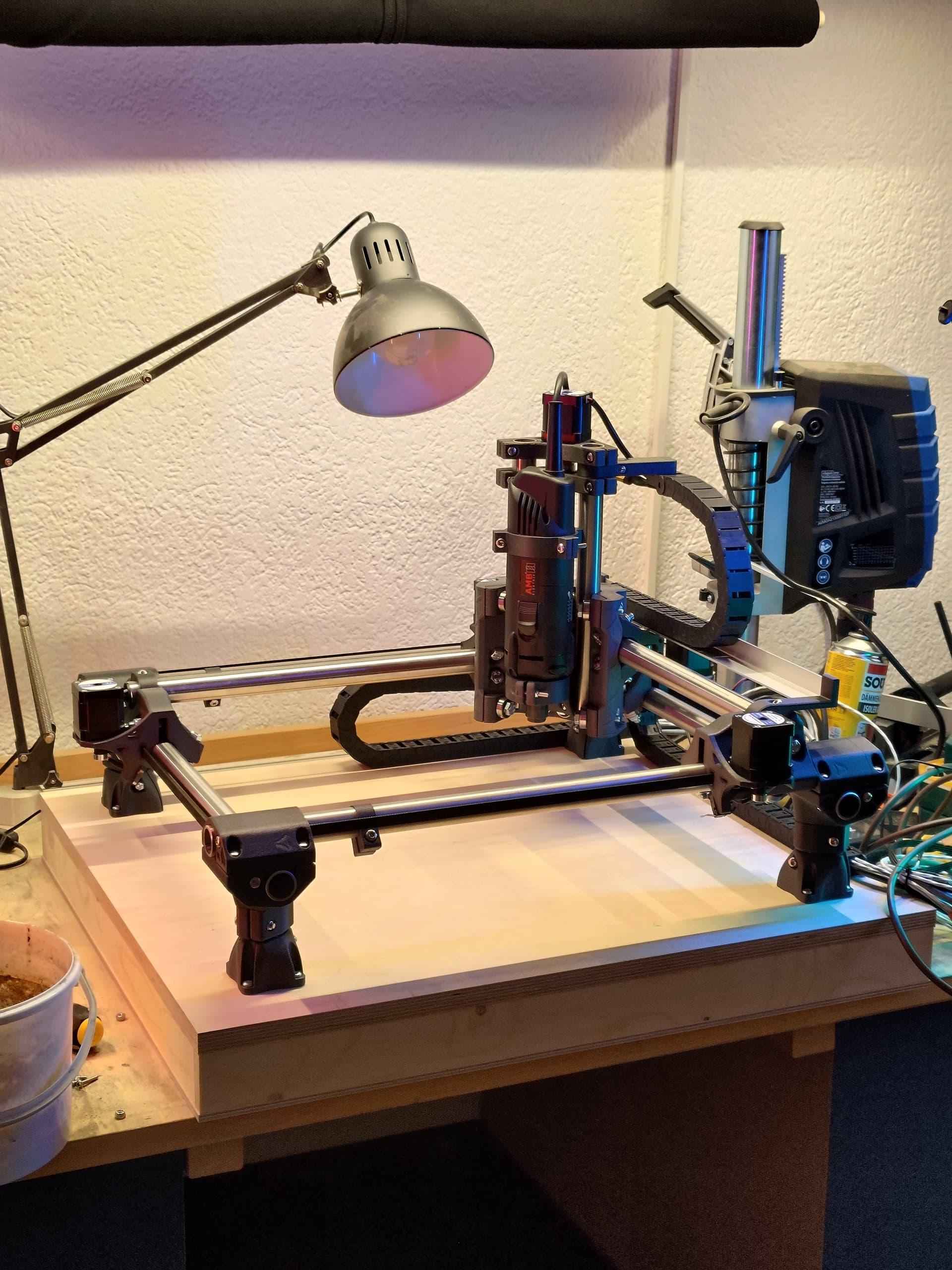

It’s finished!
Calibration is done, crown drawn, ready to get it dirty :smiley:
