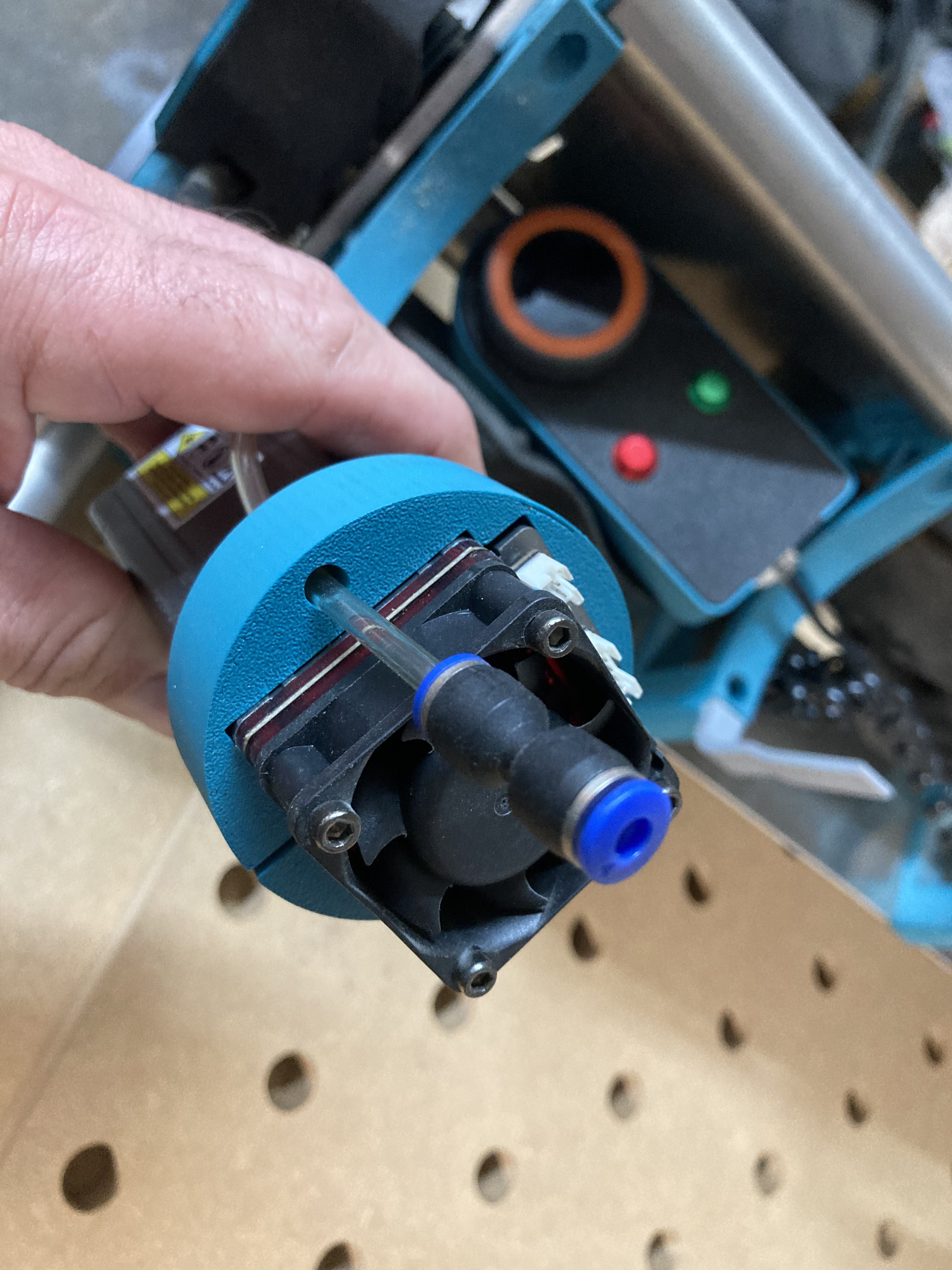

Last night I took a few photos of My daughter and “developed” it on the lowrider directly on canvas. 400x500mm canvas and some black matt spray paint. 11w diode laser 8000mm-sek/pw75%

That’s great, thanks for sharing. How did you get lightburn to burn it diagonally, or does it do it automatically if you do a raster image?

Scan angle 45 deg. Choose a dot raster like Javis or Dither. Make laser setting slightly out of focus for a more smooth appearance specially with portraits.
Wow, NICE! Love the setup! I have a diode I could mount to my LR4 like you have done here. I think you already shared your mount, and I’m now thinking I need to go find that!

Start buying 10 small canvas to try different settings on. Start spraying a layer of white so the underlying color is more vivid. One coat of black is sufficient. I find matt spray paint the most appealing. I tested both premium quality paint but the cheapest look any different. Fun to retouch with spray afterwards you print.
Can you tell us exactly which laser you have installed?
Neje E40
