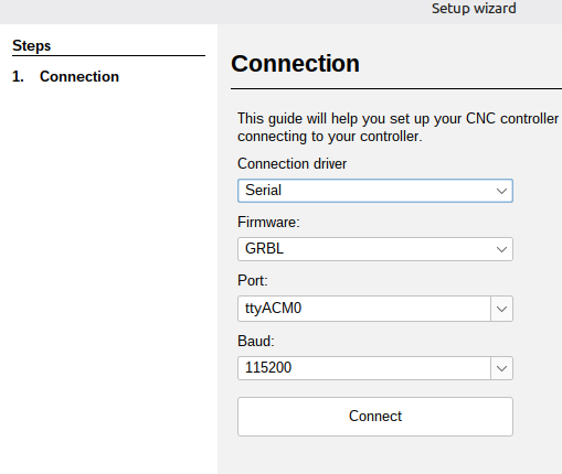

I’ve got it flashed with the V1 SKR build once more, and I’ve got Universal Gcode Sender running on my machine - it’s Linux Mint, not sure if that makes a difference. It’s connected by a regular old USB cable.
I went into Machine → Setup Wizard in UGS, then configured it thusly to match the serial port baud rate in Touch Mode:
Not sure if it makes a difference but there are no other options in Port
I set the SKR to Marlin Mode and restarted the SKR, then tried to connect. It shows the following:
** Connecting to jserialcomm://ttyACM0:115200
*** Fetching device status
An error was detected while sending '?': echo:Unknown command: "?". Streaming has been paused.
*** Fetching device status (2 of 10)...
*** Fetching device status (3 of 10)...
*** Fetching device status (4 of 10)...
*** Fetching device status (5 of 10)...
*** Fetching device status (6 of 10)...
*** Fetching device status (7 of 10)...
*** Fetching device status (8 of 10)...
*** Fetching device status (9 of 10)...
*** Fetching device status (10 of 10)...
*** Connection closed
