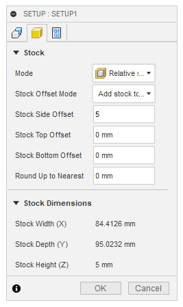

Then you will need to set up the stock.
Personally, I always use a Relative size box and either “No Additional stock” or I’ll add a bit of stock to the sides as I’ve done in the image above. By default, there will be some stock added to the top, so you will need to zero out that value. You don’t want added stock on the top.
Repeating, you will need to do a setup like this for every indepentent job on your machine.

In the stock tab, set the Stock Top Offset to 0. The side offset will result in the milling beginning inside the stock rather than at the edge of the stock. This will help compensate if the stock is not mounted perfectly square with the machine. Alternately, you can select “No Additional Stock” and simply place the origin of your job (i.e. the tip of the router bit) slightly inside the stock.
