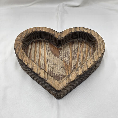

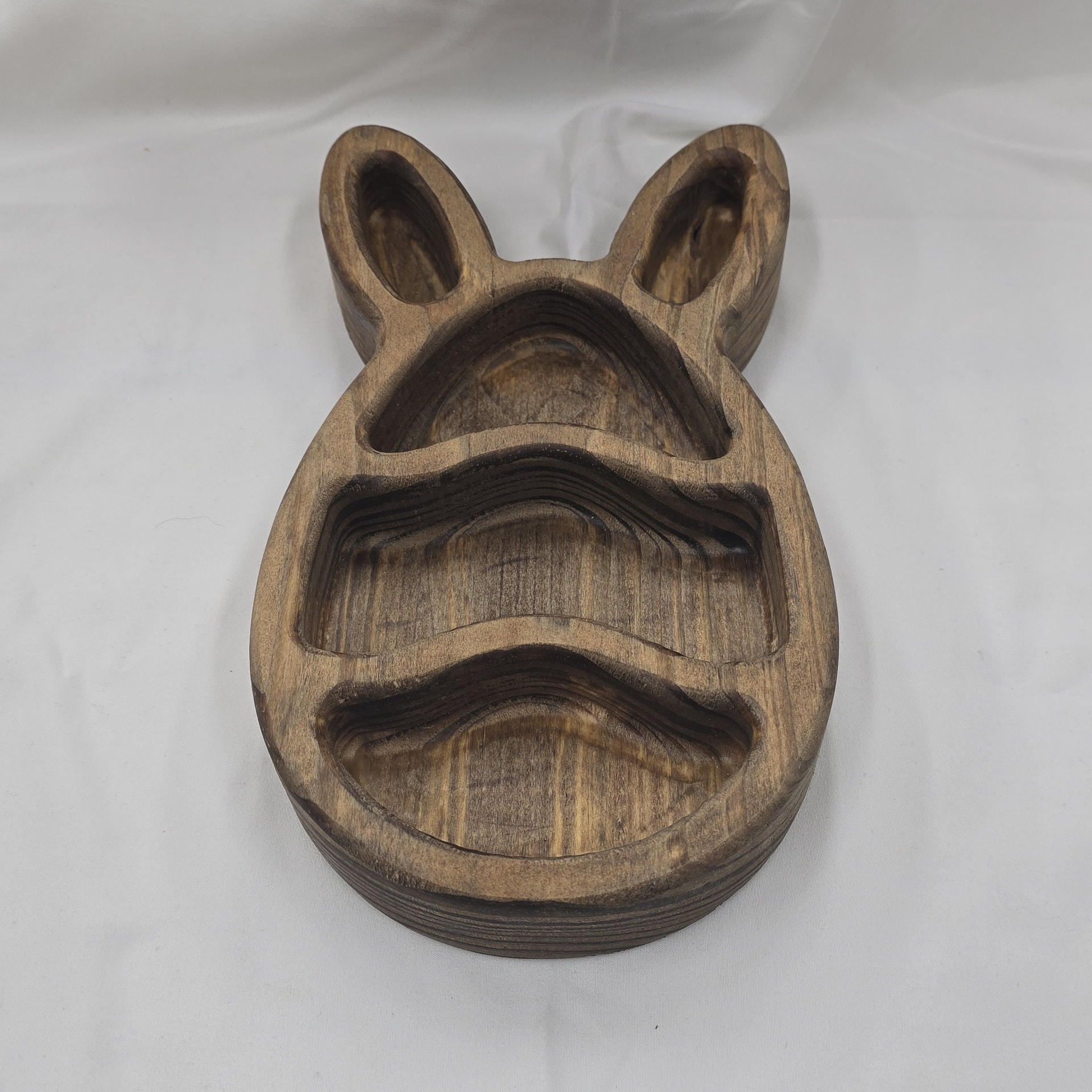

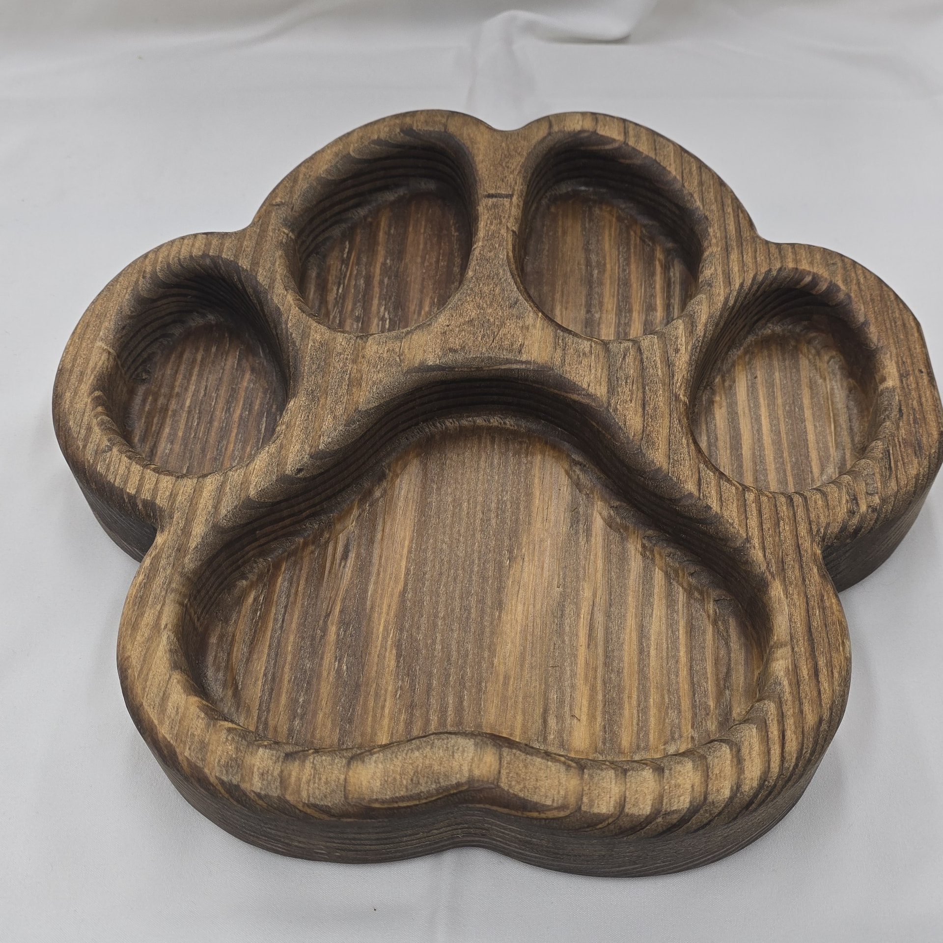

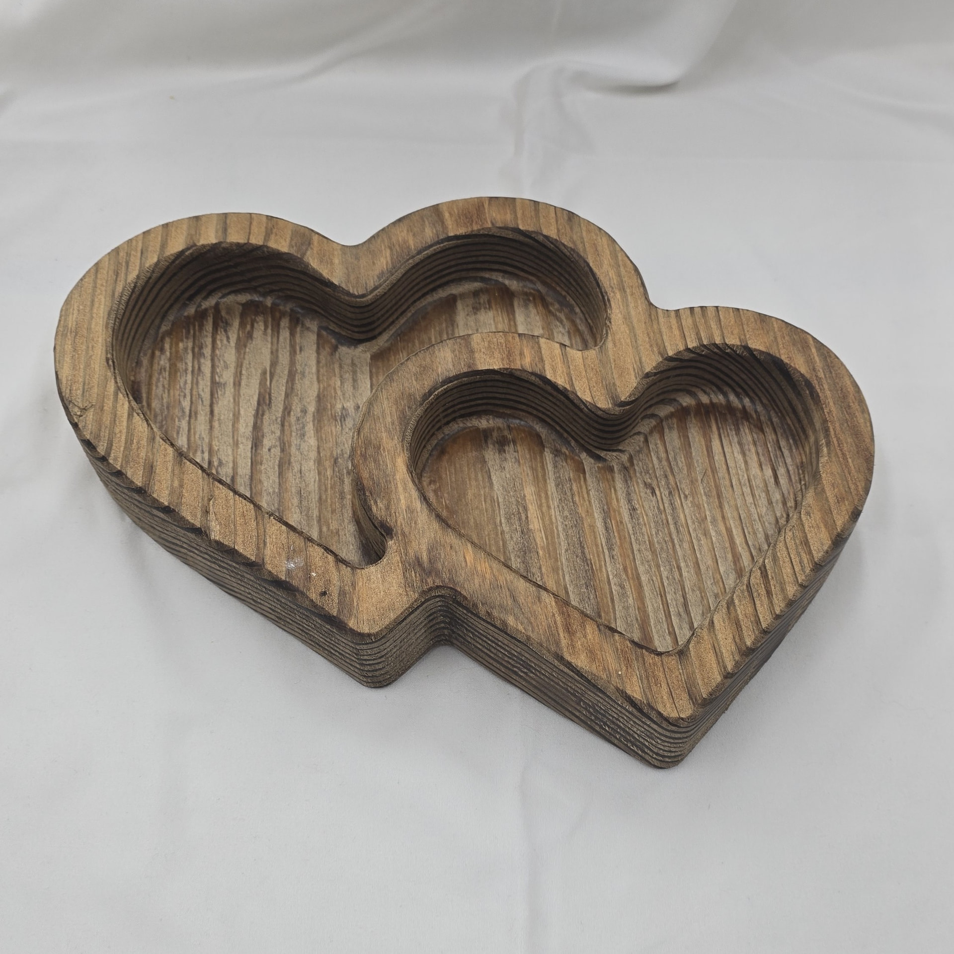

I started making these. I am using a Bowl-Cut Jenny bit from Cadence MFG. I am using their default settings for it (120 IPM). It cuts really well and the LR4 as no issues with this speed. I am doing 2 operations, a pocket and then profile cut. These are finished with a food safe finish. I actually offer 3 different finishes. The wood is just plain pine. It is actually a 2x12 construction lumber. These have been a pretty good hit so far.
I like them, I really want to make such a bowl for myself.
Did you do everything on the cnc or did you do the top with a router jig/table?
Everything is done on the CNC. I first pocket out the dished part with a bowl bit. Then I switch to an end mill and profile cut the outside.
