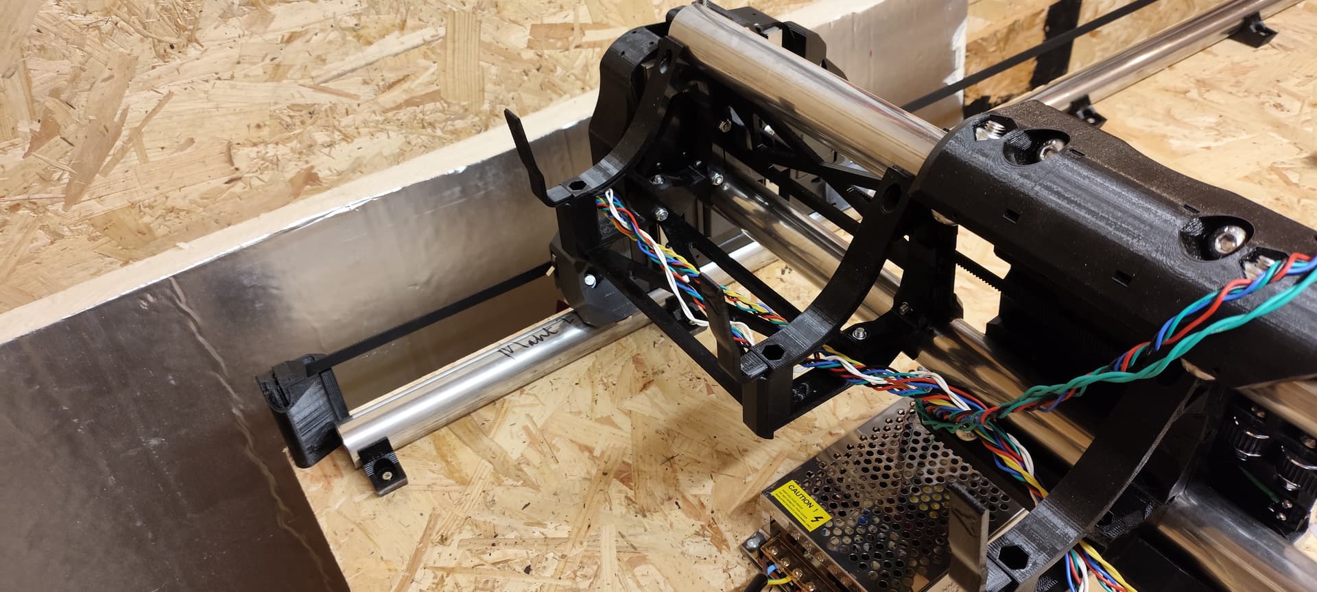

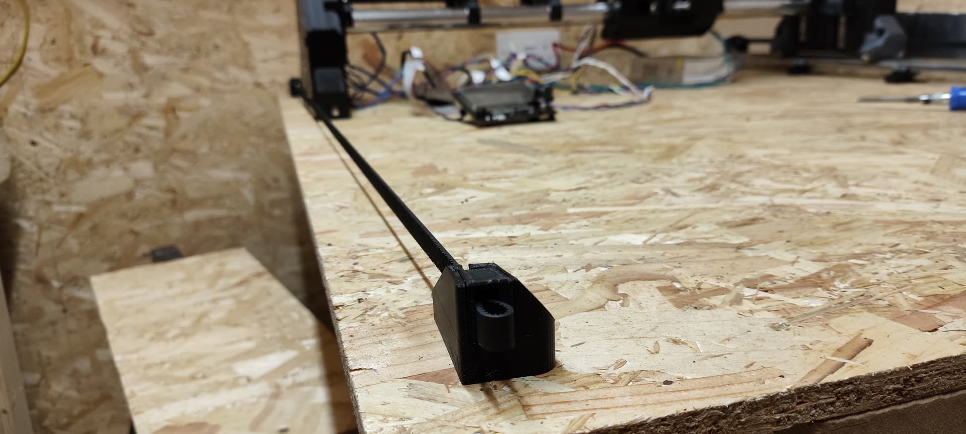

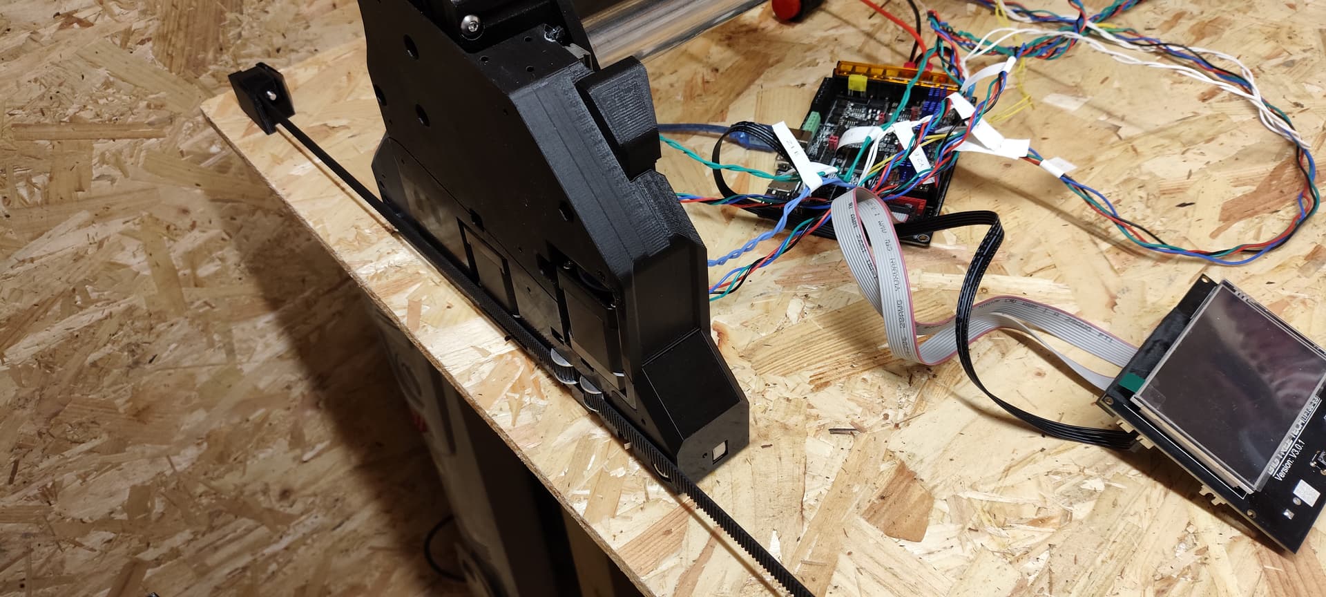

My build has a Y axis endstop facing forward and one facing backwards, and it seems both of these have to trigger for it to home properly. But if it homes in one direction only, this obviously wont work.
Can someone explain how I can get this working properly? Is it mechanical assembly or firmware issues?
Pics for context

Your assembly looks right to me. There are (normally unused) slots for rear switches on both cars. As long as you have the ‘front’ switches (actually sticking out the side) on both cars, you’re good.
If your machine moved backwards on homing, flip your stepper connectors into the board.

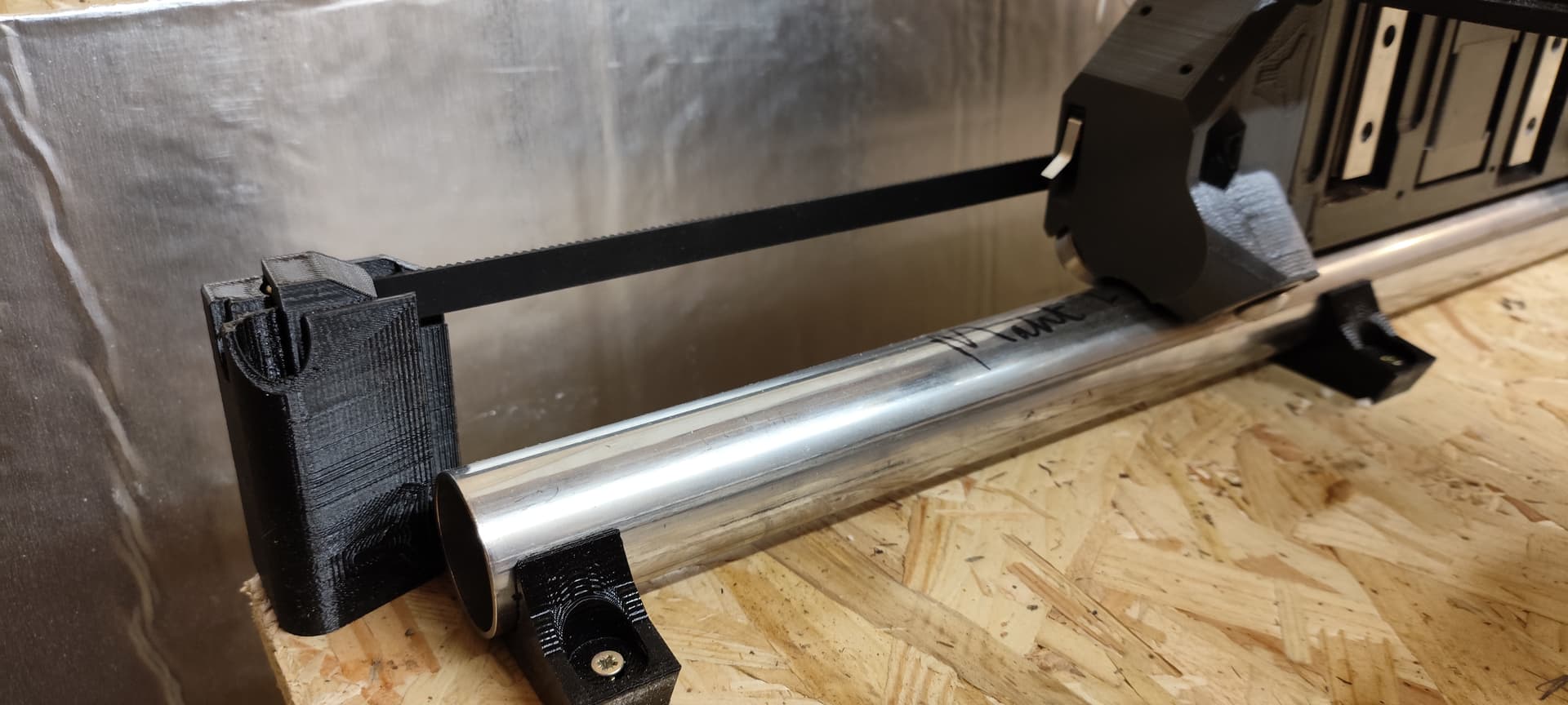

What’s throwing me here is only one of the switches is sticking out of the side.
There’s another one on the opposite side that’s pointing towards the rear, in the opposite direction.
So it would seem this switch needs to be moved to the underside switch slot on frontwheel_min (i think. …this would be much easier to refer to with a CAD assembly!)
the hole it is there for those who are going to be homing to the back ( if you are going to home to the back you arent populating the front ones) just leave them and dont connect them

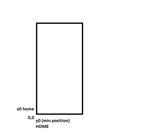

what happens when you move your machine y +10 ( moves back or to the front according to the image?) - if it moves back just turn off the power and flip the conector to The driver
So if I understand this correctly, the machine should home towards me if I’m standing in front of the table in your diagram (closest to 0,0).
The X axis seems correct in this case, and it’s just a case of moving the switch to the underside on one side, and flipping the y direction.
Correct!

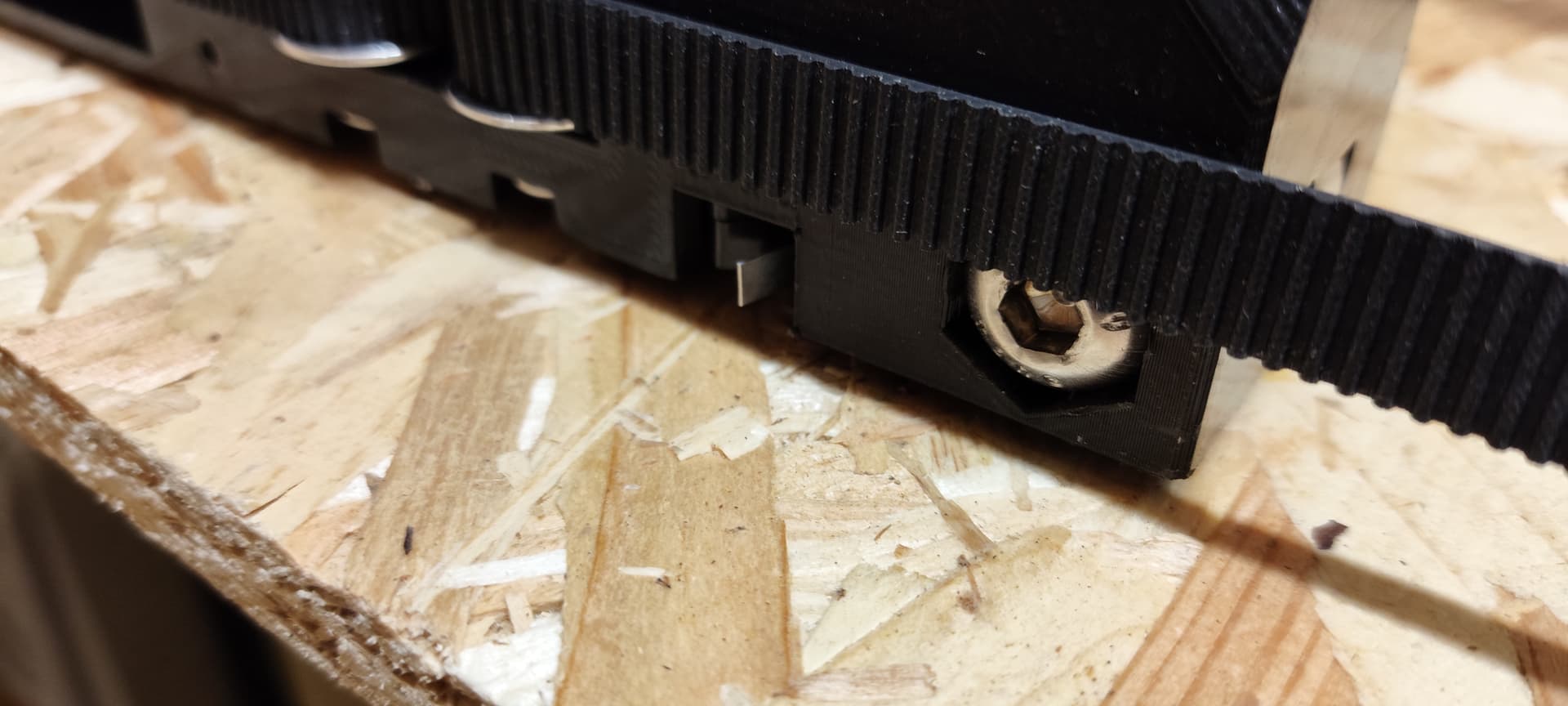

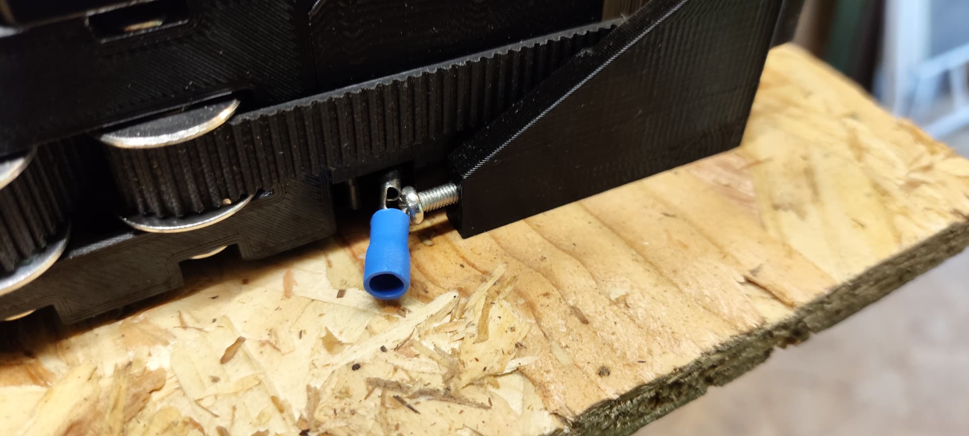

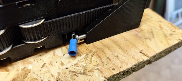

Ok I got it working! I moved the switch as discussed, and it crashed a couple of times, so I put some spade connectors over the microswitch levers on each side and it’s homing pretty reliably now.

I think maybe you can flip the switch either over or end for end, it will be the reverse of the other side.

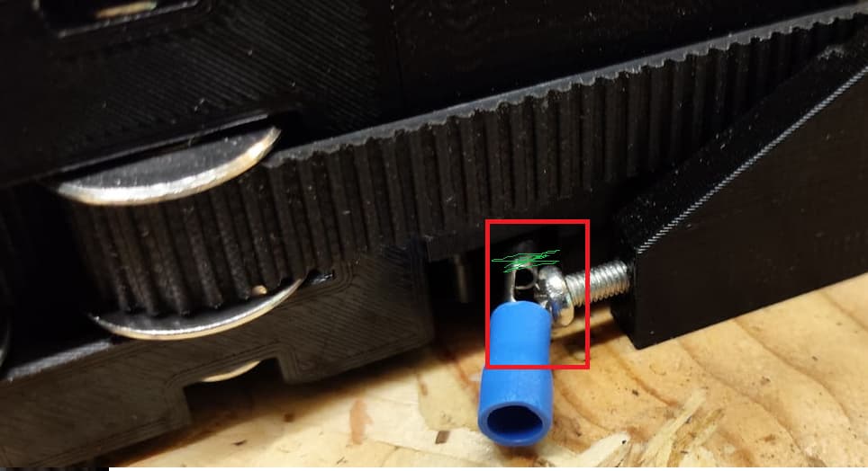

his issue is that the levers on his switches are on the smaller side.
the lever don’t stick out enough
The pic isnt so clear but they stick out enough to make contact when the spade connectors arent attached. The problem is they then clip past the bolt im using. The switches I used were the ones specified in the BOM, but I guess the lever isnt long enough.
Anyway, my spade connector hack seems to work well enough so it will probably become permanent.
they dont look the same as the ones ryan sells , in can see the lever is shorter
If you use a socket head screw on the y endstop you may have better luck with the switch tab not going past. Have you tried the switches with the roller on the end?
