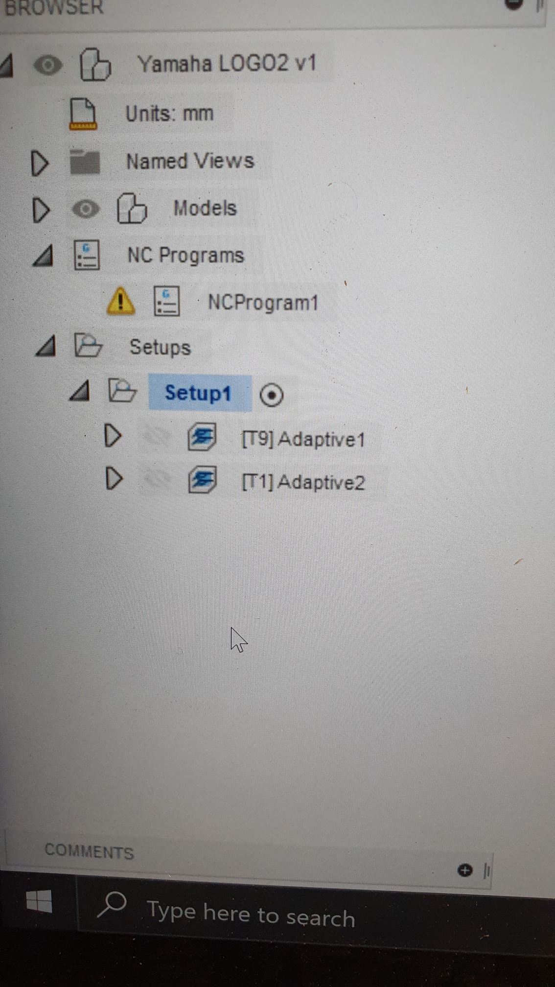

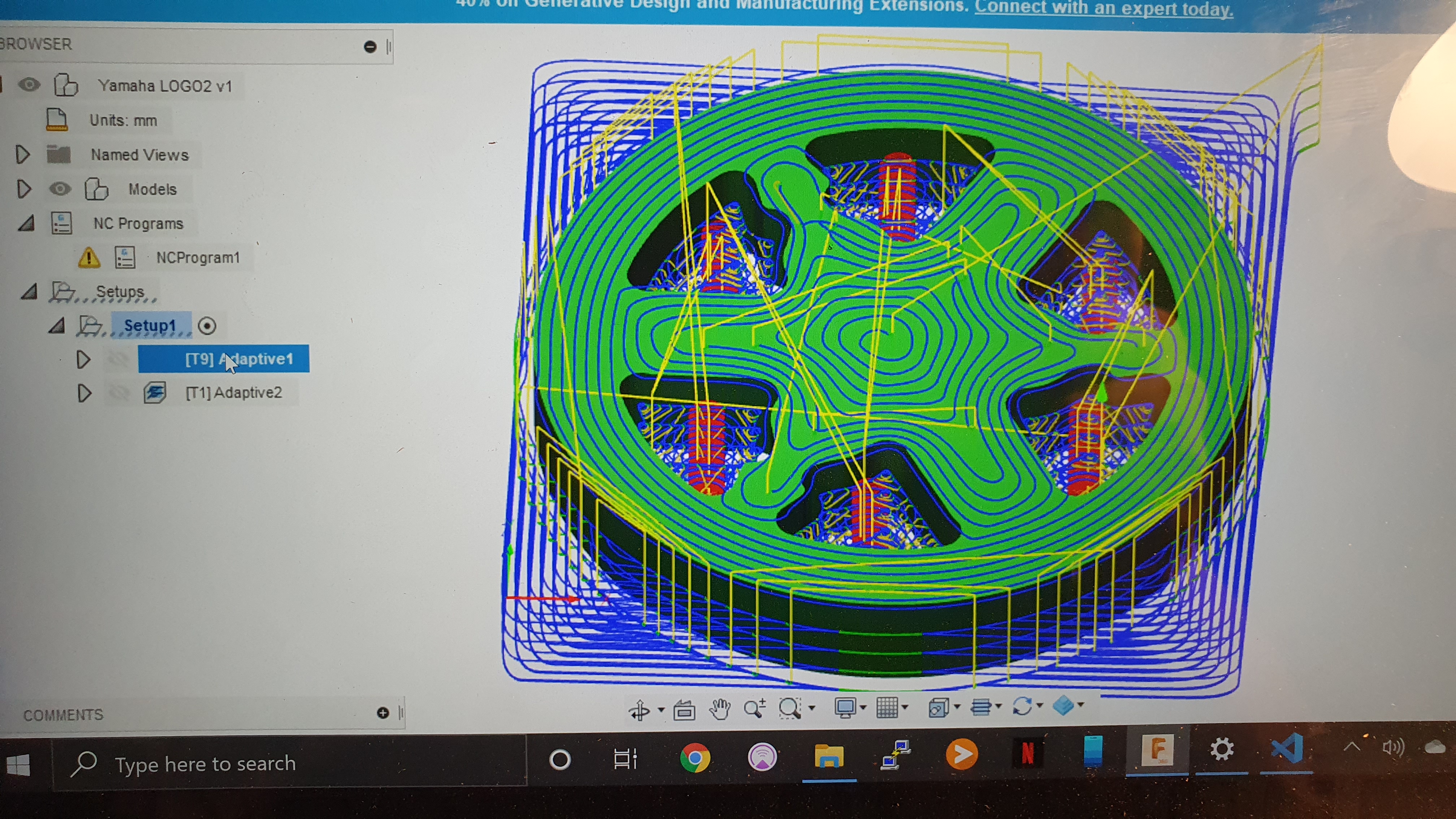

I decided to give it a try doing a tool change and it worked. But there is one problem i need to figure out.
The first tool path was perfect, then I did the tool change and it started doing the path no problem BUT instead of finishing the job taking into account what the first tool path had done, it just started from zero and did the job as if the first tool path never happened.
Im sure there is some setting in fusion360 i still haven’t figured out
Inside the toolpath, there should be a checkbox for only machining what’s left. I don’t remember which tab it’s on or what it’s called.
David you ROCK!!! I found something called rest machining from previous operation. It seems to do what I was looking for, it takes into account what the last toolpath did.
Thank you!!!
This is the one…
Success!
