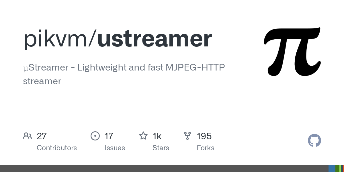

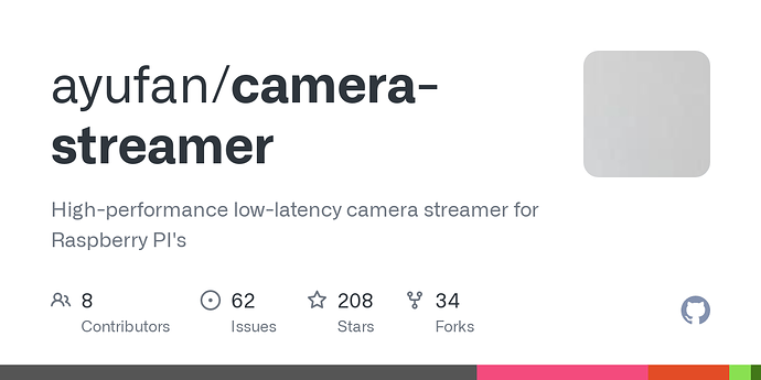

The rtc protocol is a little confusing. I’d prefer a proper web service. These two looks promising:
Ustreamer even got updated bookworm support.
camera-streamer is what octoprint switched to with the changes in the latest raspberry pi camera.
