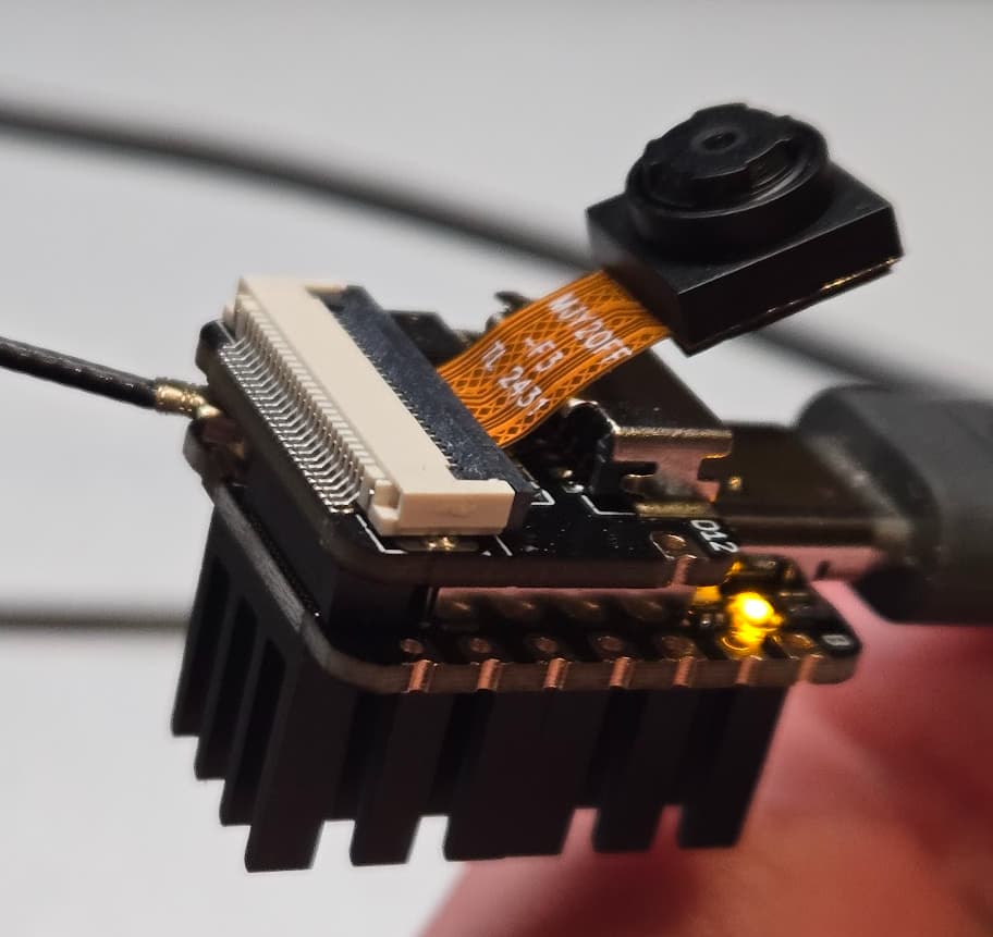

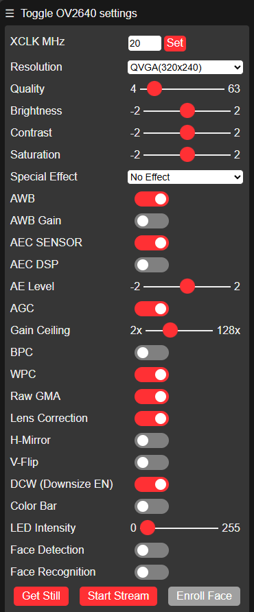

So, anyway, I figured for the WebUI, it needed to be a camera that could stream over HTTP. I got one of these. It’s tiny. I’m not sure it’s the best solution but works for my current purposes (whatever they are). It can stream wirelessly so all I need to do is run USB power.
I used this code (which I tweaked a bit so I could use PlatformIO):
Camera Usage for Sense Version | Seeed Studio Wiki
It comes with some heat sinks which are bigger than it is, which it absolutely needs.
So, when you run that code, you get all kinds of settings. For me (on my local network), this is at 192.168.0.199. The video stream is at 192.168.0.199:81/stream.
Max resolution is 1600x1200. It’s loaded with some “AI” nonsense for face recognition. Maybe there’s something useful there. I’d be satisfied with manual alignment via tiny jogs.

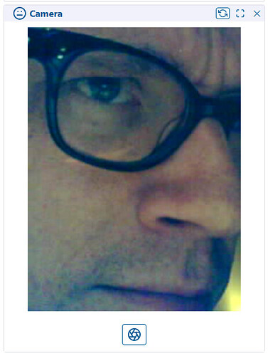

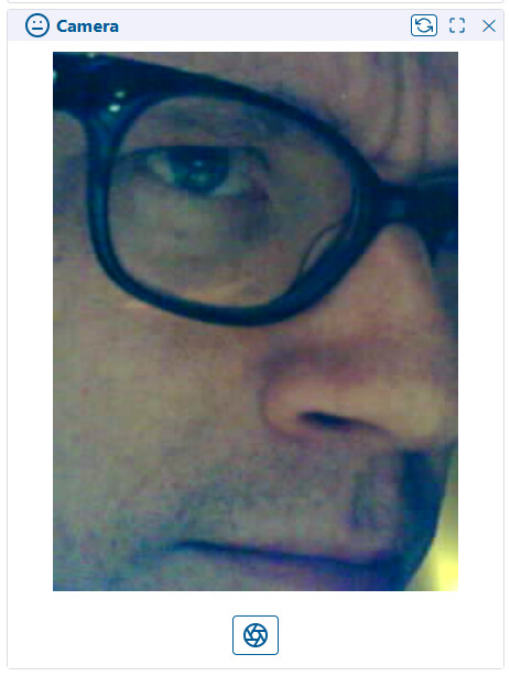

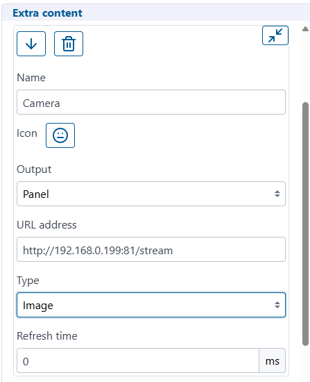

In WebUI v3, under the “Extra content” settings, there’s already an image type and it works:
Sorry.
There’s a button to save the image but it doesn’t work. That’s fine.

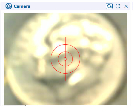

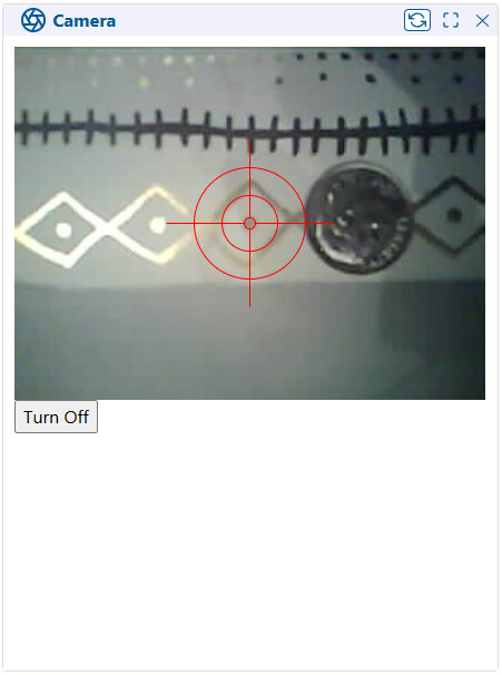

Now I’ve got a simple extension with a target overlay and a button to toggle the camera on/off. It gets really hot so I don’t want to leave it on all the time.
This is on a random coaster with a dime for scale (that’s about 18mm diameter for non-US folks).
Next step is to add some controls for a digital zoom and maybe some other settings. Maybe some target color options.
