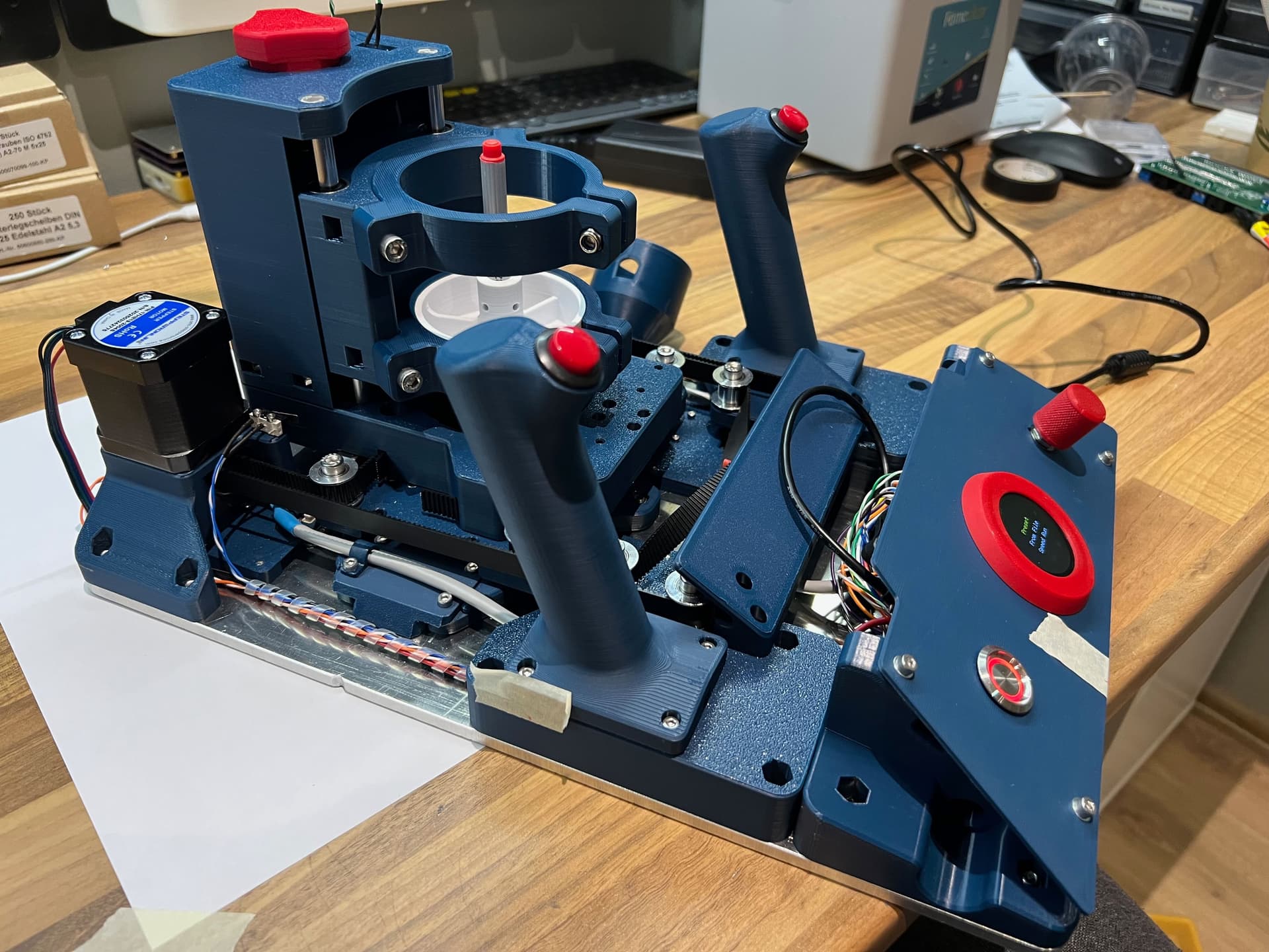

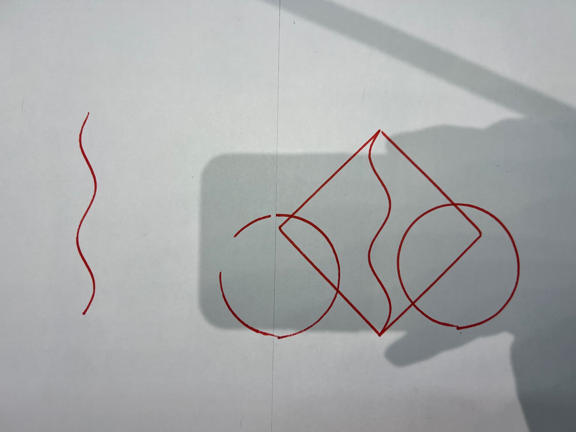

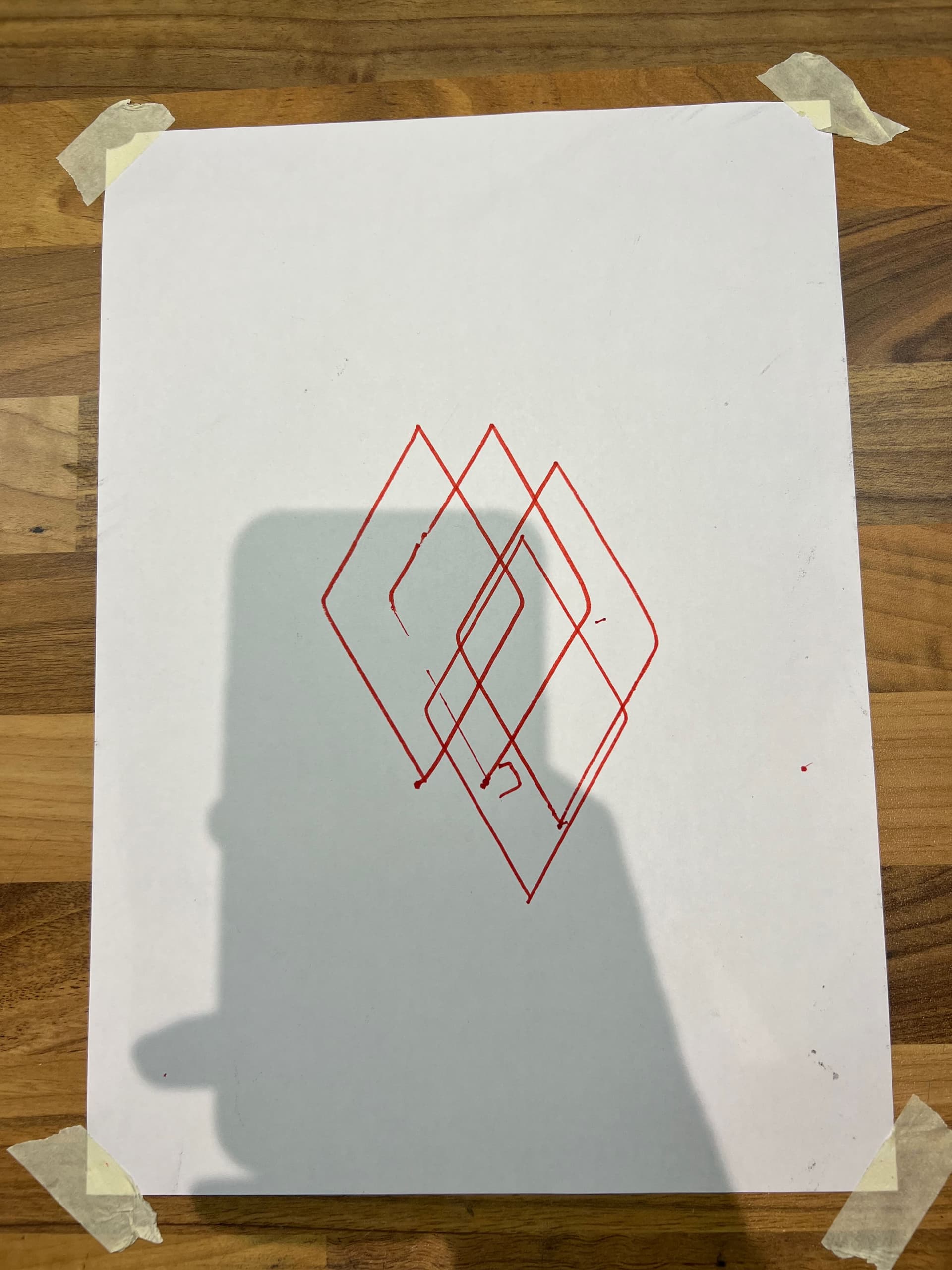

So I built my Compass CNC, many thanks to Cam: the project is awesome and the documentation is fantastic!!!

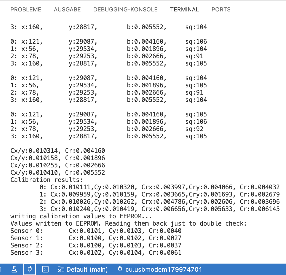

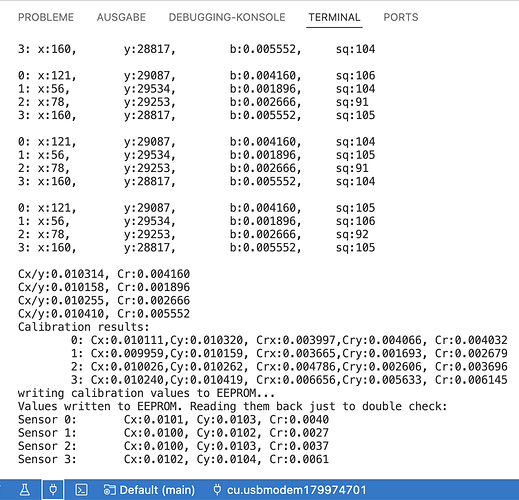

I started the machine and it immediately worked, but now I have the problem, that squares turn out as diamonds. The machine travels too far in Y direction. I read here that Thomas had the same issue, but he was able to solve it with calibaration. I calibrated my machine several times, updated the firmware, but nothing seems to work.
I already checked the cables (i went the extra hard way and crimped the cables myself and soldered the PCB… tombstoning is really an issue I learned), but as far as I can tell, the connections are fine. Especially since the error is completely repeatable.
Does anyone have an idea what I could try?
This is because the rectangle is actually a diamond.
How does the one with the sine wave looks?
How perfect is the circle?
I currently have the problem that there are always issues on a white background. Strangely enough, it works fine on slightly darker backgrounds.
oh boy, i feal stupid now. I only tried the diamond. The other forms look good! The circle is round, the sinse wave is a sine wave and the square with the sine wave is also perfect. I guess next step is to try it with a router and wood

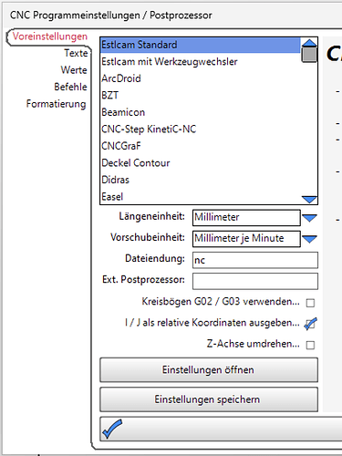

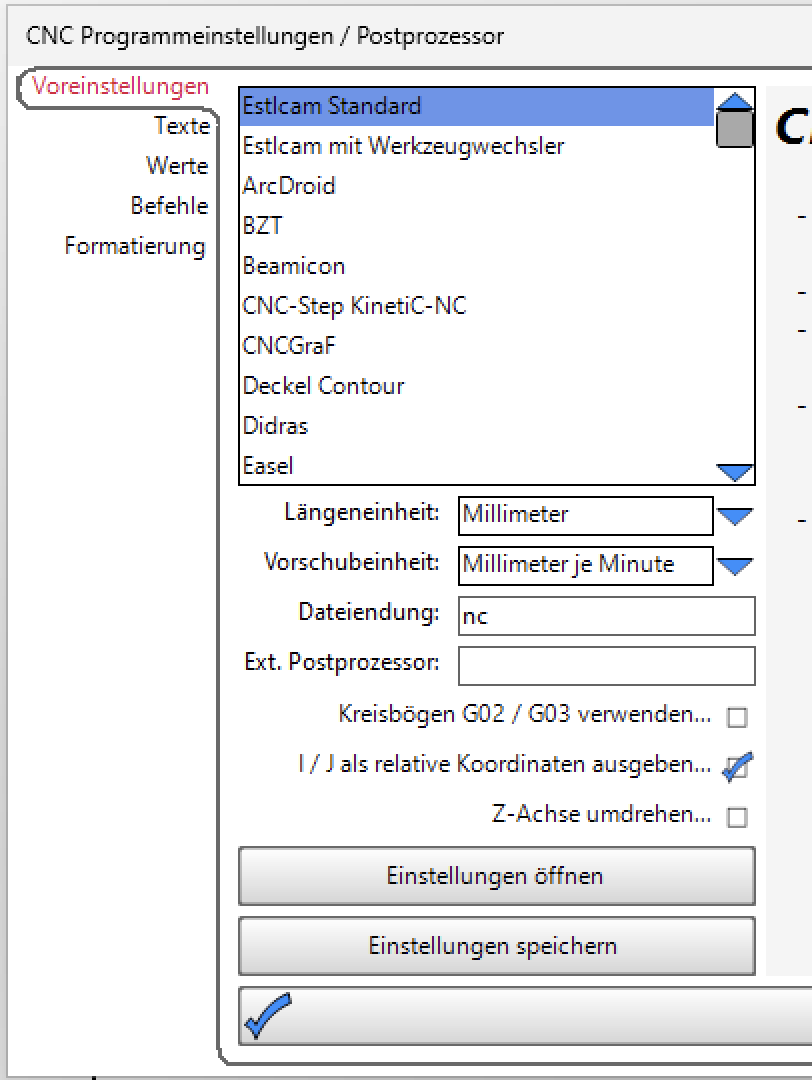

I tried it, but so far without success. In Estlcam, I disabled “Use G02/G03” and tried exporting GCODE with the post processors “Estlcam Standard”, “Marlin”, “GRBL” and “Default settings (Grundeinstellungen)”, but when I click on either one .nc file on the Compass, the screen with the square indicating where to go will just flash for a fraction of a second and go back to the file browser again. I guess I have some settings wrong

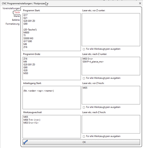

I tried a lot of different postprocessors - I attached two examples (dont know if this is important, but the LinuxCNC.ng was .ngc but i could not upload .ngc files). In Estlcam I could change the GCODE beginning and ending texts, and from what I saw in the file created by Fusion with the compass_post.cps postprecessor, this would be neccesary. But I found it strange, that in the gcode made by fusion, not every line starts with G, but tbh I have only very limited knowledge of GCODE :smiley:
Ahhh I think the problem is that your gCode uses “G01” whereas fusion outputs “G1”. I need to change this in the firmware. Give me a sec
Ok I just got both gcode files working on my device. Can you pull the new firmware and confirm it works for you?

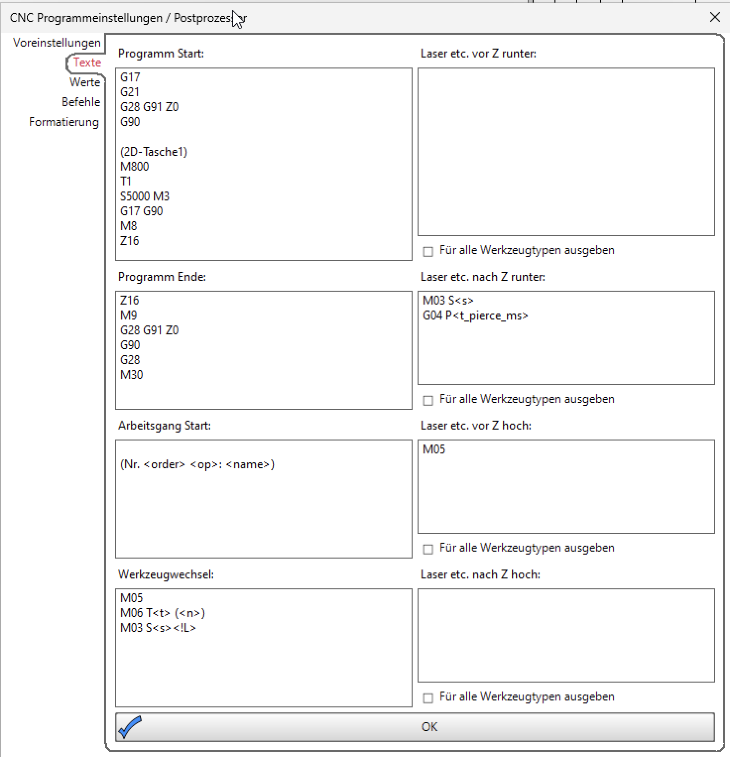

I got it working with Estlcam. These are my settings. I just copied the start and end GCODEs from a file that Fusion created and tinkered a bit. I dont really know what they do or what they are for on the compass, but it works. Since I will be using the compass for simpler shapes, I am happy to be able to use estlcam over fusion
Hmmm yeah those extra lines shouldn’t be necessary, but they don’t hurt :slight_smile:
