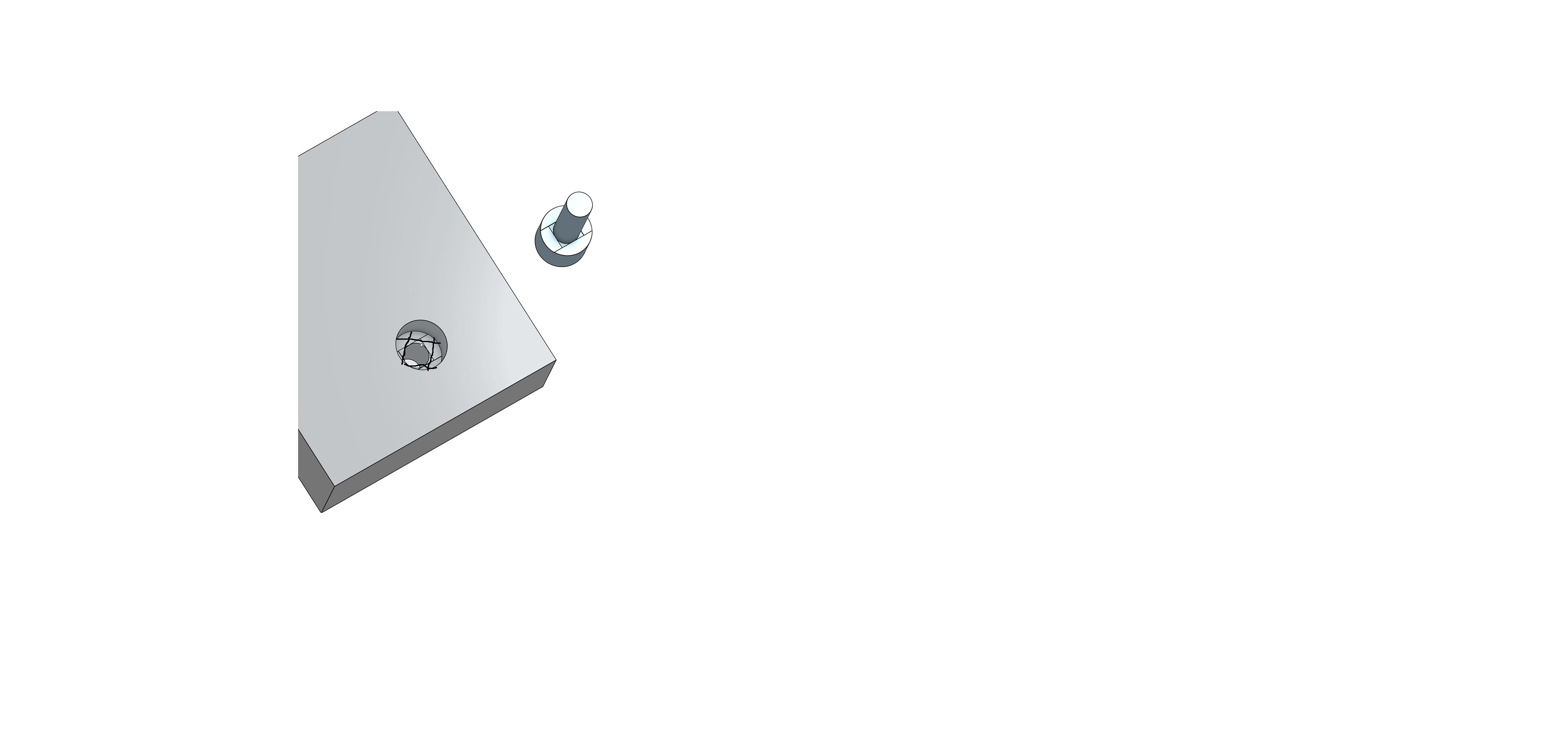

There’s a fairly standard method for making an inverted countersunk hole, but running a couple of tangents on one layer, then a couple the other way on the next - some even truncate those again, but I’m not that convinced it’s necessary. I think you do this @vicious1? I know Prusa does, and Makers Muse did an entire video on how to draw it a year or seven ago.
I’m not sure if this will make a lot of sense but I do know what I’m trying to say!!
A conversation on another thread about mate connectors and assemblies in CAD got me thinking.
What if I was to draw a parametric “bolt” to make a pattern?
All I’d have to do would be to pop a mate wherever I needed that feature, stick the “bolt patterns” in place and do a boolean subtract. Someone way smarter than I could write a feature script in Onshape to fully automate this and it could be a one-click sort of adventure.
Hopefully this single screenshot will explain - if not I’ll publish a sequence.
Does this make sense, or is there a simpler way of doing this that I haven’t discovered?
This will work.
You can even go as far as setting a few more 45° from those if its a real large hole and the corners need more supports
Don’t judge my crude drawing. Its still early LOL
I’ve had a quick look at what it will take to make a feature script library so it could be accessible to other Onshape users, and I may even be able to nut it out eventually - that would be cool!

The subtract idea is a good one, save a couple steps for sure. For me it is one sketch with both circles and the 4 tangent lines, through hole cut, counterbore cut, bridge cut one, bridge cut two. For a subtract you will need to add the part, size it, locate it, subtract it. Looks like it saves a step if locating is only one step.

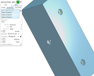

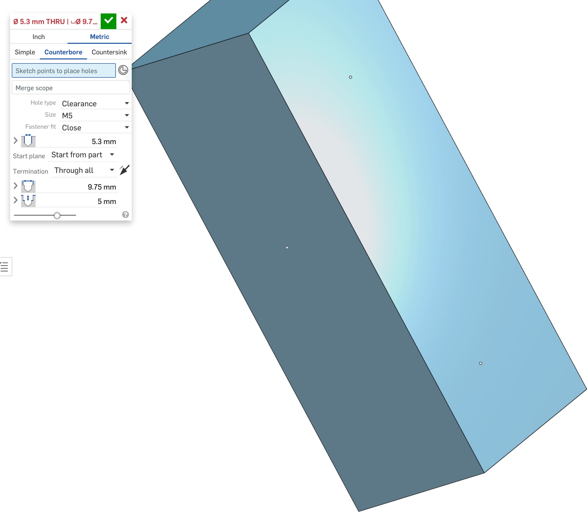

I think you might be close. My workflow for countersunk holes is-
Mark centre with a point.
Use Hole tool to make all holes of the same size at once. That way any change later is universal.
It’s easy to then select the faces and I think it should be relatively easy to make that “apply face” work - I’m sure it would be for someone who knows about this stuff, but I’ll see if I can get a chance to have a go over the next couple of days.
