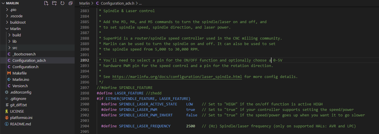

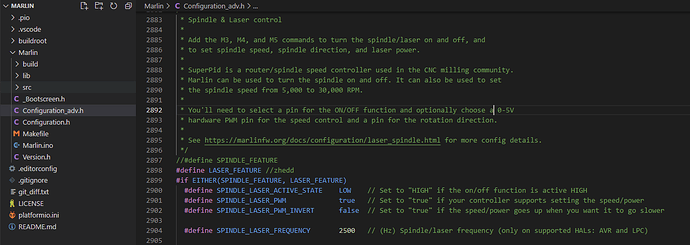

You can find a bunch of laser options in configuration_adv.h. You just need to give it a pin in the pins_ramps file (one is probably already set) and enable it, then you can fine tune it with the different laser options.
@jeffeb3
yep - now that the brain is recharged…
From Configuration_adv.h (line 2898 in this pic):

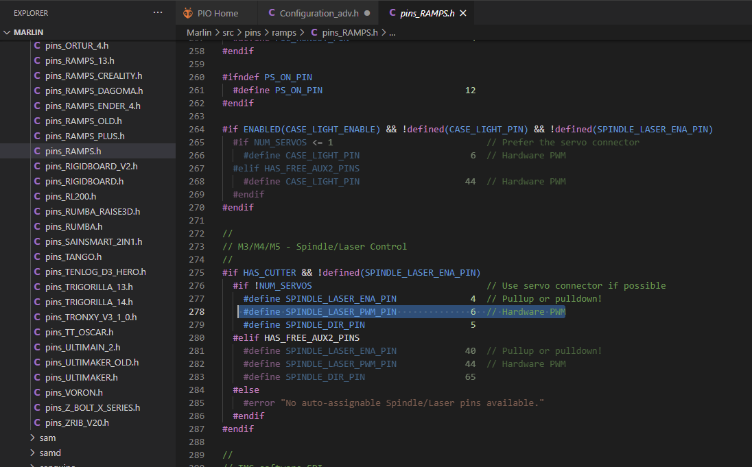

Then pins_RAMPS.h says that the default pin for hardware PWM laser control would be pin 6:

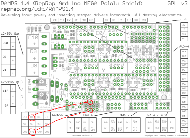

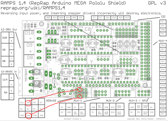

Which corresponds with the servo headers on the board:
