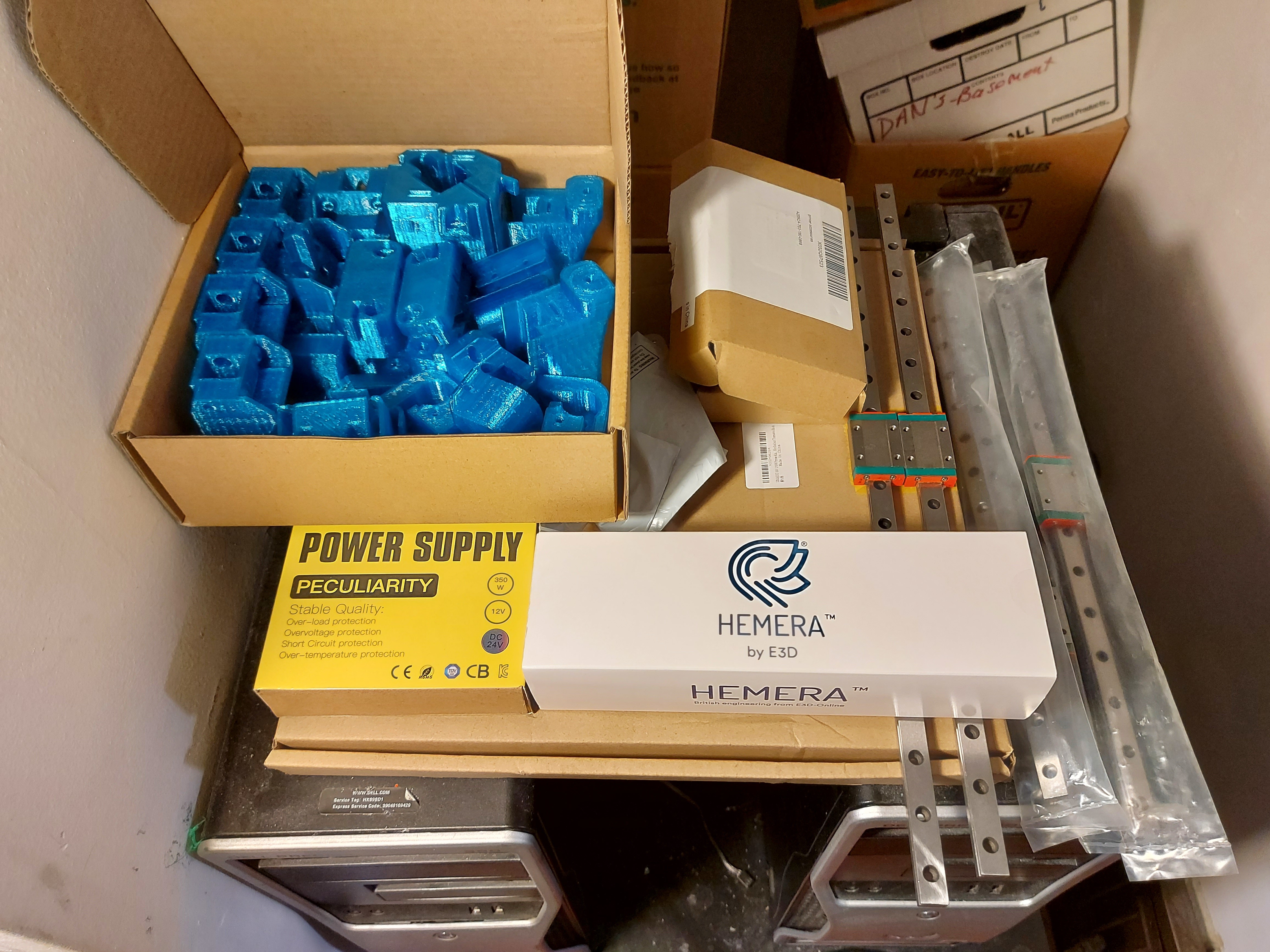

Nice surprise in the mail today, my Hemera kit showed up. This pic is the closet where I expect the printer to live. I have a pile of old PCs for it to stand on. Maybe I’ll make a shelf for it or something.
So I have the build platform here, power supply, most of the printed parts, BLTouch, Hemera, various odds and ends, and 5 MGN12H rails. Still to come is the CF rod, and V1 package including the SKR Pro, LCD, motors, belt, and pulleys.
