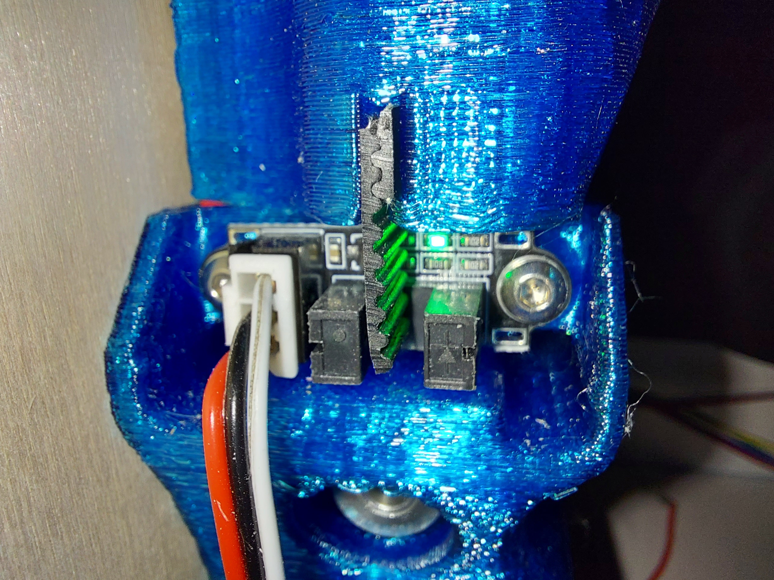

The only thing that I would change is on the Z belt slider, the belt slot for the optical sensor by couple mm… in my case no mater how strait the belt is once it is inserted into the slot the belt bends to the left and from time to time its get cot on the sensor.

Noted thanks. I will take a look at all of them and see where it is at. Can you move them over if you loosen the screws a bit? There is some slop. Wait, is that one on backwards, what if you flip it over?
That wire though, it should either be on the stepper side or the switch side, none of them go over the side.

I don’t beliave it is backwards, I tryed flip it over, no joy.
What wire? are you talking about the black wire sleeve? That is from the X axis and was just moved to take the picture.

Okay, I checked both of mine and they are lined up.
How thick are your linear rails and block? My stack is about 13.3mm bottom of rail to top of block.
I just check the order and the specs say 13mm
MGN12H
You are missing the little lock piece of belt in the mount. I have a small piece3-4 teeth long that locks the belt in from

I guess I see a little of that, but it has only caused a problem with the one sensor where it has hit the wiring. I moved the wiring and it’s been good.
Maybe different switches? This is my other machine
For some reason I thought I have then in, I’ll be home tomorrow night and I will check everything.
It is possible, but If I’m not mistaken, I got them from the shop on my last order.
I suppose different switches might be possible, I did source mine from China, but the PCB patterns look the same…
Man This sucks, I have no idea how this can happen. Same linear motion thickness, same switches, same belt, same hardware. I can not imagine the printed parts being that far off.
How do all the belt triggers look?
I think the little strips of belt are an elegant solution, but have a possible low/no-cost workaround. In the past I’ve used cut off pieces of soda can for optical flags. It’s thin enough to cut with regular scissors. Hot glue it in the slot and it will take and hold a bend to fix any small alignment issues. You can also make it intentionally too long to start and then trim it to just the right length while testing.
That might end up being plan B if we can’t figure this out.
