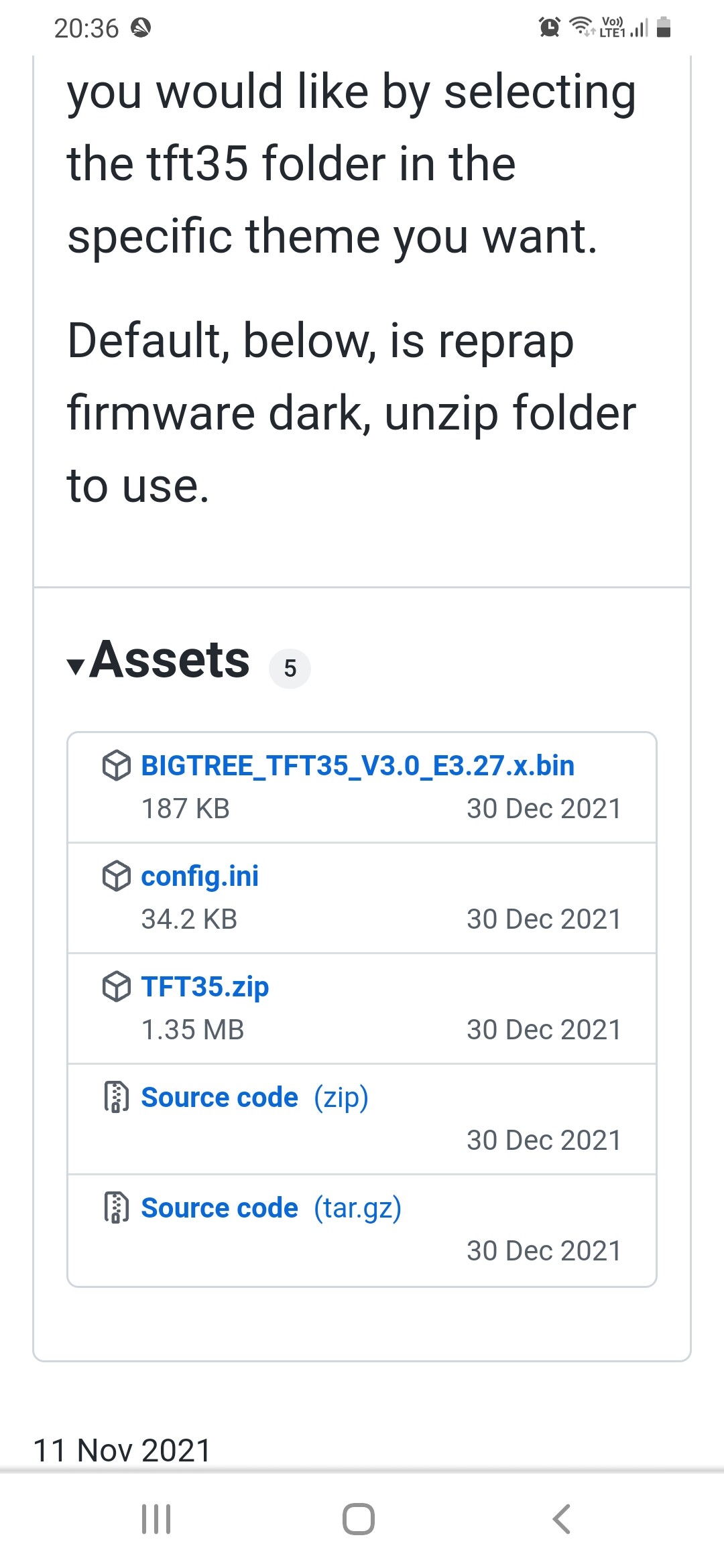

Hello Ryan,Jeff, when i put the latest firmware on my new Tft 35 than i get the print version not the cnc one,
What do i wrong?
Here you go.
https://docs.v1engineering.com/electronics/skrpro/#tft-files
Sorry, it is not working for me, only the print version

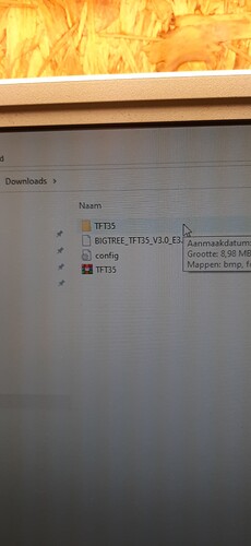

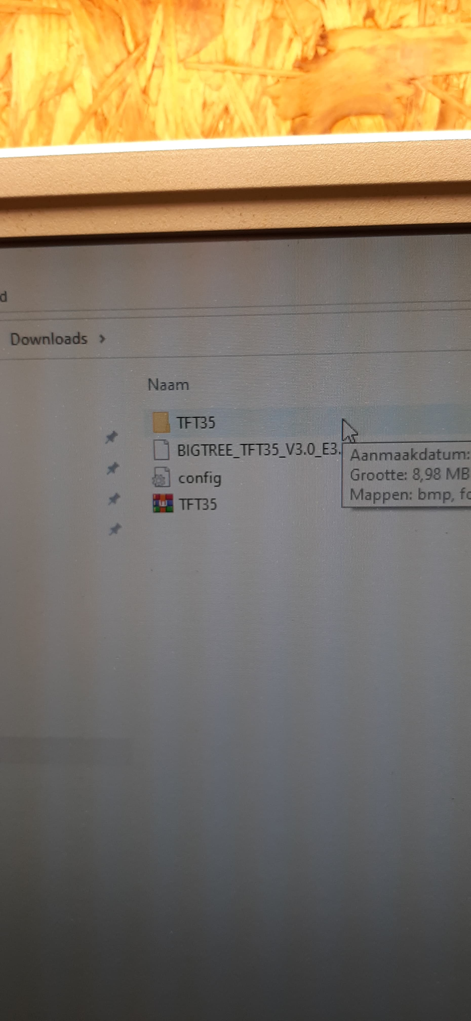

I put the 3 items on my sd card and afterwards in the tft sd card slot , push rest and download
Sorry for my english
Did you unzip the folder?

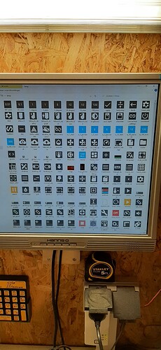

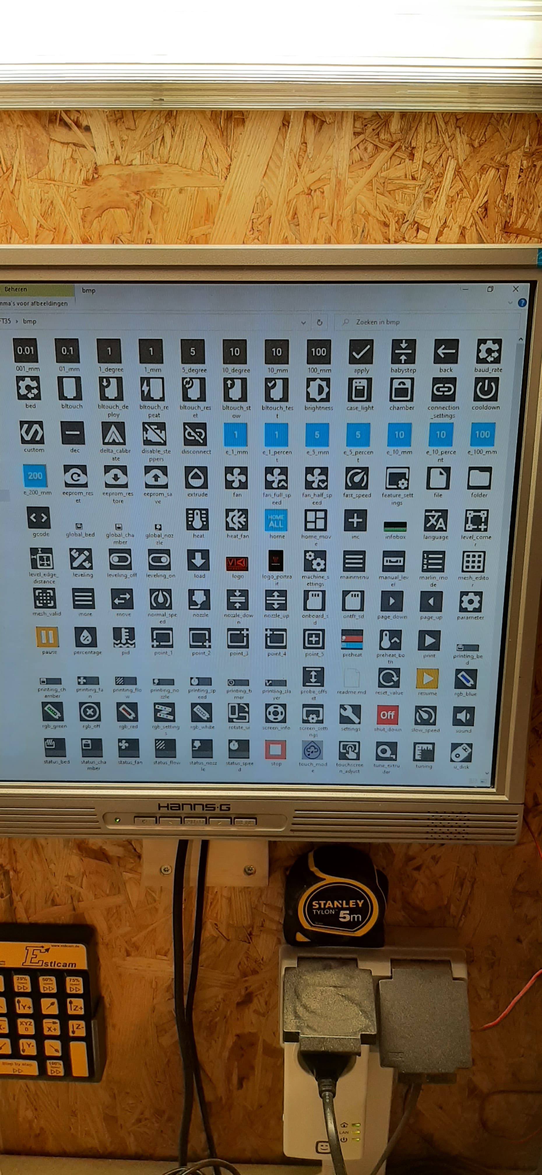

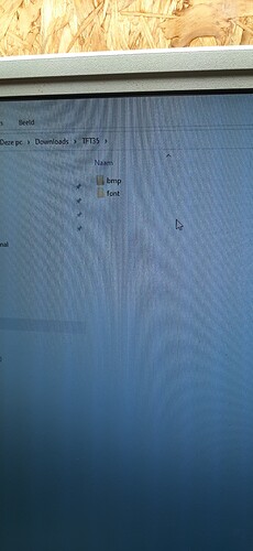

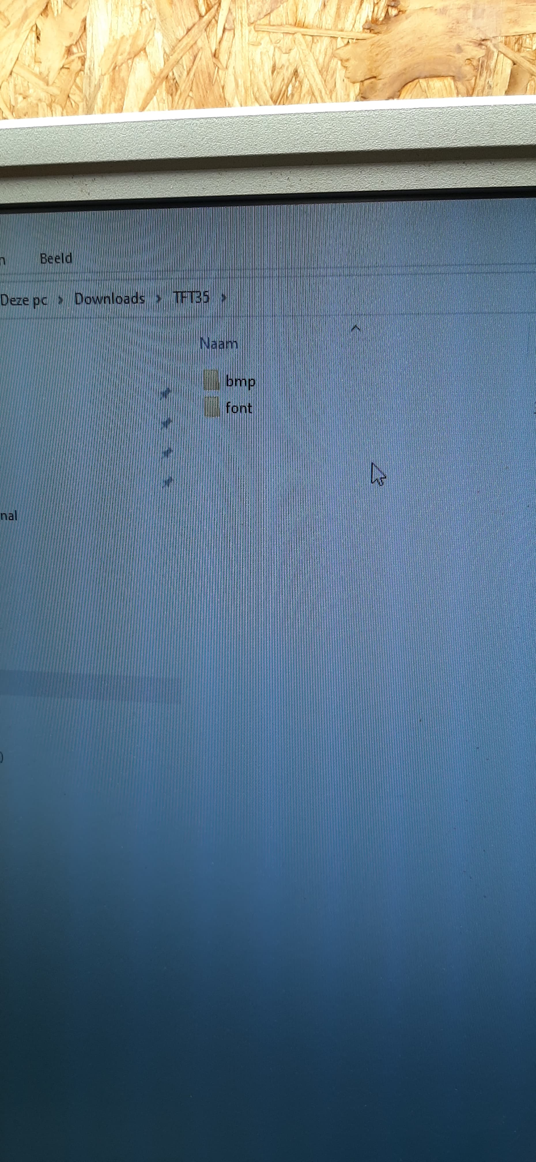

After downloading the 3 files, i unzipped the TFT35.zip and this is what’s inside.
It looks like the firmware for a 3D Printer instead of a CNC mill.
The firmware was designed for a 3D printer. All the parts were. We have made changes to make it work for CNC.
