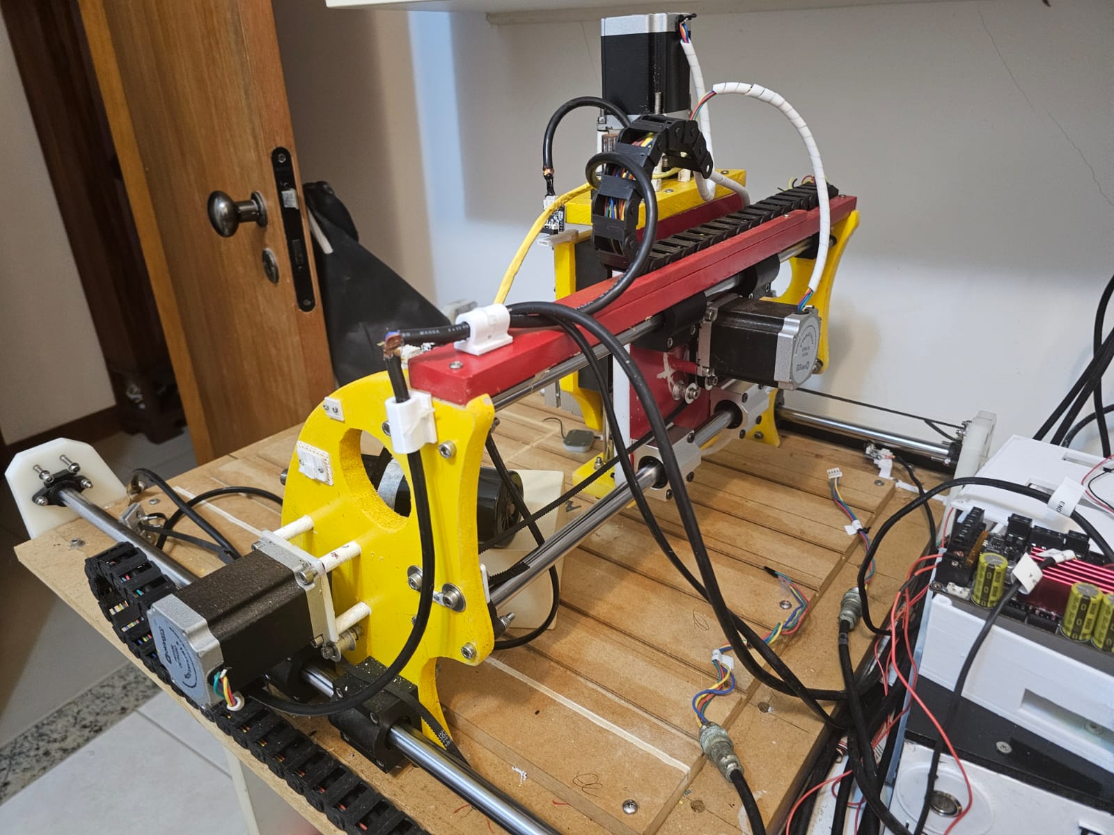

I am having hard time to configure a YAML file for my laser engraver running FluidNC on a BTT Rodent. I have managed to get everything working except the Y and A motors work together. Could someone kindly share with me the YAML file of a 3-axis CNC? Actually, I only need the section related to the Y axis so I can try to understand what is wrong in my configuration. My Y axis YAML is this:

Can you post pictures of your machine setup?
Do you have no Laser Z height control (or manual Z), and are using a rotary axis?
We can’t really help suggest a configuration unless we understand fullly how your machine is built and how you use it.

``My CNC is partially disassembled. It used to work with Arduino and I’m trying to make this upgrade with Rodent. Sorry if it got confusing, but it’s not axis A, it’s motor A. That is, Y axis with 2 motors. Motor0 (Y) and motor1 (A which the board designates as E). At the moment I’m just testing the motor activation, that’s why the mess of the CNC. I just made a change in run_amps from 0.5 to 1.5, but I haven’t tested it yet.`

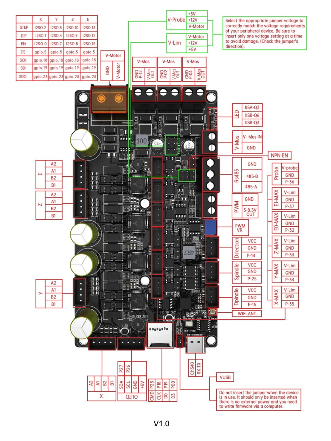

Which motors are connected to which connectors on the rodent?
Rodent appears to label these as XYZE. I don’t see an A on the BTT users manual:
Also, what endstops are on your machine, which motor and axis are they associated with, and where are they plugged into your controller?
How is your laser connected to the rodent?
